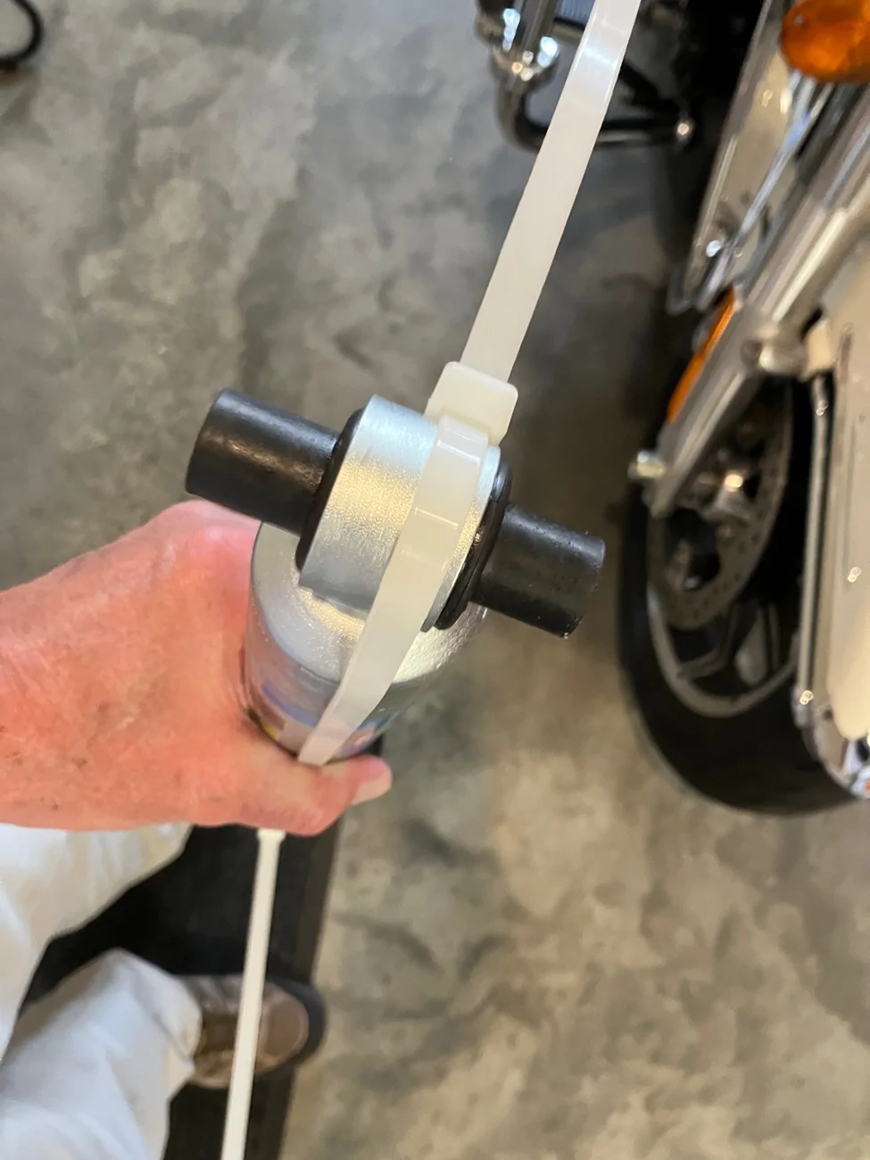

The zip tie trick, courtesy @ChrisNLA, works even better than if all the nylon packing straps were still on the compressed shocks when I opened the boxes from Extreme Terrain, because the shocks were still several inches longer compressed than they needed to be.

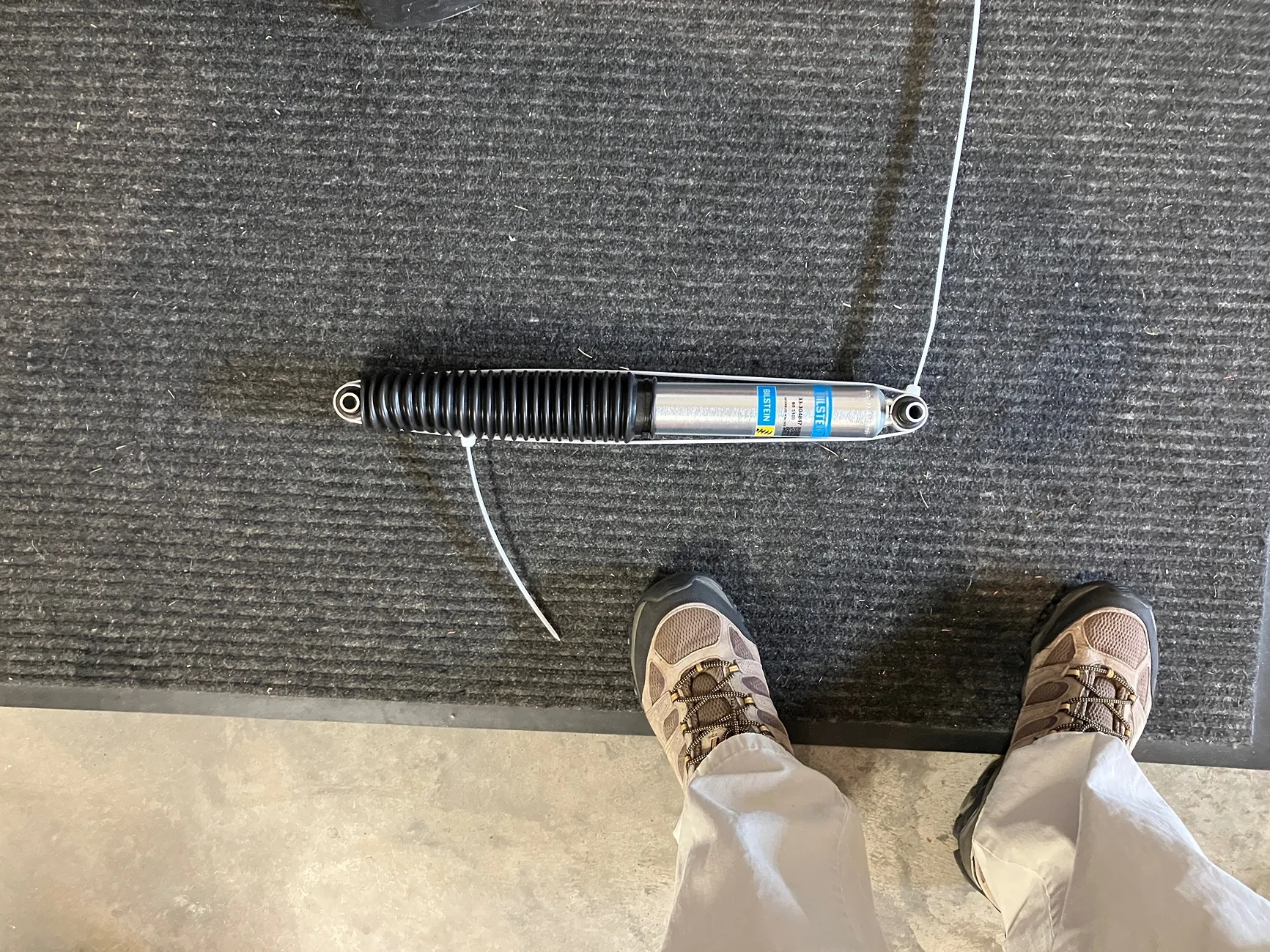

Measure from center of shock bolts, or center of bolt holes if the shock is removed, the exact length your shocks need to be when installed. Connect two 36ā€ zip ties. cinch the loop up while shock is lying flat.
Jeep Gladiator Any tricks for keeping new shocks compressed for install? IMG_5473
Then stand the shock on the floor, with the wide end at the top (aka top of the shock). You can get better purchase with your GLOVED hand to compress the shock against the floor, while cinching up the zip tie, which is somewhat of a wrestling match. Measure often because if you cinch it up too far, you have to cut the zip ties and start over. Better for it to be an 1/8th of an inch too long than too short.

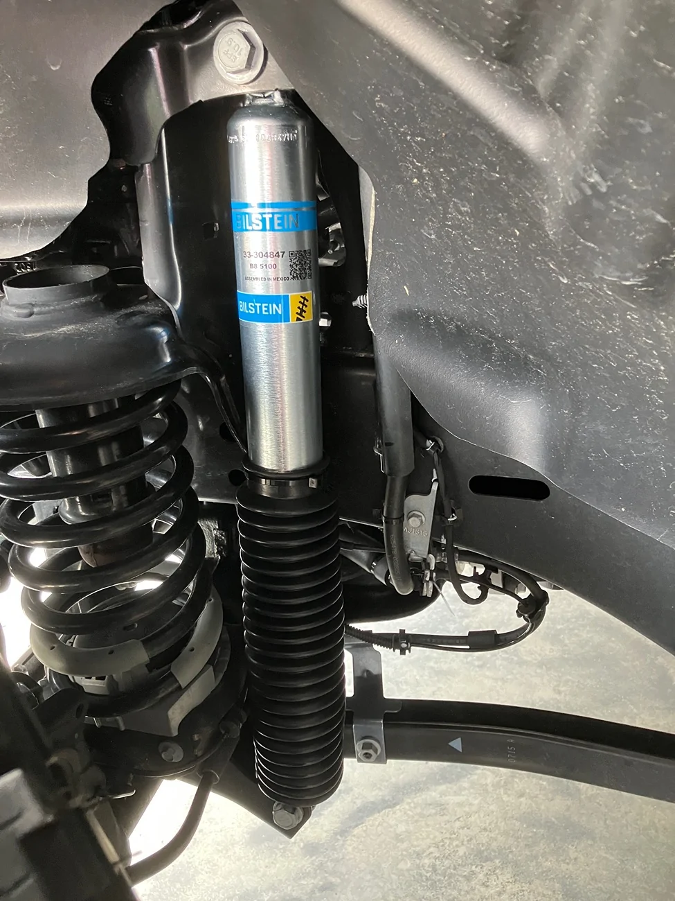

Then place the shock in the proper position, insert top bolt, and as @Zachanadandy, use a large flat bladed screwdriver underneath the bottom of the shock to pry it up a smidge to slip the bottom bolt in.
Voila!
