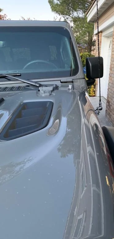

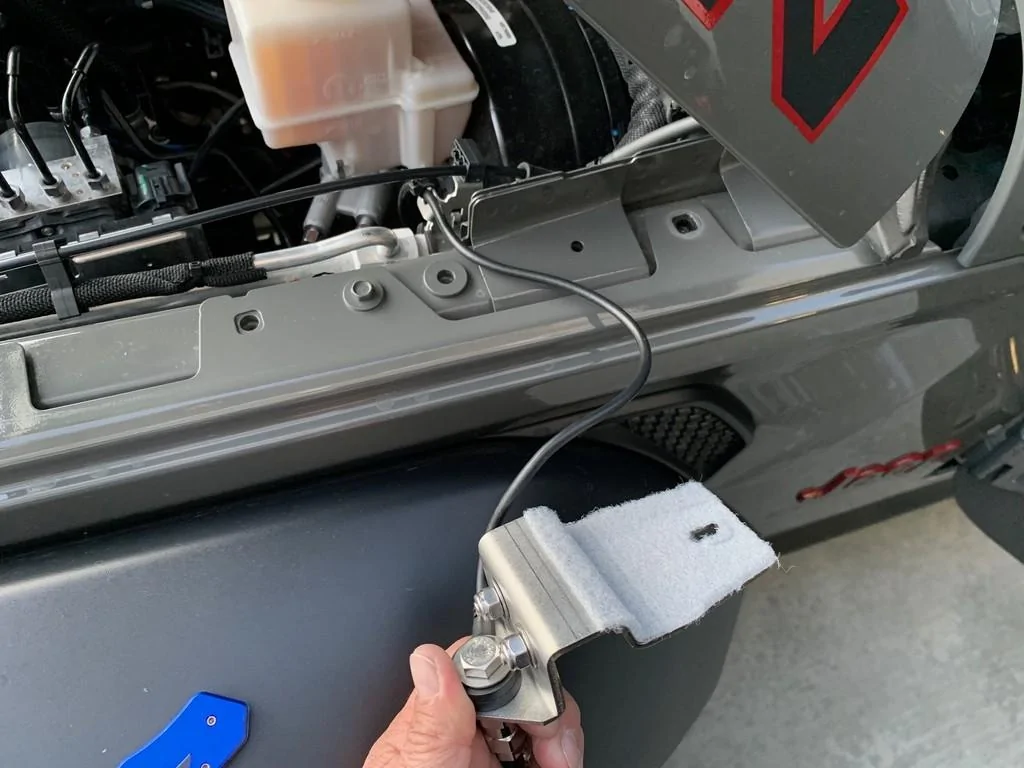

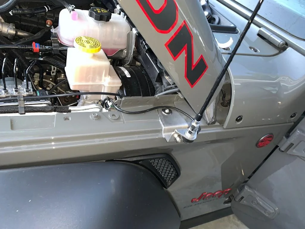

I have a cobra 75 with a mount near the grab handle. The antenna cable is run out of a floor drain plug. The antenna is attached near the hood and front fender.
Johnny-Double J, that hood mount is what i am looking for. Who and where did you get it? Thanks,

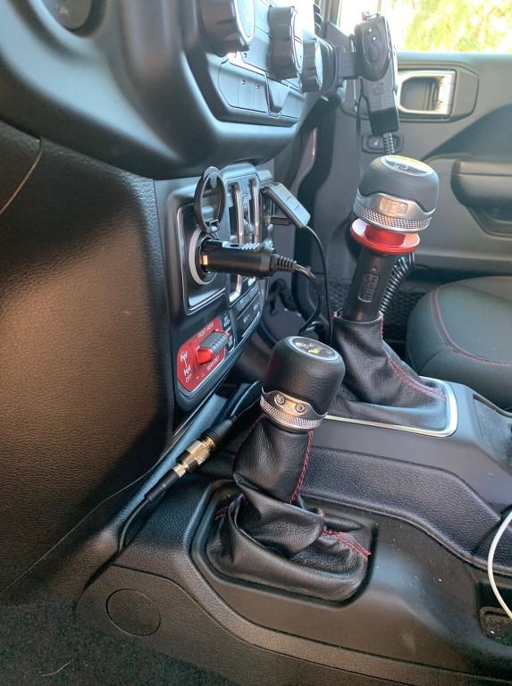

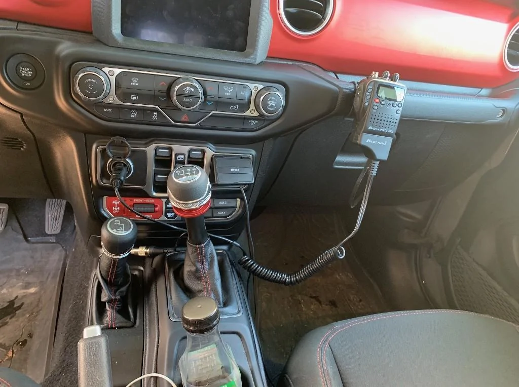

Here is my setup, midland handheld that has a mounted setup also. I then got A pillar mounts, mounted a Wilson antenna, because I wanted to run the ground myself and Wilson already has a ground wire, ran the antenna cable through the firewall on the passenger side, added a cb mount to the OH Crap bar and there it is. As noted, you get better range with a mounted antenna. I also added some lights :). Hope this helps
I did not want a full size cb, so this works exceptionally all well for me. Take pictures and have fun!

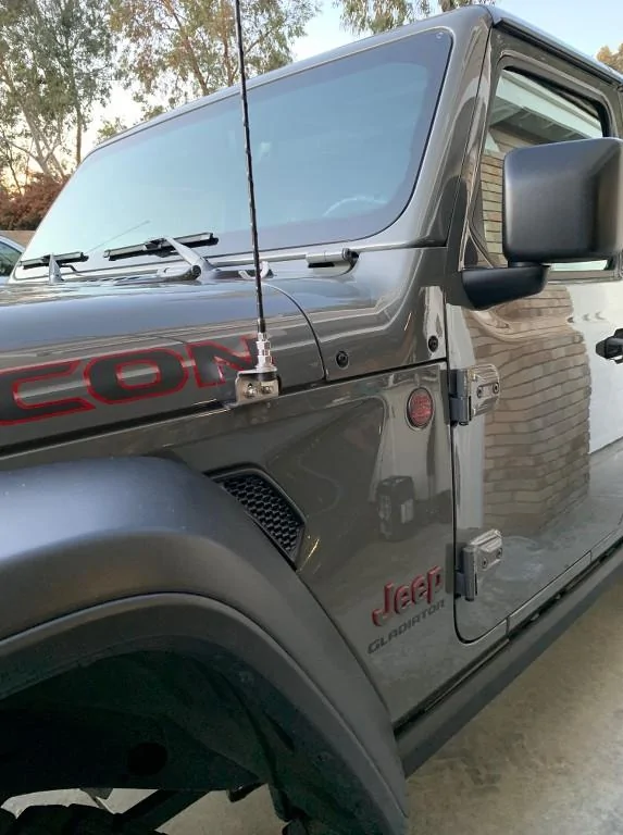

Fyi, I installed my CB - Midland 75-822. I went with the Quadratec antenna kit. This is a great kit for installation, not cheap through. It comes with a 3 foot non adjustable super flexible antenna. But, After installation, my SWR was good on channel 40, but, terrible on channel 1 - SWR was 2.5.. I got it down to 2 SWR with a light weight spring, but, I was not happy. I needed a longer antenna. I tried 3 additional antennas. In my opinion, a three foot firestick or firefly is still too heavy for that location, even with a light weight spring, however, it is very easy to dial these antennas to the correct SWR, I got both of them down to a minium of 1.3 swr or less for all 40 channels. All the three foot antennas were too short and had to be lengthened to get the correct SWR.
At the end of the process I selected the four foot adjustable Wilson 305-4FD Silver Load Series 4' CB Antenna Whip. This antenna is super light, very flexible, light, and you do not need a spring, so, that makes it even lighter. For tuning, the antenna was too long and had to be shortened quite a bit. I had to take off the adjustable tip, throw it away, then, grind down the antenna about 1/3 inch just past the adjustment screw to get a perfect SWR. My SWR is now 1.1 for channel 1 and 1.2 for Channel 40. I am super happy now with my reception and transmission and I like running that Wilson antenna with no spring.
