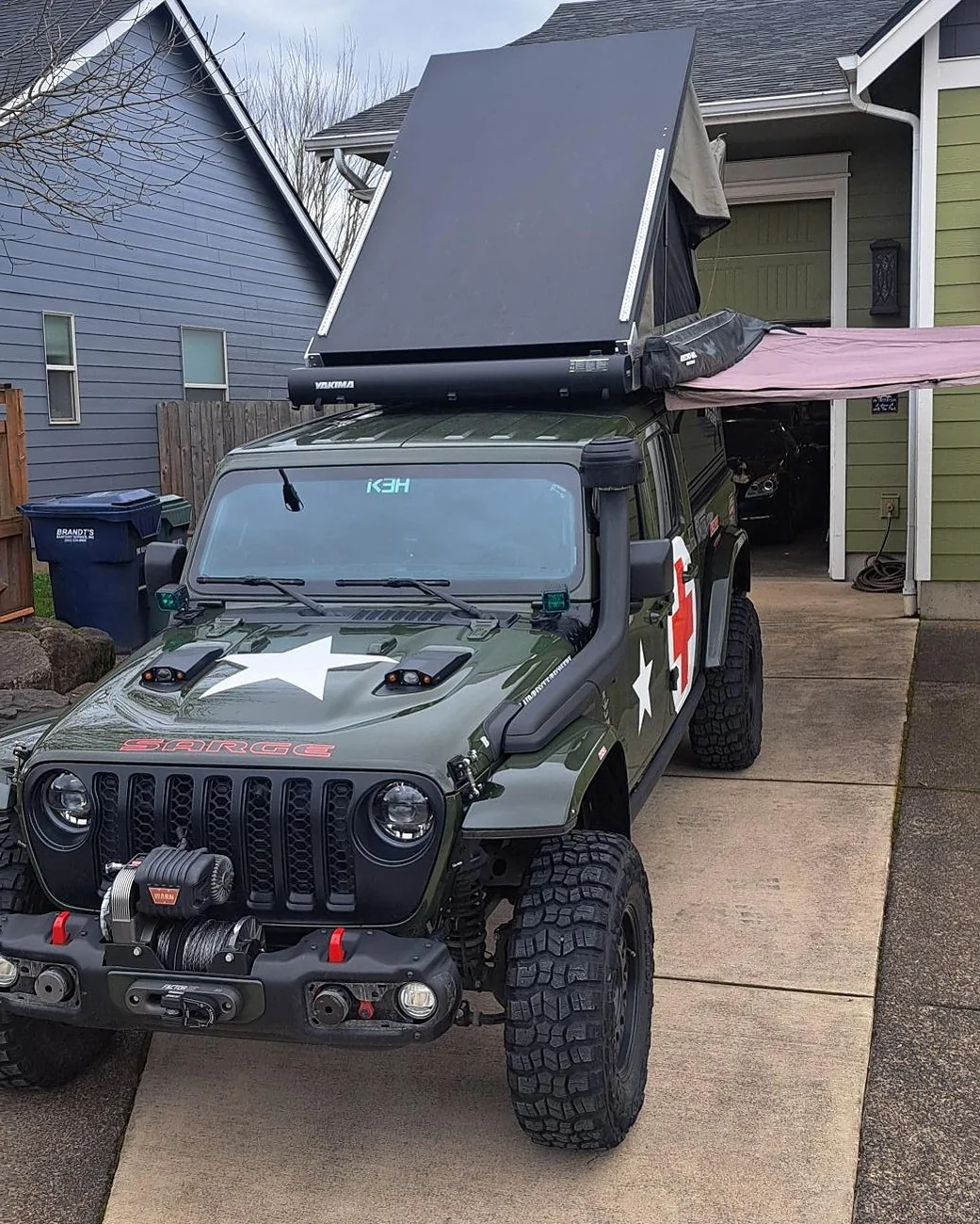

Sorry about that. I didn't catch the "D" in "JTRD" at first. I've got the Rugged Ridge snorkel that replaces the cowl piece to enter the engine bay. So the only relevant comment I guess I can make is that I don't even notice my snorkel anymore. I had to do a lot of modifying to get the amfib snorkel to play nicely with the light bar and the light bar mount. (I had to shorten the snorkel stack 4" and remold the air box at the cowl) But because the AEV one you're using is off to the side more, The only complication I could see for you guys is an overhead light bar if you ever decided you want one.
Jeep Gladiator Anyone regret installing the snorkel? 1763645173129-y8

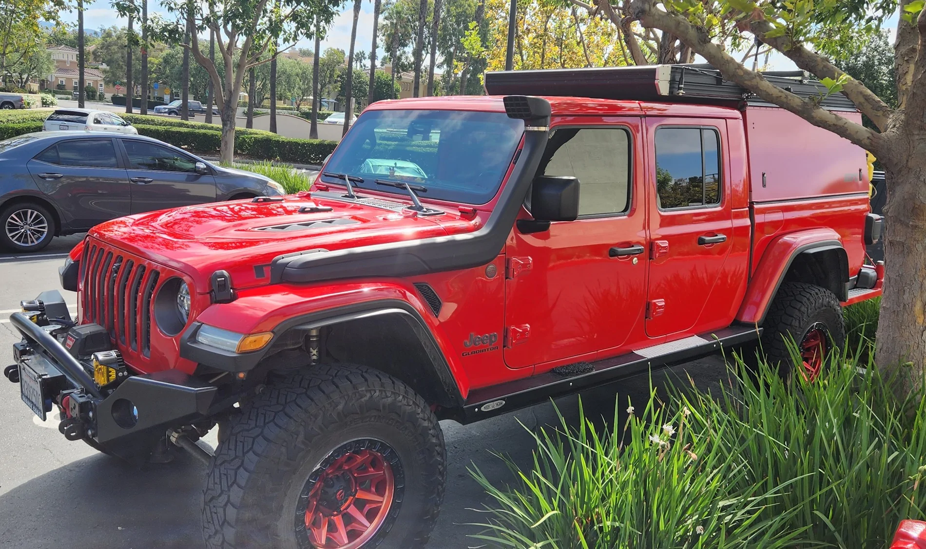

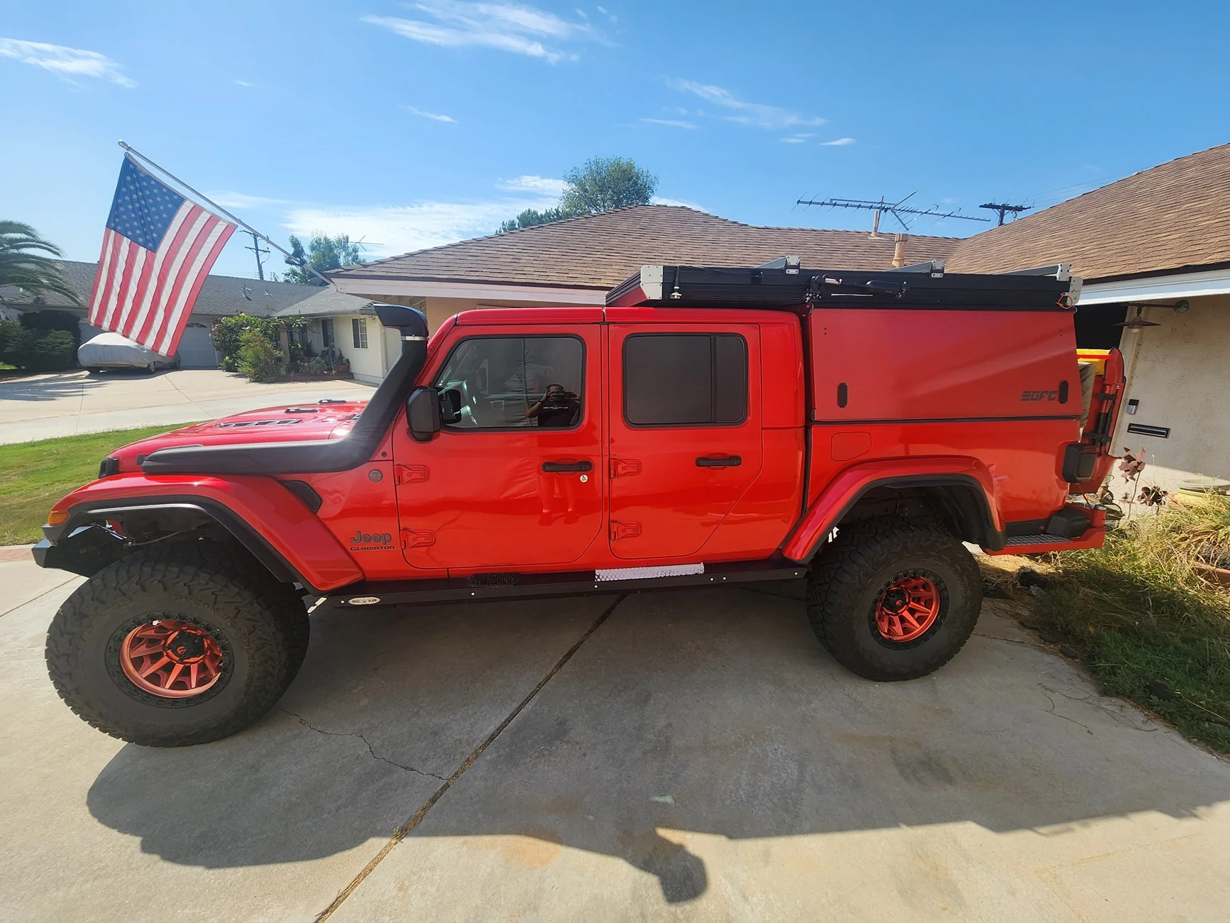

I've got the AEV snorkel and have not regreted it at all. I have the dust spinner that i put on when im in the dirt. With the intake shown, i get more power, it throws a code because i am too much air. AEV is the only one that can work on the Diesel. I have not had to change the air filter in 10,000 miles
Jeep Gladiator Anyone regret installing the snorkel? 20230919_103442
Jeep Gladiator Anyone regret installing the snorkel? 20241004_121617

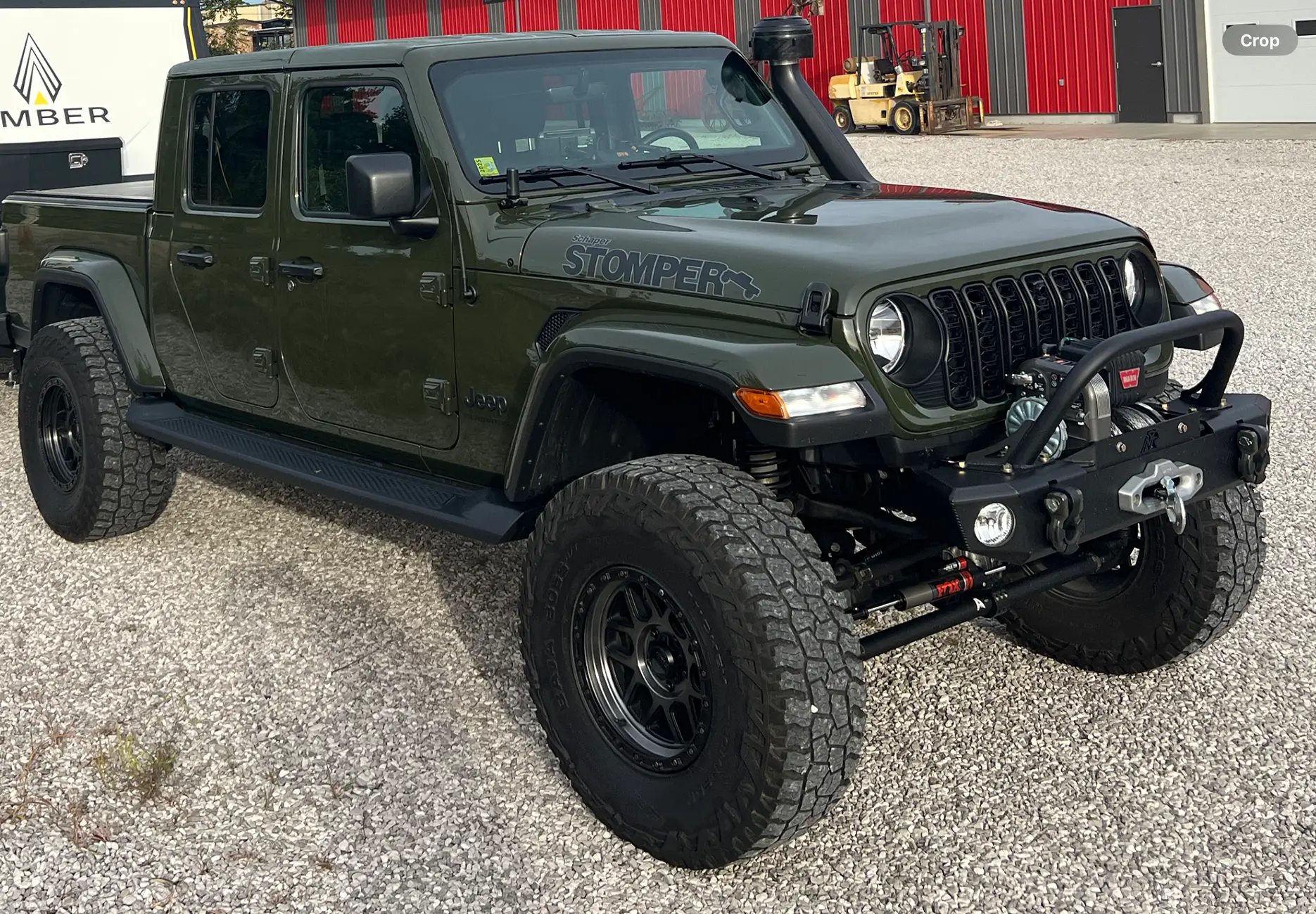

No Regerts!
Jeep Gladiator Anyone regret installing the snorkel? 1000029768
