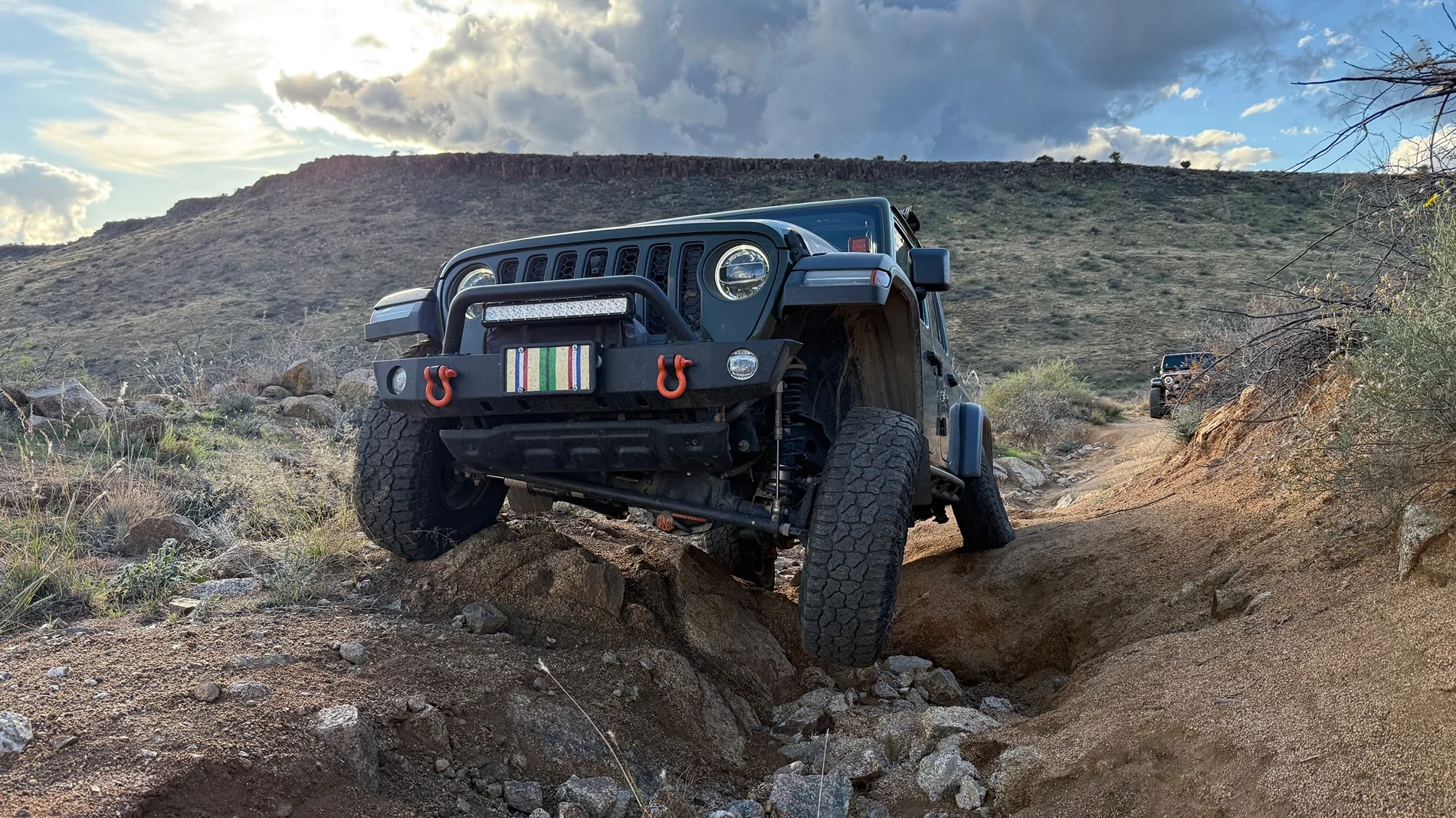

If you’re using OEM shocks with shock extensions, and don’t plan to go higher, then get 8 inch. I’m still using 8 inch with 3 inch lift and shock extensions. I put them at the highest setting.
Jeep Gladiator APEX Autolynx, which version?????? IMG_1756
