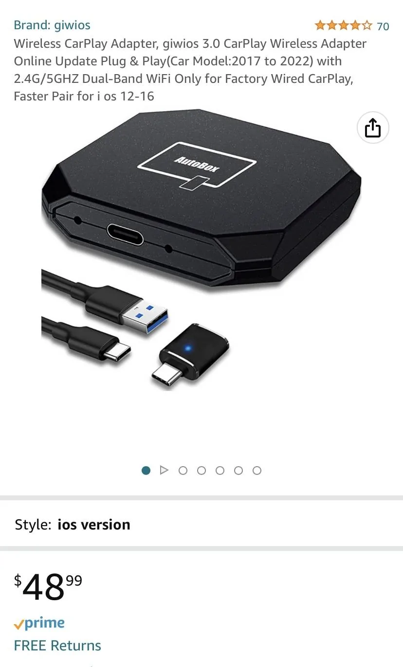

I've been using this for over a year now, in the console without any issues.
Jeep Gladiator Apple CarPlay issue fixed with most recent iOS 15.2.1? E7B5D754-BC96-47E9-A9F6-AF57F4C46294
did you have issues in center console before you started using that device?
