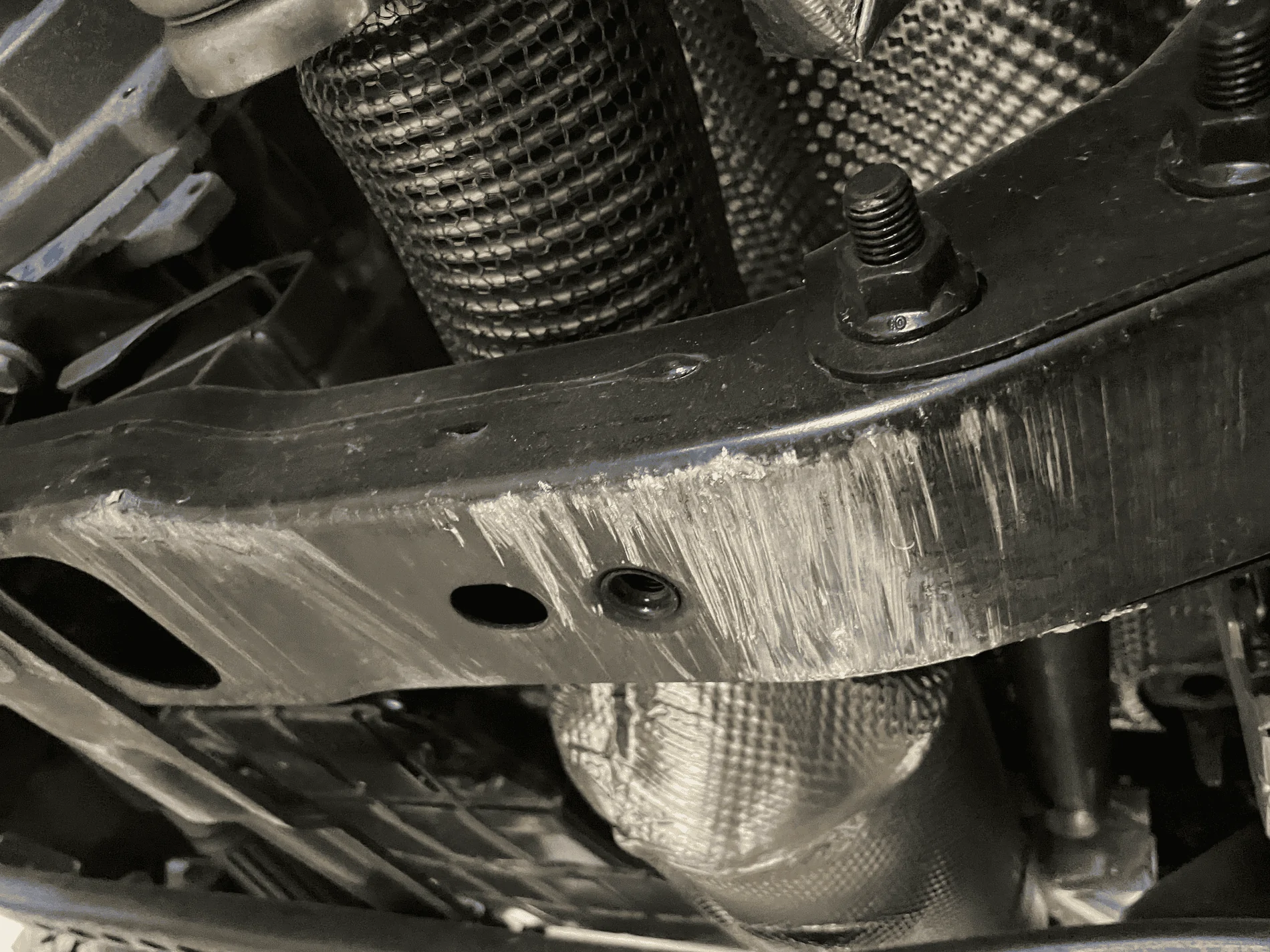

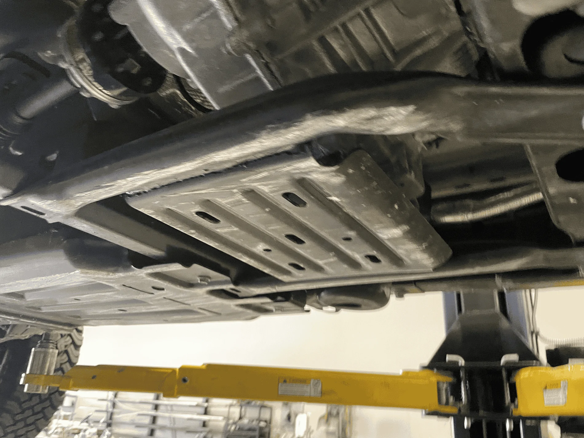

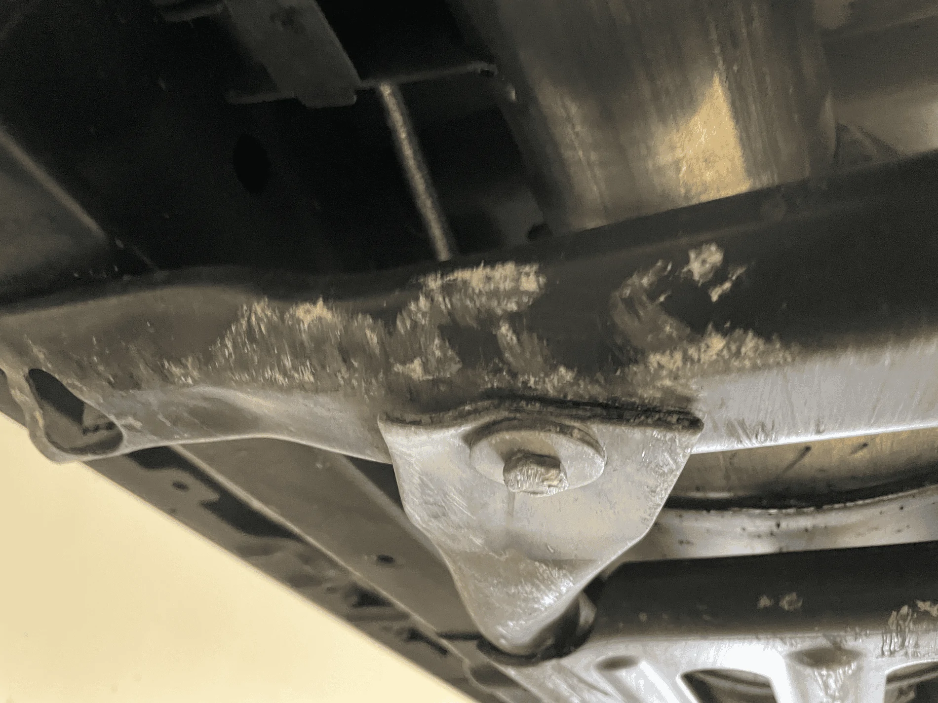

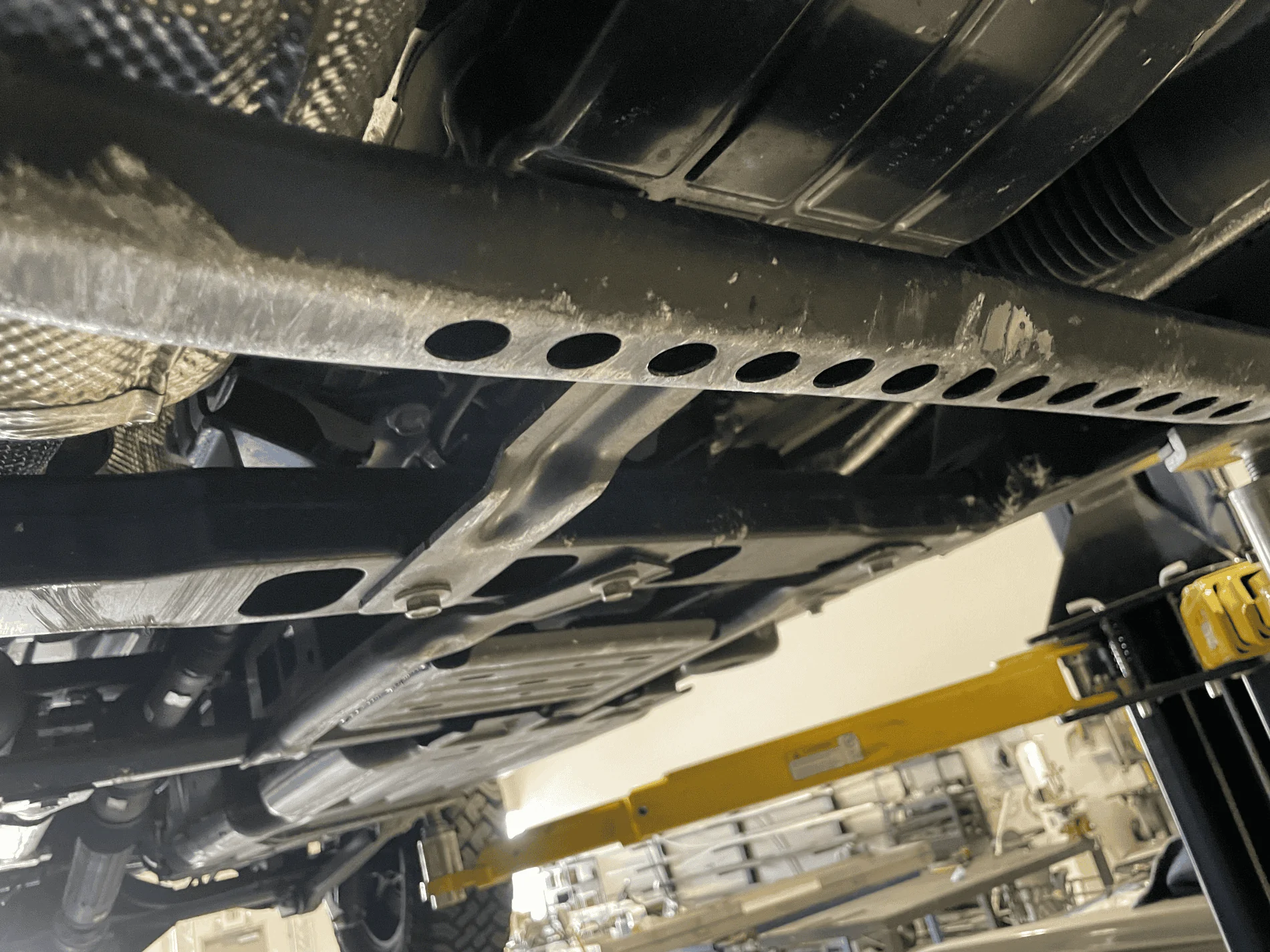

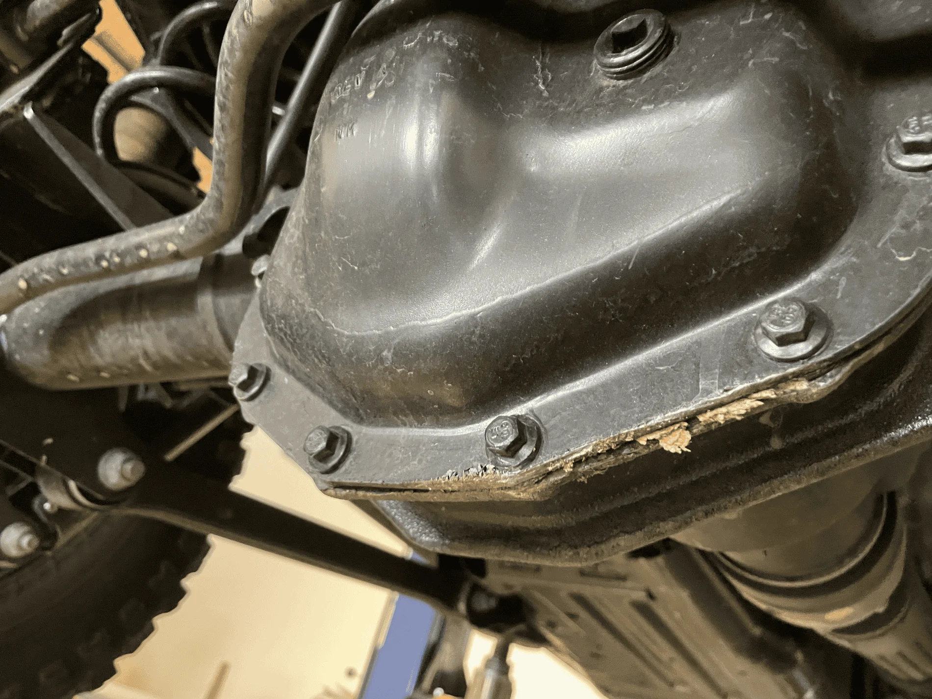

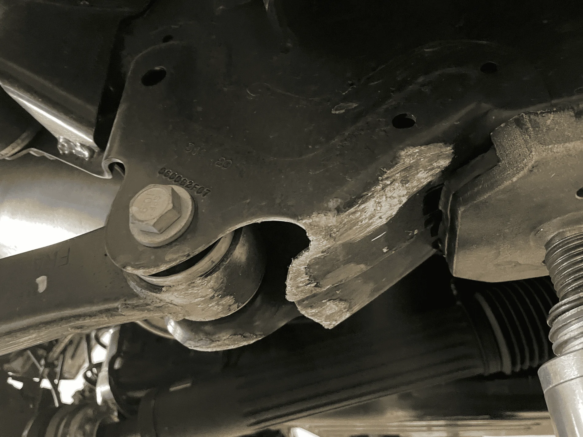

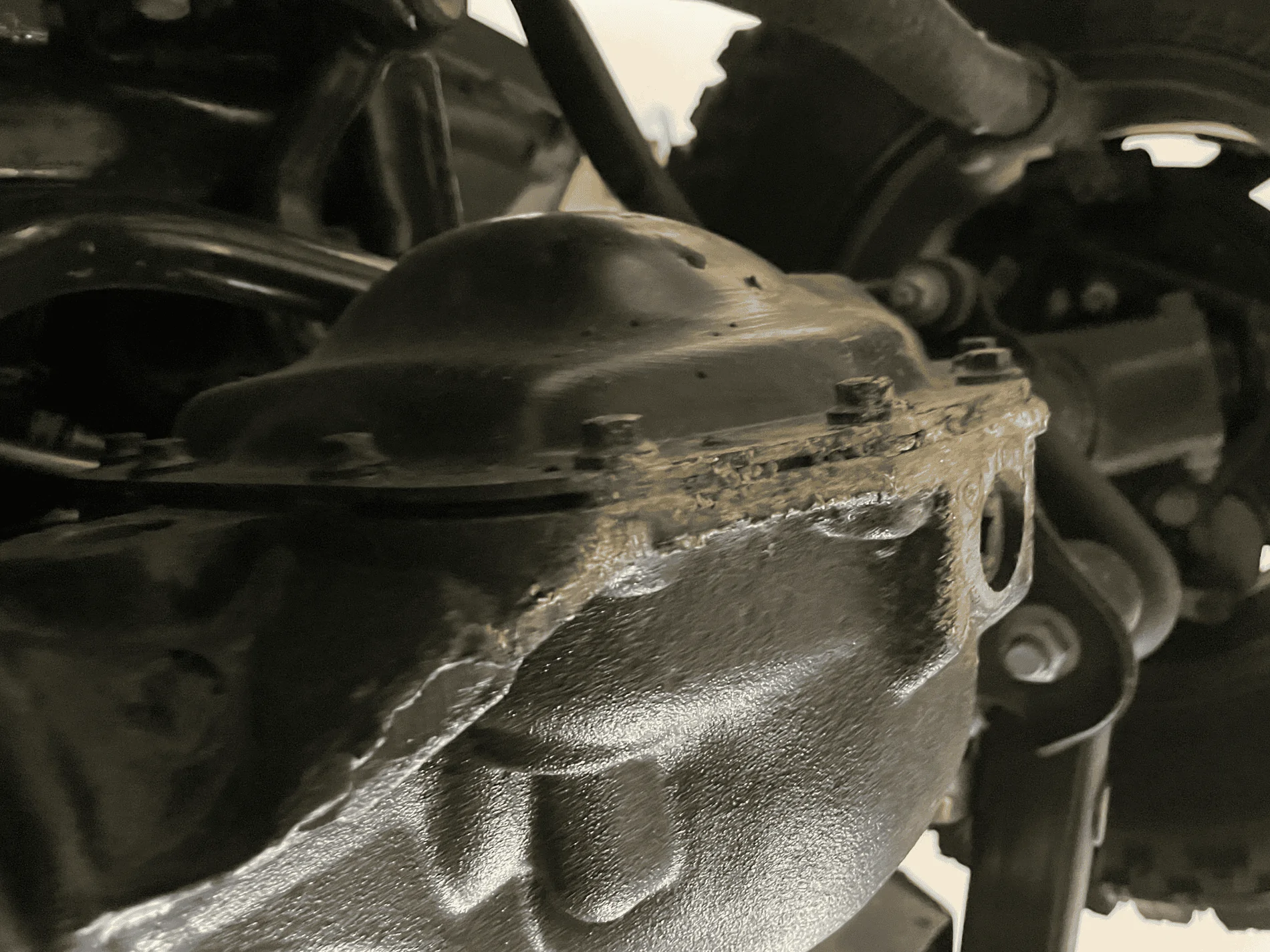

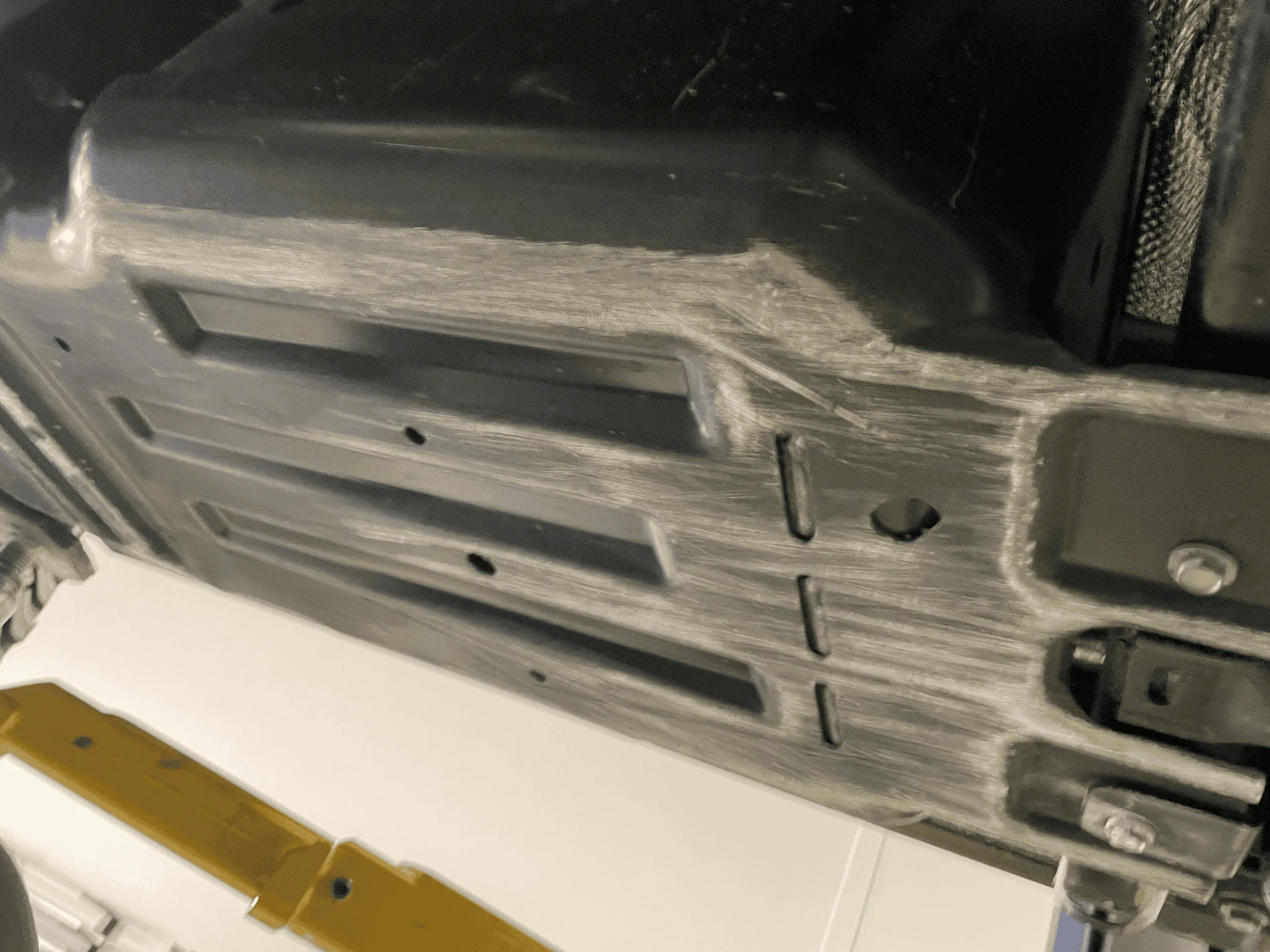

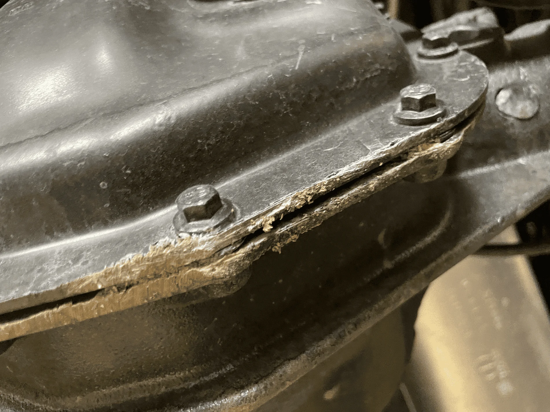

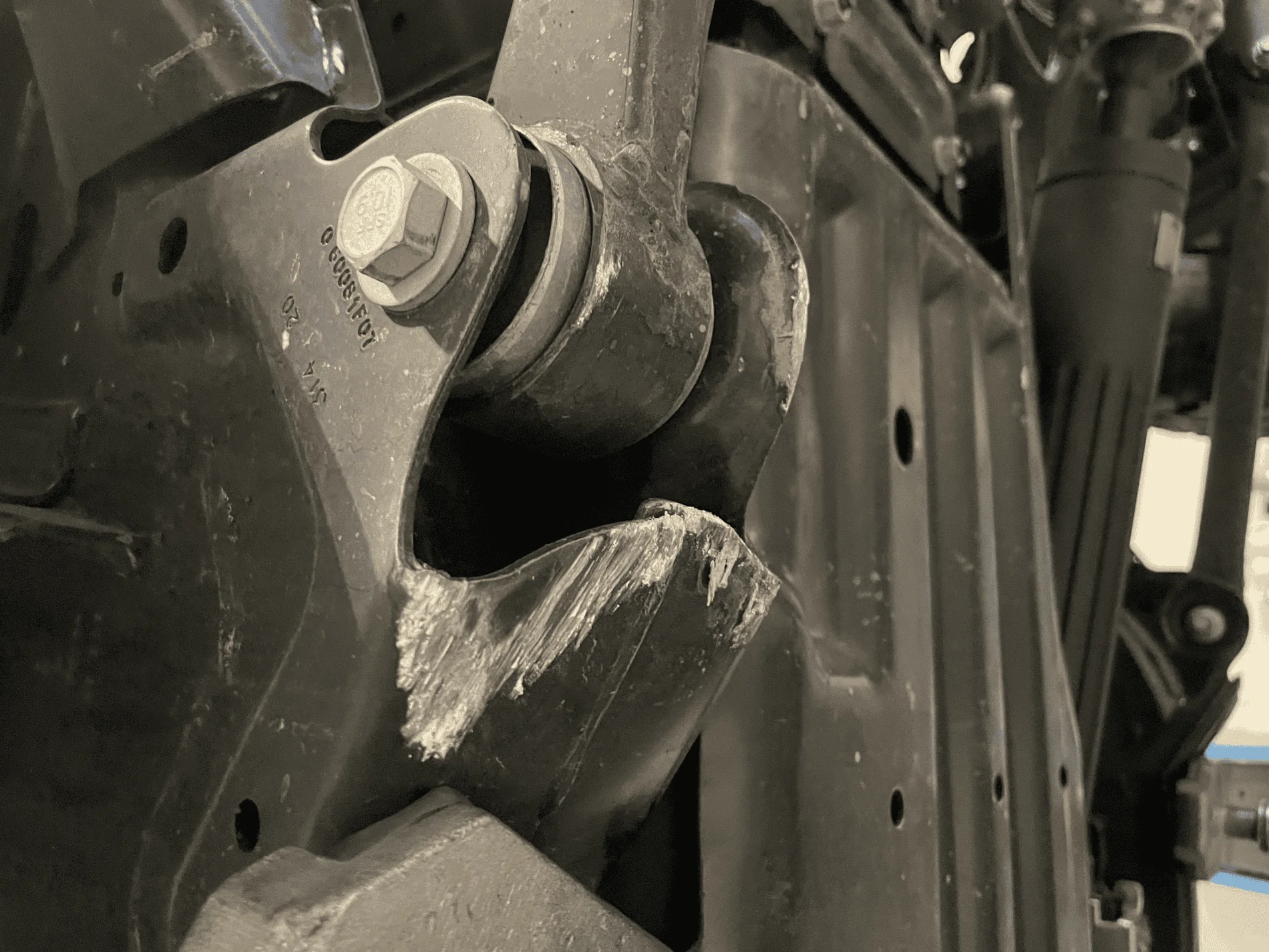

I just did Moonlight Madness up to Bald Mountain in my completely stock JTRD, but grew up wheeling in the Sierra Nevadas. I took all "easy" routes, and went slow. Had my whole family in the JT. Finally got it up on the lift yesterday to look at the carnage. I was pretty surprised how much carnage there was!!! Got an immediate approval from the boss (wife) for lift/tires, and probably going to look at differential armor as well.
The irony is that I had Rock Slide Engineering sliders but hadn't installed them, and the stock Rubicon sliders are the only thing that didn't get damaged?!?!

Is that 1st picture your gas tank skid plate? Does your Rubicon come with a skid plate for the oil pan and exhaust that crosses over behind the engine?
I guess I might keep my order for those Rock Hard Lower Control arm and shock skid plates after all. ?

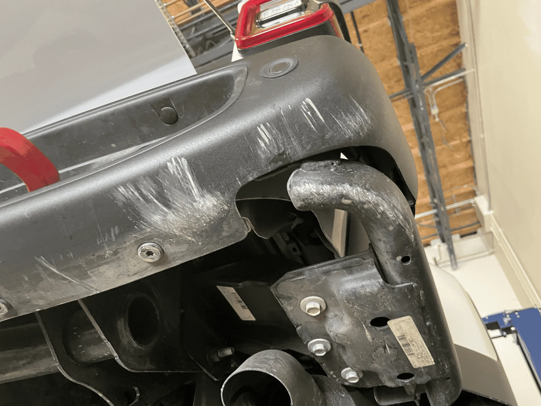

Glad that I am planning to add some rock sliders for the rear bumper too. I was considering a skid plate that goes into the hitch too, but it sort of has one built in already. What do you think?

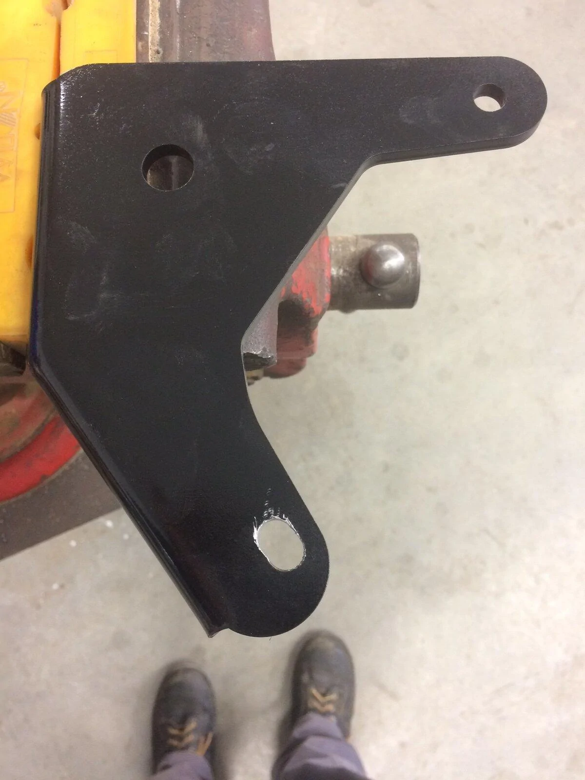

I just ordered Rusty's Rear lower control arm skids. Anyone install these yet? Looks like a challenge getting the nuts inside the frame for the two small bolts.
(stock photo)
https://www.jeepgladiatorforum.com/forum/threads/control-arm-bracket-protection.34641/post-628950
I had to ream out a hole so the bolts would line up (as many others have had to do) and I also am a bozo and had a hard time getting the control arm bolt back through.
I don't know about using the long needle nose pliers or something, but I don't think it was terribly difficult to drop the control arm, reach in and place the forward nut/bolt, then do the back ones.
Hopefully your holes line up better, and don't have trouble with the control arm.

need some LCA skids!
Yes- that was the gas tank skid. It also has a tubular guard for the exhaust/catyalytic which got smushed as well.
As far as sliders for the hitch/reciever, I don't think you'll actually damage >1/2" thick steel but a skid might help prevent hang-ups.

Lower front bolt first then upper while control arm is out of the way, then install the bolt. Many of us have had to elongate one hole, a few people actually only installed two bolts. Do one side at a time to help keep the rear end located. They take a ton of abuse!
So do you have a skid plate on your Rubicon that goes in front of the skid plate on the transfer case to protect the exhaust that crosses over behind the engine and also covers the oil pan?
I didn't think I would need to add anything to that hitch either.
DocMcStuffins
Feb 20, 2021
180
268
Central California
2021 Gladiator Rubicon Diesel
No- nothing in front. Oil pan is still exposed.
