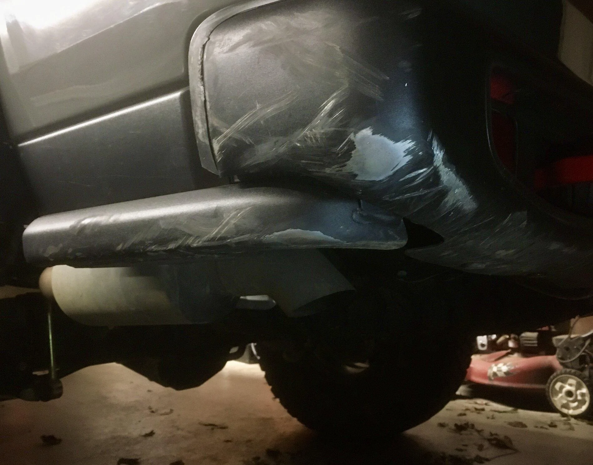

Have you had problems with the optional steel bumpers from the factory? I thought the rear bumper looked like it was mounted a little too close to the body, and that dropping down onto to it (coming down off a ledge) might lead to some body damage. The front bumper looks okay. Would like to hear what your experience has been. Getting ready to order...
I’ve found the the Rubicon rear bumper and bed rock sliders sufficient, although I’ve really scraped them up, and dented the bottom a bit. I have a stubby front bumper from my old JK on the front, with the stock steel front skid plate. I’ve also hit that pretty hard and am impressed with its strength, but it does hang down just a bit more than I would prefer.
