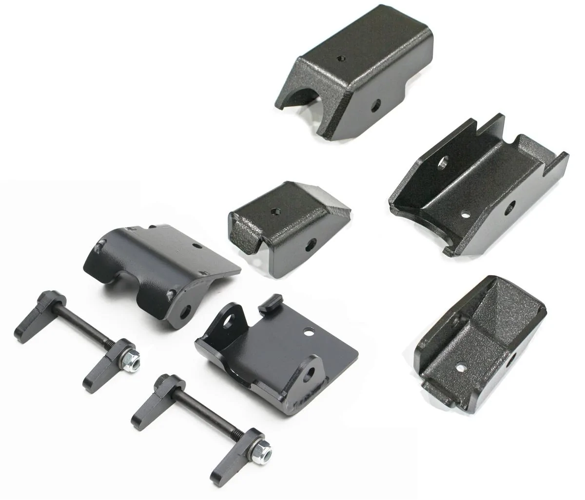

Has anyone used the Rock Hard front and rear lower control arm skid plates? I have a set on back order from Extreme Terrain that I just need by early October.
Jeep Gladiator At what point are additional skids needed? RH-80515-2T

Yes, good kit but the shock skids need longer bolts.
I also had to "edit" the plates that go on the rear axle, but not everyone seems to have that issue.
Have a scrape on the driver side front arm plate, nothing else yet.
DEFINITELY get the Rusty's too for the frame side rear mounts, lots of scrapes on those.

I had off-road Wherehouse install the full set, including frame mounted skid plates. They said everything fit good. Rock hard off-road is a good company
The amount of Jeep aftermarket parts that have to be altered to fit is mind blowing. I think the fact that so many of us "make it work" is why these companies don't fix the problems. But any of us planning on off-roading need them and are going to be inclined to make them work, I reckon.

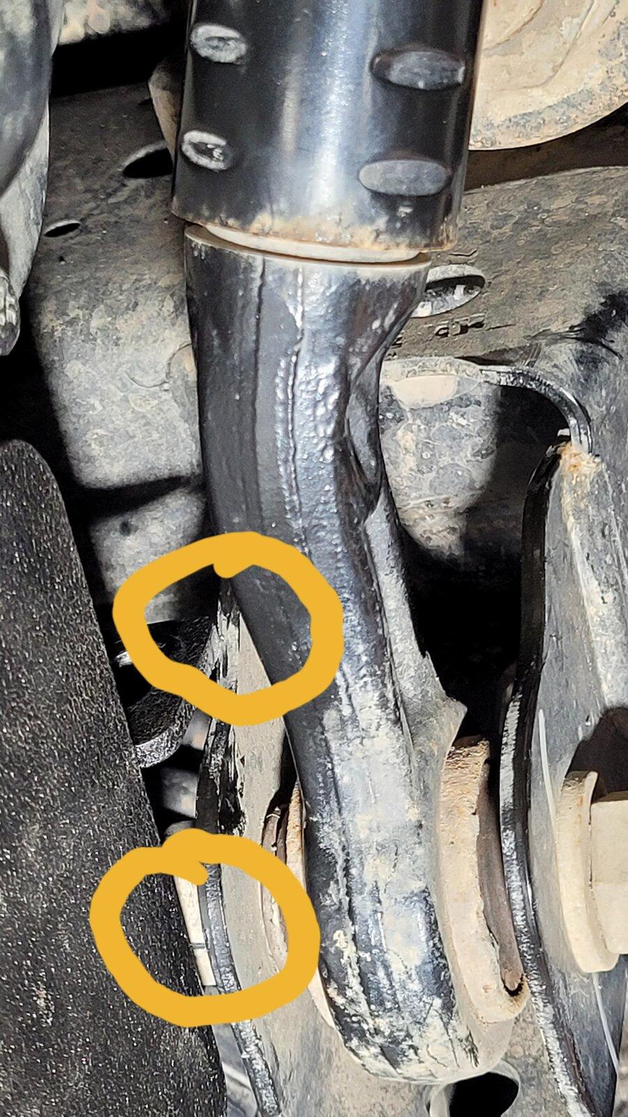

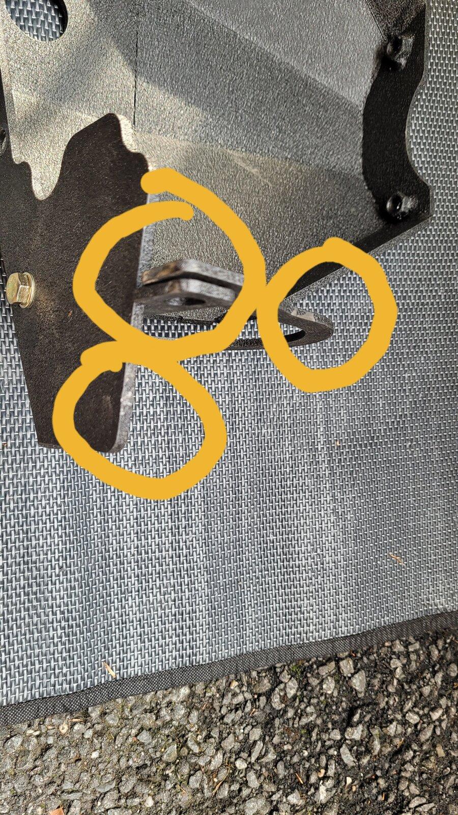

Keep away from the DV8 front differential skid plate. Absolute garbage design. It clunks and makes contact just going over minor seams on paved roads. I called DV8 and they just told me to put rubber over the areas that make contact?!? I cannot imagine the damage this would do if you actually took it off road. Extreme Terrain was great about returning it though and we talked about other options.
Unfortunately, Extreme Terrain said that the Rancho differential skid plates are only designed for the Rubicon. So it looks like there are no differential skid plate options for the other JT models at the moment. (I have an 80th anniversary.)
I think I might get the Rock Hard Front & Rear LCA skid plates for a trip with Jeep Adventure Academy to the Badlands in Indiana in October.
I bought the DV8 front skid plate, I had the same issues you mentioned, but I was able to dremel away enough material, all on the driver side, where the left retaining strap interferes with the frame side track bar mount and the top part of the plate hits the bolt holding the track bar bolt.
For a lifted JT this is probably not an issue, but for my stock 80th Anniversary it is a problem.
