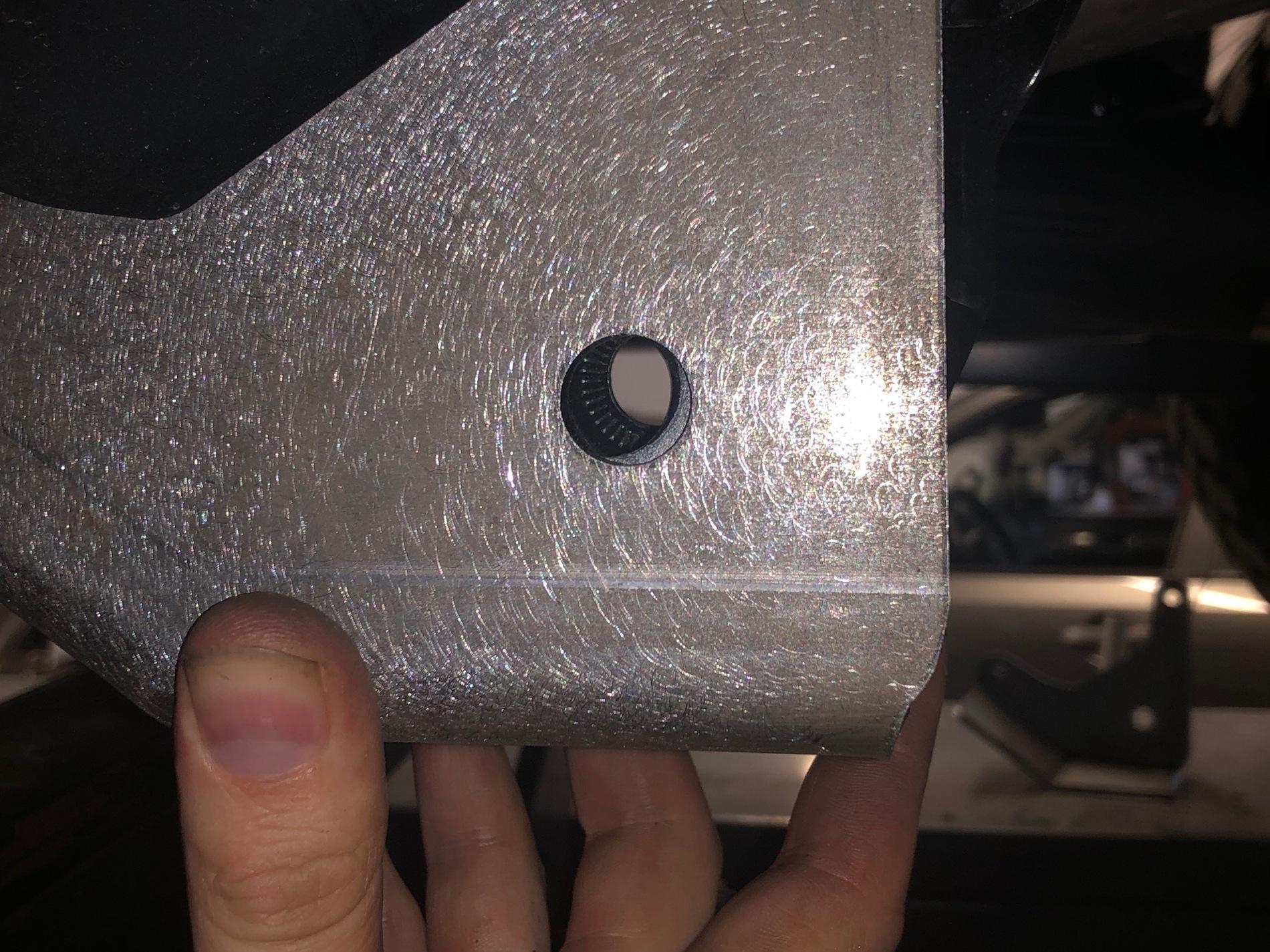

Ain't that the truth! I got the front diff skid from Rancho and the U bolt was too short, and then my skid from Rustys was so off-center I couldn't get the side bolt through. Matt from Rancho mailed another U bolt out, which I should have time to try tomorrow. But my guess is they keep making them this way because Jeep folks are inclined to modify if needed and make them work. Maddening.

Off center hole:

I was interested in the Rancho skids too, but was told that they only fit the Rubicon with their wider axles. I'm not sure what is different on the Rubicon differential as far as fitment goes.
I'm trying my Rancho again tomorrow (got the rear diff set too) but supposedly they fit all Gladiators (out side of the part where they send too short of U bolts, etc.). I'll update whether I can make them go or not. I'm going to be irked if they won't.

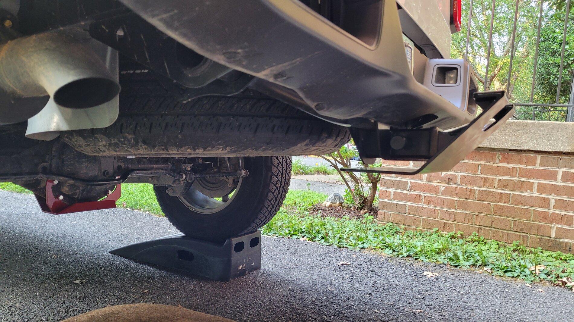

Jeep Gladiator At what point are additional skids needed? 20210805_183347
Jeep Gladiator At what point are additional skids needed? 20210805_183426
Body Armor Backbone in the hitch receiver + Rancho rear differential skid plate. No issues on my 80th anniversary edition (a fancy Sport S).

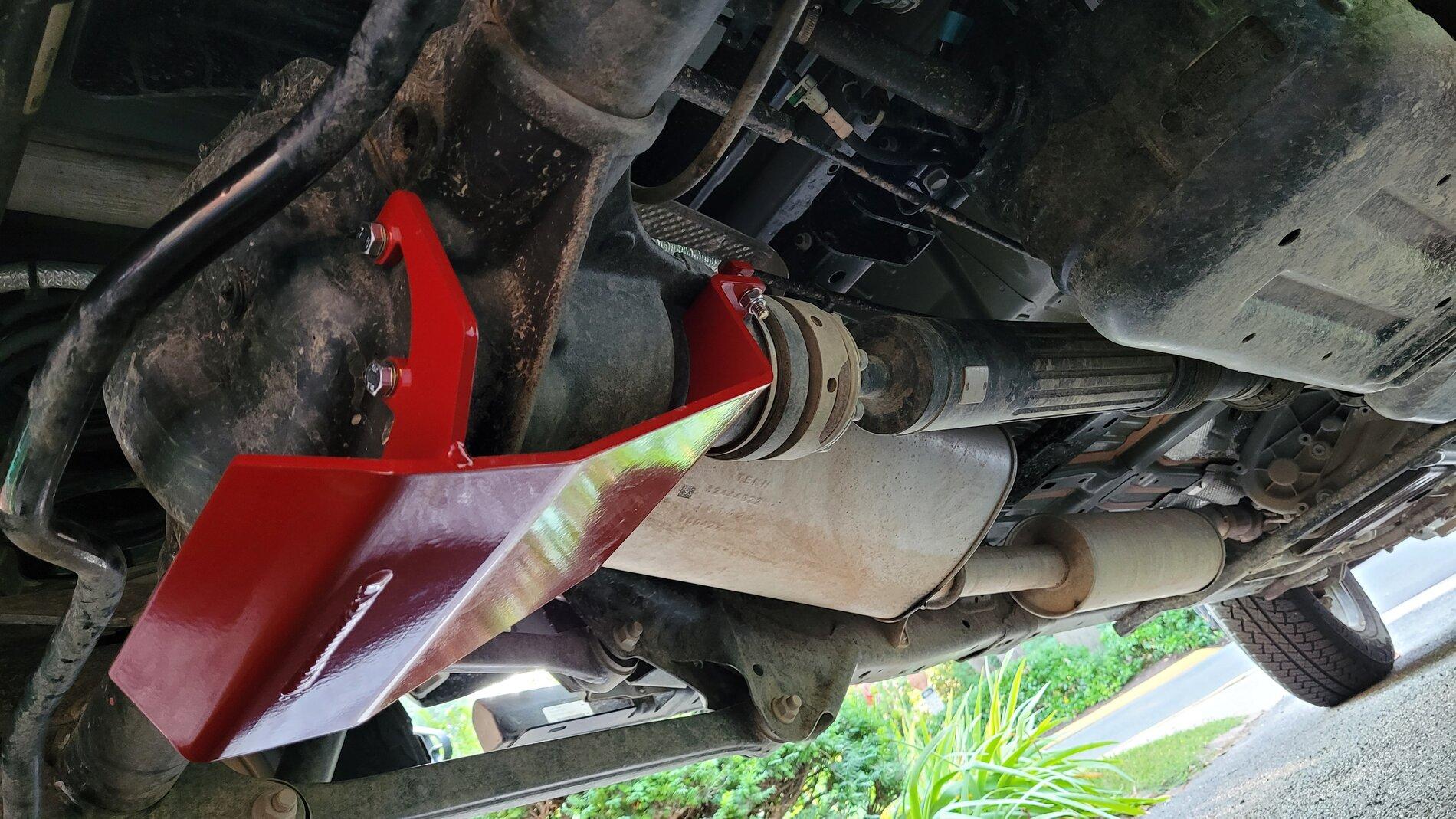

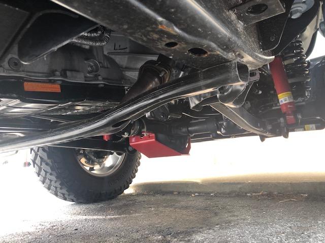

Okay, got them on my truck so I can confirm they fit with the longer U bolt. I have an auto mechanic in my shopping center where I work whose lift I wanted to use, but for liability sake, he just put them on for me. I assume they went on without a hitch because I had the truck back in about 20 minutes.
I have the same problem w/ the front Rancho diff cover. I emailed their tech support today and they told me it would be at least 2 months to get longer u-bolts. I guess I'll have to go to the hardware store to see if there's anything that comes close to what I need.
