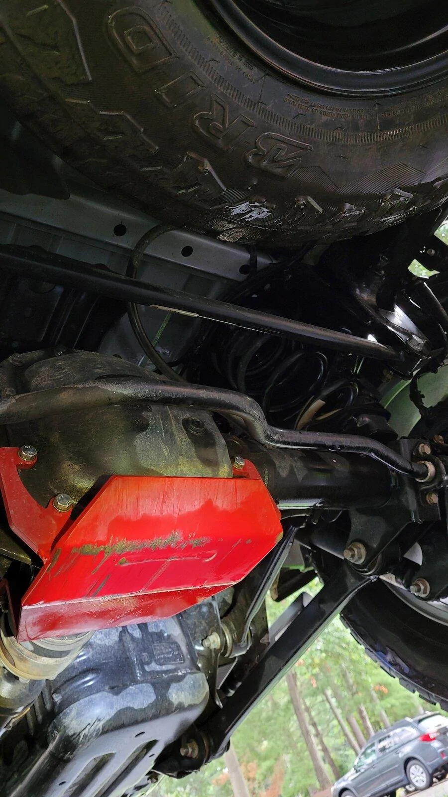

No leaks when I did the rear diff skid plate.
Am I seeing that right that you need to pull a few of the bolts out of the differential cover to mount the skid plate?

Well, that is really good news. Those Extreme Terrain guys don't know what they are talking about. It looks like part of the skid plates require you to remove bolts from the diff cover and re-use them. Does any oil leak out or do you have to reseal or drain the fluid?
4 bolts, 2 on the left 2 on the right of the bottom 2 which are not touched.

Does anyone have the torque spec on the differential bolts you have to remove to install the Rancho front and rear differential skid plates? Thanks!

It's in the instructions, I think 20 ft-lbs.

This past weekend at Rausch Creek I hit every stock skid plate plus the rear diff and hitch skid plates I bought. Frame side lower control arm mounts took a beating, rusty's skid plates next on my list.
