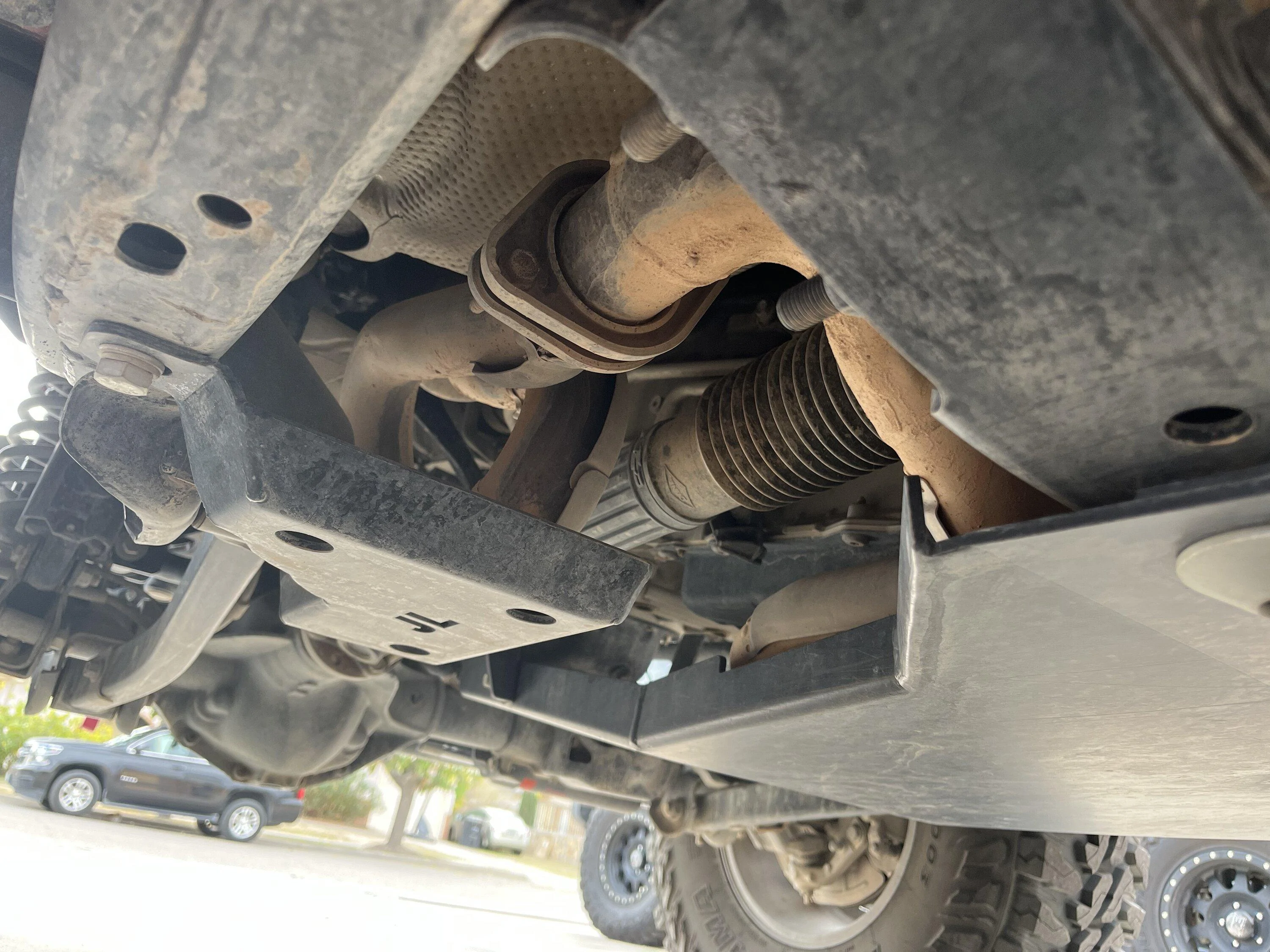

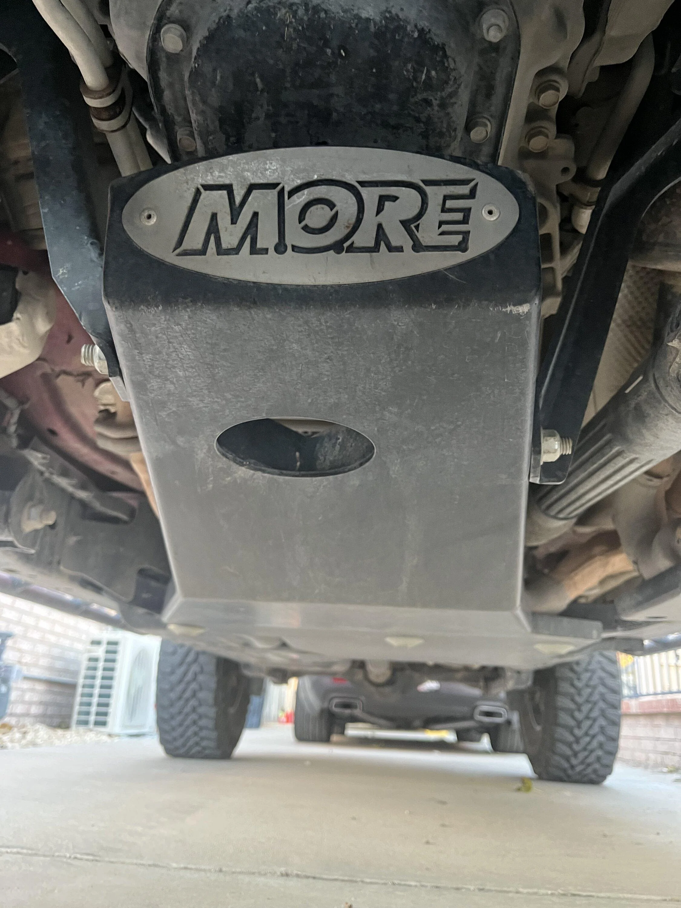

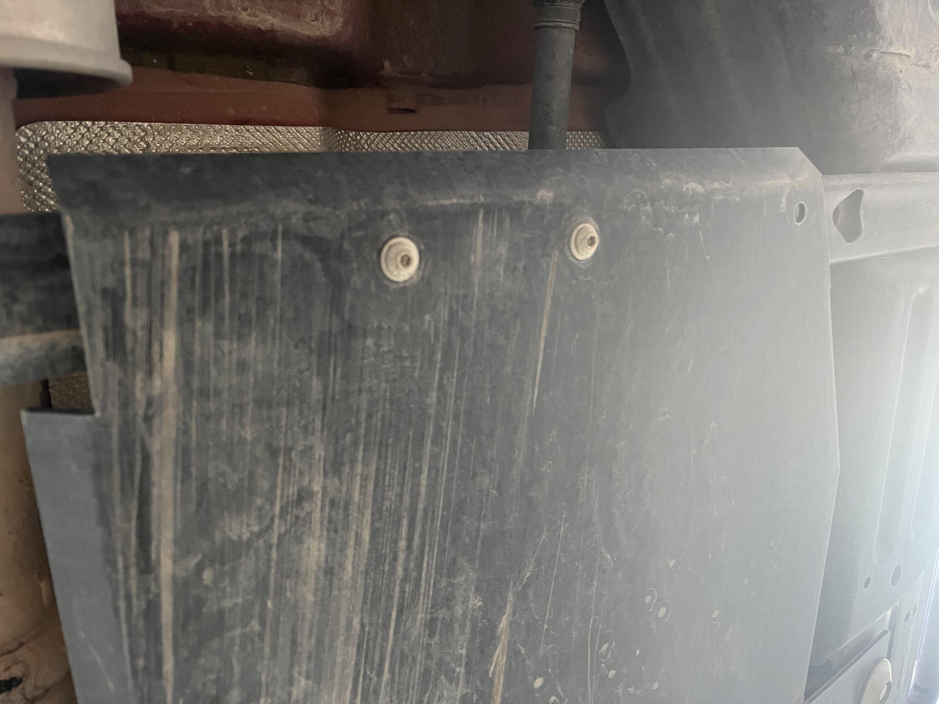

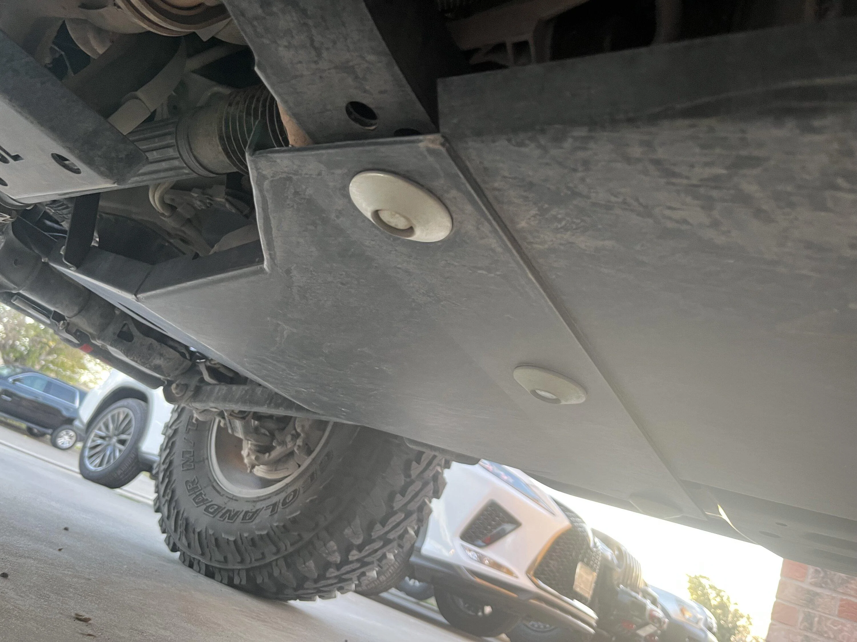

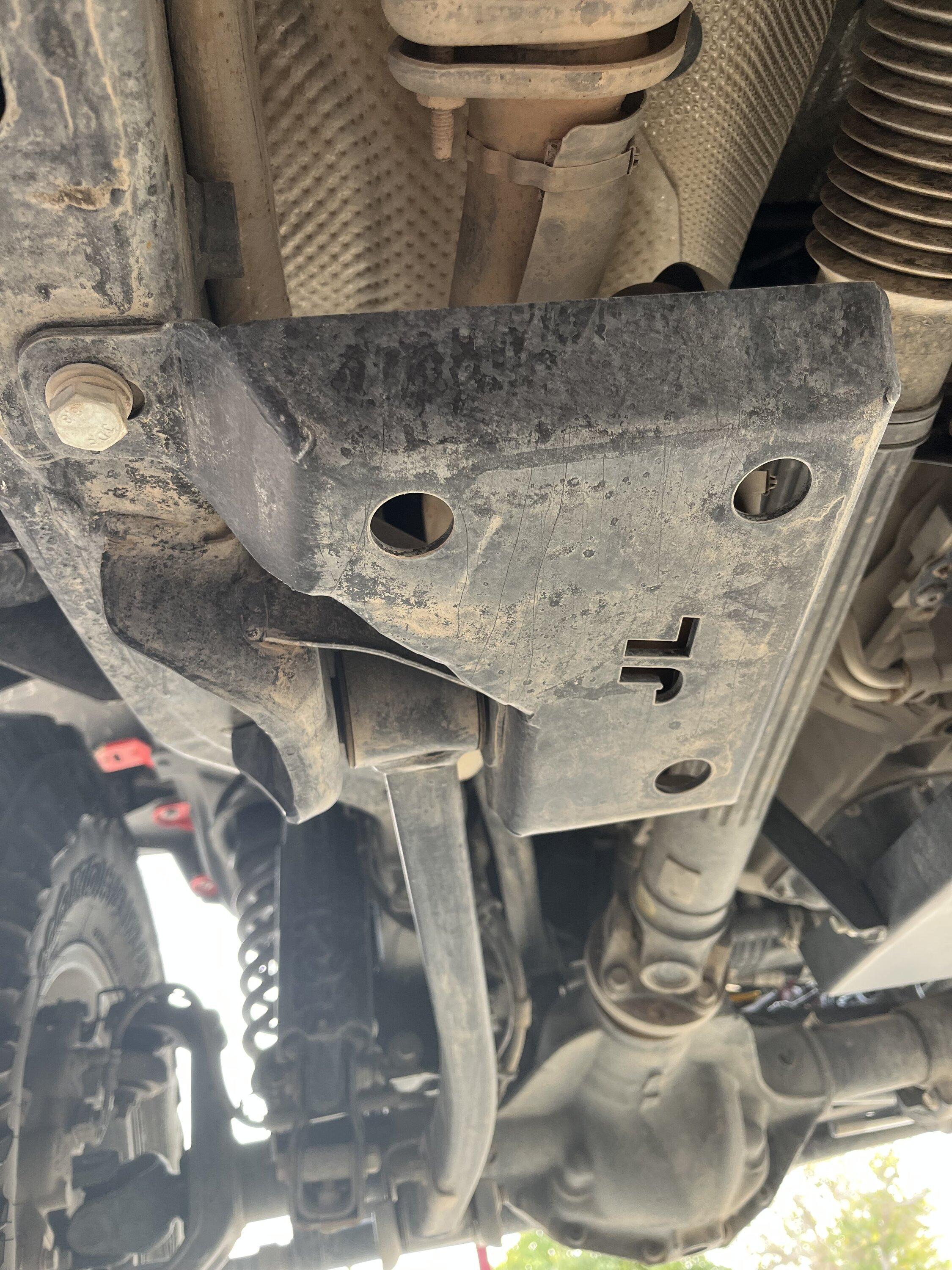

One little problem with the Skid Row exhaust loop skid is it requires you to remove the “cross arm” that protects the transmission oil pan and can not be put back on. That sorta sucks, also that I didn’t read installation instructions when ordering sucks more. I’m going to try and modify the skid to bolt onto the cross member as I would like it, if it doesn’t work it will get recycled in the scrap bin….Jack
Another option is to go in and get a engine/transmission skid plate like the ones that M.O.R.E makes. This helps protect the transmission lines that hang low and can get caught on tree branches.
I went for the Engine + Transfer case skid paired with the Skid Row Exhaust plate (JL version was $20 cheaper ?) and I'm very happy with them, engine skid already saved my bacon when I bottomed out in a mud pit a while back, took the hit right were the transmission valve body is located. Would have destroyed my transmission otherwise.
Just get something like the Fumoto valve for oil changes, I learned that the oil WILL splash all over the skid plate and you'll want something you can attach a hose too for mess free changes.
Jeep Gladiator What Skids Are Necessary? “Can of Worms” Thread IMG_5592
Jeep Gladiator What Skids Are Necessary? “Can of Worms” Thread IMG_5595
Jeep Gladiator What Skids Are Necessary? “Can of Worms” Thread IMG_5633

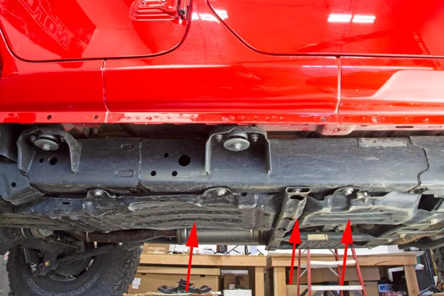

Both the Artec skids and the Rock Hard 4x4 skids have been very popular here.
This is the Gladiator forum, but the skids are very similar on the Wrangler JL and that is the one we have the best pics of after a week in Moab and this JL even had 37s on it:
That wasn't from thrashing on them, that was doing the challenging trails and sliding along the rocks. So when we got back, we swapped in the Artec Belly pan system (the only one available back then).

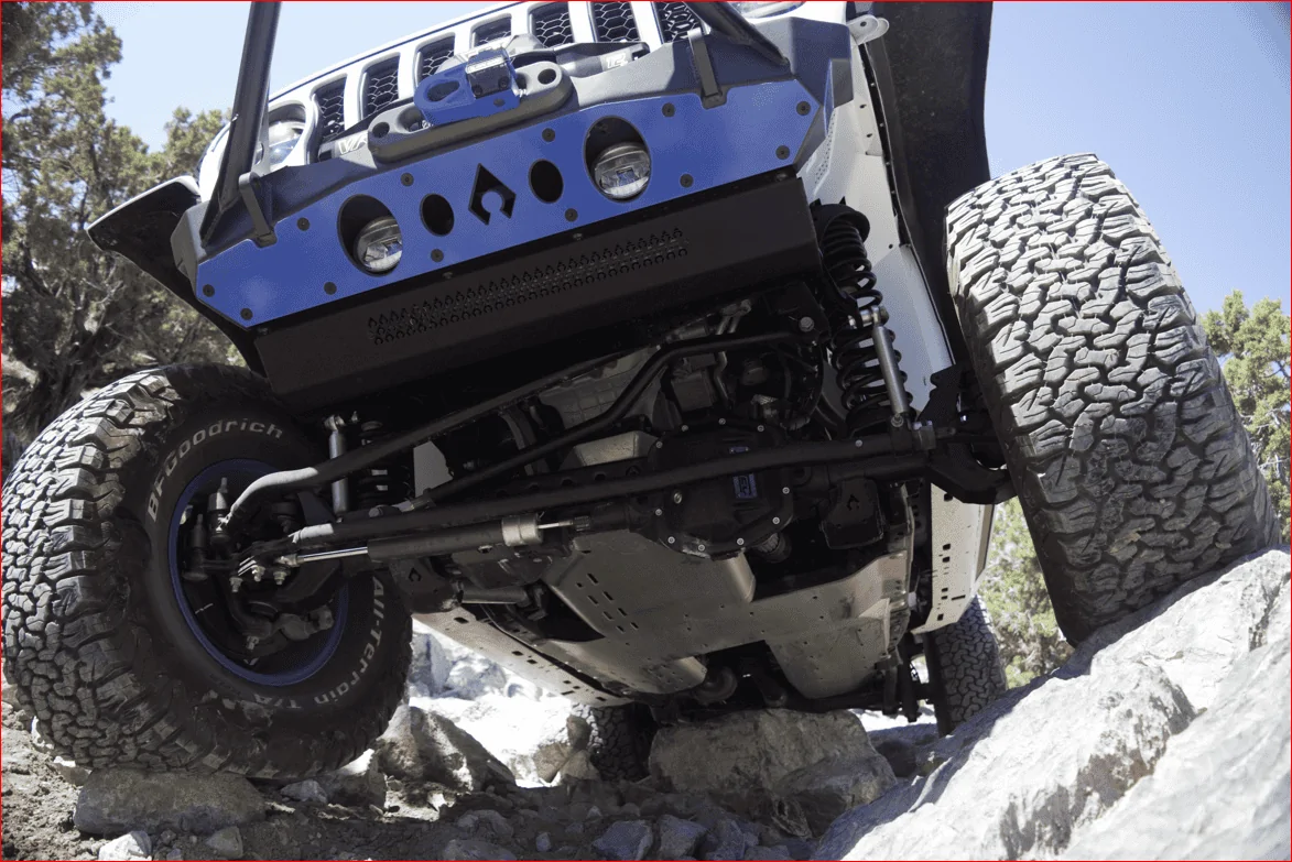

Alright, so does anyone have any of these skids on a Sport S Ecodiesel? Preferably the Asfir ones. Or any of the aluminum diesel versions. Asfir states it's tested on a Rubicon. Are the Sport S Ecodiesels the same?
The Artec Diesel skids work on all Diesel JT's the t case and axle are different in the Rubi vs the sports We have had this one all over Moab, Sand Hollow, and other local trails with zero issues
Jeep Gladiator What Skids Are Necessary? “Can of Worms” Thread 1667935133928

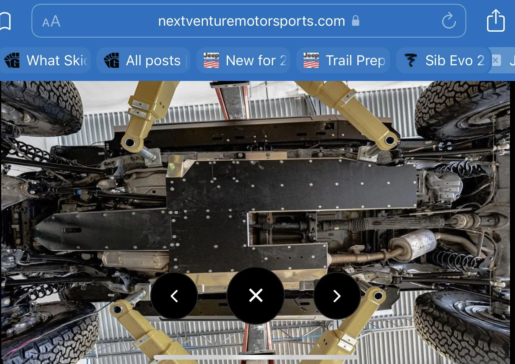

I have the gasser, but have the next venture aluminum belly skid. I can personally attest to their quality. In fact, their diesel version protects the muffler as well. I’m a bit jealous.
This image is of a diesel with the UHMW option, so you can see coverage.
