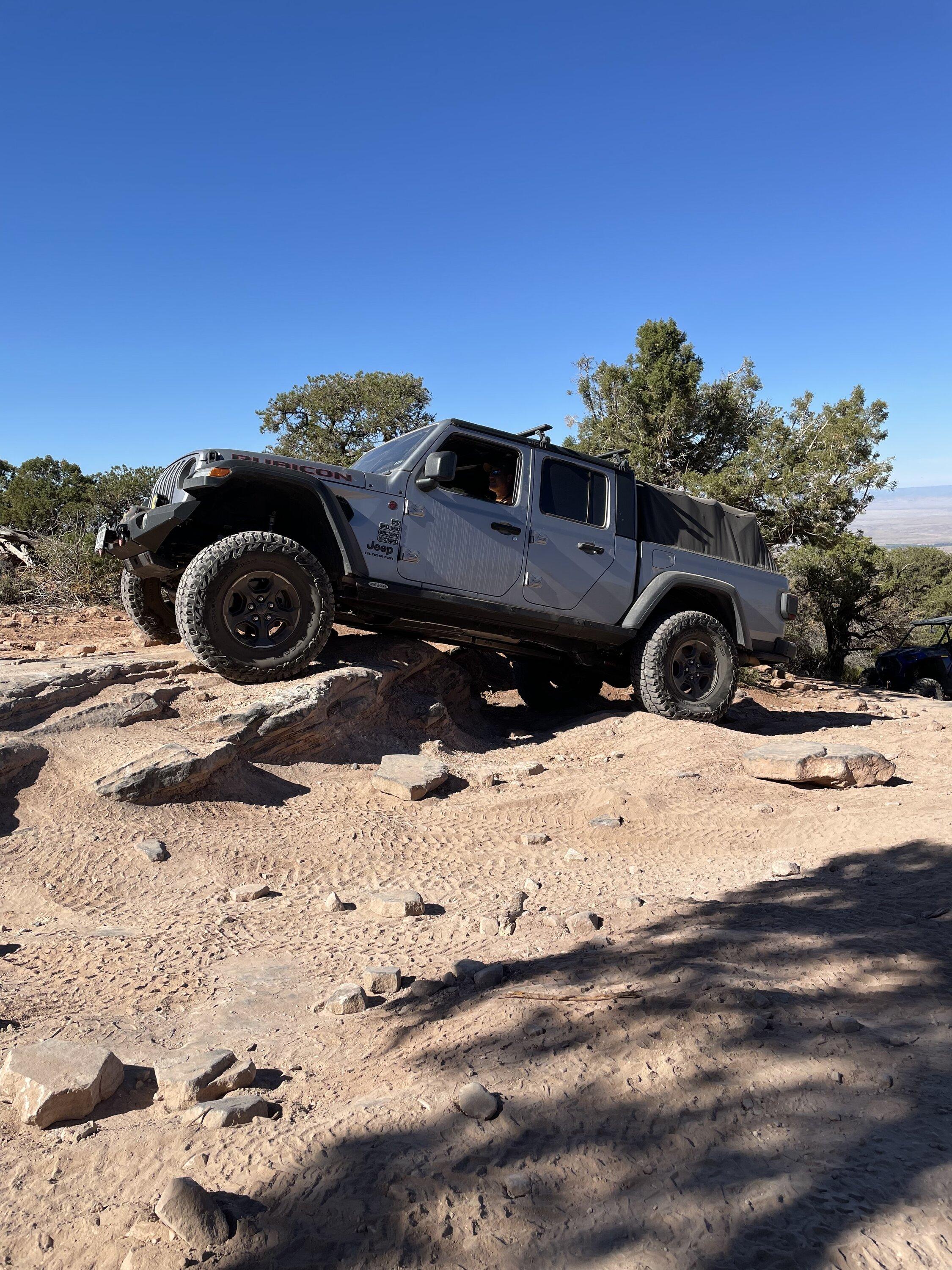

I added a diff skid and LCA frame side skids to my JT just because it's so long, but for what it's worth I beat the everloving crap out of the stock skids on my JKUR and never had any issues. They are a lot more durable than people think as long as you are mindful of low hanging objects (mainly trans cooler line). Here's a pic after my last trip out to Moab.

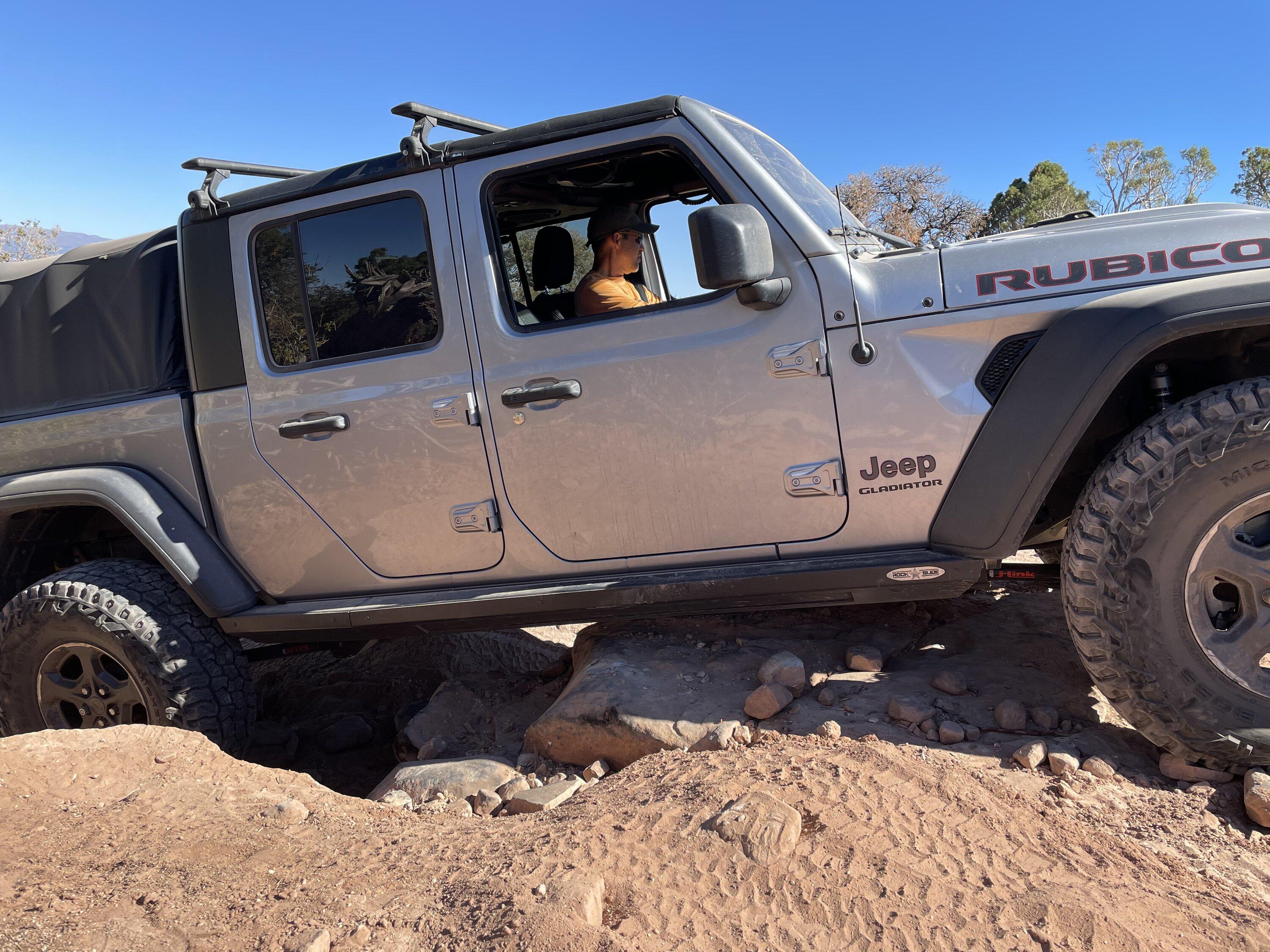

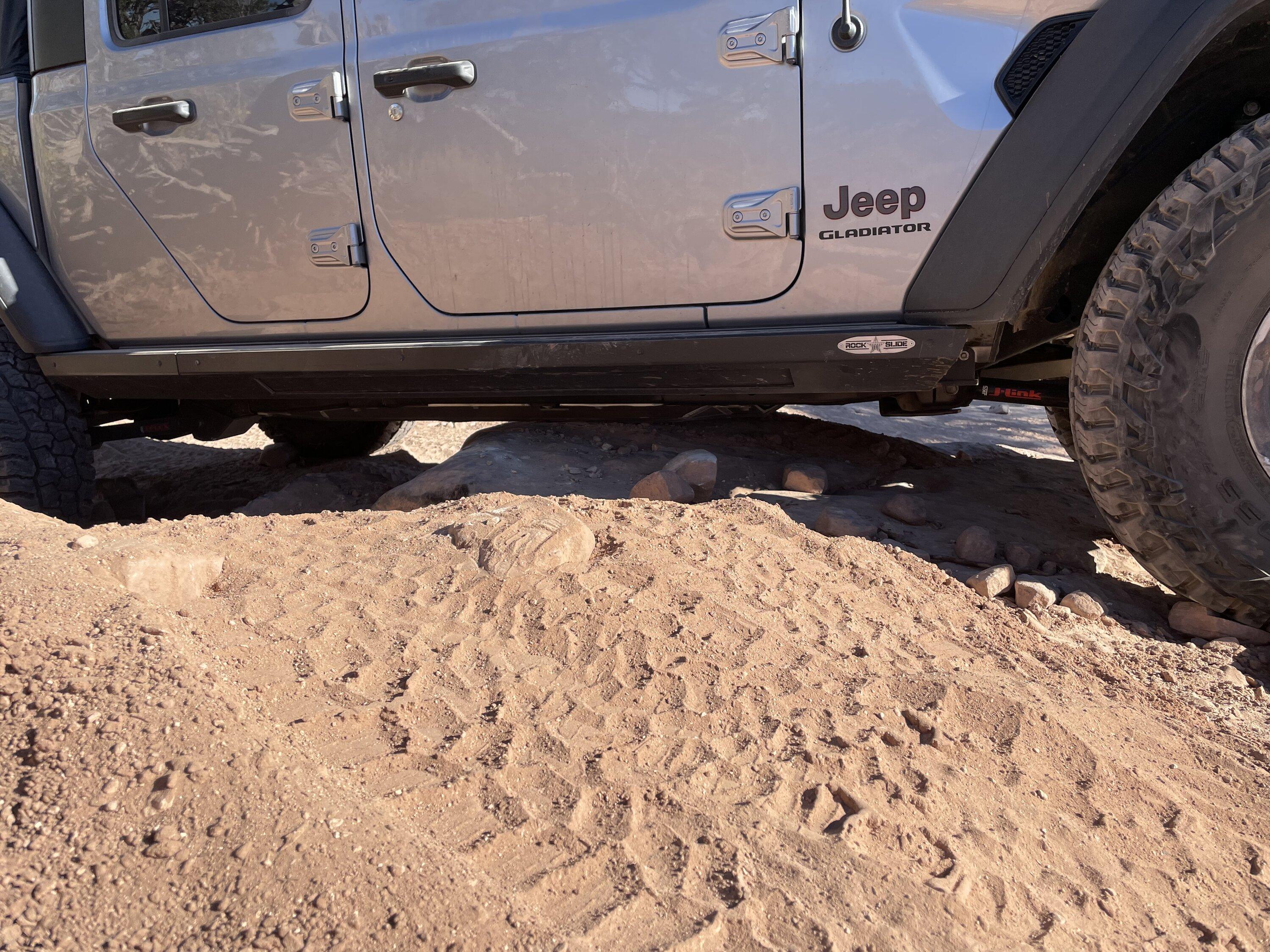

Absolutely. Just left Moab and let my friend drive for many of the tough obstacles. When the occasional scraping noises started, I was able to relaxingly say, “it’s fine, just skids”. :)
