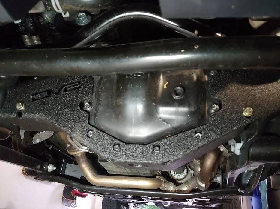

Keep away from the DV8 front differential skid plate. Absolute garbage design. It clunks and makes contact just going over minor seams on paved roads. I called DV8 and they just told me to put rubber over the areas that make contact?!? I cannot imagine the damage this would do if you actually took it off road. Extreme Terrain was great about returning it though and we talked about other options.

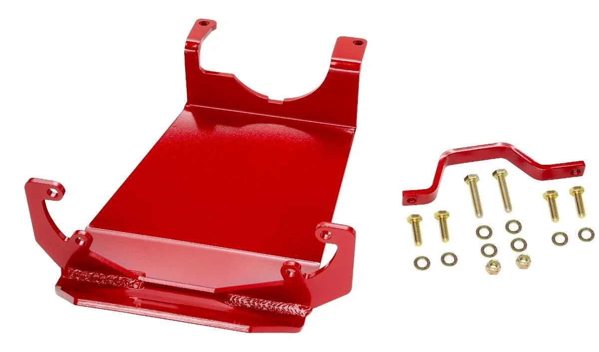

Jeep Gladiator At what point are additional skids needed? DV8 installed
Unfortunately, Extreme Terrain said that the Rancho differential skid plates are only designed for the Rubicon. So it looks like there are no differential skid plate options for the other JT models at the moment. (I have an 80th anniversary.)
Jeep Gladiator At what point are additional skids needed? Rancho

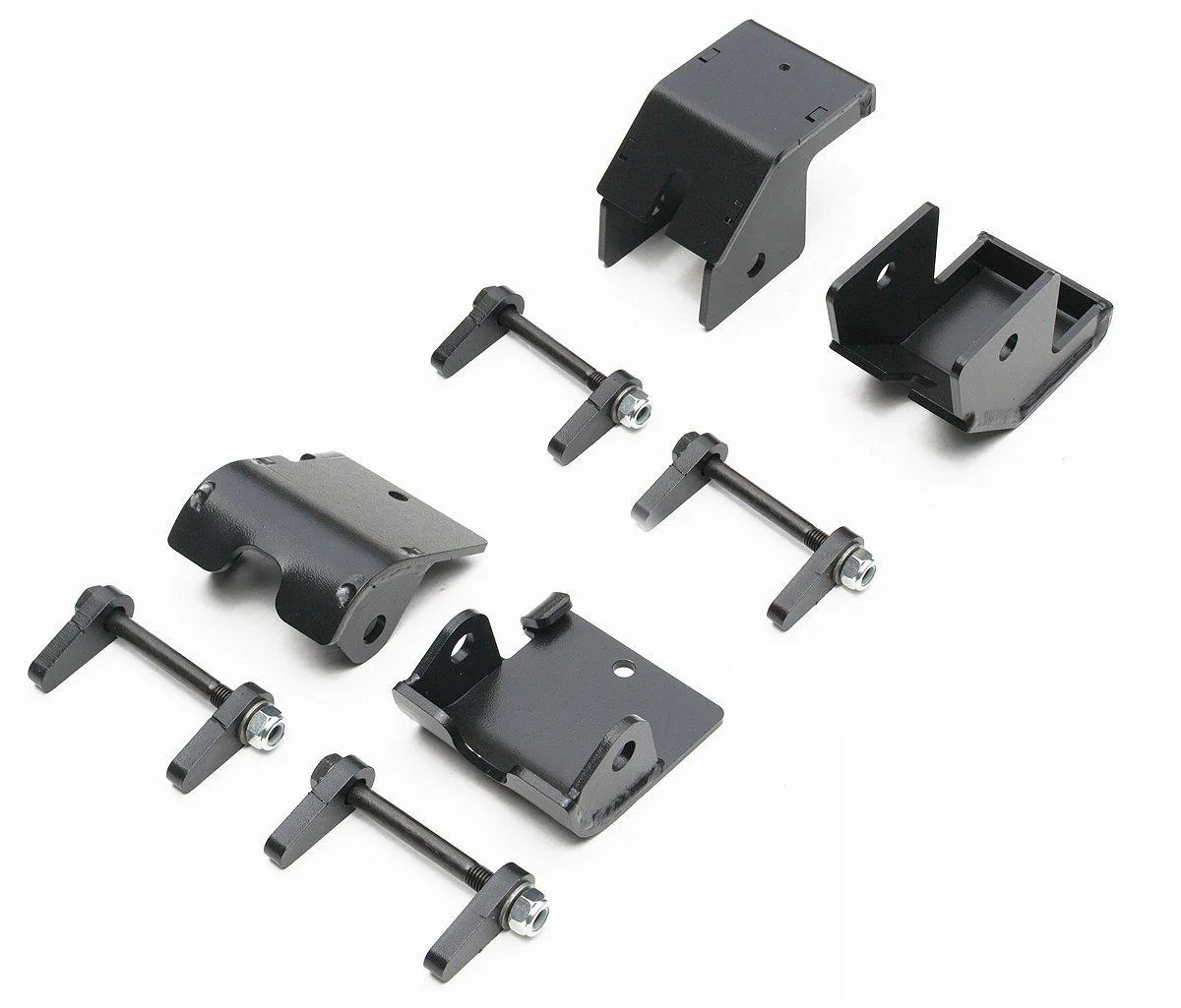

I think I might get the Rock Hard Front & Rear LCA skid plates for a trip with Jeep Adventure Academy to the Badlands in Indiana in October.
Jeep Gladiator At what point are additional skids needed? rockhard-4x4-front-rear-lower-control-arm-skid-plate-jl-rh-90515_0

I agree completely. I thought this would be much easier. The DV8 skid plate was packaged really well and the skid plate itself looks very durable. It is the U-shaped mounts that go over the axle housing that are the issue. Terrible engineering. I had a bad feeling installing it that I would soon be removing it just based on the huge amount of articulation built into our suspensions. Sure enough, the first seem in the road I drove over I thought I had a flat tire with how loud the impact was. ?

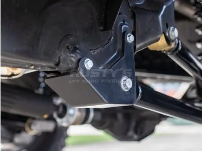

I just ordered Rusty's Rear lower control arm skids. Anyone install these yet? Looks like a challenge getting the nuts inside the frame for the two small bolts.
(stock photo)
Jeep Gladiator At what point are additional skids needed? ra-js5590-jt-installed-2-wm-

I ordered the Rock Hard Lower Control Arm and shock skid plate set (incorrect picture). Sounds like I will need to pick up longer bolts for the shocks?

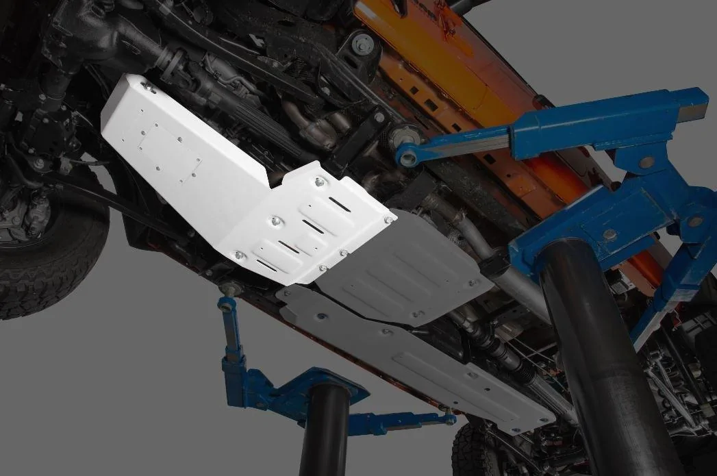

I am also considering the Quadratec aluminum oil pan/transmission skid plate. Anyone try this out yet?
Jeep Gladiator At what point are additional skids needed? quadratec-eng-trans-skid-plate-3.6l-jt-main

I talked to Rusty today to get his take on this. He said they used a long needle nose pliers to hold the nut back there. Said its not super easy, but "doable".

I think it would be tough to hit the oil pan since it is much higher up than the front differential and tucked right behind it. The exhaust pipe that goes right in front of the cross member looks pretty exposed though. I am starting to think the Quadratec oil pan/transmission skid plate might be a good idea.
