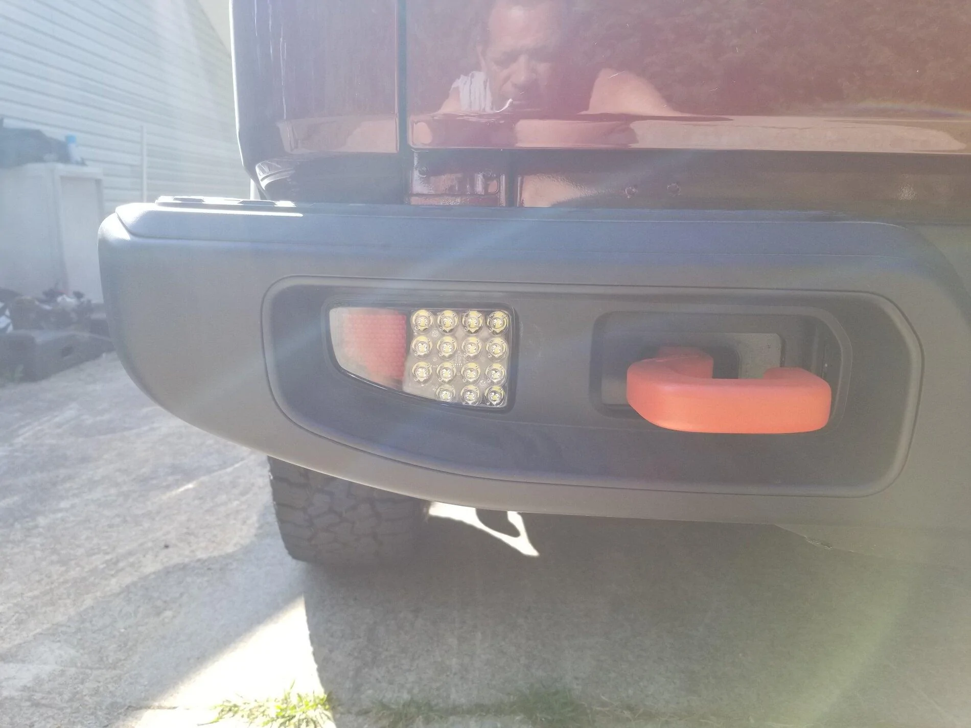

Received mine today. Harness was in a ups envelope taped to the actual lights (which were delivered via usps)
Install was fairly simple with 2 issues explained below

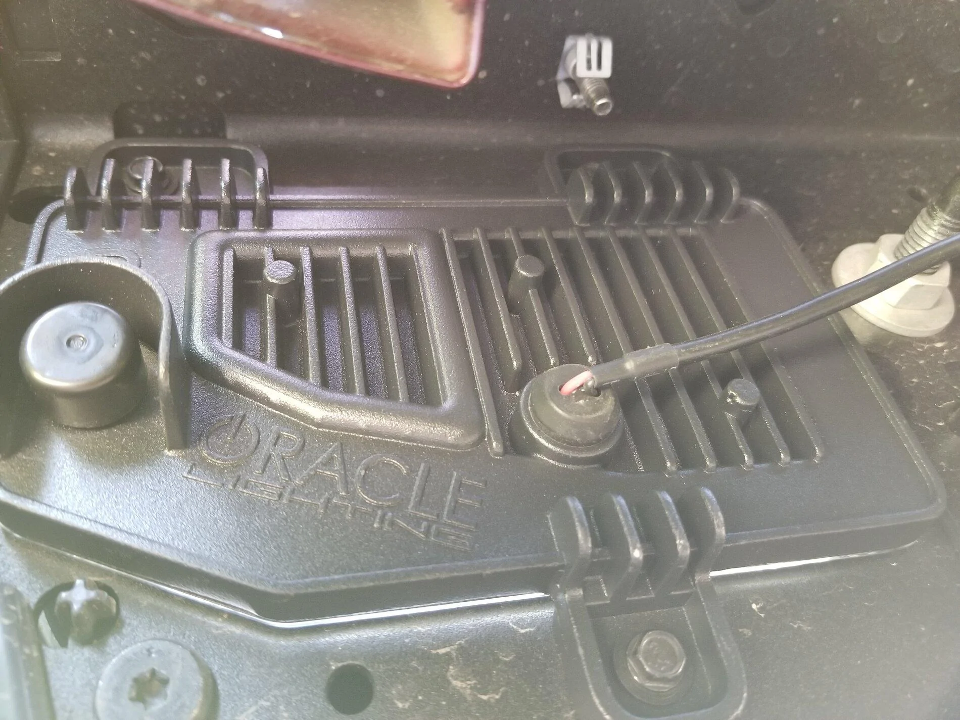

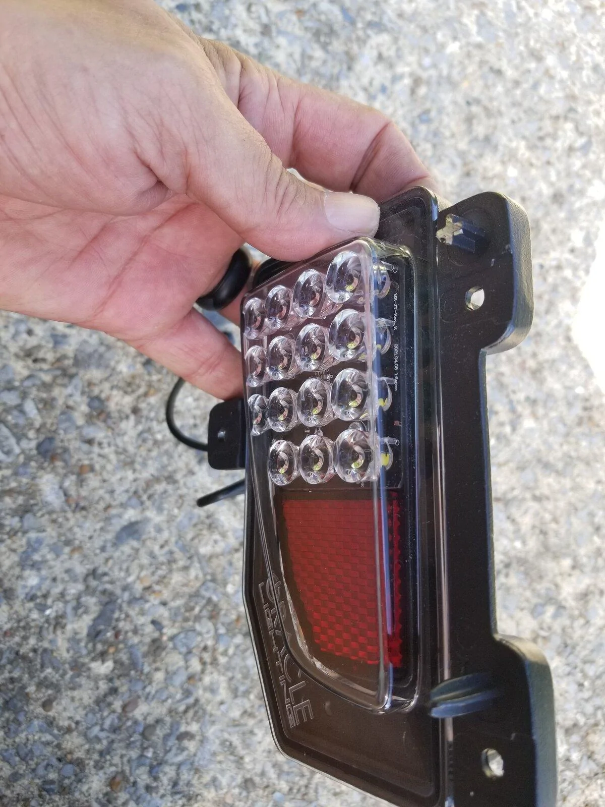

Issue 1: I have a 21 Mojave. There's a bolt coming through the bumper which effects being able to use the alignment posts on the lights. Didn't spend much time trying to determine how to remove the bolt and just cut off half of the guide pin and fit fine.
Issue 2. There seems to be only 1 way to run the harness wire from the drivers taillight to the passenger side reverse light where it's long enough. If you run into issues, let me know and I'll try explaining

This is the bolt extending through the bumper that gets in the way (silver bolt above the light

My modification was to dremel about 1/2" of that post off

Overall, very happy with the lights. Very well built and the 1st install issue isn't on Oracle. However, another 6-12 inches of wire on the pnp harness would be awesome!
