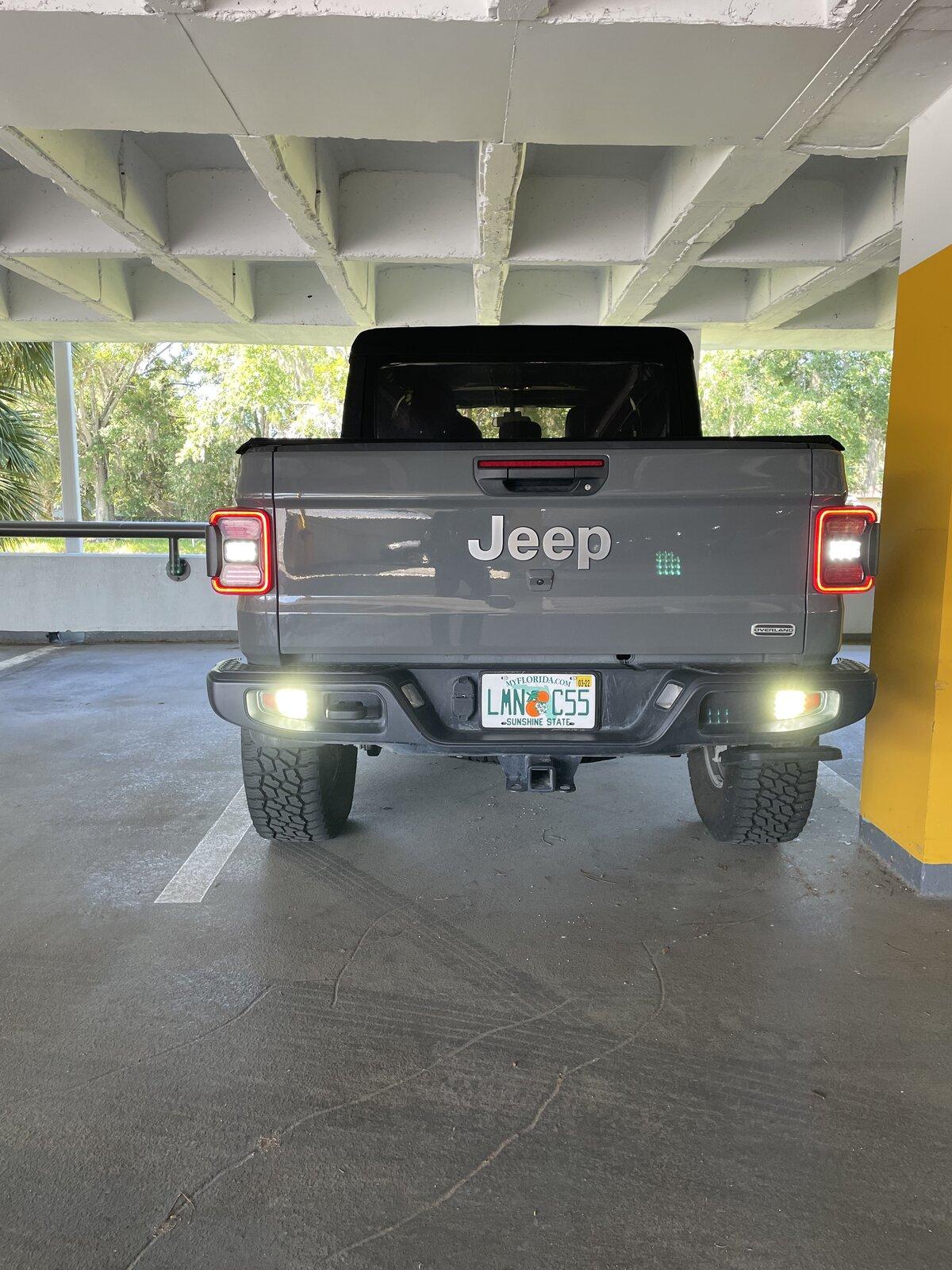

So… I guess I’m in the same boat as some people who got the plug n play harness. I can’t manage to hook up the passenger side to the harness, it will s about a foot short. Is there something I’m missing? The driver’s side is hooked up and bright. Fit and finish is legit.

I plugged mine into the driver's side tailight harness...there's a natural 'tunnel to run the wires down. IF you ran it all the way to the bottom, that's where you need to redirect. About 6-8 inches up, there is a hole that you can fish the wire through and it will reach the passenger side...barely but it does work. Just make sure that cable is ran clear through that hole without wrapping around any other wiring.
