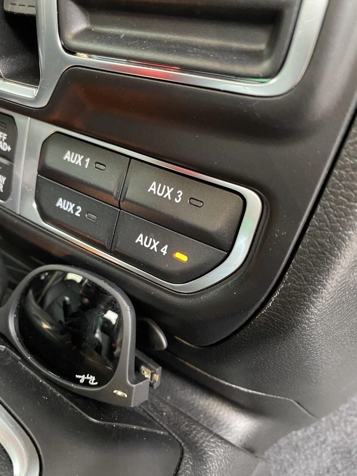

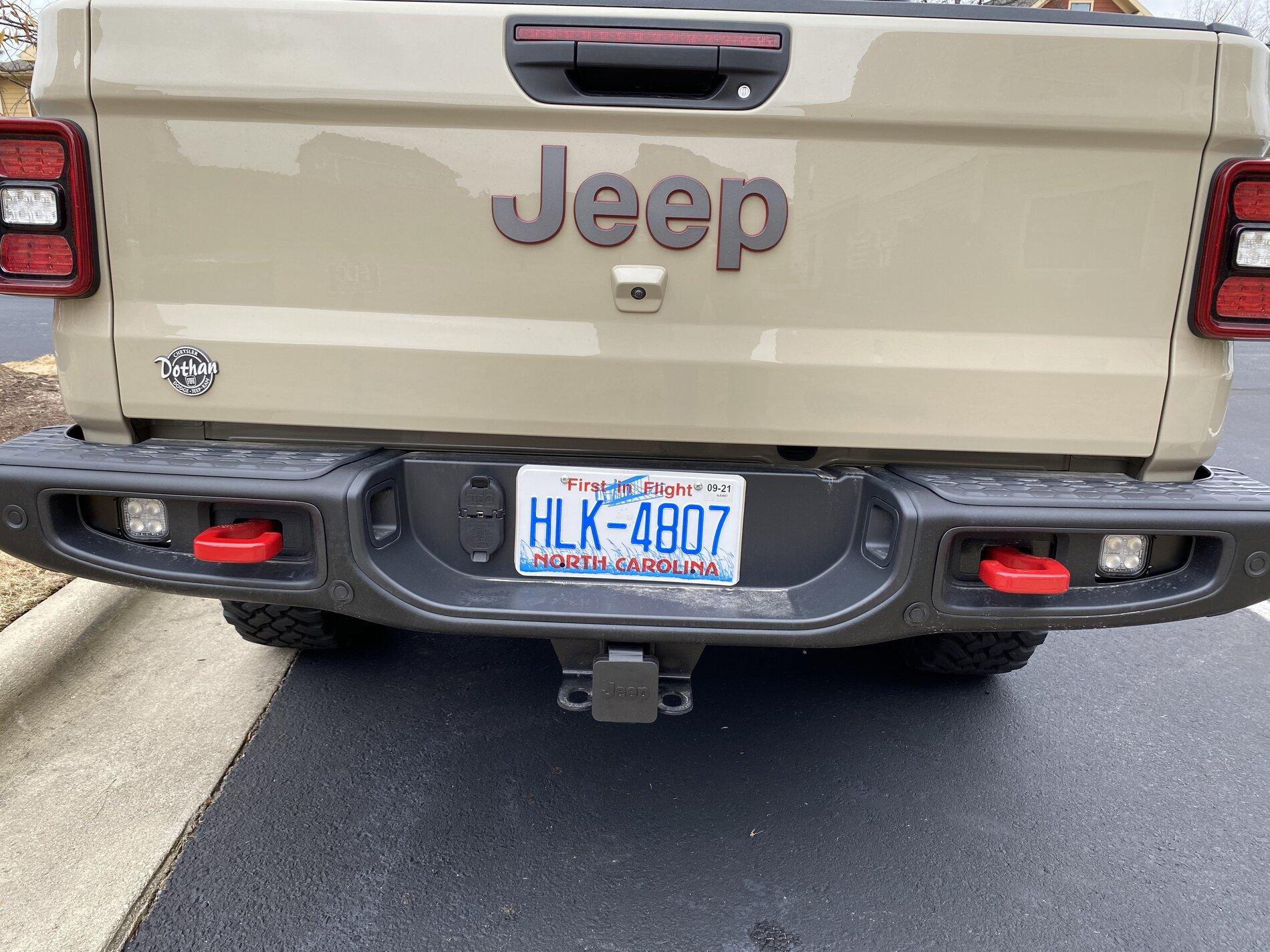

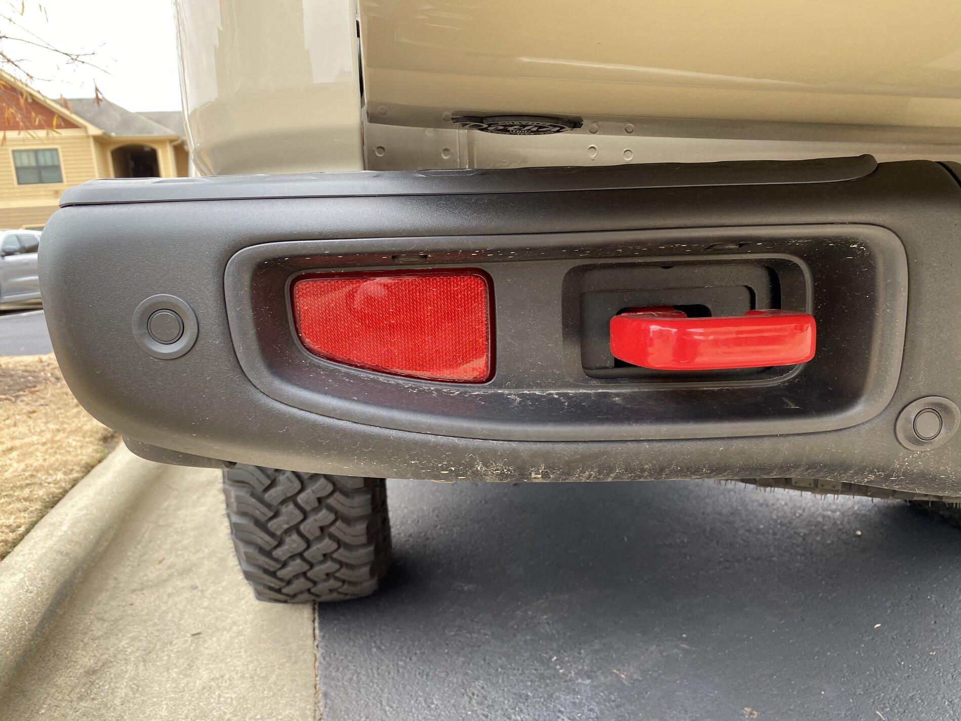

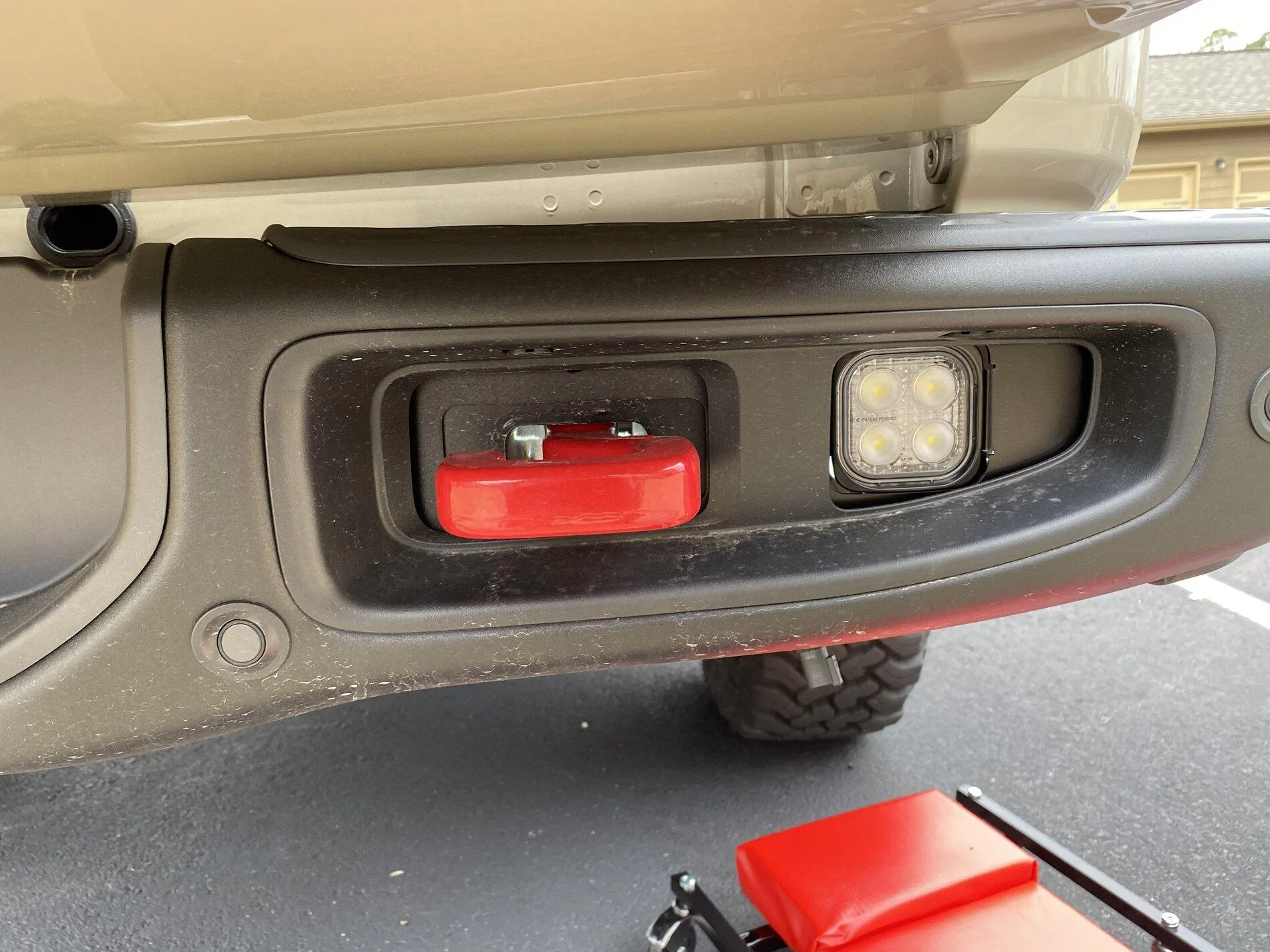

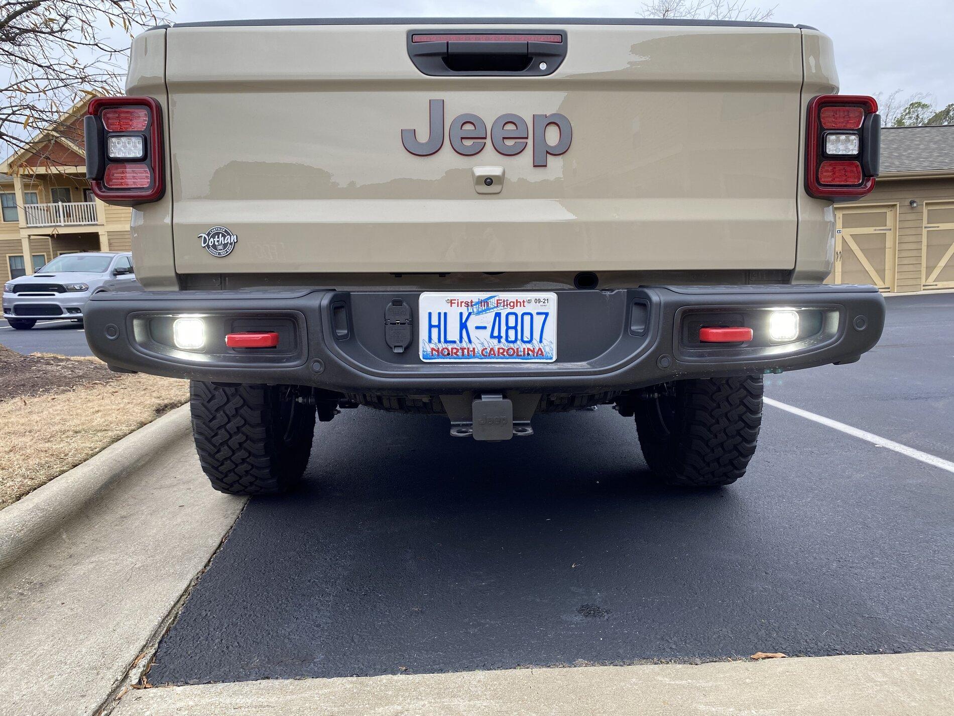

I installed the Vision-X kit. With the Aux panel already installed in the Rubicon it made life so much easier. 15 minutes and a few zip-ties and I was done. Definitely worth the money. Super bright.

Only downside - not legal in some places, most especially California. Reflectors are law. (I'm thinking maybe even federal, would have to check my notes)
Don't get caught along the side of the road with lights off after dark. Just saying - cool ain't always legal (or road safe)
