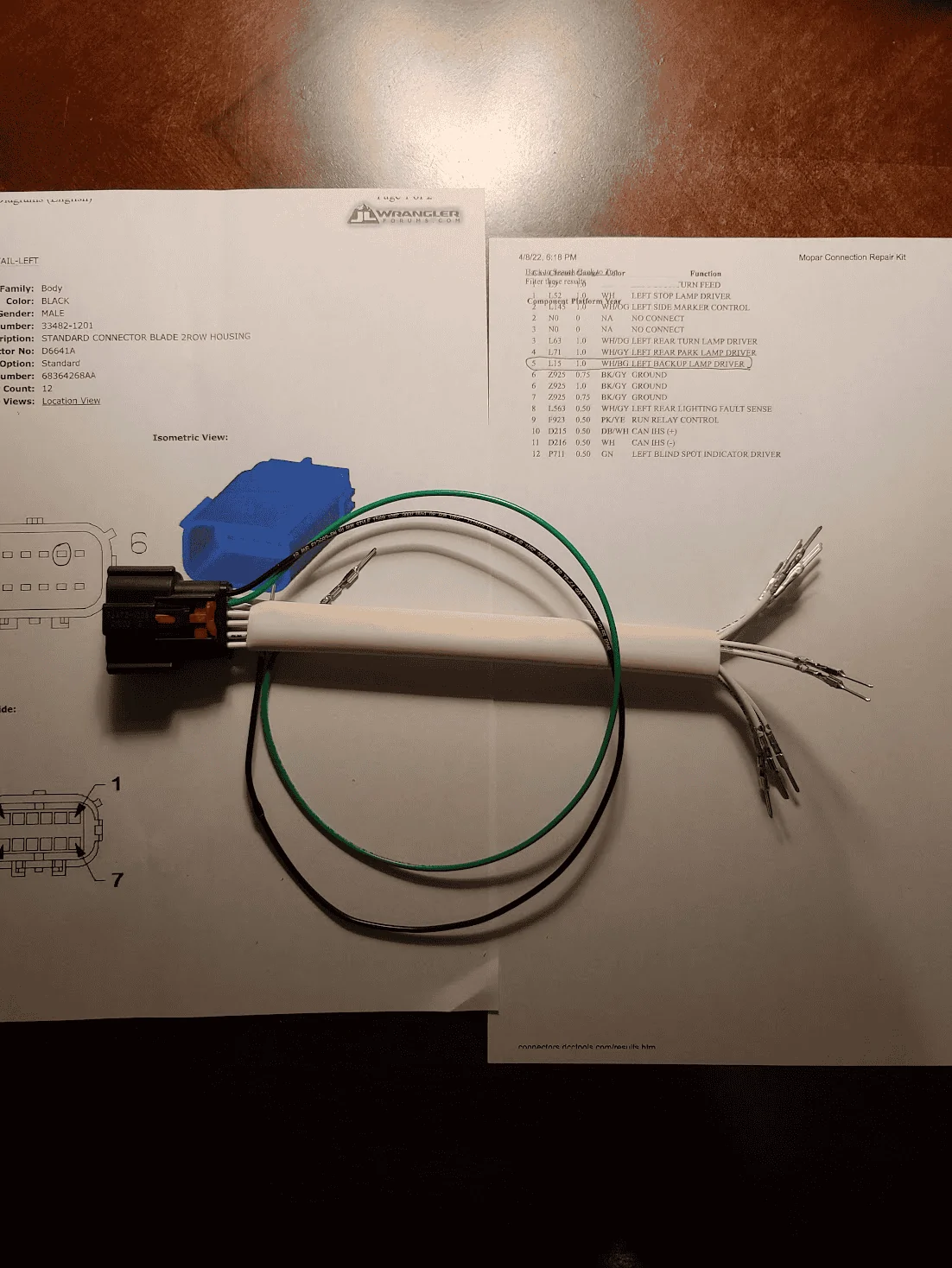

The 12 pin molex is to be inatalled between the tailight and its plug.
Judging from the ebay listing, there is a 4 way connector that leads to the license plate lights?
Does anyone have pin out for this 4 way connector?
I will keep accumulating info on this thread for everyone to use.
Pin 4 can power the relay. (Or acquire source from the license plate light)
Pin 5 will trigger the relay off.

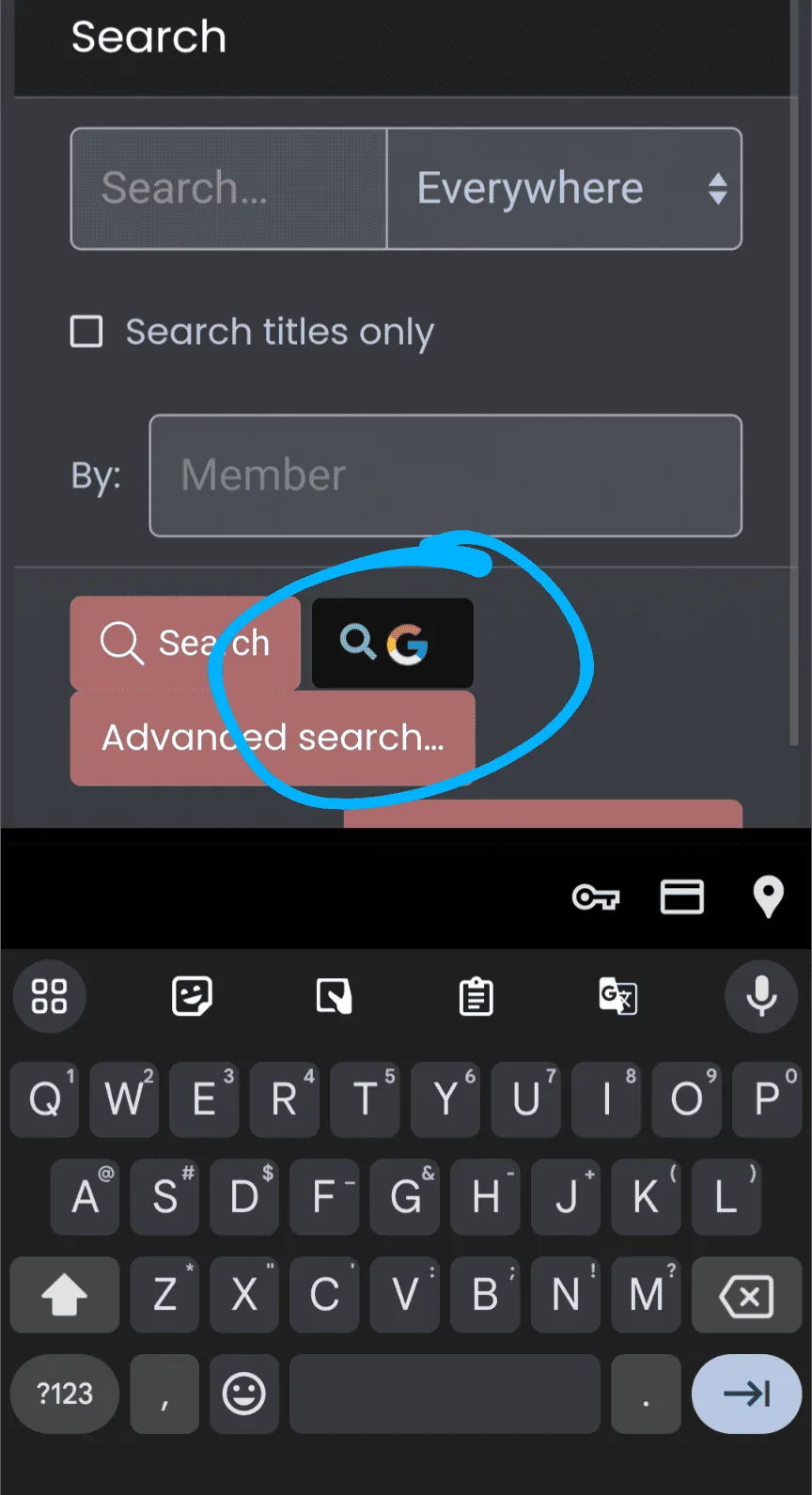

Agreed... but sometimes easier said than done. Maybe there is a secret to searching the forum, I have attempted a forum search for many topics, usually coming up with nothing... then I do a Google or similar search and find 20+ references to the forum... just doesn't make sense... IMO searching within the Gladiator or Wrangler forums is practically useless... unless you know the trick... and I don't.
Yeah, you're better off searching Brave or Google and letting it lead you back here.

Anyone have parts list for all the connectors involves for the license plate light bypass?
Per what I can gather:
Molex 12 way male and female
License plate lights is a molex 34900-4120
Mating plug on vehicle is molex 34899-4080
Pins 2177610-3
Socket 7-145267-1
Can someone help me find the pin out diagram for the license plate light and rear light housing connector pin out?

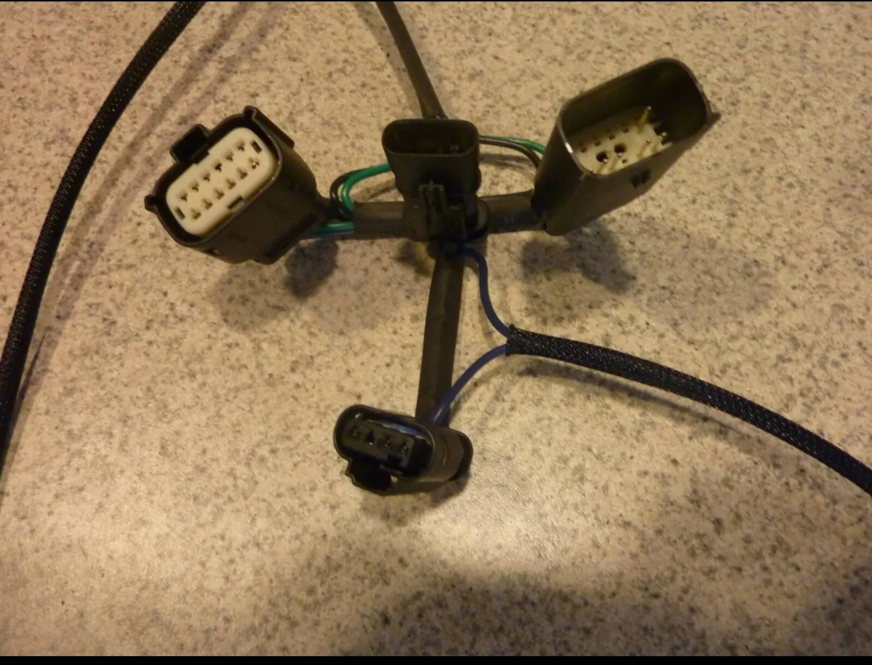

This is what I used
You'll need the tail light connectors to tap into the reverse lights in addition to the parts you have listed already. Also a relay to cut the license lamps when the reverse lights come on.

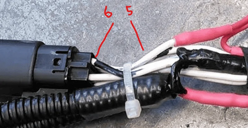

And here's the pin you tap into:
You can verify that with the Oracle harness.
5 is the backup light driver, 6 is the ground.
