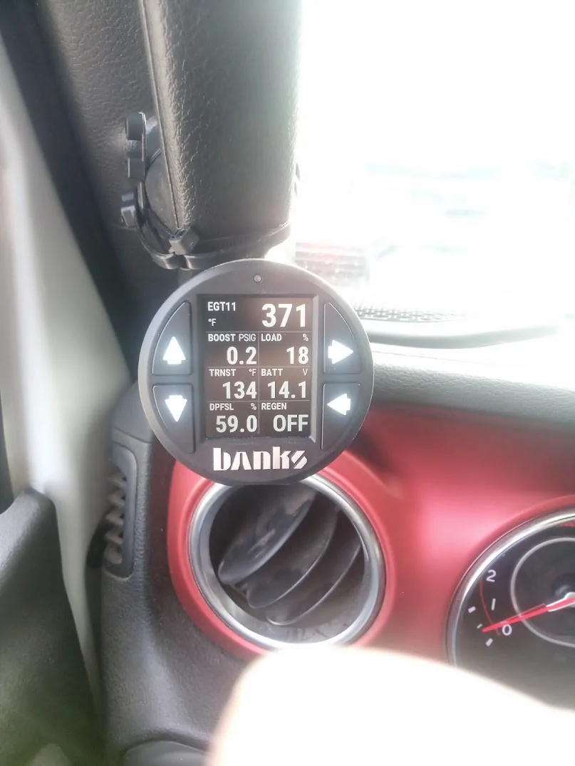

hope this helps not really sure what you are asking.
this is my format

Welcome to the forum. Doesn't sound unusual to me - like rharr says, the gauge is dumb and only reports what the computer tells it. My experience with this truck (I also have a diesel, and a Banks iDash FWIW) is that sometimes it looks like things are frozen for a long time, then there will be a big step change. Seen it with DEF level, oil life % remaining, tire pressure, DPF % full state etc.
I don't think I've ever seen it happen with oil temp, coolant temp, oil pressure, various more critical things. Maybe the canbus system is tuned to prioritize critical values, and non-critical sensors can end up holding their updates for longer
I don't ever see 0 for DPFSL% though - active regen typically kicks in at 80% (or sometimes at a mileage interval like 800 or 1000), and stops at exactly 8%. Never seen lower than that. Just to cover the obvious questions - you're certain that it's stock and has a DPF in place? Could it have been flashed to disable regens?
Nothing actionable so far though - the DPF management seems to work almost all the time without having a gauge to watch it. Unsatisfying as it is, I'm gonna suggest just continue to drive and watch for another few hundred miles before thinking too hard about it

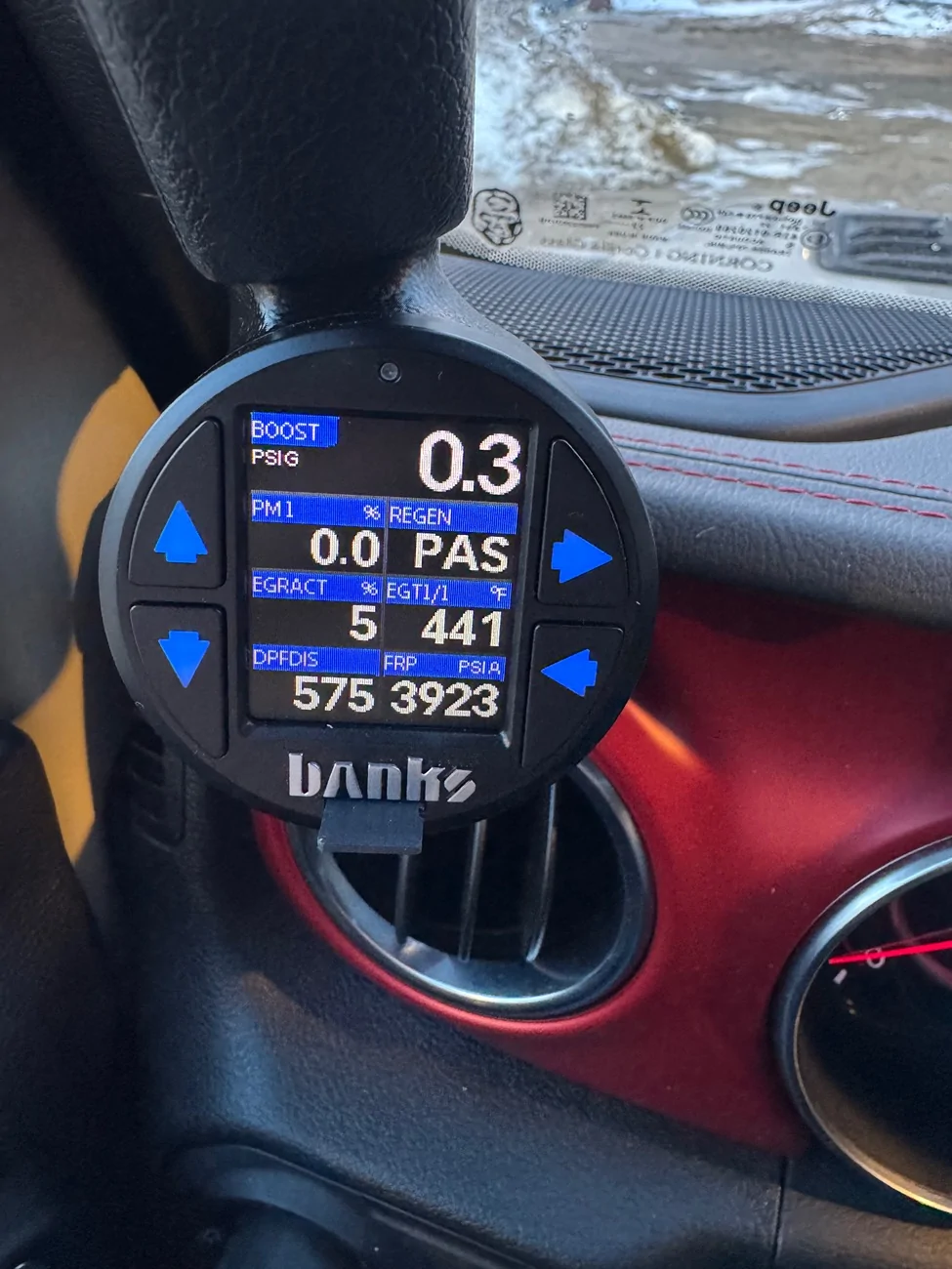

These are my parameters. Yeah, for now I’m just gonna continue to drive it, but I assumed it would be some value there.
And that is a concern of line being that it has some kind of a tune on it. All the emissions equipment seemed to be there and working. The EGR valve values are accurate. And it does seem to be using DEF. I live in New York and purchased it in North Carolina and it used some on the return trip home.
Just trying to see if you guys actually see it jump say one percent for 100 miles or so. I know that’s extremely generalized, but just trying to get an idea.

I’m wondering if there is an issue with the truck. I assumed when I plugged in the gauge for the first time they would say 20% or 60% soot. Not 0.0%. And after close to 70 miles now, I assume that I would have at least 1%?
It might help if you can take a pic of your gauge so we can see exactly what your a monitoring.

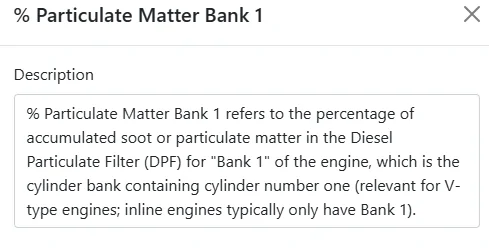

You are not monitoring the DPF Soot Load. You are measuring Particulate Matter Bank 1. If you are wanting to monitor the soot load it would be DPF Soot load Percent.
Here is a link to what is available on the iDASH for the Gladiator and acrynoums that might help you out.

Pretty sure that’s what I selected. I’ll triple check PM one is particular matter. I understood that to be soot. But I still have the 575 miles to the next region that has not moved in 100 miles.

Yep that's the problem - there are PIDs for PM1/PM2 for vehicles with separate left/right DPFs. We don't have that, we have a single one that's tracked in DPFSL%. So makes sense that PM1/PM2 should be zero
I haven't ever tried miles-to-regen, so can't help with how that should behave. I just watch DPFSL% and REGEN (off/passive/on)

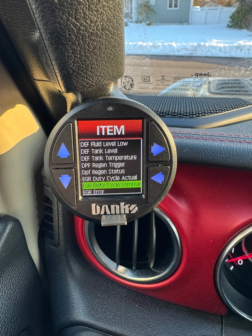

Only issue is I do not have DPFSL%. Maybe I need to do a firmware update.
I do have DPFRG%. Looks like it gives me the percentage of how close it is to a region cycle.

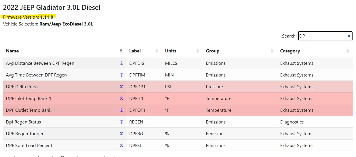

These are the all the DPF Options that you should have available on the latest firmware 1.11.0. If you are on the latest firmware and are missing some I would contacts Banks Support. They are very helpful.
Jeep Gladiator Banks IDash/ regen 1772228373807-7s
Here is a link to update your firmware if needed:
Update – iDash Pro or iDash Data Pro

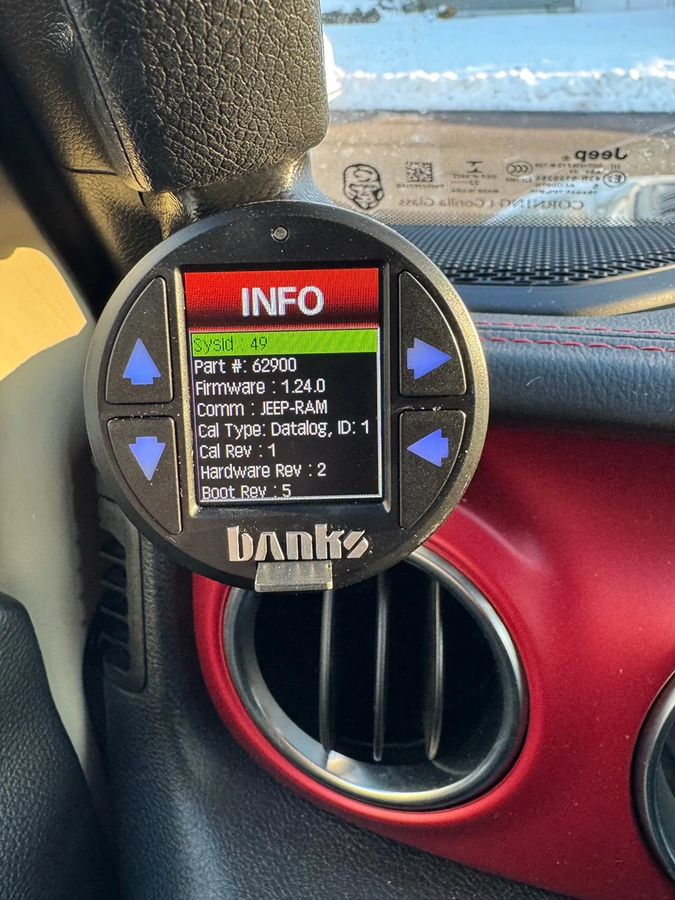

Just out of curiosity did you set the engine in the Banks? Not sure if that makes a difference or not. Unfortunately my JT is in the shop so I can't give you the exact steps to do it but I know you can go into the settings and tell it that you have the 3.0L EcoDiesel. That might change what options are available.
