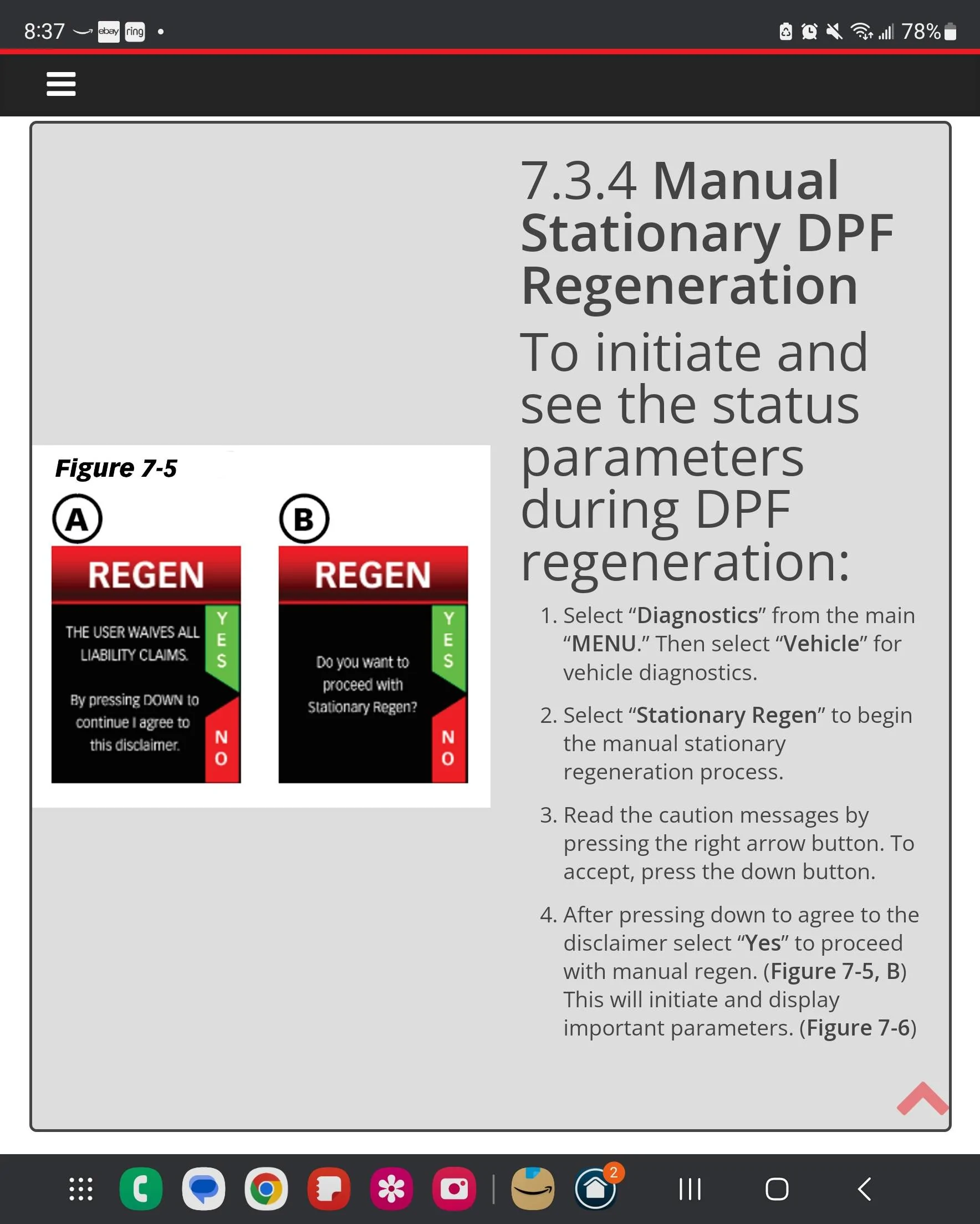

I have tried searching but from what I have found it seems like iDash is NOT capable of initiating forced regen on Gladiators?
Yet I found the procedure for forced regen on Bank's manual.
So those who have this, were you able to initiate the forced regen with iDash?
Jeep Gladiator Can iDash perform forced regen? Screenshot_20240119_083727_Chrom
Jeep Gladiator Can iDash perform forced regen? Screenshot_20240119_085301_Chrom

I haven't found anything on being able to force a regen with the iDash.
What you posted is something I haven't seen yet. When I get back home from Cancun. I have to look at that.

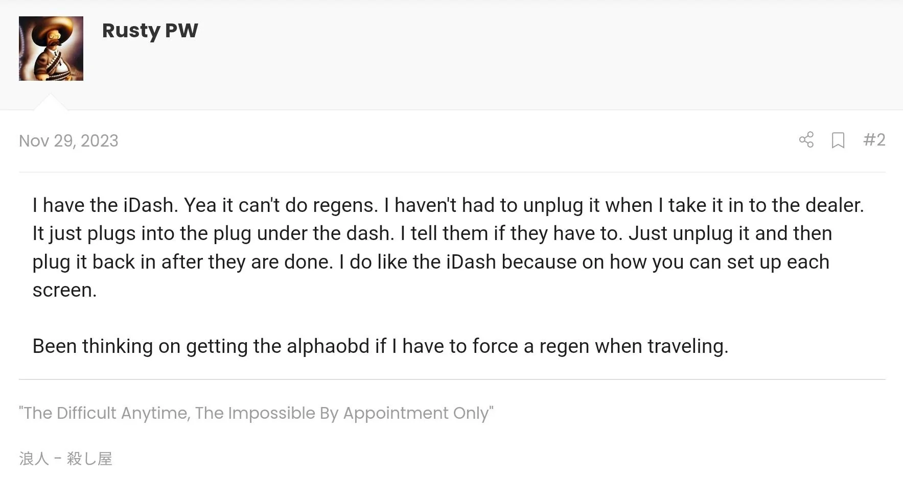

Does not look to be an option on mine. I have the iDash Datamonster and went through the diagnostic settings, no forced regen mode to be found.
