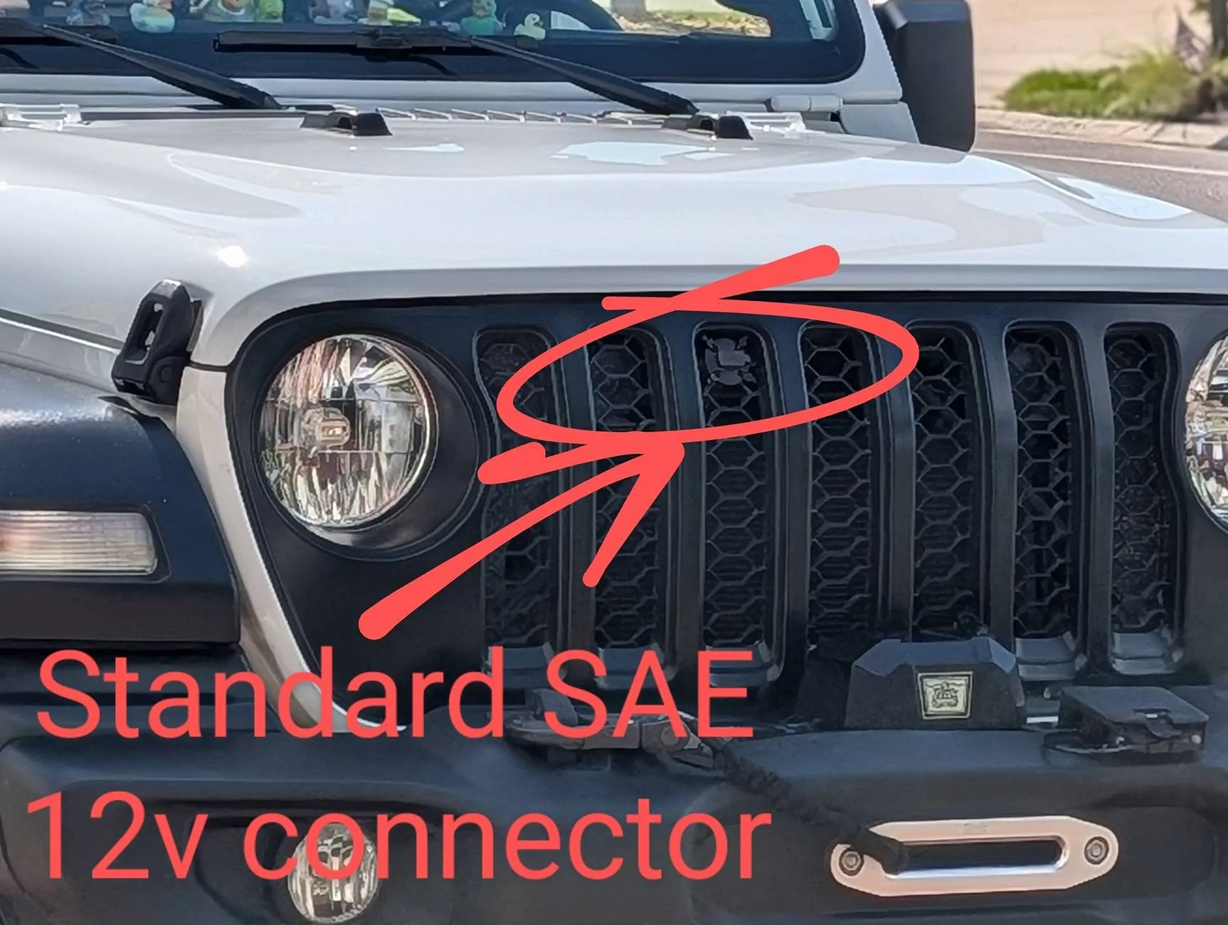

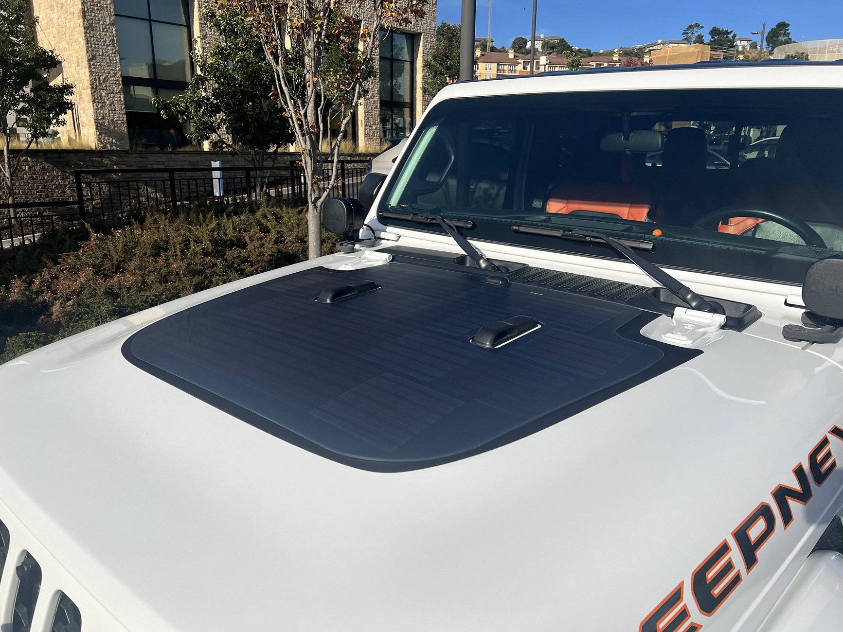

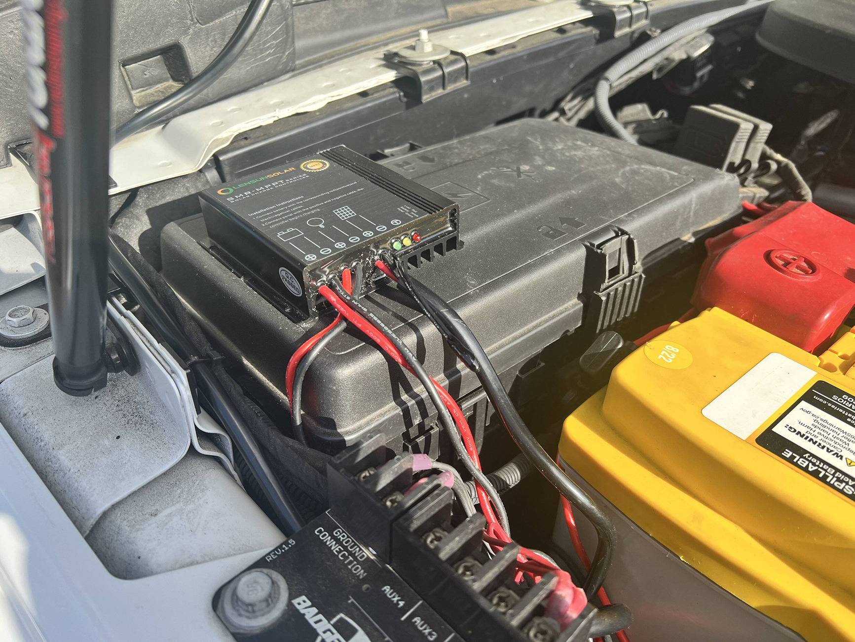

Yup!!! But I went with Solar.
There is no power outlet where my Glad is parked.
That's cool as hell, disguising the solar panel as a hood decal. I might think about that on mine, but it's a Rubi so it's got the fake scoops. I get the message about the Aux switches unavailable, battery charging when it gets a little chilly outside on the factory batteries.

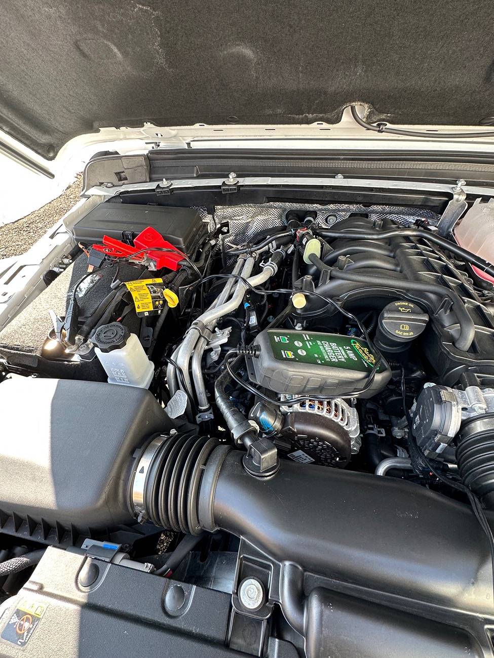

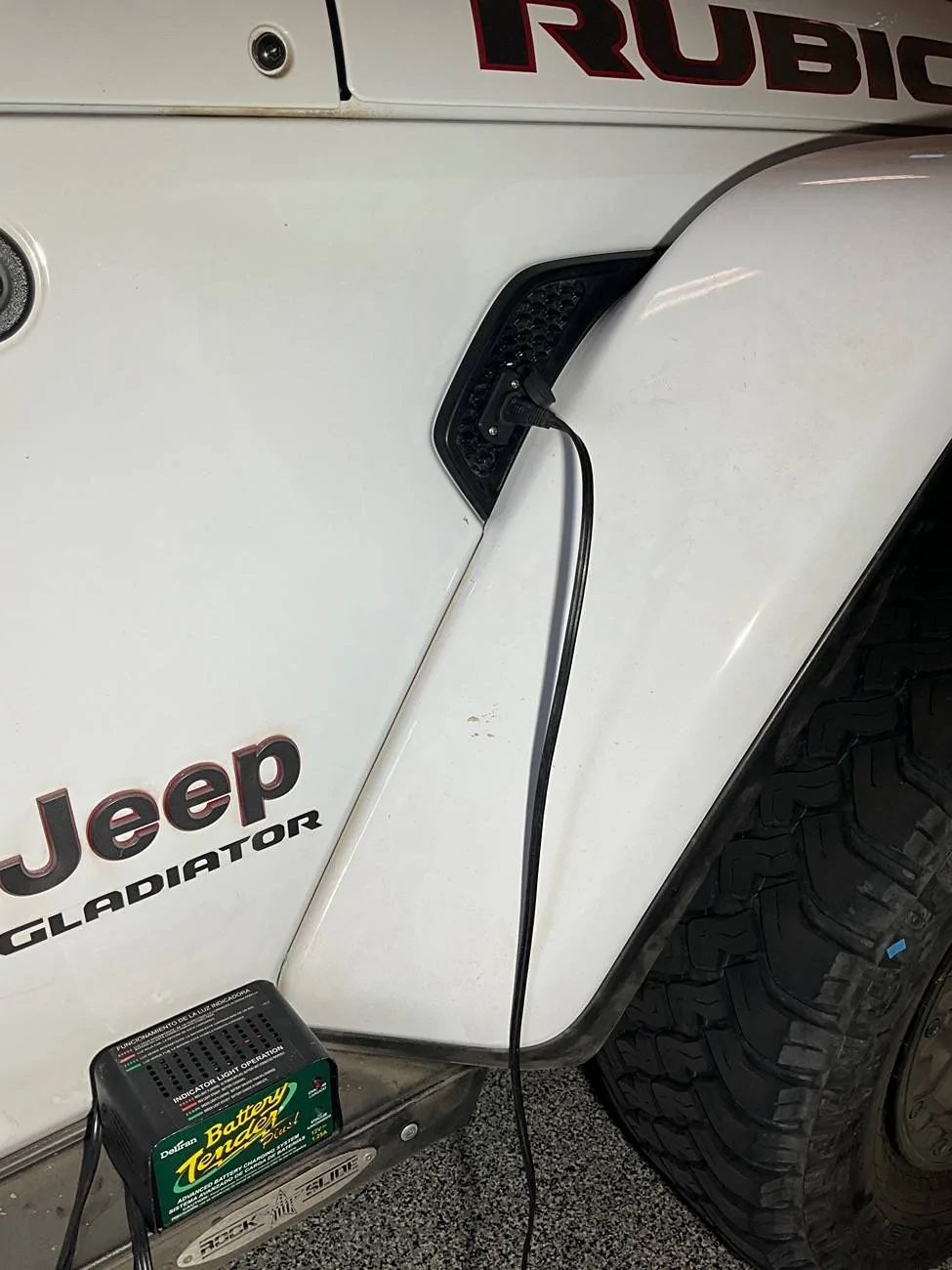

BTW, we trickle charge this with a Battery Tender (via a fast connection on the grill or through the trailer plug) when parked at home.

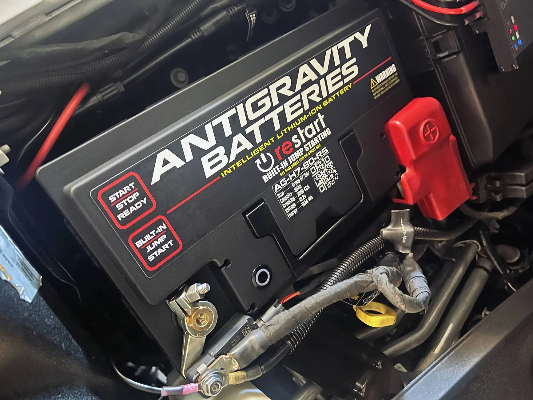

Back in 2020, life was put on hold for everyone. Cars sat on the lot. My Jeep was a mid 2020 build. I didn't pick it up until Dec 2020. My JT was jumped so I can take it on a test ride. It had to be jumped again three days later to get it prepped. My start stop never worked right after warm up. It usually took 30+ minutes.
The next month, I installed my winch, solenoids and Aux switches. The Aux battery was dead when I put it all back together the next week. After charging both batteries and resetting the IBS, ESS worked immediately after warm up. When it stops working immediately, I put the trickle charger on it . And when I say stops working, I mean, I don’t get the ready message right away.
Two years later, I separated the grounds and charged both batteries, reset the IBS again after the ready message still taking a long time to come on.

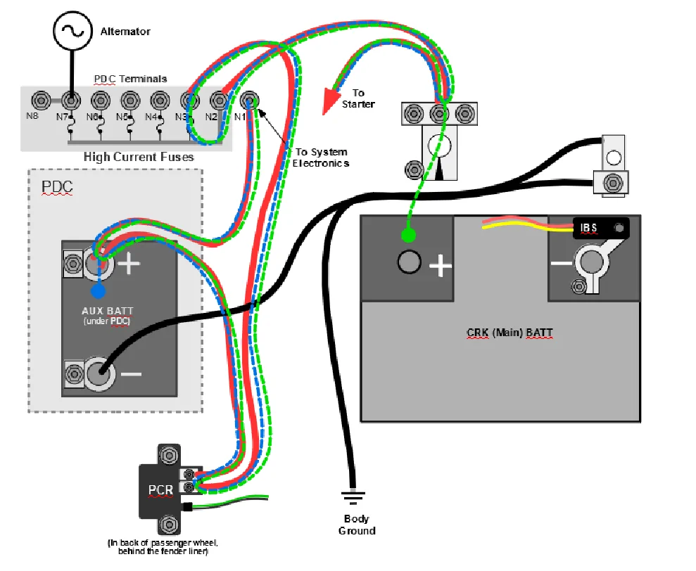

Hey, it happened. I was thinking the same thing. Batteries connected together (at the ground strap on the main battery = normal draw. Disconnect the aux from at the main battery ground strap = increased draw. I measured this at the IBS post. Reconnect = return to normal.
I do understand that the computers will monitor voltage lavels on the batteries, and can sense when the aux is low - part of the ESS health check. (If aux is low - or dead - ESS will be disabled.)
Batteries are indeed connected in parallel, but they are seperated at the PCR. (Hence, the batteries are not always in parallel; they get seperated when self-testing and when starting.) Perhaps that is where the fault can be detected, hence, throwing the fault and waking up an otherwise 'sleepy' module. For what it is worth, I confirmed the resting voltage of both batteries to be about the same just after disconnecting the aux. I suspect that if I pull the F42 (PCR) fuse, this anomolous condition would cease.
Your diagram is missing a lot of what's there. It's from an FCA document, yes, but is for "charging system and battery testing" reference and is otherwise incomplete.
That has nothing to do with draw when it's stopped/parked. There are no sleepy modules.
I know exactly how the system works - see the thread about "Are the batteries really isolated during ESS stops".
Heck, I'm the one who posted several of the documents and images there as far as how the syste works.
Been working with these electrically for quite a while now.
There is nothing about disconnecting the aux battery that causes more parasitic draw.
You confirmed voltage just after disconnecting - how about much later?
Where are you measuring? At the main battery post? Well, there's the problem - they both work to supply power to everything when it's off, and if you disconnect the aux ground and measure the load at the main battery, suddenly it's supplying everything.
The BCM has NO IDEA there is no aux battery unless you go to start it, and then, there's nothing about anything which will increase draw when the truck is off due to an error. Period.
If you are measuring draw at the main battery you are measuring is wrong.
Where this one says "to system electronics" it really should say "to everything except the starter and high current items (EHPS, cooling fan, alternator)

Your diagram is missing a lot of what's there. It's from an FCA document, yes, but is for "charging system and battery testing" reference and is otherwise incomplete. ...
True. I was using the simplified diagram to support the narrative of two batteries. (Also, I couldn't quickly find the diagram you shared whilst replying from my phone. I've seen it and would have posted that one if I could have quickly retrieved it.
...Heck, I'm the one who posted several of the documents and images there as far as how the syste works. ...
I've seen, followed, and used what you've shared on this and acknowlege your research and depth of knowledge. Thank you.
... Where are you measuring?...
I am measuring current draw ground strap side of the IBS. I am isolating the Aux at the ground strap, seperating it from the ground. Also, the batteries are both less than 6 months old, and trickle charges when parked. IF the extra draw is not due to an extra load forming (from a module wake up or otherwise), then the only logical conclusion I can draw is that the batteries were resting at different voltages, and when they are seperated, the main drops voltage, thus causing in increase in current to maintain the same power (workload). (I may be able to confirm this by disconnecting the Aux after both batteries have been maintained for a while, then check the voltage after a few minutes. If differenent, then I could calculate if the voltage difference is enough to explain the extra 100-150 mA from the main.)
I'm open to ideas for an explaination. The fact is, the observed current increased when the Aux was isolated as described, and returned to the prior state after it was reconnected.
