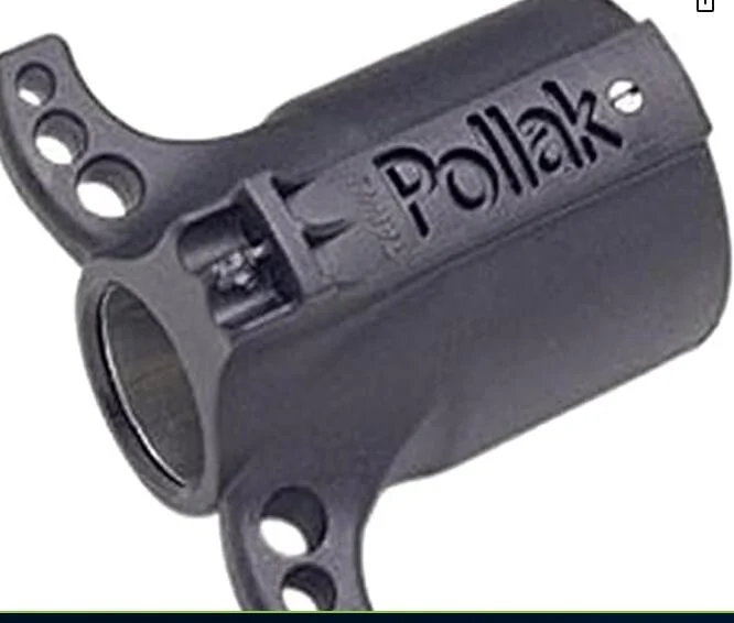

Things just keep gettin' better. thanks for this supplement.

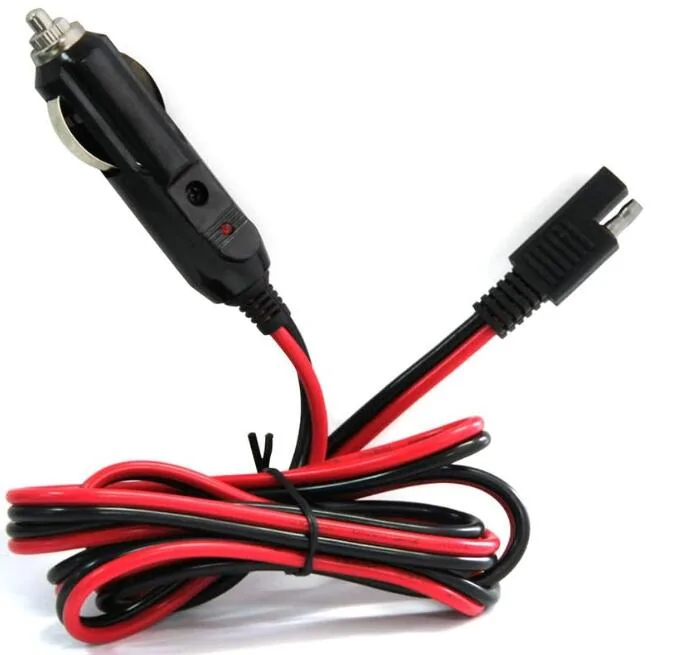

No need to cut and splice with these.
Automatically connects to the right pins.
This will work fine, one thing to be aware of is that the tip on the male cigarette plug is positive 12v. If you just toss it somewhere and the tip touches metal (floor jack or whatever) it can create a short. I know most modern chargers won't power up unless they see a voltage (safety feature), but I chose to not use this method, I do use the 7 pin trailer plug, but without the 12 cigarette pigtail.

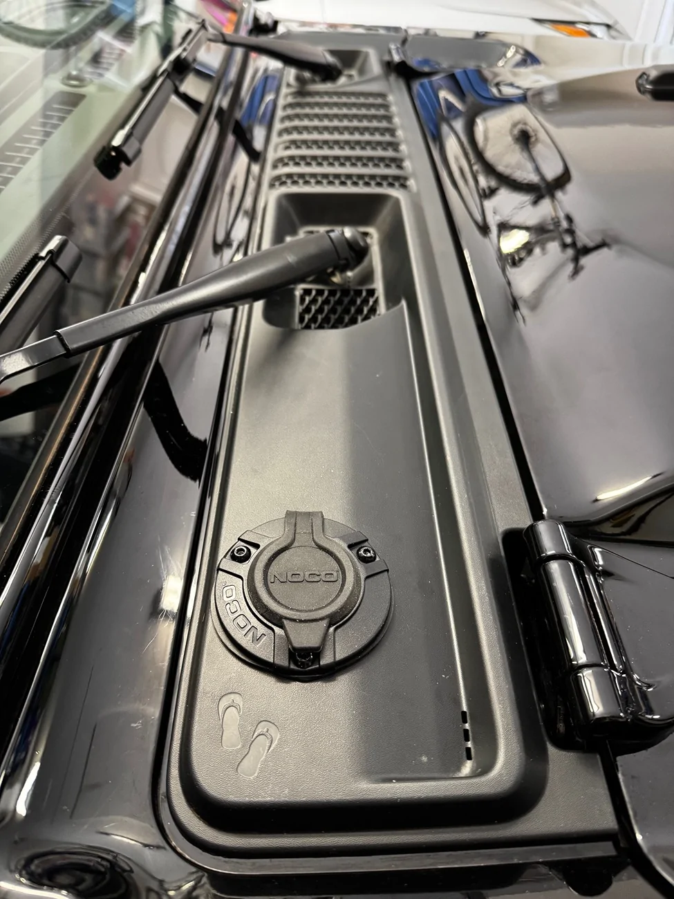

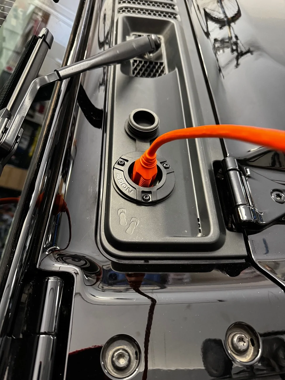

Another battery tender (Noco genius) charging location. Easy install and short wire length.
You charge only inside? Would think that would pool water if it rained creating a shock hazard.

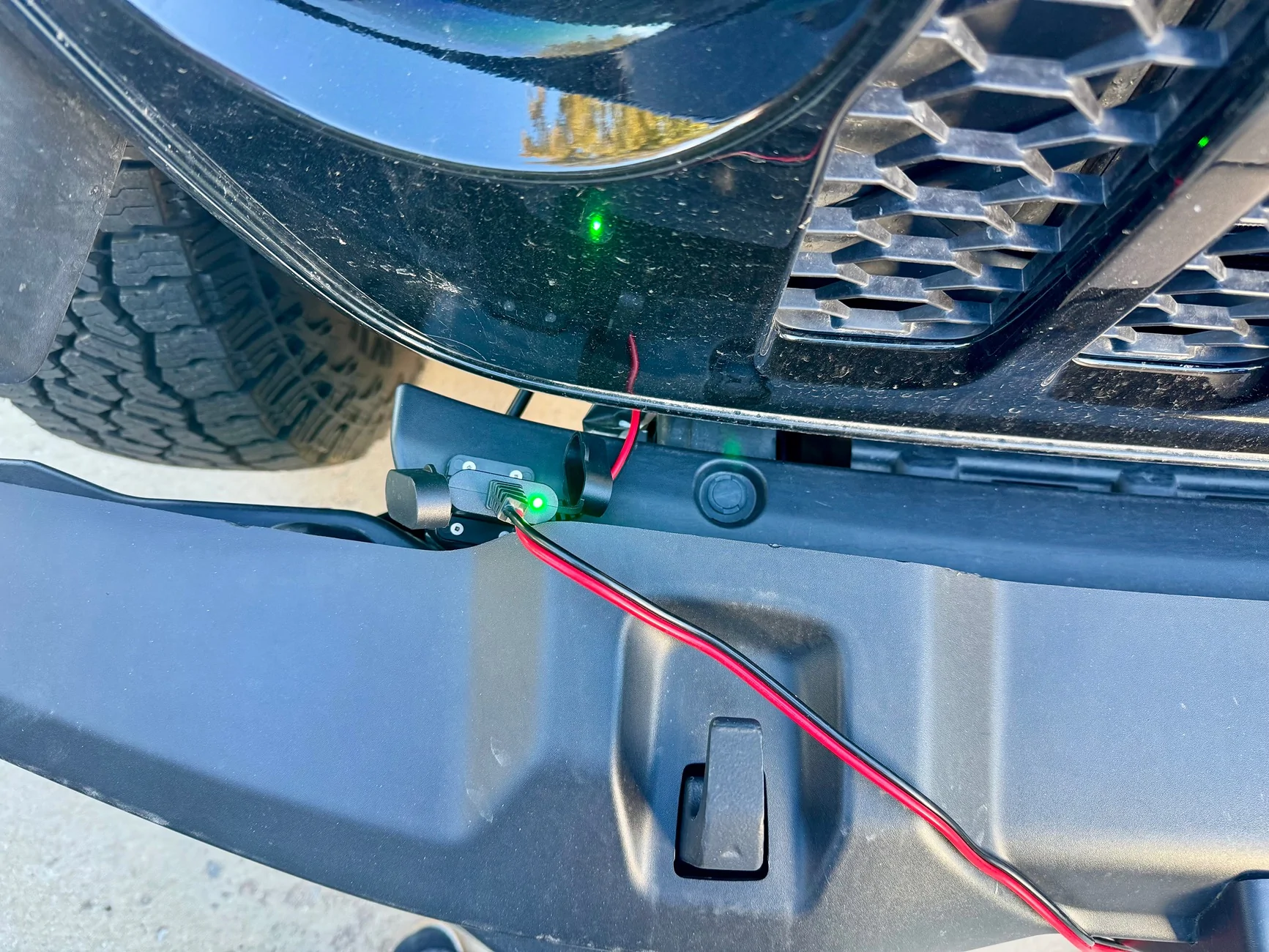

I just run an extension to the front grill and have another for the Viair as they are fused differently,7.5 and 25 amp.They are hidden behind the grill in the right lower corner when not in use.
I do charge in garage and would not charge it outdoors; that is a good point to highlight. It’s water tight when closed and I can still charge under the hood if I was outside. I chose this location for ease of install and short wire run. Also the plastic cowl is inexpensive to replace.

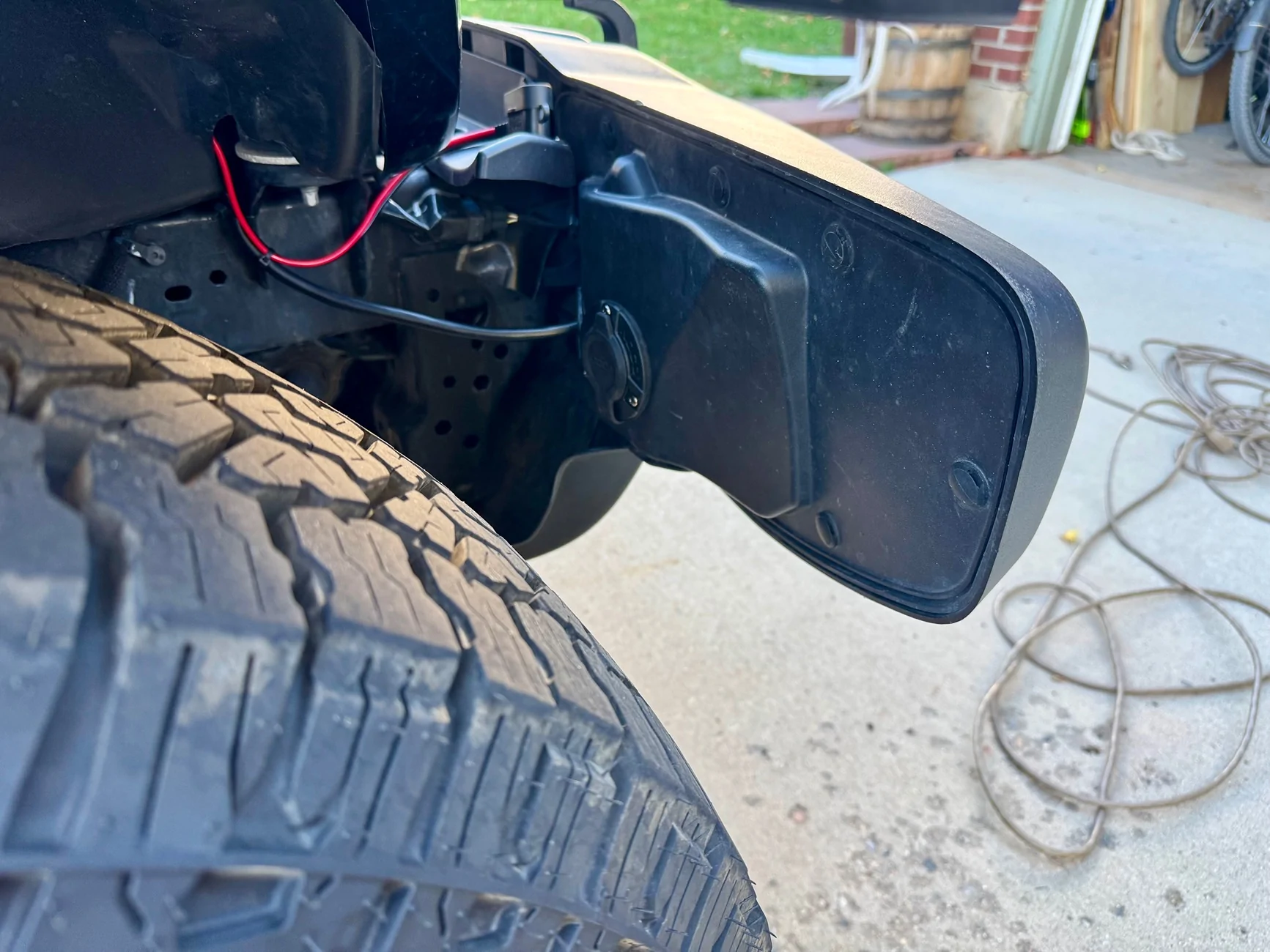

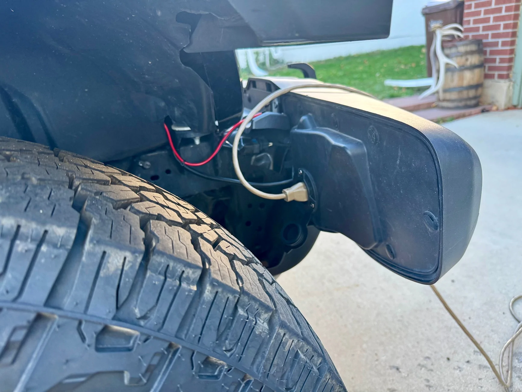

Mounted my battery tender connecter just inside the front bumper and the engine block heater outlet on the back of front bumper
Jeep Gladiator Battery Tender IMG_9577
Jeep Gladiator Battery Tender IMG_9578
Jeep Gladiator Battery Tender IMG_9573
