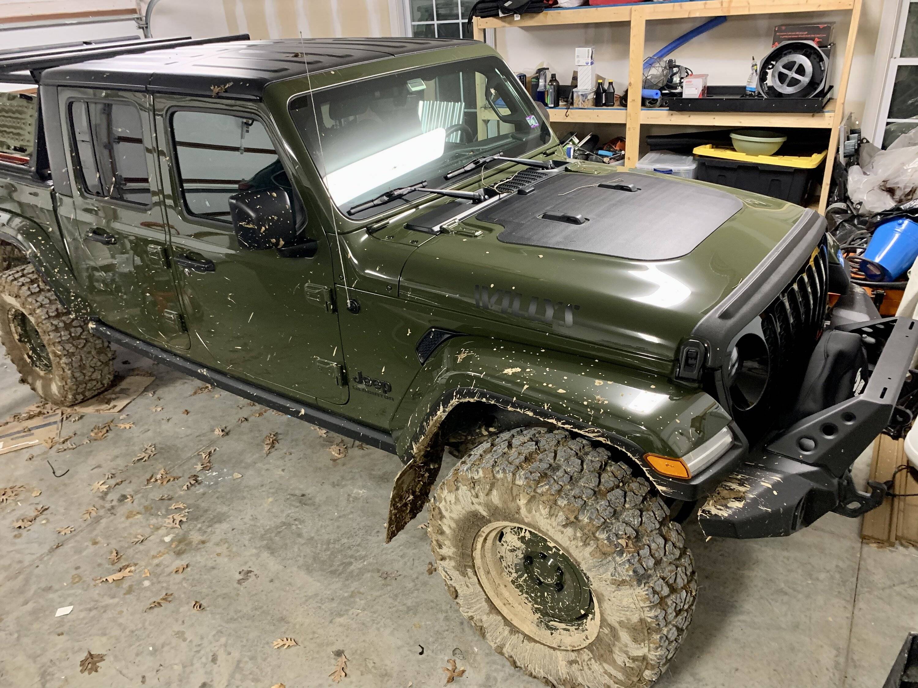

Cascadia’s hood panel trickle charges while offering a 12v out. Covered storage would pose a problem but I had it backed into our car port at the previous home and it still gathered enough light to keep it topped off in winter.
I ended up doing the same thing after dealerships refused to fix the auto stop/start system never working due to defective batteries. With the Cascadia tensing it, the engine start/stop always works and I’ve got extra power for accessories.

I've had it setup with a few different configurations. Powering the cooler was the primary use case originally. At first, the fact that it would also trickle charge the truck was just a side benefit. Below is the current setup:
Cascadia Panel w/ Cascadia Controller:
- Trickle charge at all times (the controller stops flow when topped off)
- 12v out from controller -> EcoFlow Delta -> All else (Dometic CFX3 75DZ, lights, camping gear, etc.)
The above has been bullet-proof for us and carried us nearly a week while pinned down in the RTT north of Yellowstone due to the washout last year. Glad we had the delta for that scenario but once I realized how little the dometic draws (65w max cooling both fridge & freezer in San Antonio summer) I realized that the Delta itself was overkill. It's bulky with a large footprint. We travel with our boys so interior cab space is limited. I could have gotten away with a small Jackery that stays in the truck and even that would be underutilized given how darn efficient these fridge/freezers are. With the panel charging the primary battery, the bed outlet is more than enough for fridge plus other items. The panel itself installs cleanly, I opted to file the lip on the plastic wire channel/rail and run it long with the other wires in the OEM location down the side through the firewall.
