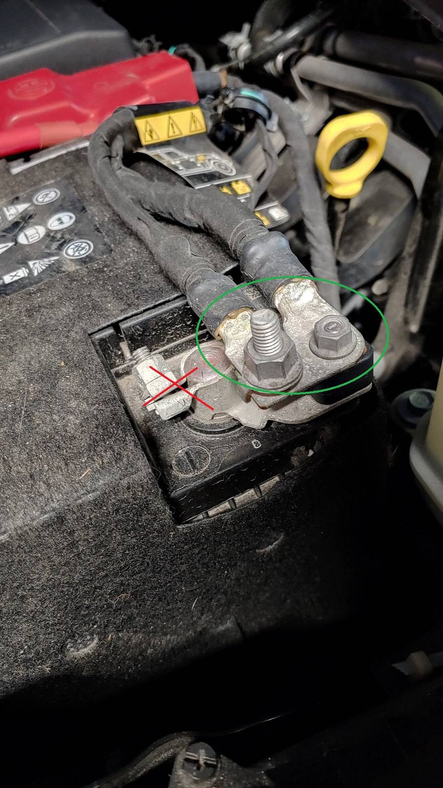

Only charge with the negative charger clamp above the IBS, as in the green circle here, never directly at the terminal or IBS clamp unless you remove and reset the IBS.

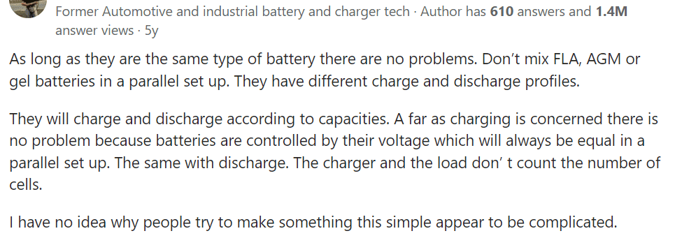

I've found a couple of decent explanations with the solar guys that of course run banks of batteries and talk about this a lot (been digging because we've talked of solar at home) ->
It works because the batteries discharge at the same voltage decay rate if you will. The voltage must stay the same since they are in parallel.
A 10 Ah battery will deliver only 1/10 th of what a 100 Ah battery will to decay in voltage the same amount. Therefore it delivers what it can as it discharges. The 100 Ah battery delivers approximately 10 times as much to drop it’s voltage the same amount.
An engineer wrote this:
Take two LiFePO4 batteries, even at different states of charge but at the same voltage. What happens if you initially parallel them? Answer: nothing. They'll just sit there, both with their own BMS. Now you provide a charge source. Both batteries will start charging but one will take more charge current than the other even at the same state of charge (and voltage). The reason being that the internal resistance of one will be different than the other, based on the state of charge
In the end they'll reach the same state of charge. And they will happily split the load between them, and share the charge current between them. The only things you need to do is:
- Make sure you cables are approximately the same length and the overall resistance from their connection to the bus bars to the battery packs is the same
- Make sure that each BMS can handle the full load in case one battery pack disconnects.
- Only do this with batteries of the same chemistry
