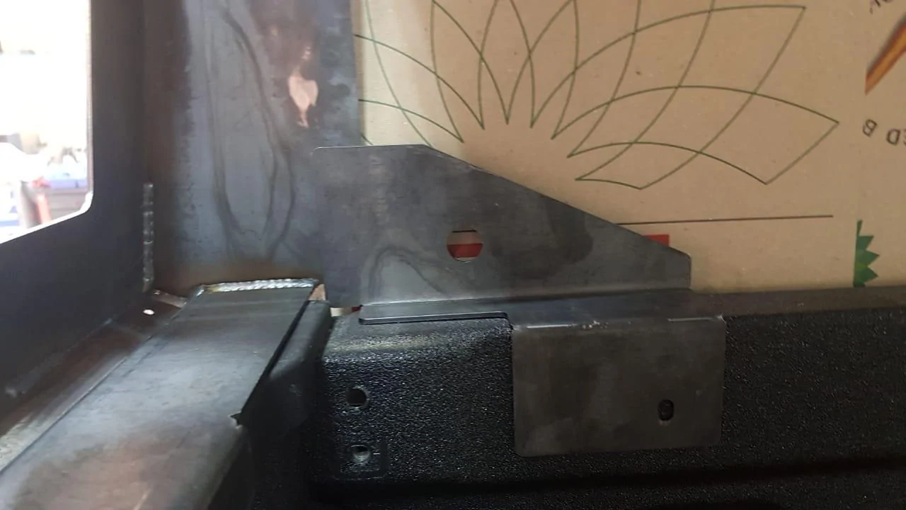

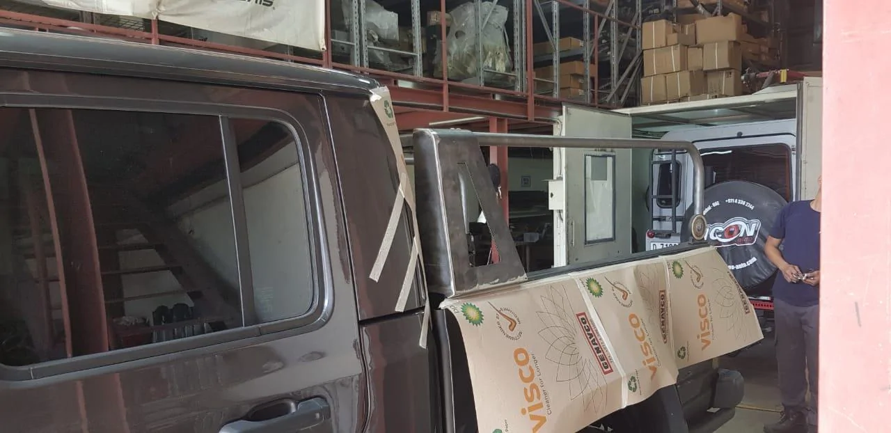

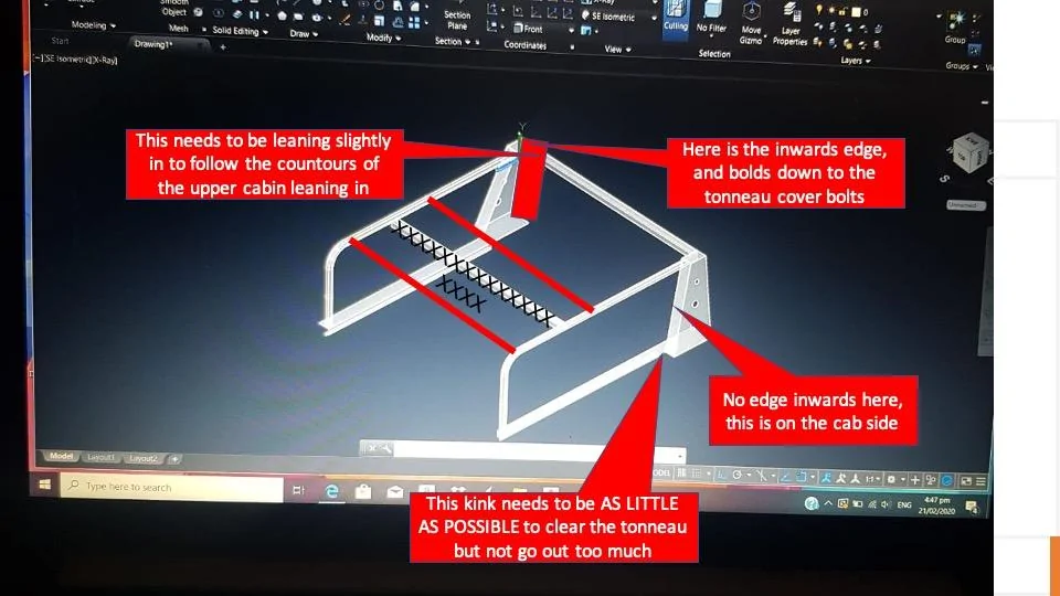

An update from my end...we went from sketch to initial CAD and now did the measurements to finalize the CAD and cut in 3mm for all plate work and 42mm x 2.8mm which tube for the rest. Should be 100% bolt on and in 5 pieces

what brand is this? super cool to see the cad work involved.
Custom made...my design...local fab shop executing...should be done by end of week (not powder coated so we can make sure it has all we need)

I was going to ask how much it costs to have a fab shop do that, but i see you're in Dubai.......gotta be different expense than local Middle Wisconsin.
Looks badass. Do you have a background in design?

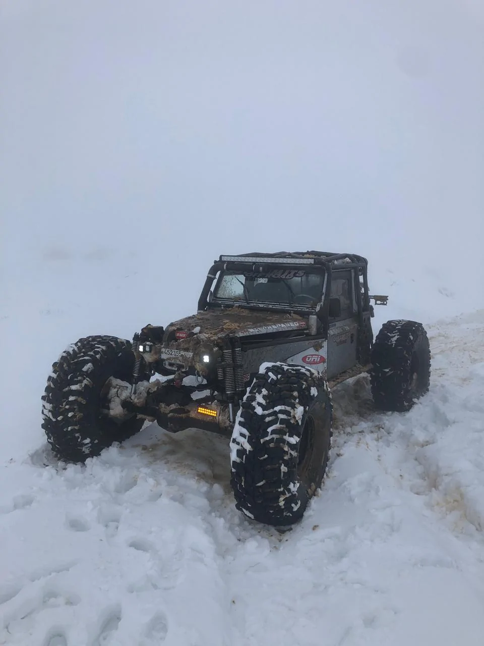

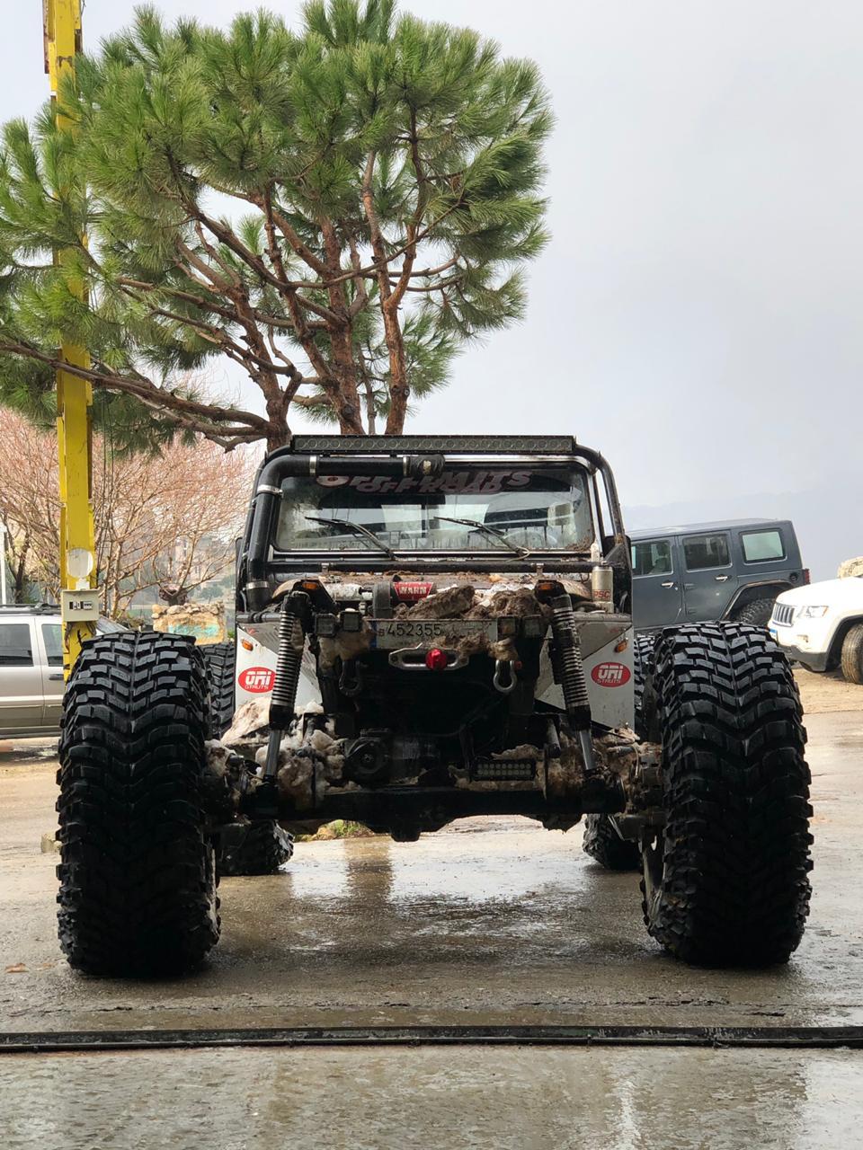

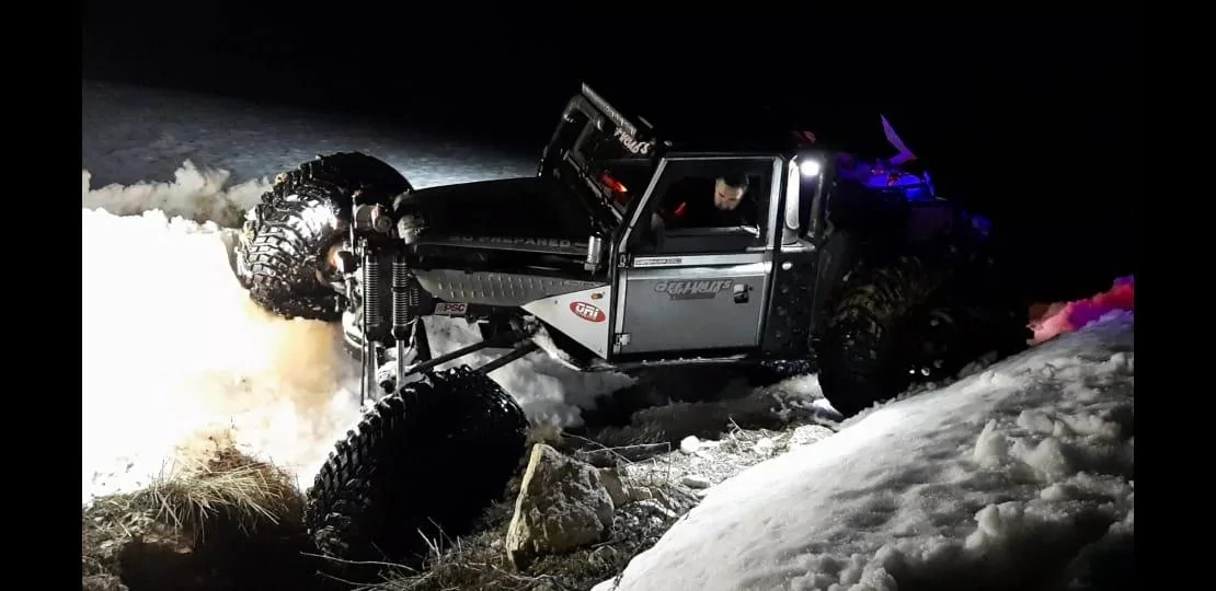

Thanks! No, I actually failed Mech Eng back in undergrad :)...but I've built several vehicles in different forms/functions (Dual Purpose 110 on 37s, Overlanding Discovery 2 door, older Disco truggied on 42s, etc...)
Most experience was a full on Defender truggy with only around 4' left in the chassis and the rest custom made to accommodate the LQ4, NV4500, Hero 3, RW2.5 axles, dual 16" ORIs, 4 links F/R, 54" tires, triple winches, Jaz cell, etc...while maintaining the Defender single cab under the exo-cage so we can enjoy warm snow runs (Mountains of Lebanon) or lighten her up for summer wheeling without the top:
are those the 54" tires on the photos you posted? That thing is awesome!
yeah, 54s...has a set of 42s for more technical and faster uses...and thank you!

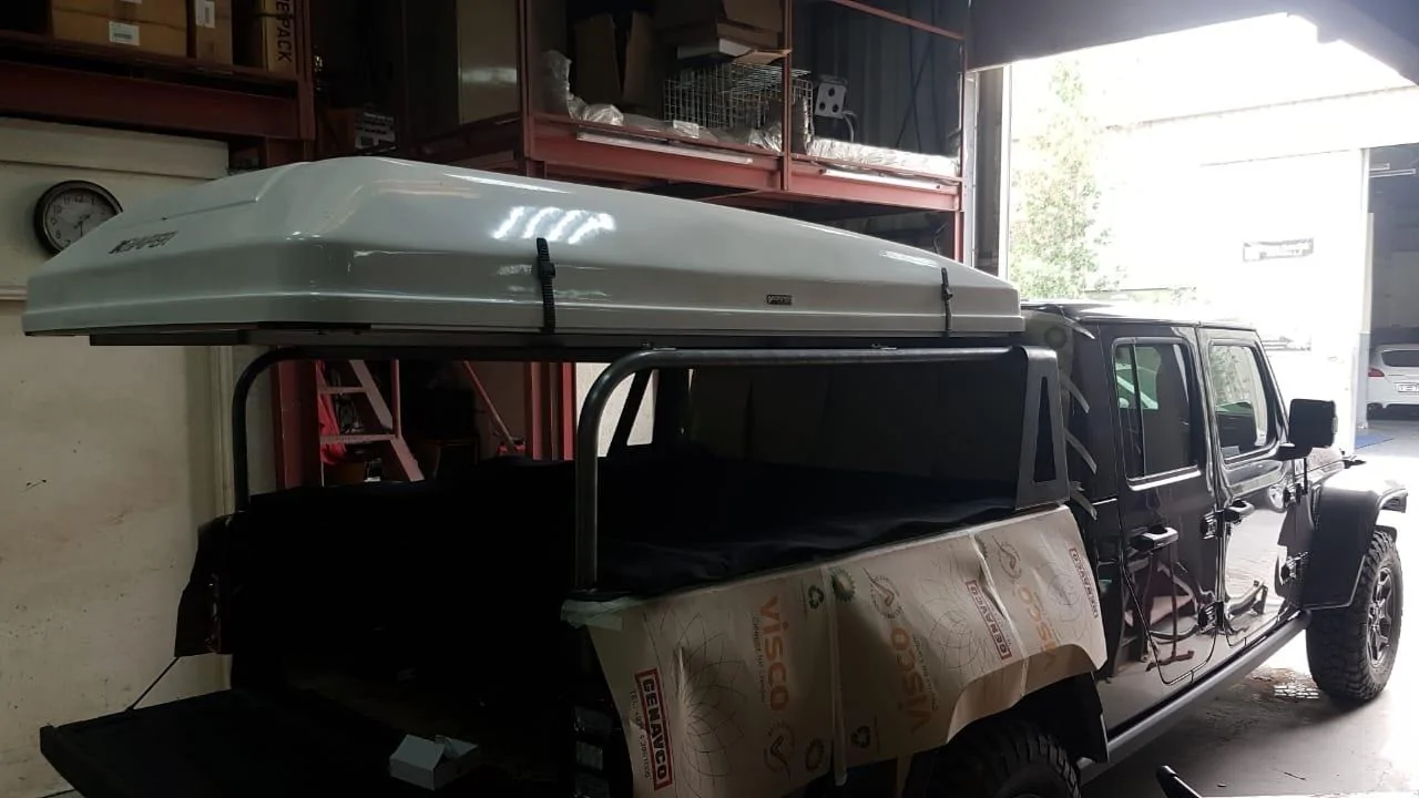

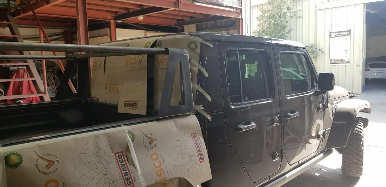

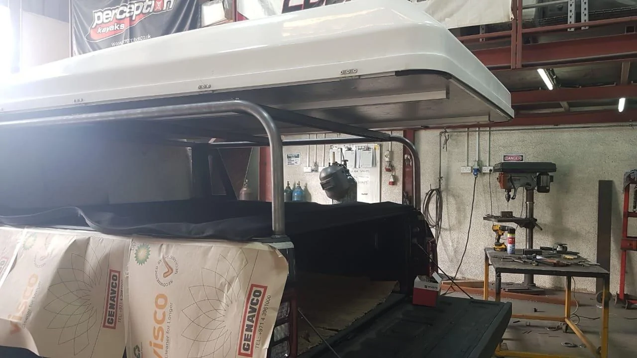

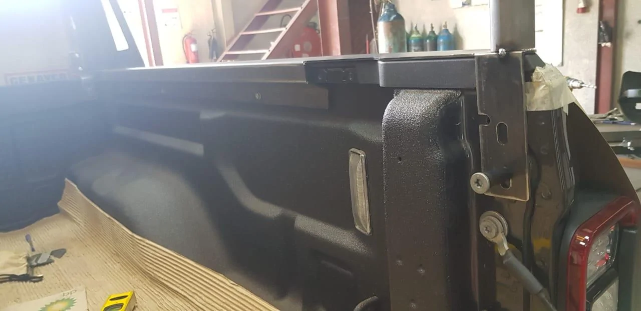

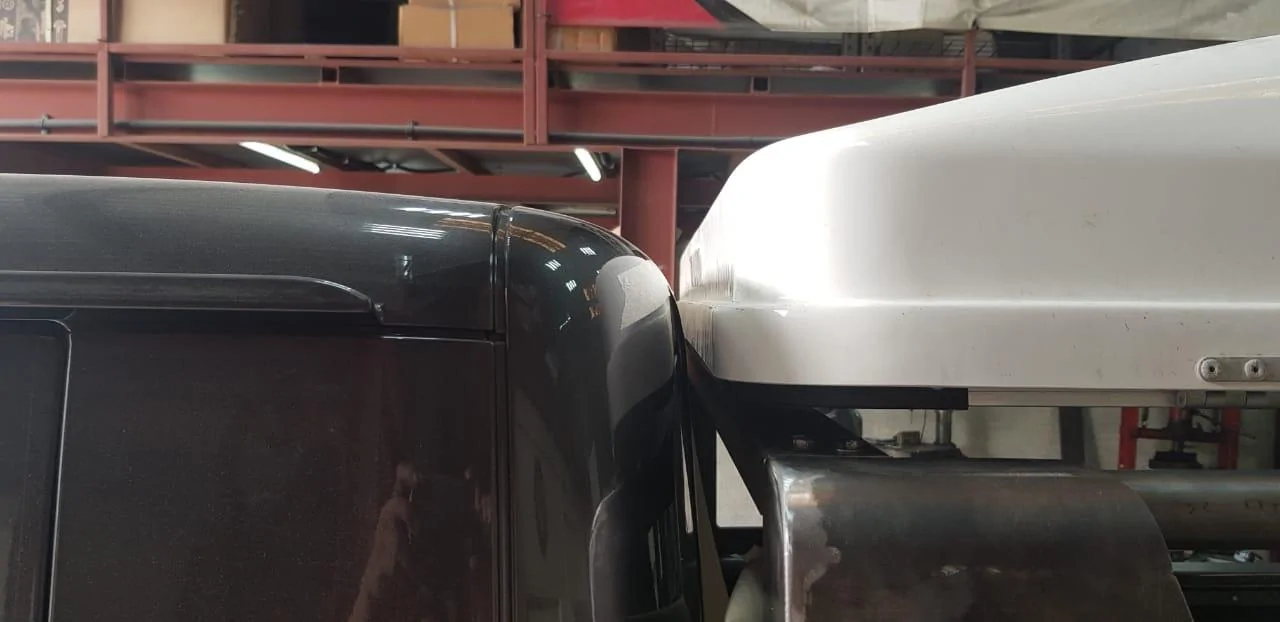

Update on my prototype (already severe things I want to change...but key thing is that it works with the OEM Tonneau...). The tent goes overboard by around 29"...if/when I put a rear tire on the rear bumper it should be OK...however, I would REALLY prefer IF ONLY AT Overland does a 180 flip forward tent that replaces the OEM hard-top as they used to have back with the JK...that would be ideal and the rear RTT can be a 2 person one then for when all 5 of us go...
