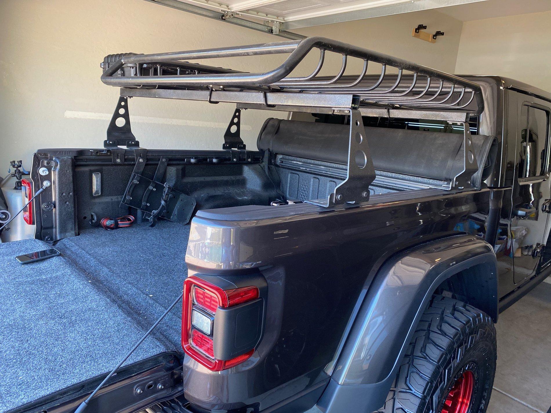

The Access Literider is money. They make these specifically for people with Bed Racks. You need trail rails, but it mounts inside of the bed to the trail rails and doesn’t sit on or hardly overlap with the sidewall of the truck bed at all. I have a pretty easy time using mine with my rebel rack.
Cheers!

I have the Literider with a JCR rack, installed without the Trail Rail system (or a DIY one). The Literider is not as tight as I wish it would be, but understandable for what it has to deal with.
Since I have both mounting to the bed right now, I had to space the bottom of the tonneau rails out so the angled top piece was more upright. 2 washers, about 1/8"-3/16" did the trick.

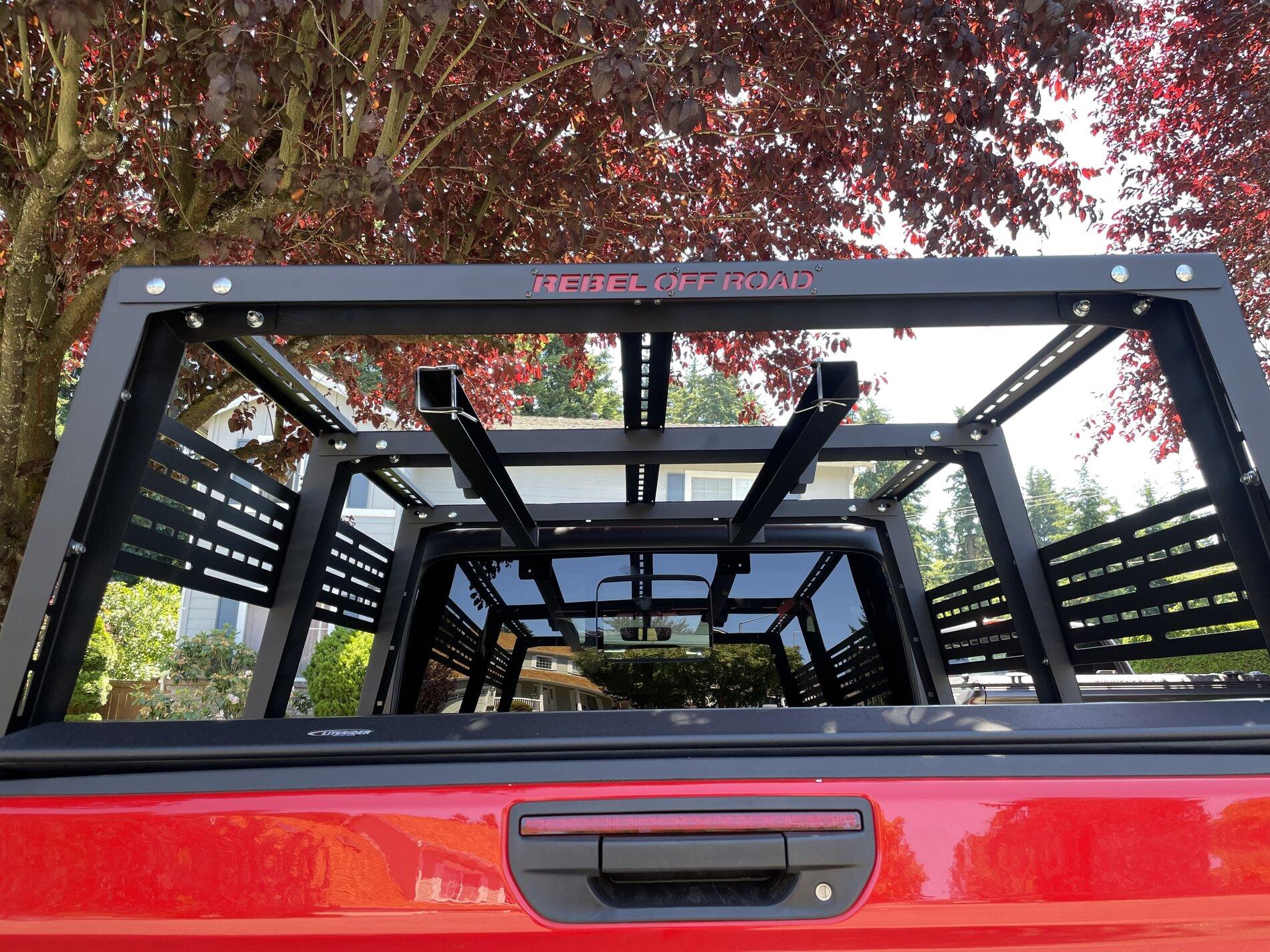

Prior post states they have the Access Literider tonneau cover with their JCR rack.
I have it installed with my Rebel Offroad XPlorer full height rack. I also have the Rebel Offroad rails installed. It is a TIGHT fit because the rails are closer together with the rack installed so closing the cover means having to pry out the rail side a bit. And I had to add some additional weatherstripping along the rail to close the gap between it and the bedside.
