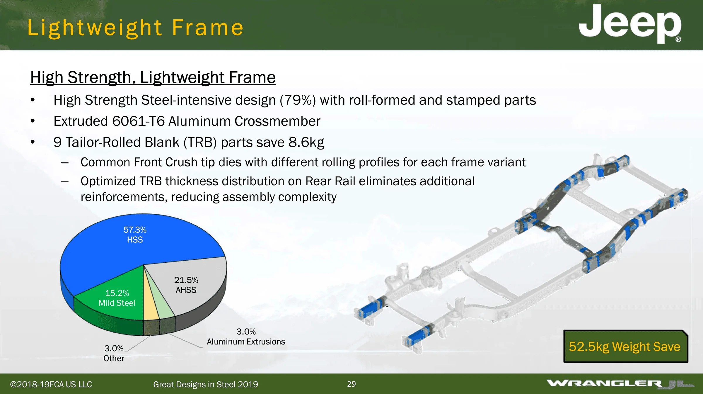

Thats not marketing, HSS and AHSS are desginations of steel. These arent the same steels you got even 10 years ago, this stuff is significantly stronger pound for pound than the old school steels.
Yes i know this is for the wrangler, but I cant find the exact one for the gladiator, I cant imagine its any weaker.
Nothing here mentions HSS, and nothing here mentions strength numbers. These infographics are useless.
Also, @ShadowsPapa is correct that HSS stands for High Speed Steel. I cannot find anything to indicate that the Mojave uses high speed steel (HSS).
The jeep infographic literally states high strength steel and advanced high strength steel.
Jeep Gladiator Bent Frame - Part Deux 1639415464319
Seriously just google a little bit. HSS means a lot of things, but they are specifically calling out High Strength and Advanced High Strength steel which in the automotive industry is abbrieviated to HSS and AHSS because we're not in a machine shop making drill bits.

We arent in a machine shop talking about drill bits, pretty much every automotive source that is put out there shortens high strength steel to be HSS and advanced high strength steel as AHSS. Your argument is that you like your abbreviation to mean this while I keep saying HIGH STRENGTH STEEL and shortening it to HSS like pretty much every other sane person does. If you have an issue i will make sure to spell out HIGH STRENGTH STEEL every time, instead of using the abbreviation that is most commonly associated with it.
But that is NOT HSS and you kept mentioning HSS - HSS is High SPEED Steel - for cutting tools and so on.
In any case you are incorrect about how these frames work, the tensile strength and so on.
Call it whatever, and yes, you apparently do need a machine shop class because that's where yo learn about these materials, HSS, or high strength steel or advances high strength steel and their properties, how to weld them, how to form them, and more.
You were looking up numbers for HSS - high speed steel, and posting the tensile strength and so on and that's not the same as high strength - so when you looked up your numbers, you got the wrong stuff. High strength steel tensile strength starts as low as about 440 and you were giving numbers for HSS - almost double that.
That's because Jeep does NOT use HSS.
They don't mention numbers because there are ranges for that. high strength steel and advanced high strength steel have ranges for their various properties.
If a person were to go to google and try to look up numbers for HSS - they'd be dead wrong because Jeep doesn't use HSS. That's totally different alloys than high STRENGTH steel or advanced high strength steel.

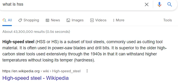

Wrong there - go in and type "what is HSS.
You will get this - I've been at this too long to not know what HSS is - I have a lifetime of working in and with this sort of thing..........
So let me get this right so we can understand. You're saying that because a fraction of the frame is made with high-strength steel, the frame cannot bend when abused? And you're using a JL infographic with no strength numbers to back this up?
I'm not saying your necessarily wrong. I'm saying you have absolutely nothing here that helps anyone.
How someone defines HSS is not the hill to die on here. Because not matter how you define it, there's nothing usable in these posts!
80% of the frame is not a fraction, literally look at the graphic. Also the type of steel has strength numbers to be classified as such. I mentioned its a JL frame but unless jeep decided to really cheap out o the gladiator frame it should be of similar construction which is basically everything but the crumple zones is atleast high strength steel.
"High Strength Steel a type of steel that has a yield strength that ranges between 30-80 ksi (210-550 MPa) and a tensile strength between 40-100 ksi (270 to 700 MPa). Steels with yield levels higher than 80 ksi (550 MPa) are considered Advanced High Strength Steels, and when the tensile levels exceed 113 ksi (780 MPa), they are referred to as Ultra High Strength Steels."
