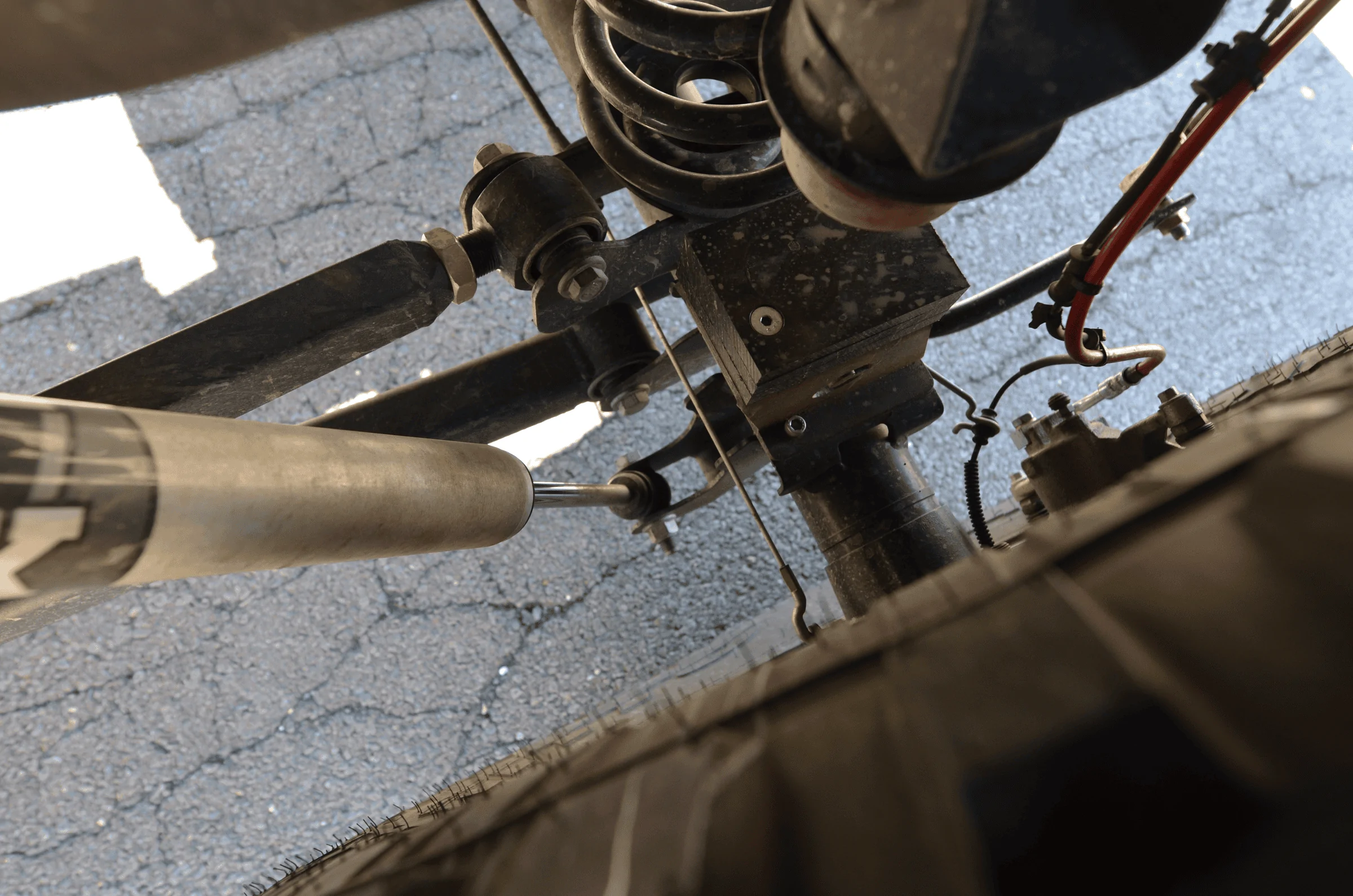

The mojave actually does have a bypass for the hard hits, they are internal bypass shocks. I do not know the compression factor on the mojave shocks though but they are indeed bypass.
When i say the bump stop cups, i mean the steel that the rubber bumper is held in. That hits the flat part of the axle and either the axle or the bump stop are going to have to give unless they are stronger than the frame. On the raptors the bump stop cup (the actual steel opening) is designed as a crumple spot to actually absorb this kind of force before the frame bends.

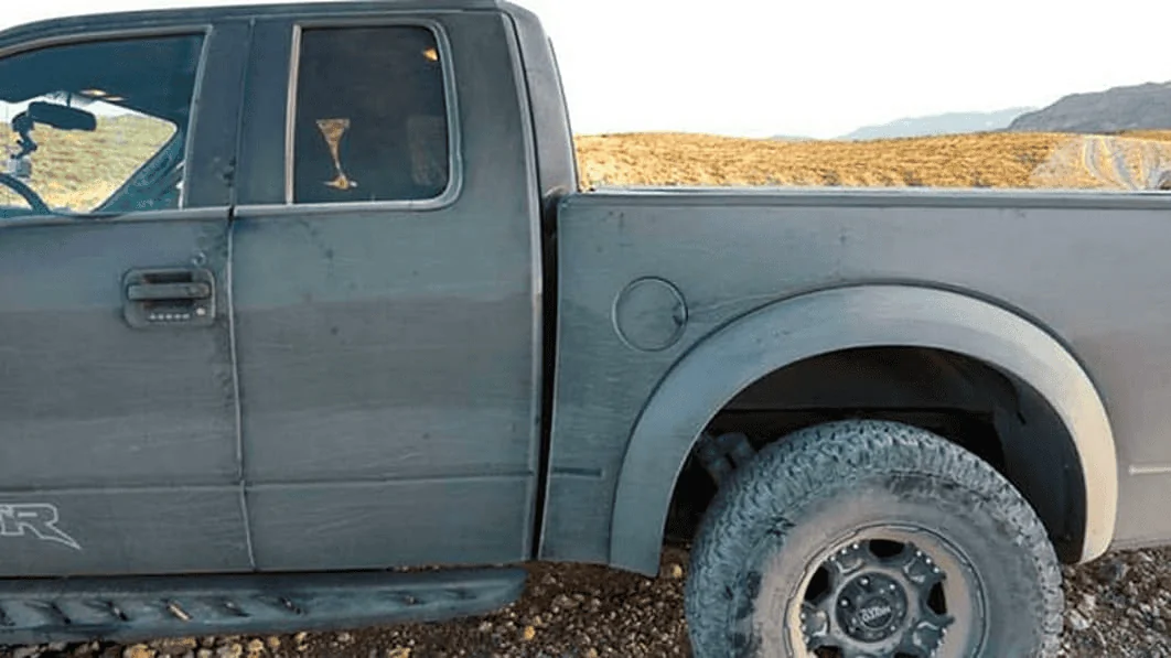

Here is an old article on it from the raptor when this damage happened, notice the picture looks exactly like this and the SVT boss explains what happened:
"Basically, the core – the root cause – is that the vehicle is traveling too fast for the obstacle, and the truck is running out of travel. By a large margin. They're going too fast for the obstacle by a large margin. The frame is not the first item to yield in that condition – despite what's been theorized, the first thing when you do exceed the vehicle's travel capability [is that] you have a certain safety zone where you will hit the bump stop and nothing will happen. If you hit that same obstacle at an even faster speed, then you will yield the jounce bumper cup – that's the little piece of steel that holds the jounce bumper. If you hit that same obstacle at an even greater speed, then the next thing to go is the frame.

This is the bump stop cup jounce cup, whatever you want to call it, notice the little cup with the flat lip designed to hit on a bottom out. The cup and the spot it sits on look like a crumple spot to me given the thiness of the material and the lack of reinforcement. Lets ask the OP for a picture of those and see what they look like.

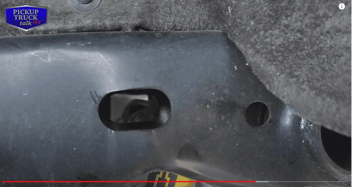

Below is a bent frame, bent downward as designed to do.
The guy in the video explains how the forces can combine to bend things and uses his hands to sort of show the movement and forces involved.
