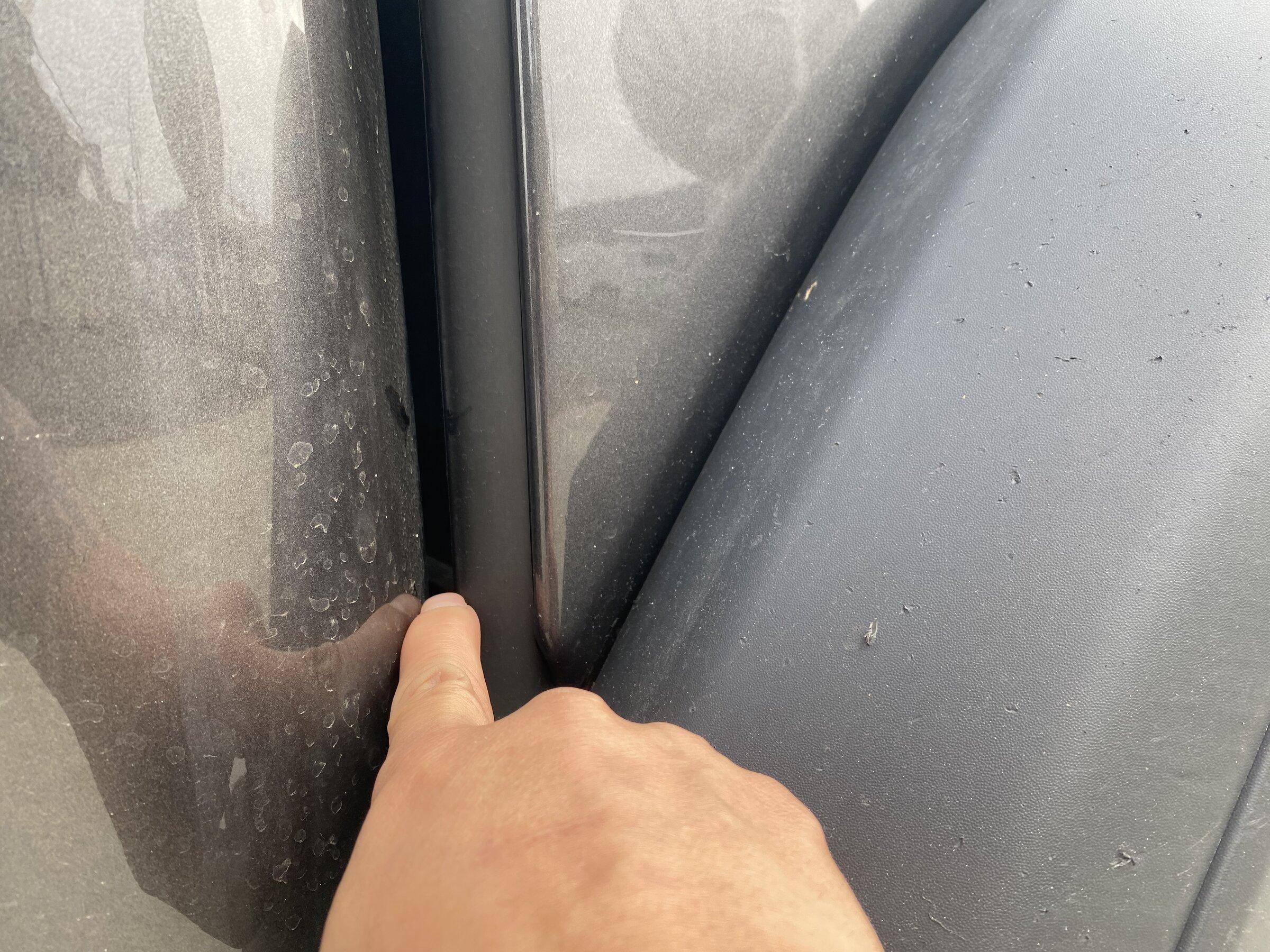

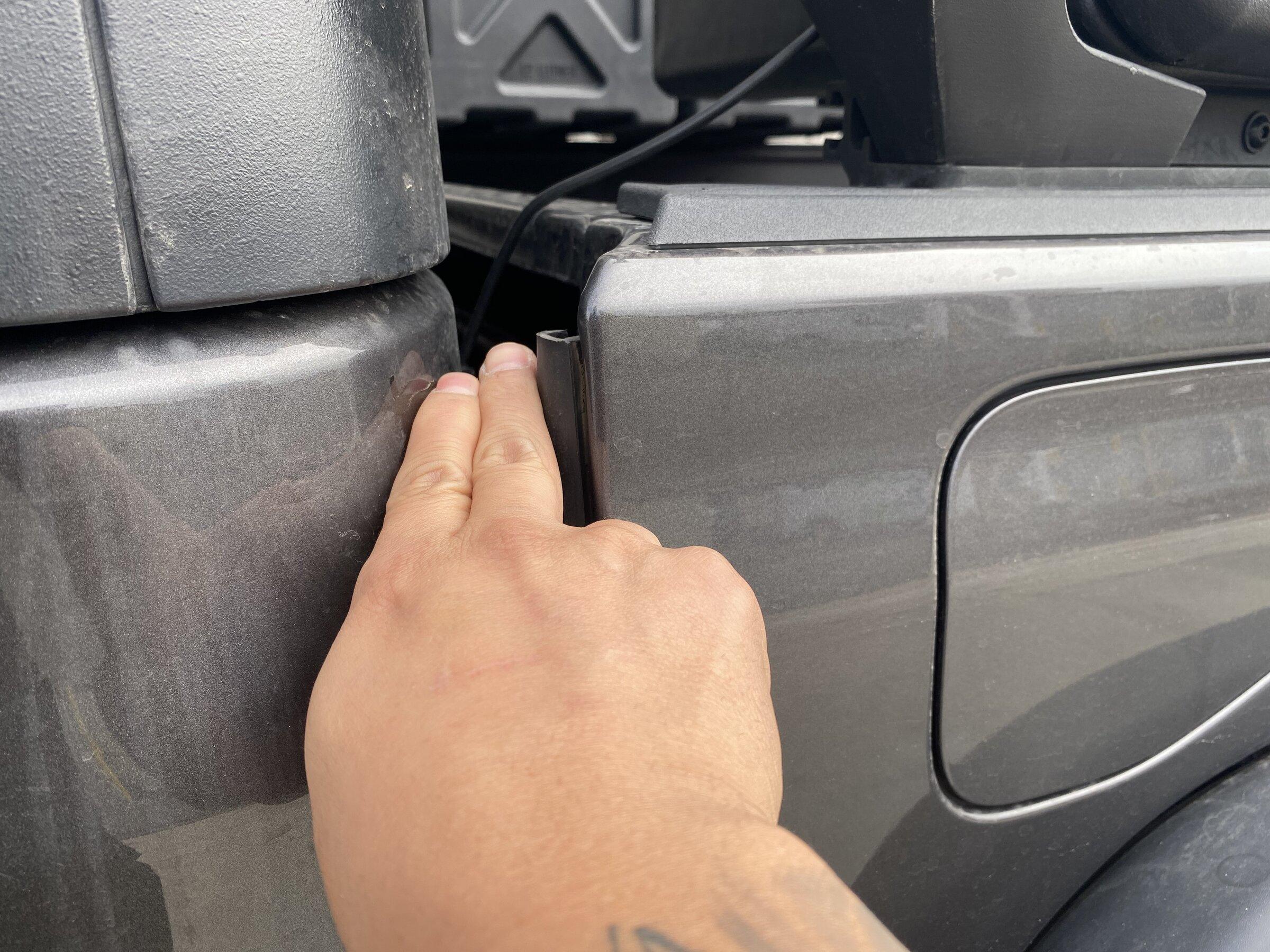

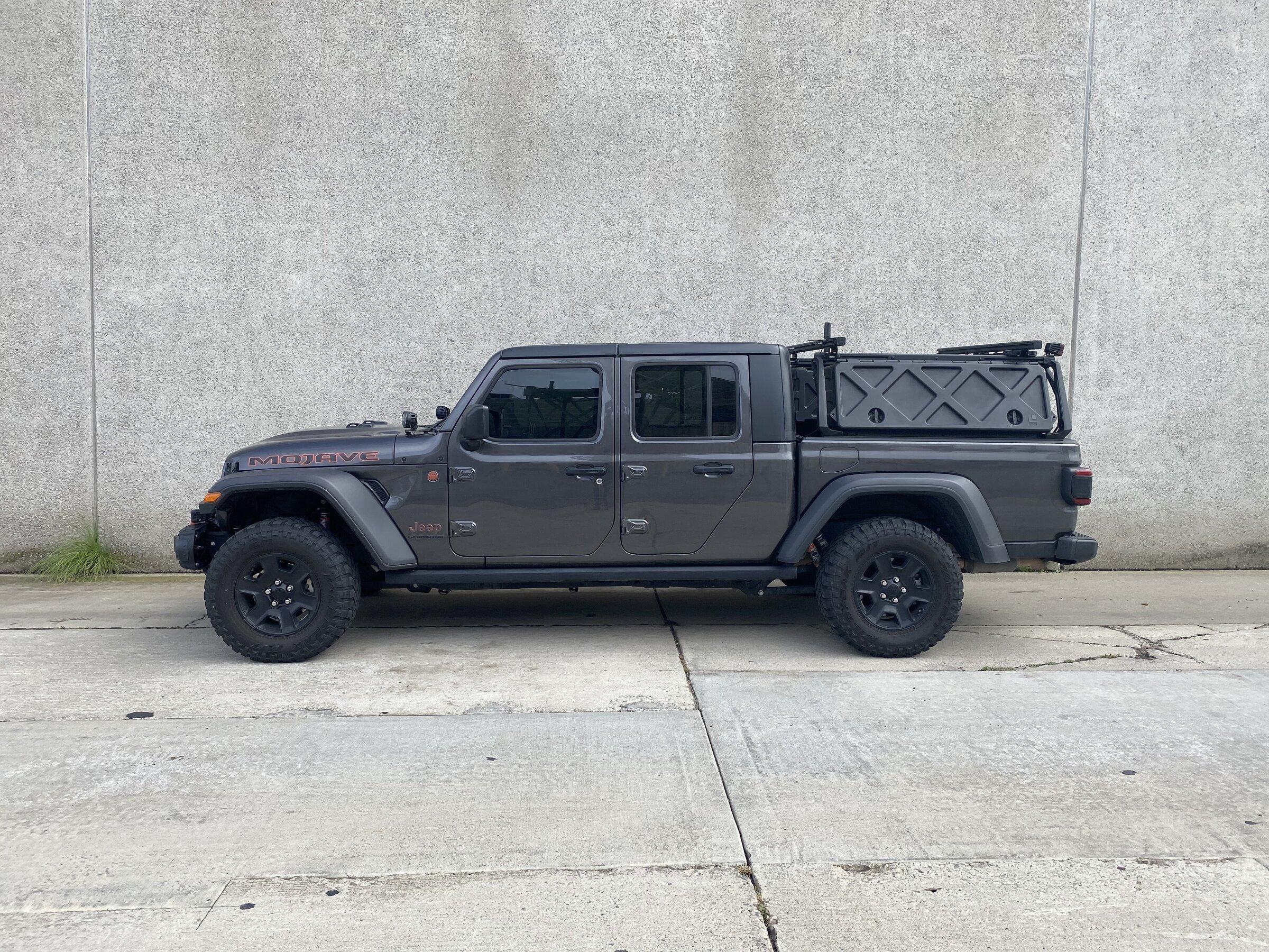

Here are some shots I took before heading out..
At the time:
Bed rack w/ accessories 175 lbs
Rooftop tent 134lbs
Tire carrier 65lbs plus the 33” spare tire

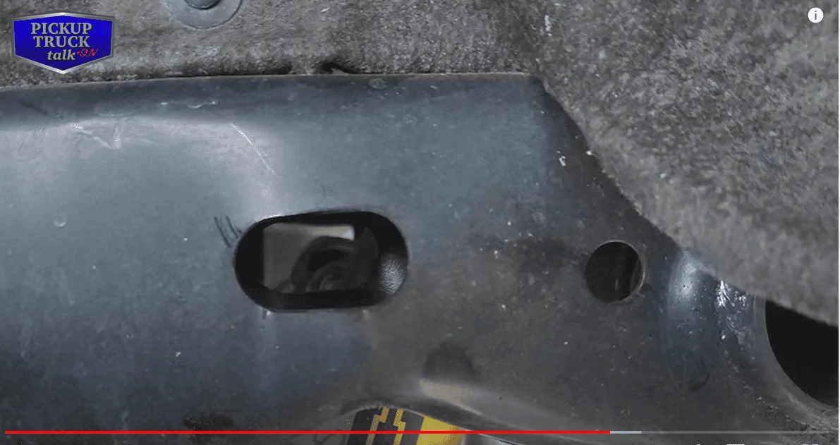

Watch this video. It might offer some clues.
249
40,515
54,112
Yeah, looks like the one I posted earlier - and the comments section has some good info as well. Another engineer chimed in.
Bottom lines -
Frames DO bend (there's proof all over the place)
They don't bend under normal use (otherwise I might be in some trouble as I load cars onto my trailer and the bed settles down in front)
There's photographic proof that frames do bend.
There are engineers explaining how and why, where they are likely to give and for what reason.

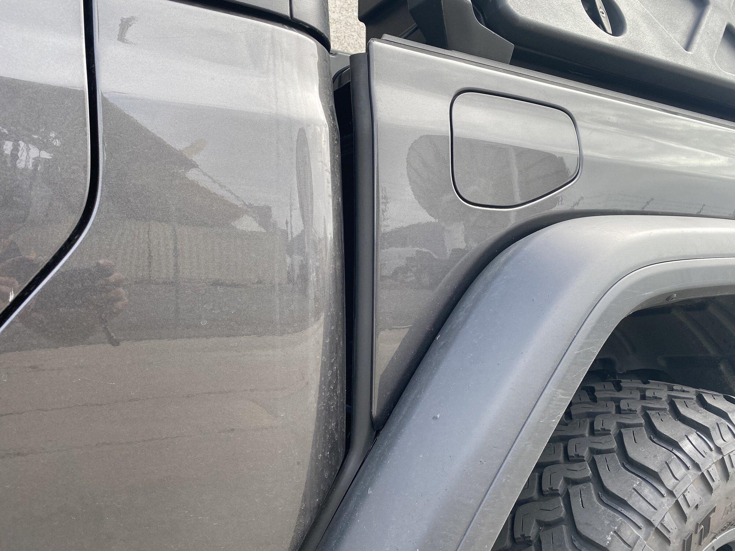

Was there any pictures of the actual frame?
I'm betting the bed bent instead with all the weight.

Need to remember that the frame is not reinforced like a trophy truck to prevent from warping when you beat the shit out of it. The warping can be pretty small where things still drive straight but you'd notice body lines not lining up evenly. There's a reason professional race trucks and pre-runners had a ton of cross bracing. And I don't just mean a beam from one frame to the other
