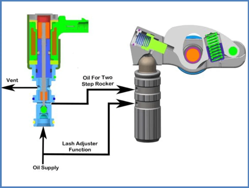

Lifters - hydraulic ones -

2016 and later VVL lash adjuster -

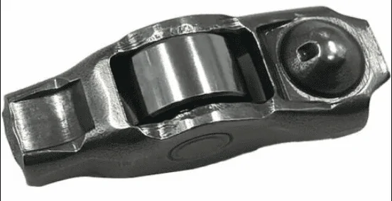

Rocker arm or follower for 2016 and later VVL 3.6 -
The rollers and the bearings in the rollers don't fall apart, the inner high lift lobe and the high lift part of the rocker get toasted.
Jeep Gladiator Beware 3.6 Penstar cam-follower

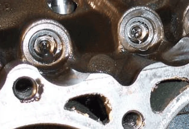

This is the early 3.6 that the law suit is about -
Jeep Gladiator Beware 3.6 Penstar 1660087575662

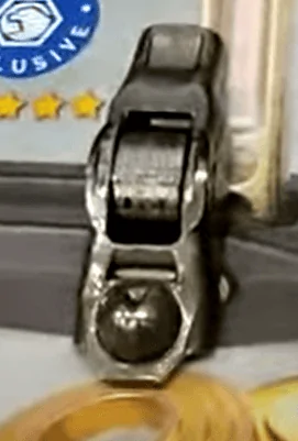

Totally different animal. It's the bearings in the rollers that blow up -
This is an example where the needle bearings went south and the roller stopped rolling
This is typical but not the only way the early 3.6 valve train failed, just the most common.

So the failures are valve train, but to say it's the same "design flaw" that caused the pre-2016 3.6 failures is what's causing the JT 3.6 to fail........... they are failing in different ways.

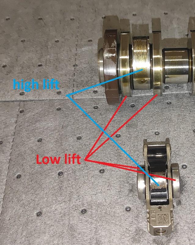

The current 3.6 has dual rollers for low lift mode, and in high lift mode (above 2800 RPM) it stops using the rollers and runs like a flat tappet cam situation - no rollers.
Not familiar with that config. Makes me wonder if it needs a higher zinc ppm oil?
