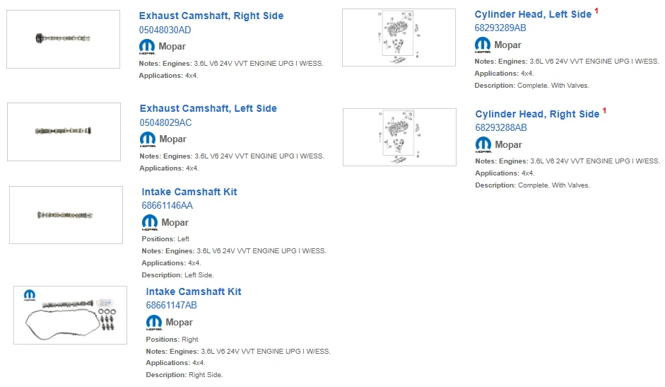

I'm curious - are the cam part numbers the same?
Same heads and cams for the UPG I 3.6 RAM 1500 and JL/JT.
The RAM 1500 has 20HP more with the same torque.

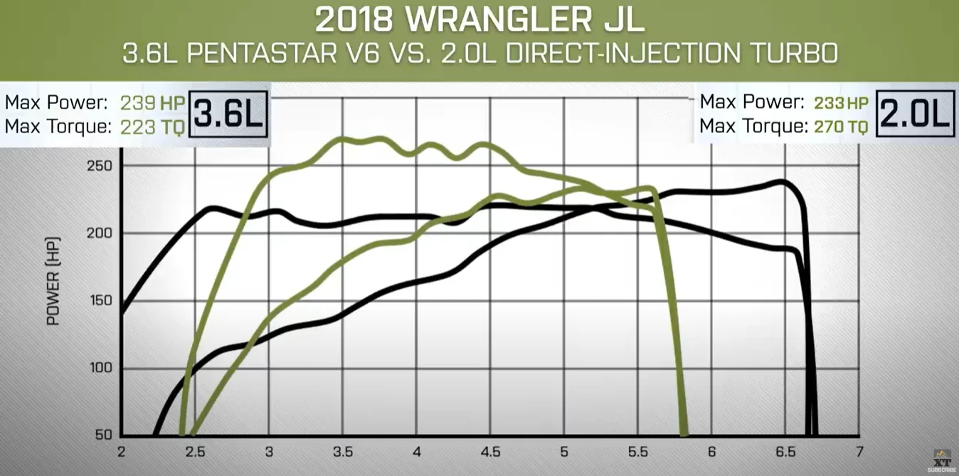

The gain for the RAM has to be in the tuning for that extra 20 HP. A DOHC 4 valve engine tends to be high revving with the 3.6 the power is upstairs absent of low end torque. In contrast to 2.0L turbo on the dyno has allot more low to mid range torque than the 3.6l.
