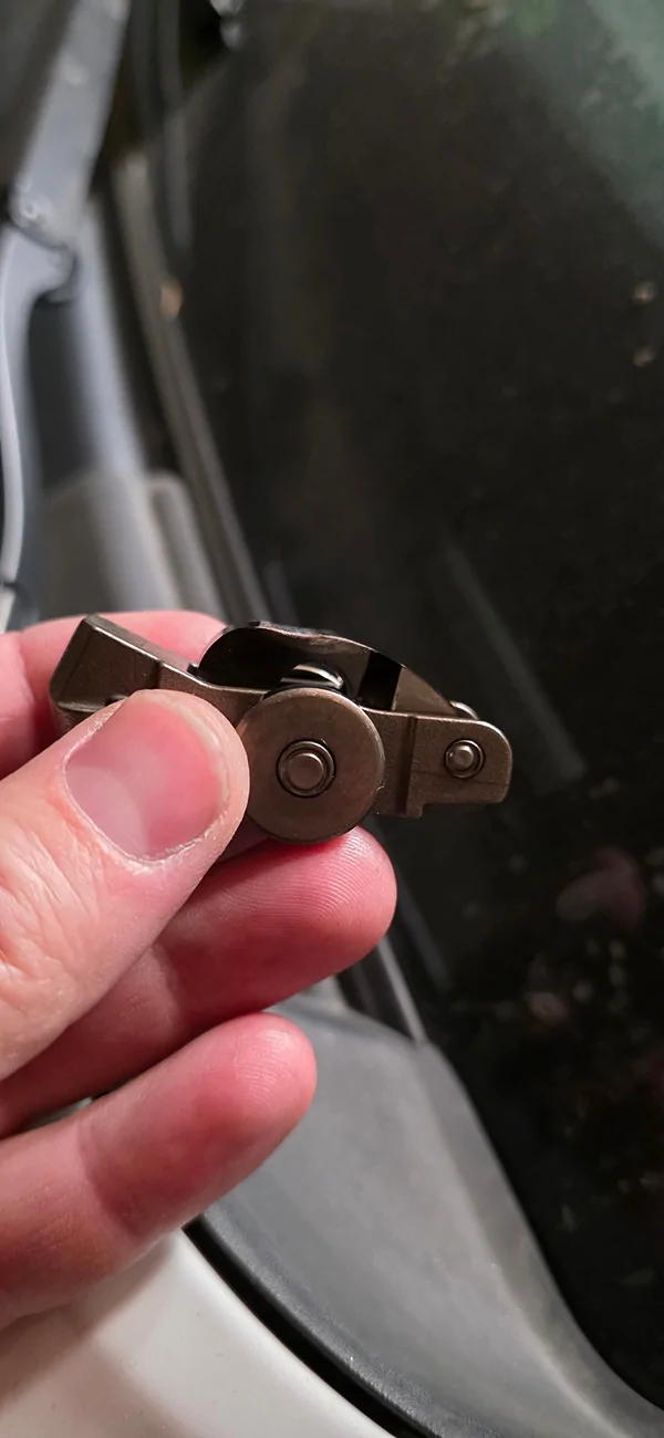

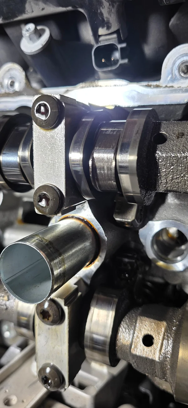

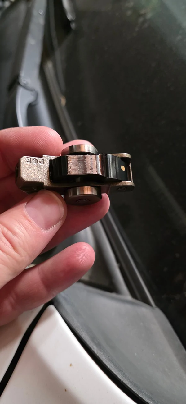

I have a question at the end of this...
My vehicle has just over 114K miles and this is what I found after pulling off the right cover. I could hear this underlying knock/tap sound which was easier to hear from inside the vehicle at some points. Also while driving, I would get this clacking noise periodically while under light acceleration. After watching bmpcamry's video, I think I now know what that loud clacking was. Haha
A few days before I opened up the valve cover, the engine made that loud clacking noise a lot worse than it had done previously. Just for a second or two...
I stopped driving it. Did my own oil change and inspected the oil filter. I could see very tiny glitter in the filter media. It was only the fwd valve on Cyl #1. All the other lobes looked just fine. Replaced the camshaft, all lash adjusters and rockers.
So, my question: I was researching about the lash adjusters for the intake rockers. I heard its best to not install them fully pumped up, but with a little give in them and let the engine finish priming them when I crank it before starting. If I remember correctly, two of the six had a little bit of give and the others felt firm. Any thoughts?

Yeah, rockers are supposed to have a bit of wiggle to them (though wiggle isn't even the right word because that makes it sound loose). Not sure how wide spread that would be though across all engine assemblies.
