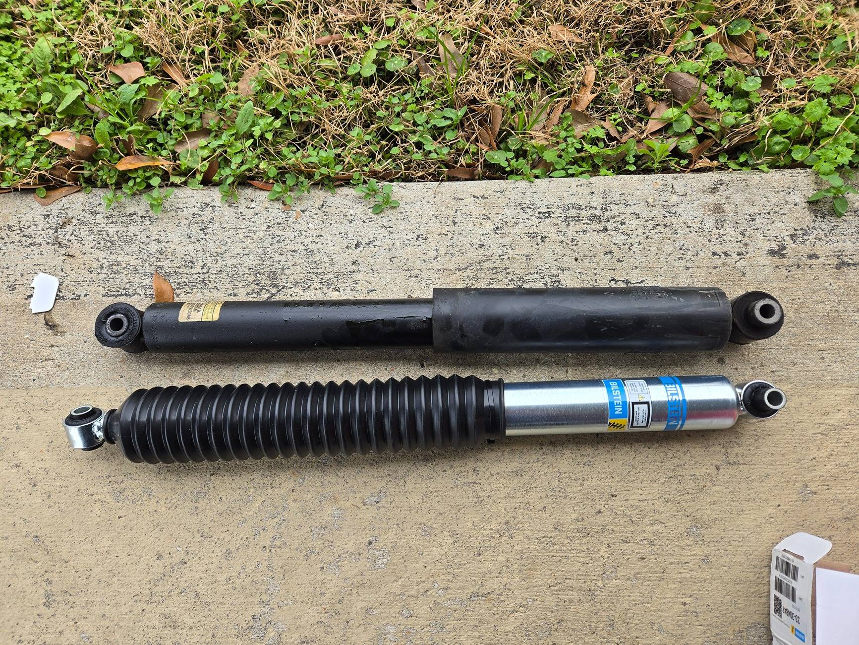

What’s your takeaway on it so far? Where do you compare it to in the line up of 2.0 shock bodies?
How many miles have you put in the 5100s?
Some may not know this but the 5100s are actually extended shock bodies since their shaft is slightly longer than other 2.0 shocks.
