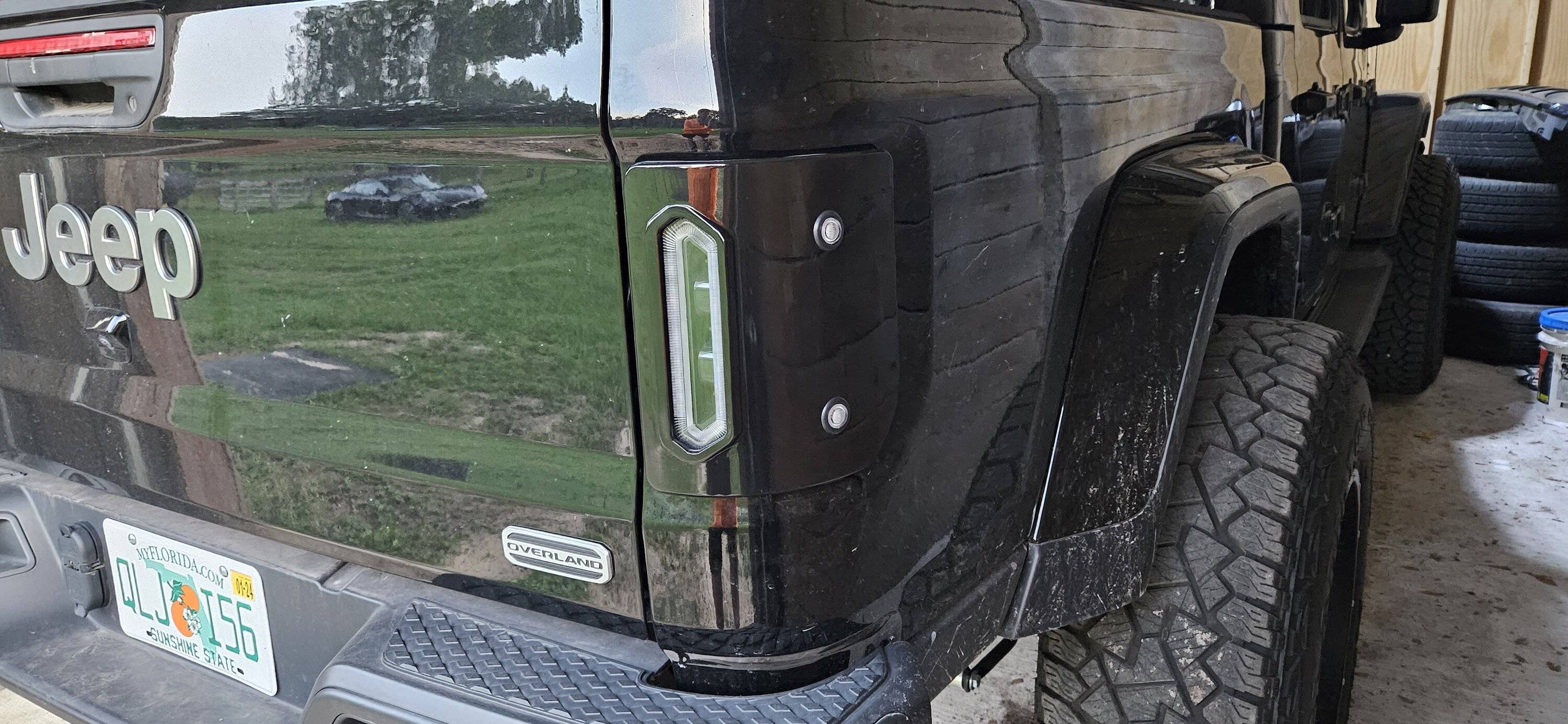

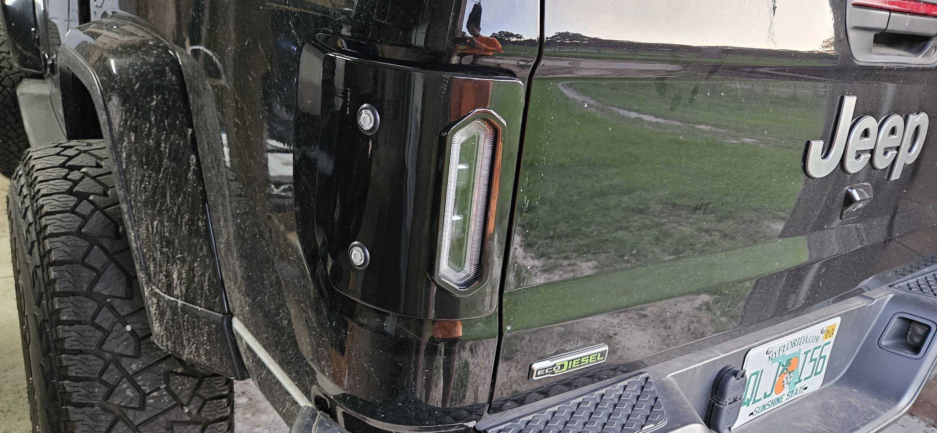

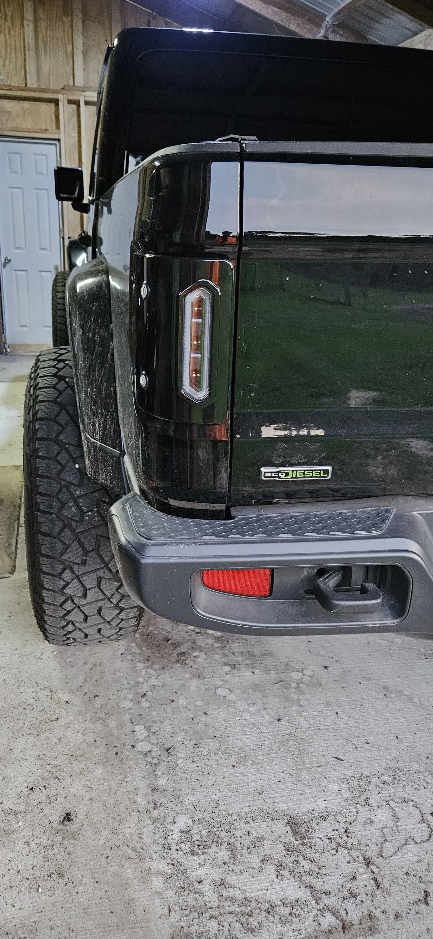

Here's the final version for my gladiator all painted. Found some corner lights that work with blinkers now too.
I personally love this set up, literally nothing I'd change.
I can't wait to get a set on my truck.

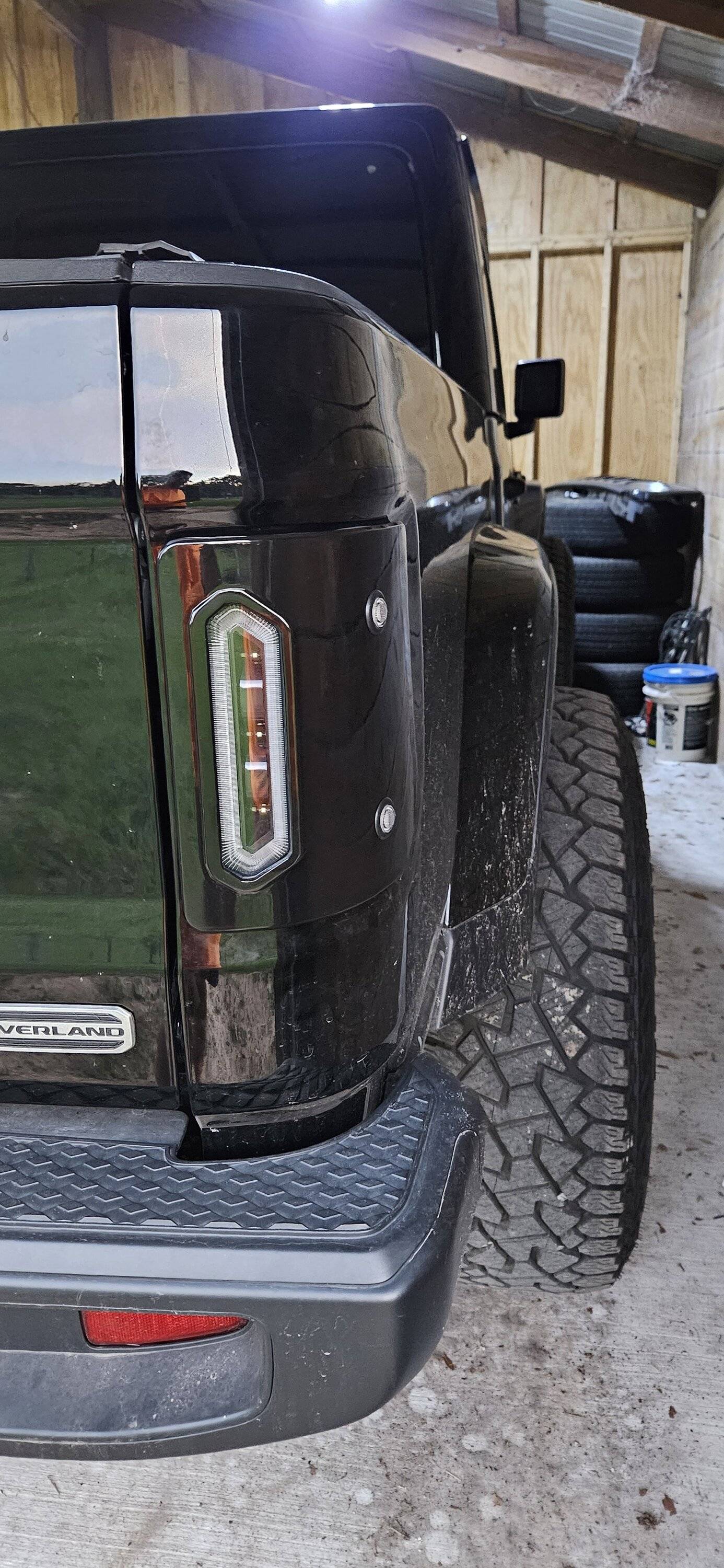

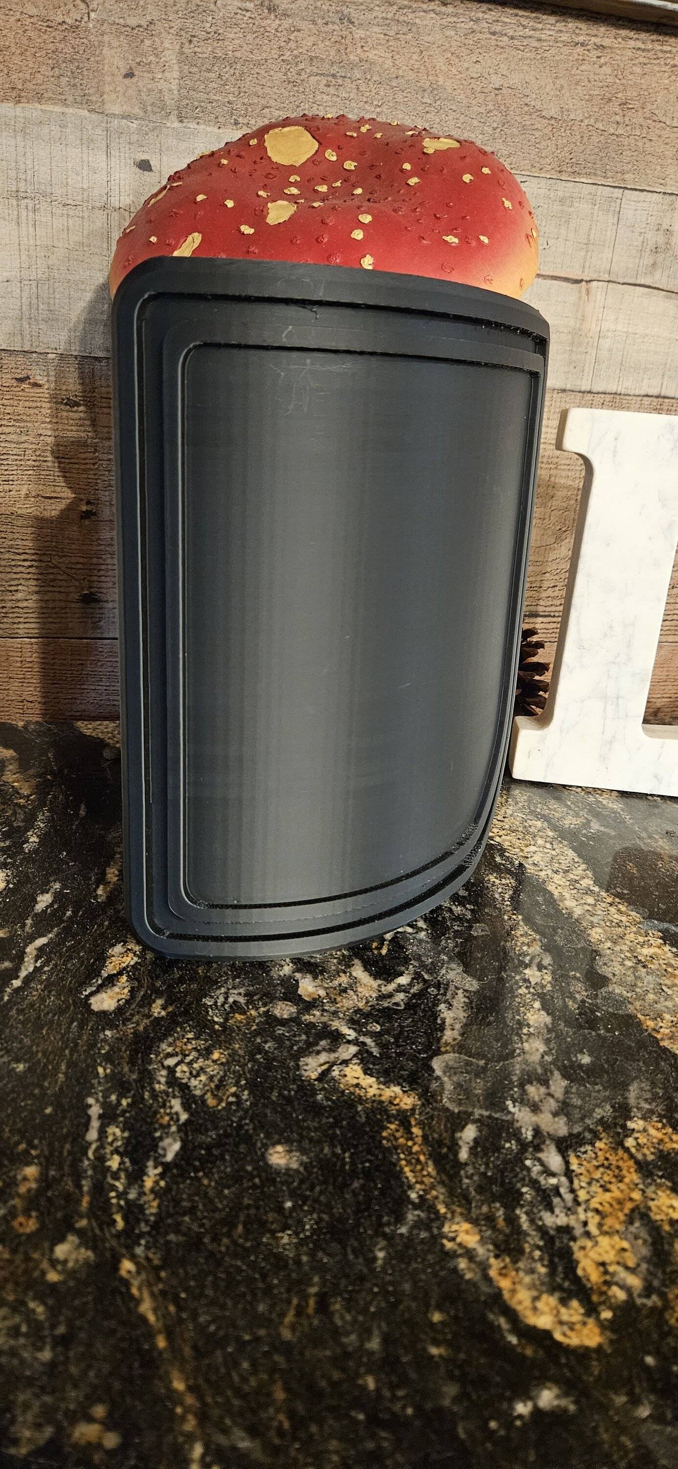

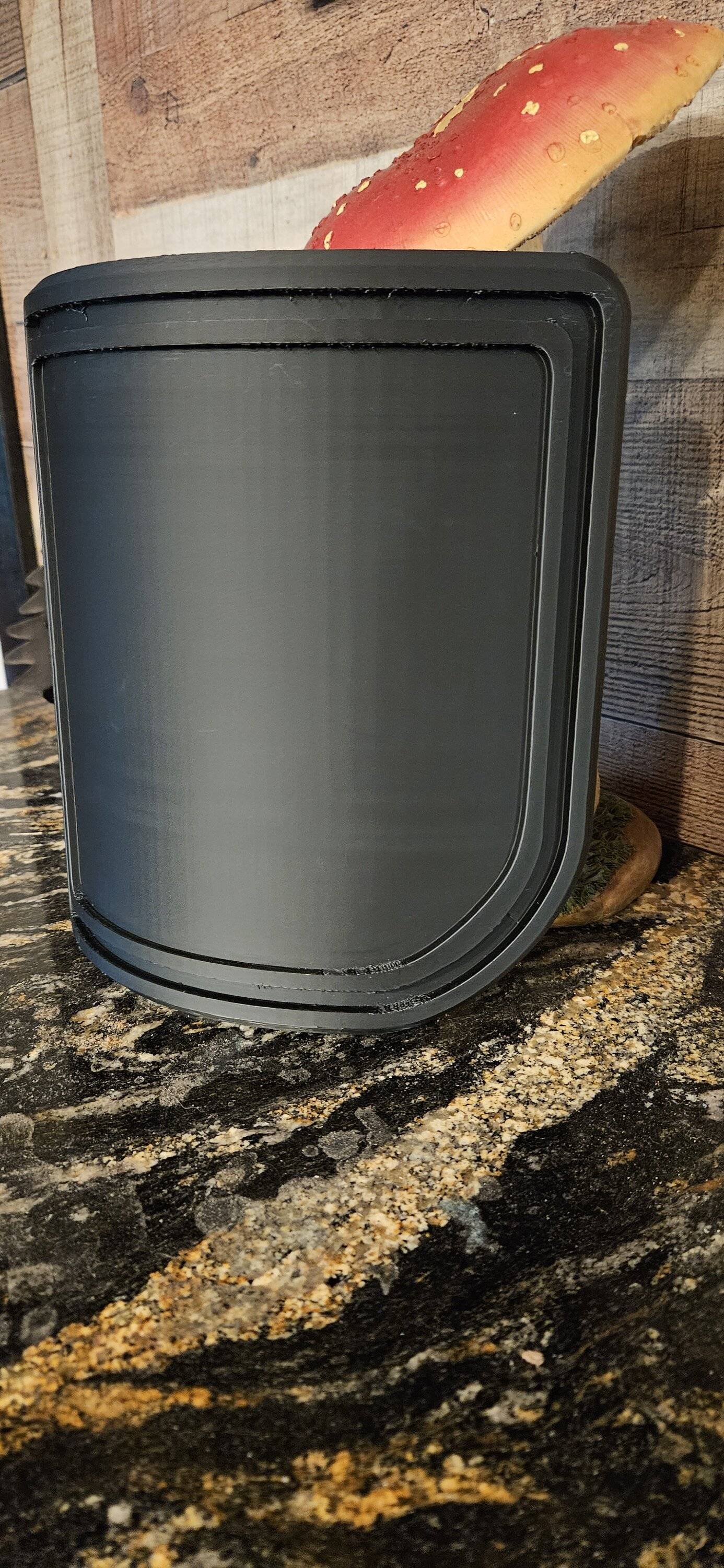

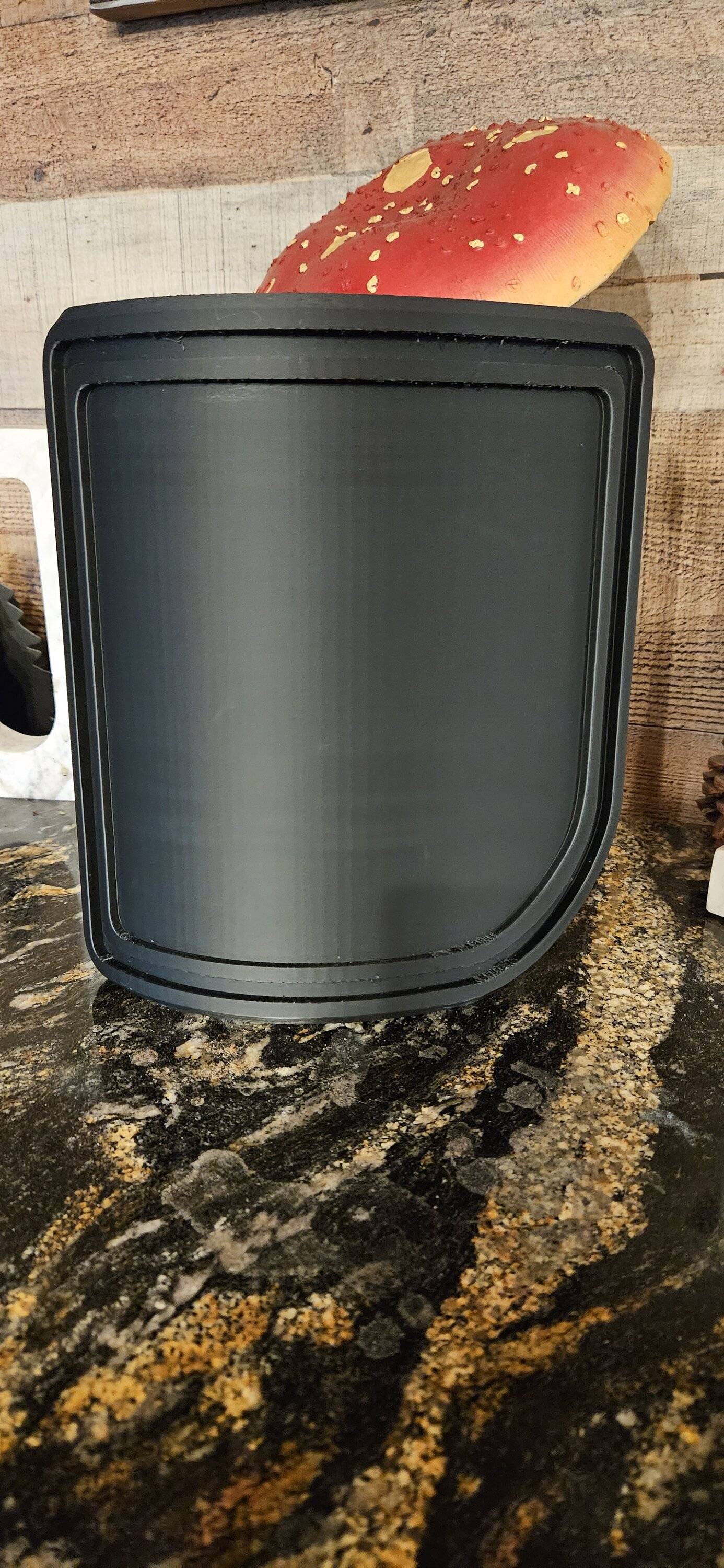

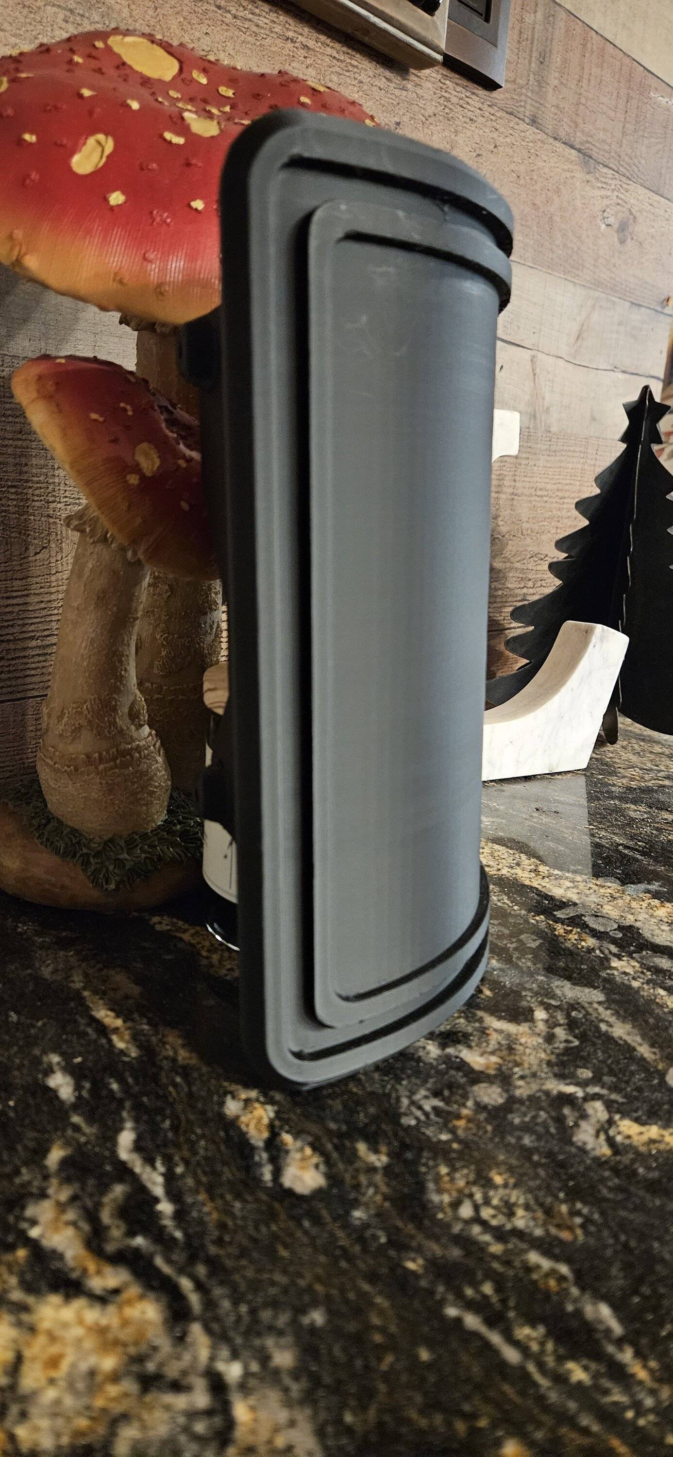

We will see how the LEDs fit when they arrive tomorrow :)
Not bad for a ruff draft so far
You all have no idea how hard it was to cad this...
This is looking killer. Can't wait to see how it looks with the lights in. I wonder if widening the strip would be better, give it a ring for running lights and then 2 for the brakes. What's the idea for reverse lights?

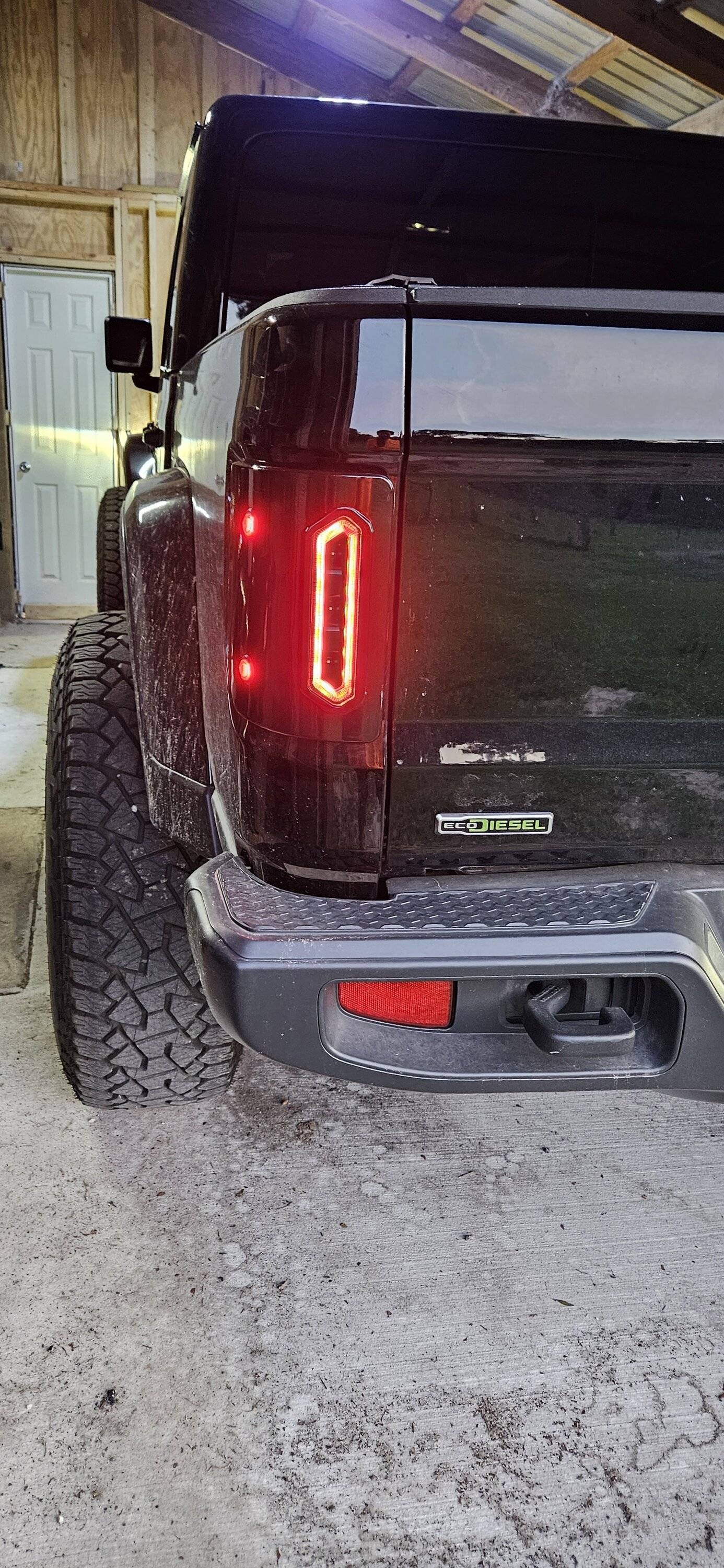

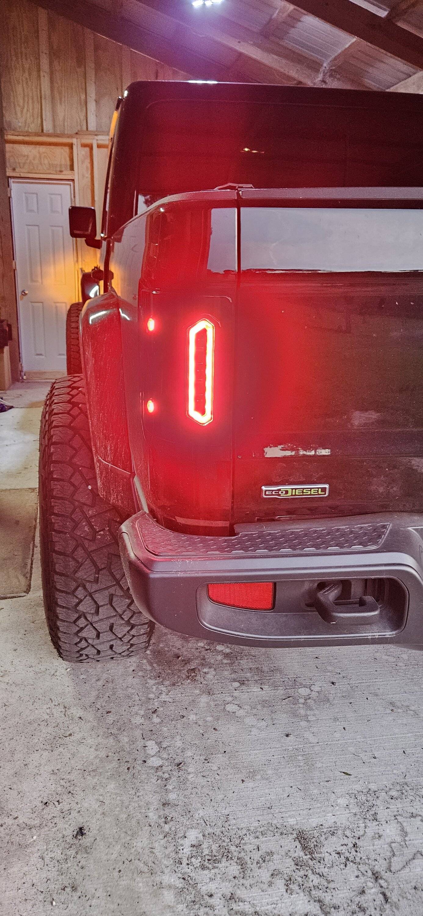

The one strip of red should be bright enough for both running and brake lights with some wiring magic to dim the lights for running lights and full power for brake and turn...
I plan on widening the channel and putting a white strip in for reverse lol... Figure that would be pretty cool....
Then in all the blank area maybe put a lit up gladiator logo or something....

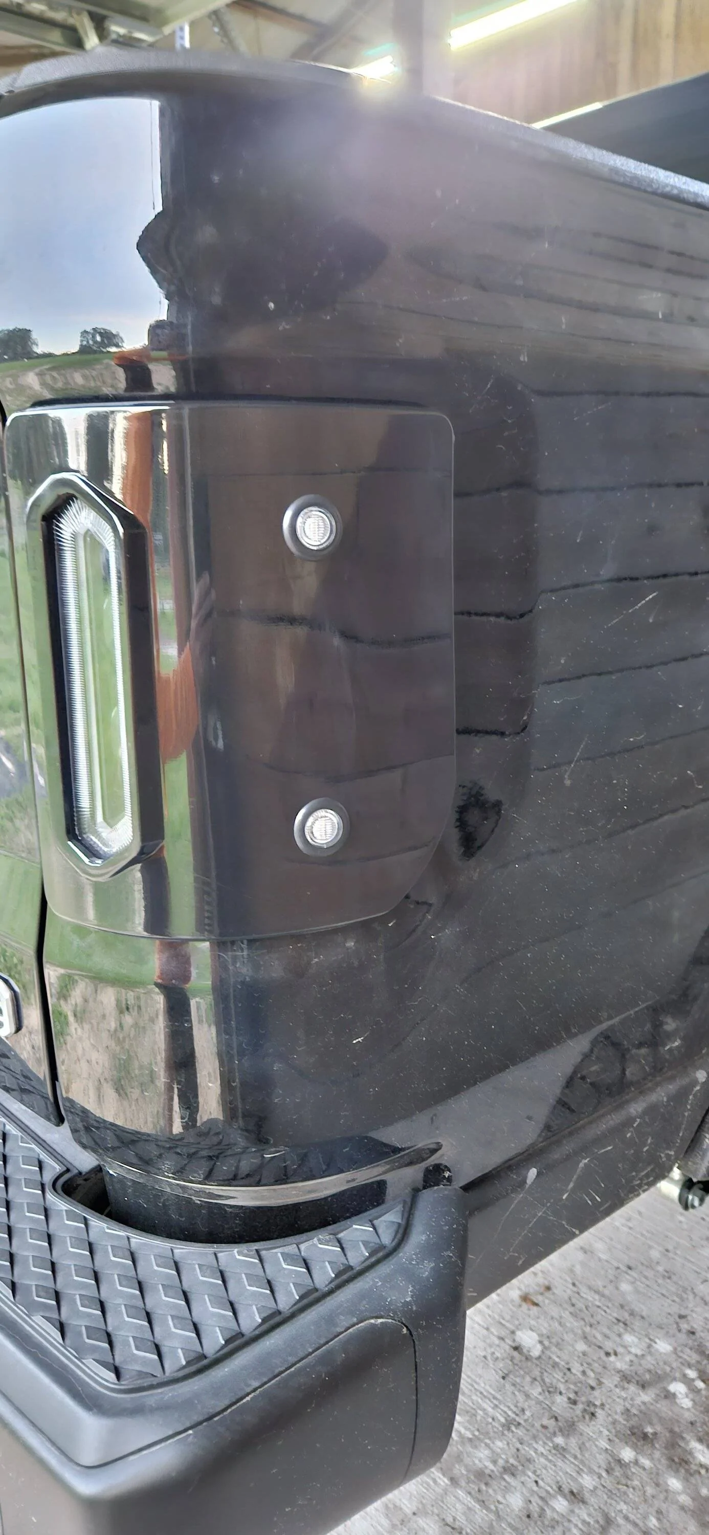

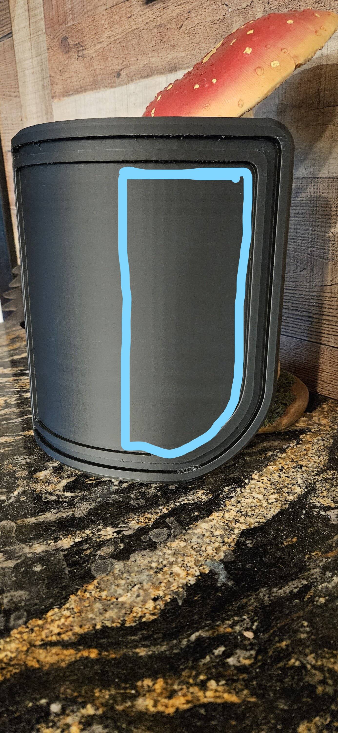

Can you remove excess material where all the blank space is? I know part of it is needed for support. Just throwing other ideas out, might end up looking bad. I have a vinyl wrap so that would show.
Jeep Gladiator Building my own flush tail lights Inked20230529_184835_
Justinswidebody
Dec 21, 2022
463
1,142
Ocala
Jeep gladiator
I guess once the lights are in you will know more on how to adjust it.

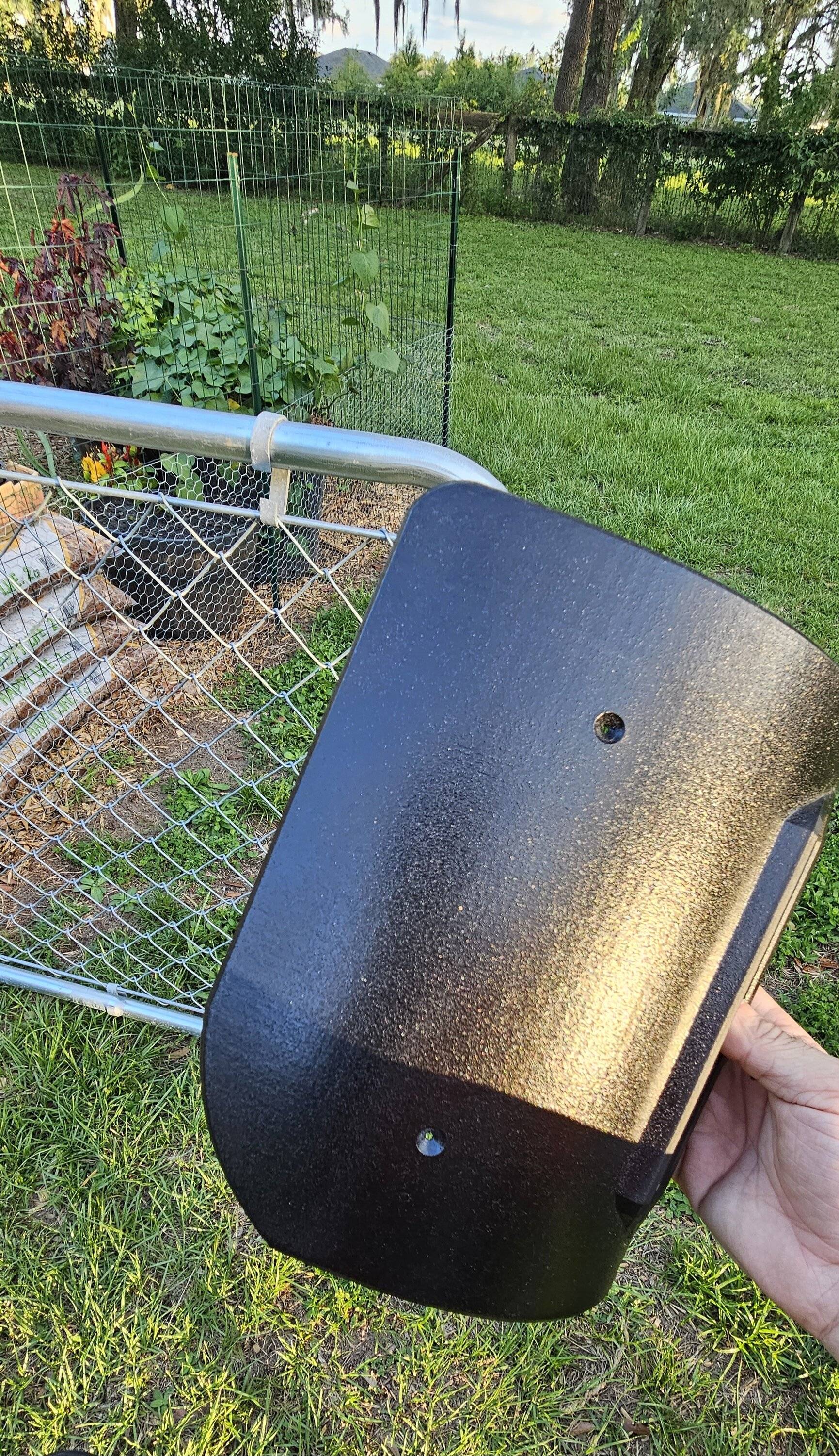

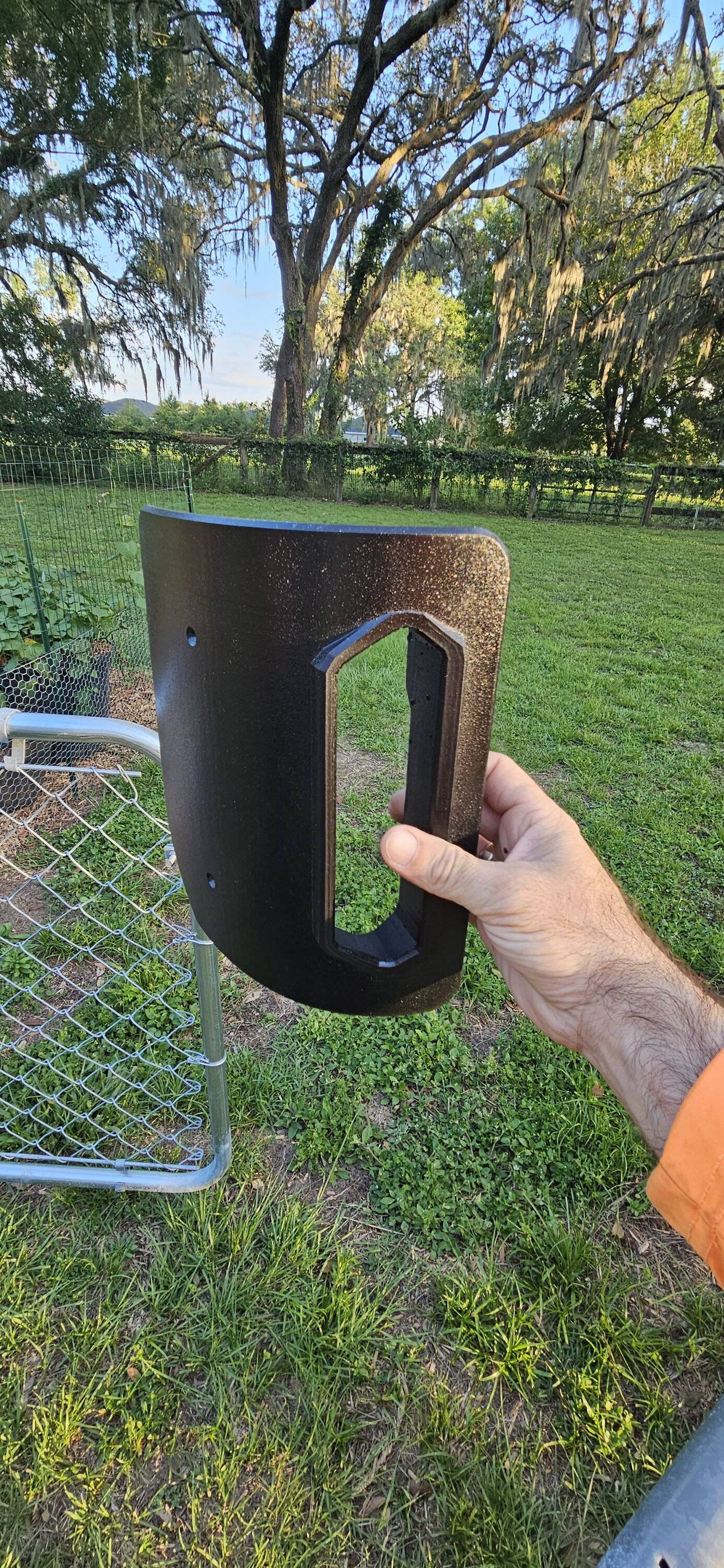

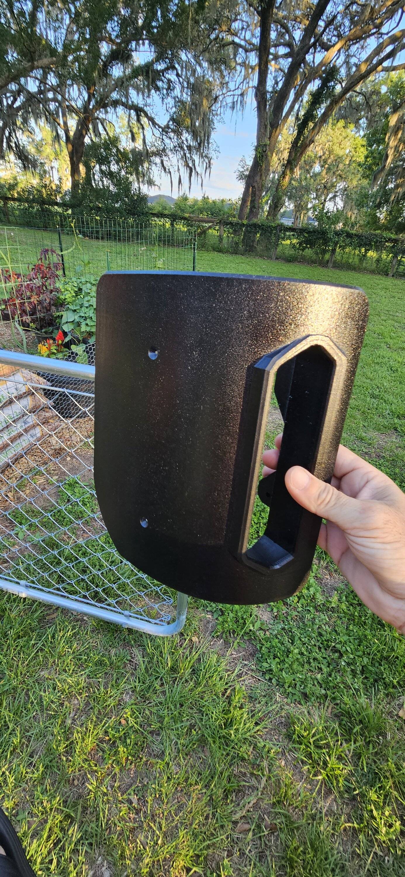

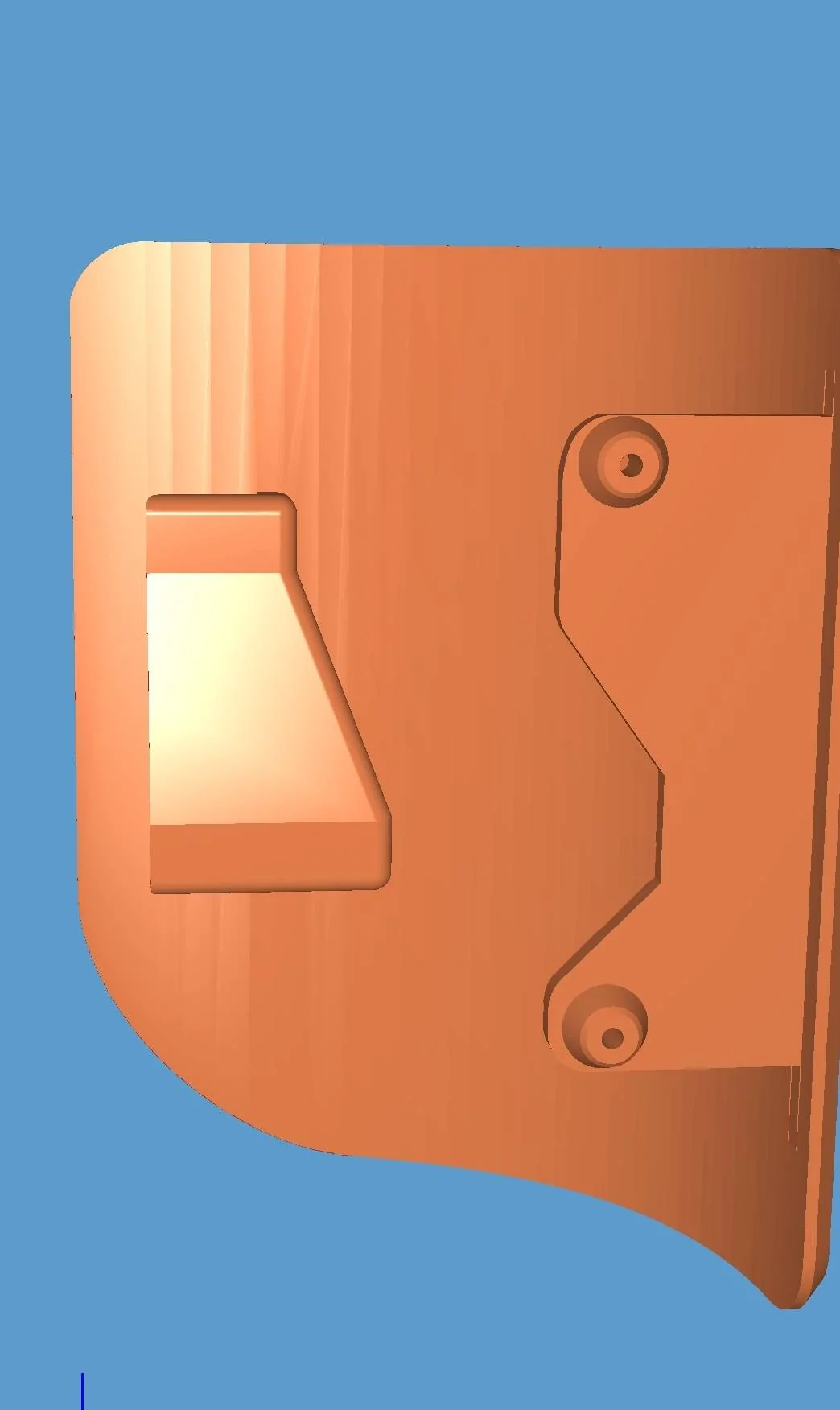

Do you mean to remove this entire area? Where you can see through it?
Sorry I'm a little confused.
Can't remove this area because it's where the hook to hook into the body is.

Yeah that is what I was thinking. Like I said I wasn't sure where the internal supports were located.
There is just so much blank space, since you have to use most of the outline of the OEM taillight to cover the hole in the sheet metal. Maybe a raised gladiator outline in the area, I think if it gets illuminated it would look busy.
I wonder if there is a compromise between this LED channel and the Oracle light channel. I think the Oracle lights are to big and this might seem small. All that said if the lights go in here and they look good then this is moot point.
