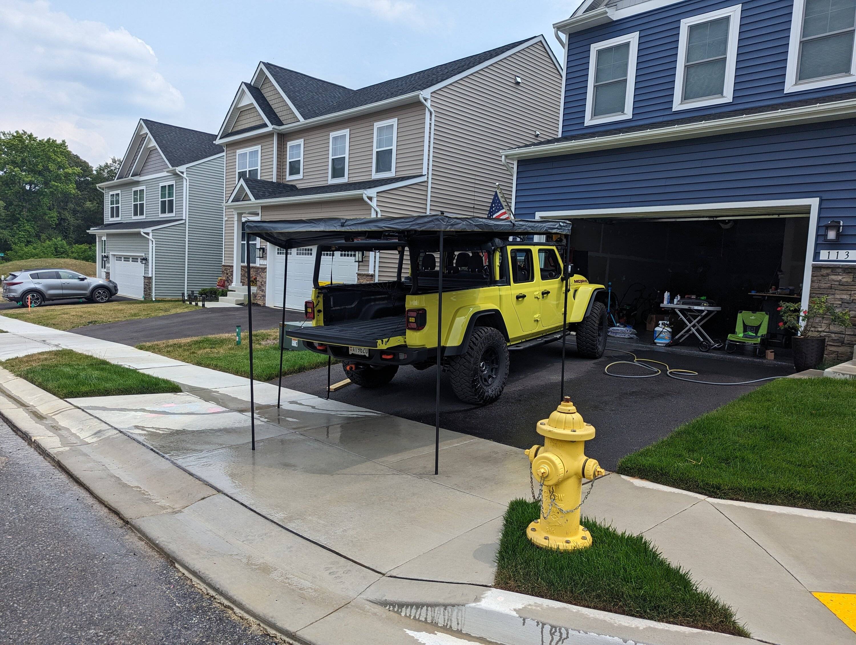

Only thing missing......some of those sweet flush mount tail lights ????

How you haven't petitioned your city to repaint the hydrant in HVY, is beyond me. Just a few shades and you've got a HVY hydrant to match your JT :movember:

Well I do have a spare can............sounds like a perfect drunk project LMAO ????
