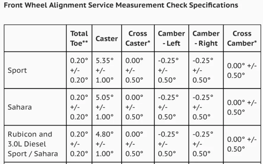

Didnt find the JT specs but here are the JL specs. So pretty much 4 to 6 degrees

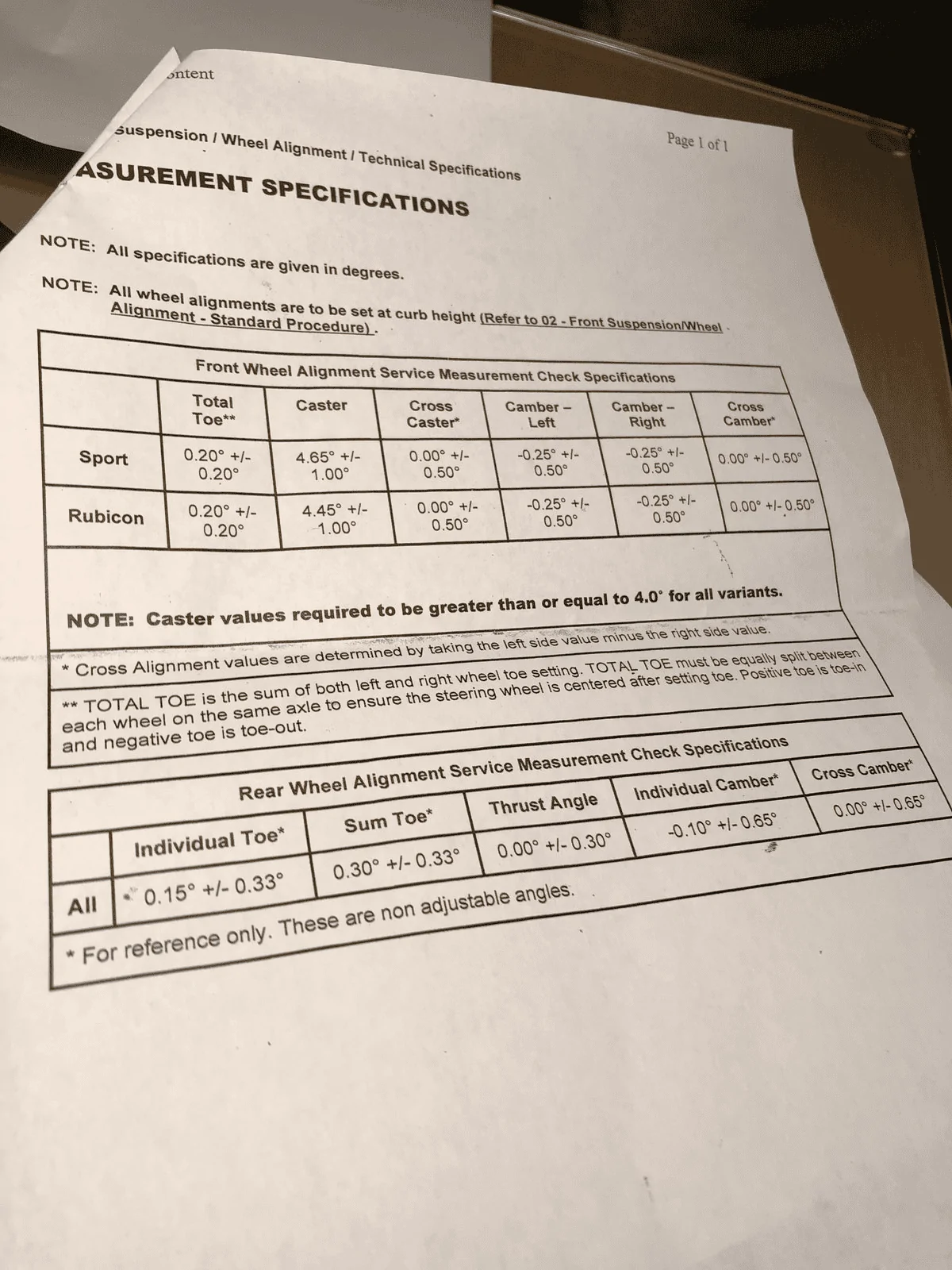

Ahh, JT specs!
Jeep Gladiator Cam Bolts 1628195679891
40,456
53,893
Slight negative camber - interesting.........
