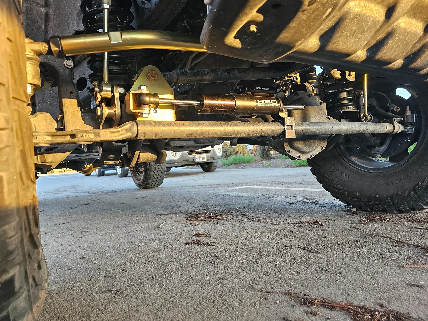

Not Necessary doesn't mean it won't drive better. Mine has 3.5" metalcloak springs, their high steer (which also raises the front track bar making for better geometry and less side to side movements hitting bumps), drop brackets, and the rock krawler triangulated 4 link in the rear. All together they've made this the best riding Jeep we've ever owned and there's been more than a dozen over the years. Control arms allow you to center the axles and add caster, but do nothing for the geometry. Flatter arms will always ride better. If you weren't clear across the country I'd offer to let you drive it to see how much better it is. Mine sees hundreds of miles of washboard dirt roads every year so bump handling at speed was my main focus of the build and it's great now.
Jeep Gladiator Can I improve the steering/driving experience any more? 20250114_164456
Alright you might have sold me 😂 does Metalcloak use the same drag link whether it’s flipped or not? I just purchased their drag link so I’d hate to have to get rid of it. Then I need to figure out which drop brackets to go with.
I'm not 100% sure but I think it's the same drag link for either orientation.
I’m going to call them tomorrow when they’re open. The tie rod and drag link nuts aren’t supposed to be reused either so I’m going to see if they’ll send new ones along with the flip kit. I think I’ll try the flip first since that specifically is for bump steer which is what I feel I experience the most of. If that doesn’t suffice then I’ll probably install control arm drop brackets.
You only flip the drag link so the tie rod won't need removed. I'm sure they can send the nuts for the drag link.
I can’t get the drag link off without removing the passenger side of the tie rod. I don’t have space to get the drag link out. I ran into this issue when installing. I put the tie rod on first, and couldn’t get the drag link installed because the tie rod is in the way. So I had to install the drag link first then the tie rod last. Won’t be the case after it’s flipped but with it mounted underneath the tie rod has to come off.
