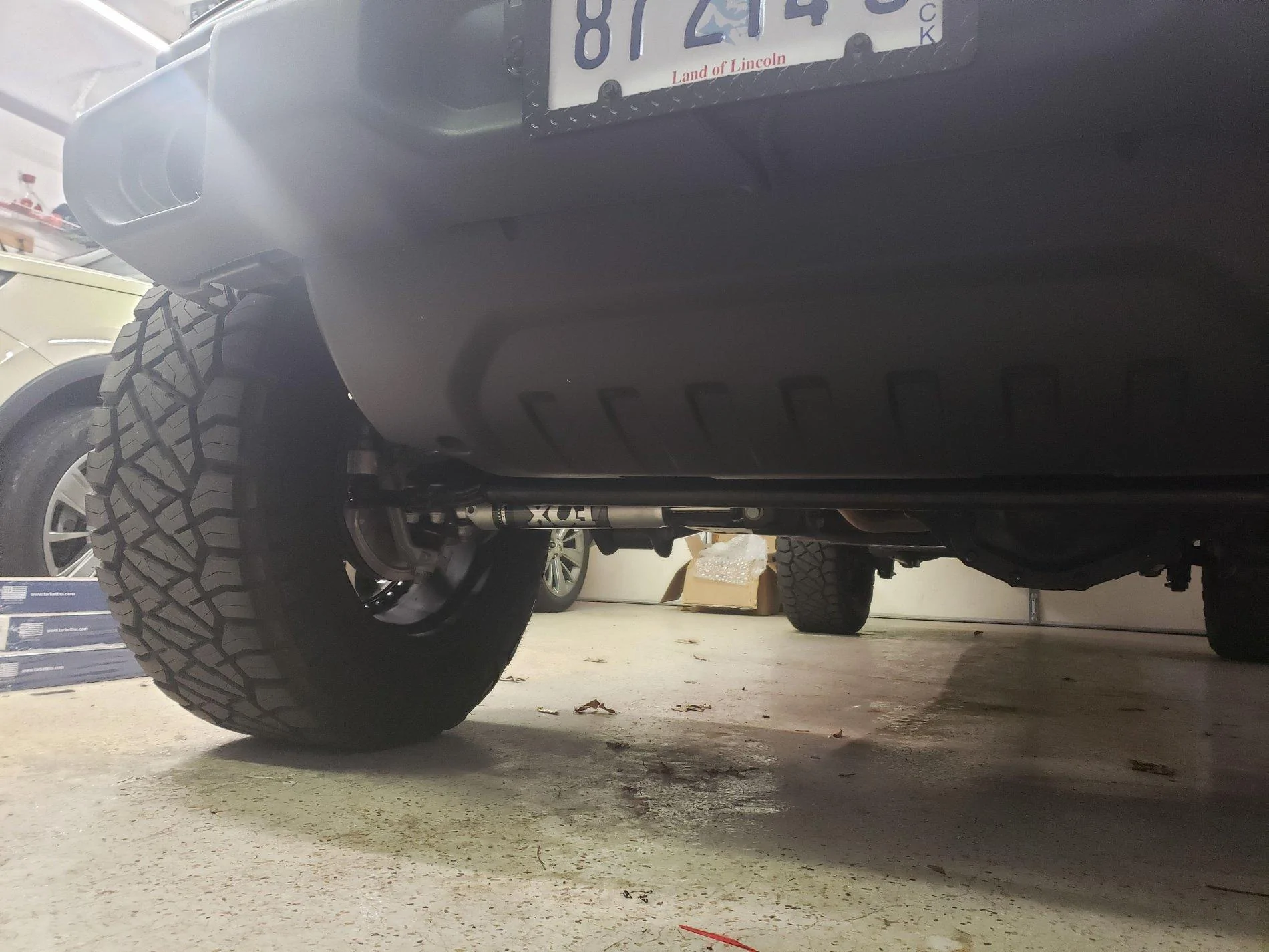

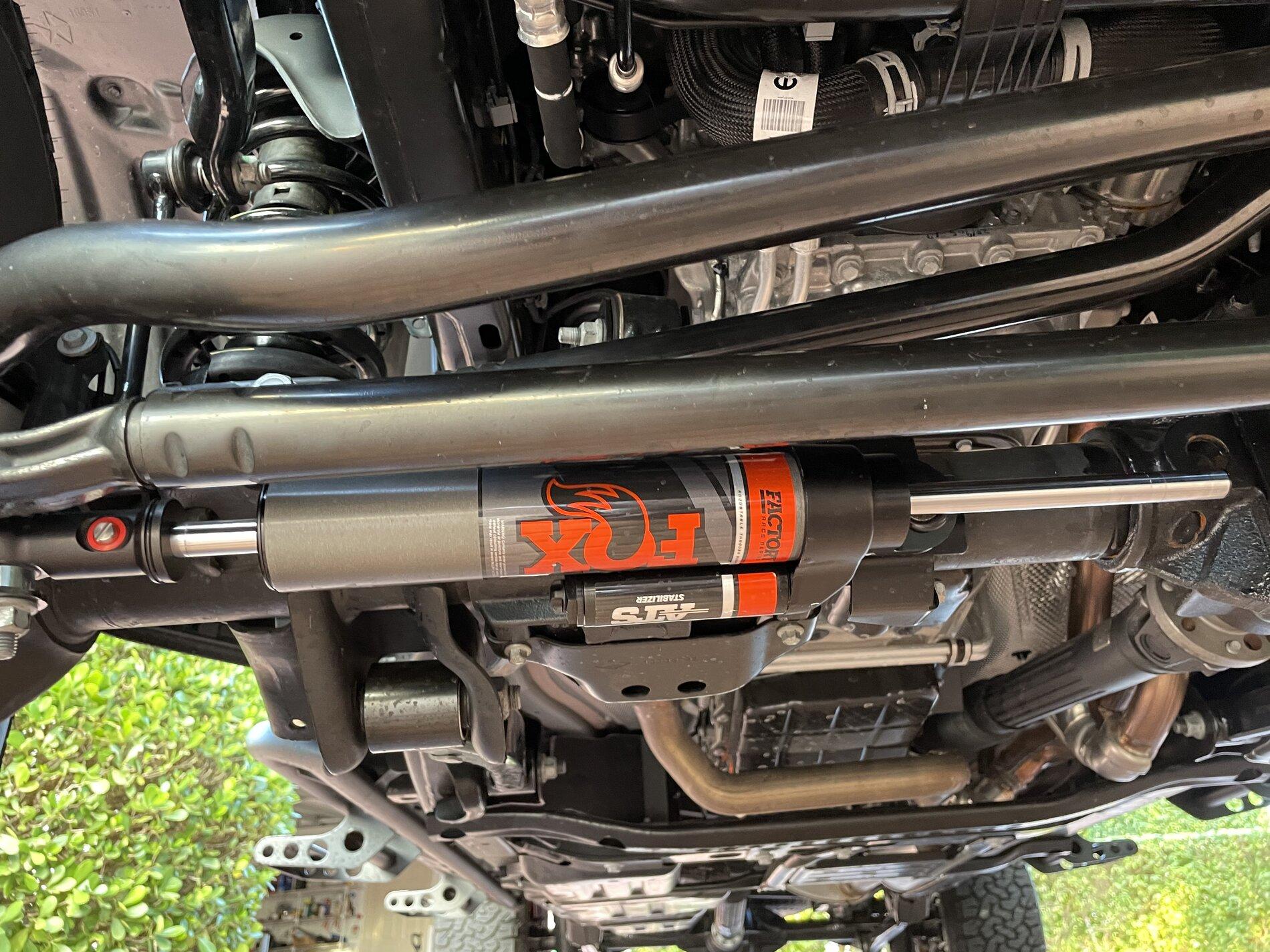

I had plans to put both the Synergy sector shaft brace and the steering damper on, but I did not have the 42mm socket required for the steering box, so just the damper for now. I had no steering issues what so ever. I figured if I was gonna put more damping on the steering it would be a good idea to beef up the steering box mount. I am quite happy with the performance of the Fox steering damper. Not a huge difference, but it does take the refinement up a level. I would do it again in a heart beat.
You have it on upside down.

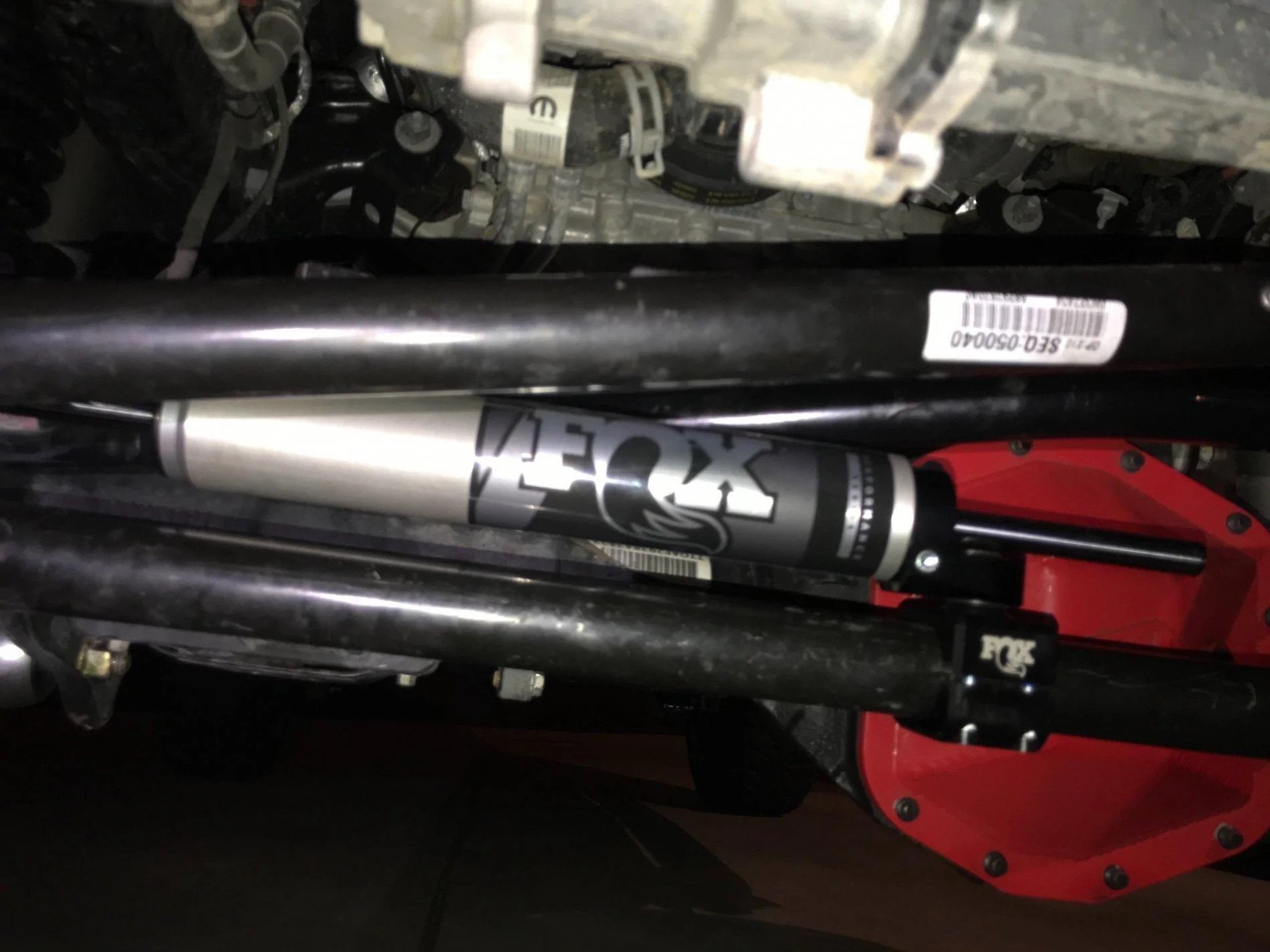

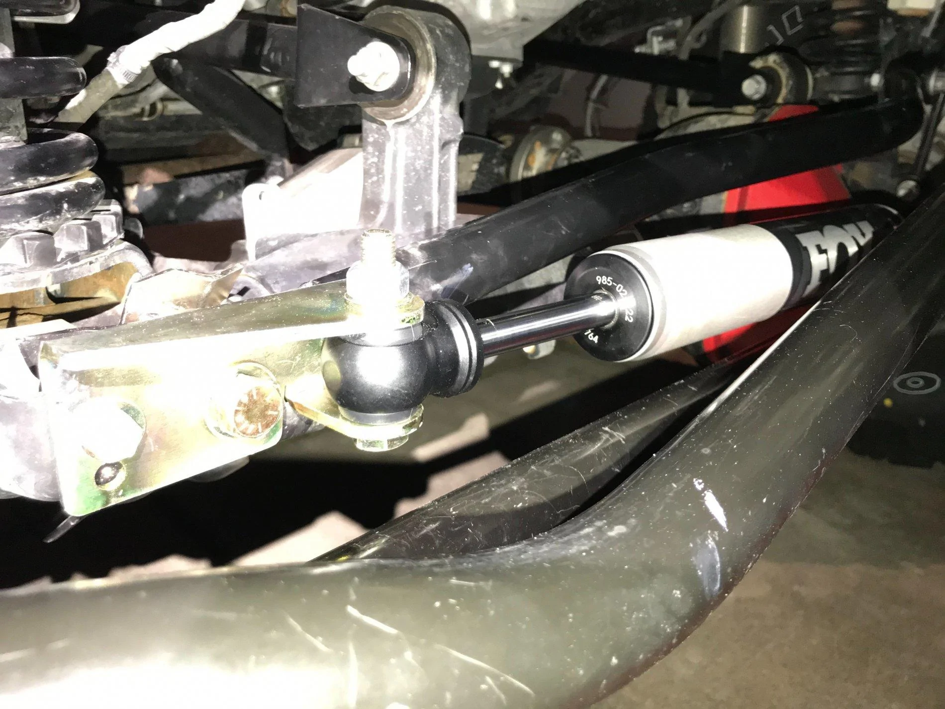

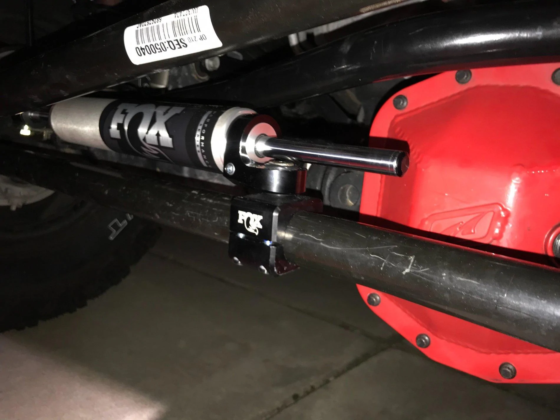

Good news!
We just tried it out with the steering stabilizer model you have, and it actually does work with just our relocation bracket! I'll leave the product link and some pictures below.
https://www.claytonoffroad.com/prod...bilizer-relocation-bracket-2007-2020-jk-jl-jt
Jeep Gladiator Just Installed the Fox Steering Stabilizer. All I can say is WOW! 1
Jeep Gladiator Just Installed the Fox Steering Stabilizer. All I can say is WOW! 2
Jeep Gladiator Just Installed the Fox Steering Stabilizer. All I can say is WOW! 3

@Clayton Off Road
Can you give me a measurement on how far down the track-bar to set the black Fox clamp? Or do you just make sure your tires and steering wheel are square, then measure equally the amount of rod sticking out each side? All the years of wrenching, and building trucks, I’ve never messed with a body-through designed stabilizer before.
Thanks.
LostWoods
Mar 13, 2020
2,027
2,421
Gilbert, AZ
2024 4Runner / 1995 YJ
@Clayton Off Road
Thanks.
You'll need to find stabilizer center and lock it down there with the wheels straight. In CTR's image above, the end of the rod from below is the driver side of the damper:
  1. Force the body toward the end of the rod and measure from the body to the end of the rod (the valve inside will stop it at some point)
  2. Force the body away from the end of the rod until it stops and measure body to the end of the rod.
  3. Subtract #1 from #2 and you'll get the total available travel. Divide that in half to find center.
  4. With the body maxed out away from the end of the rod, measure from the body to the center value in #3. Mark it off with masking tape so that the edge of the tape is on that center line and the tape is toward the end of the rod.
  5. Center the wheels and lock it down where the body of the stabilizer touches the edge of the tape.
  6. Work the wheel side to side just to double check yourself.
