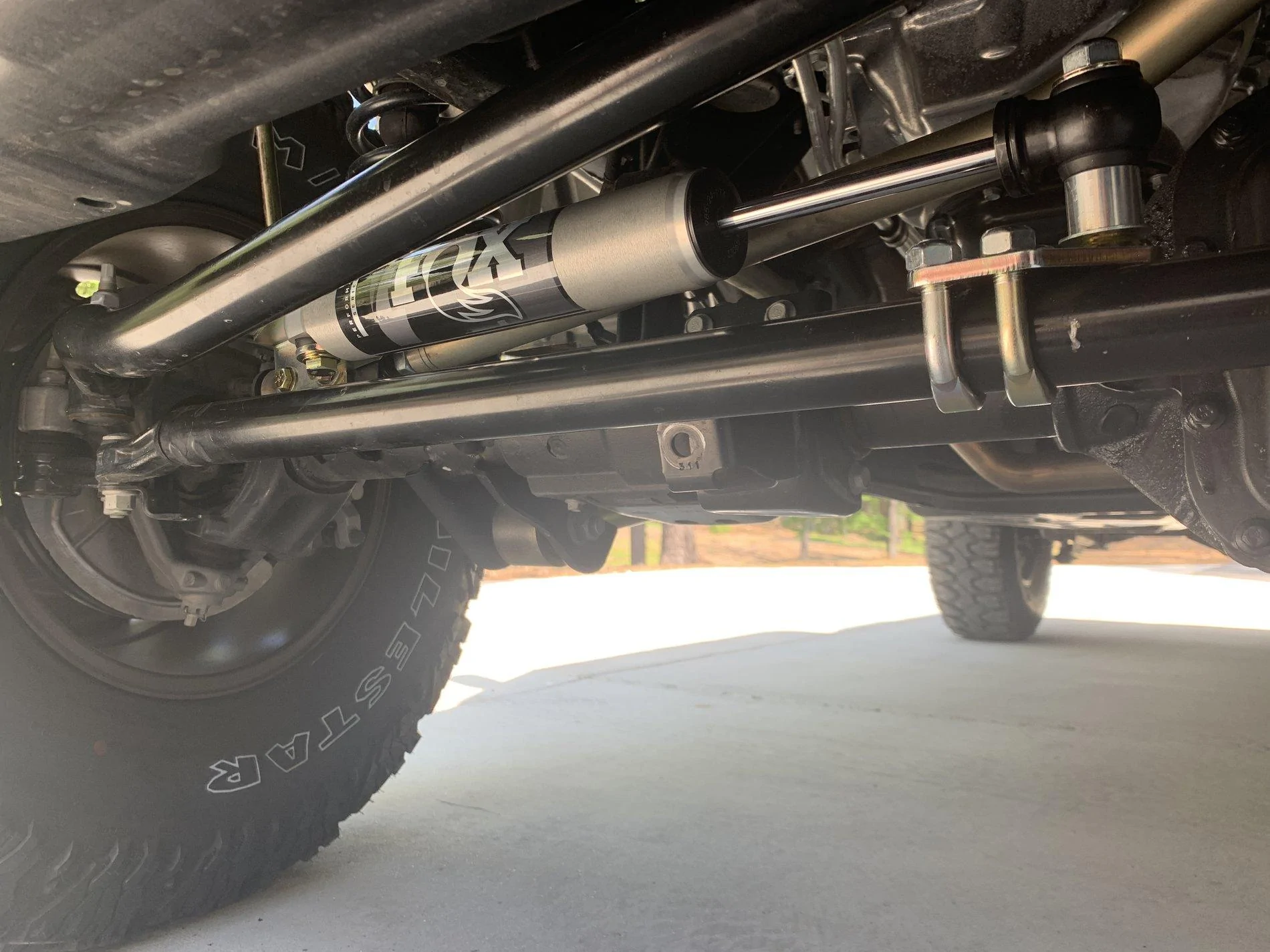

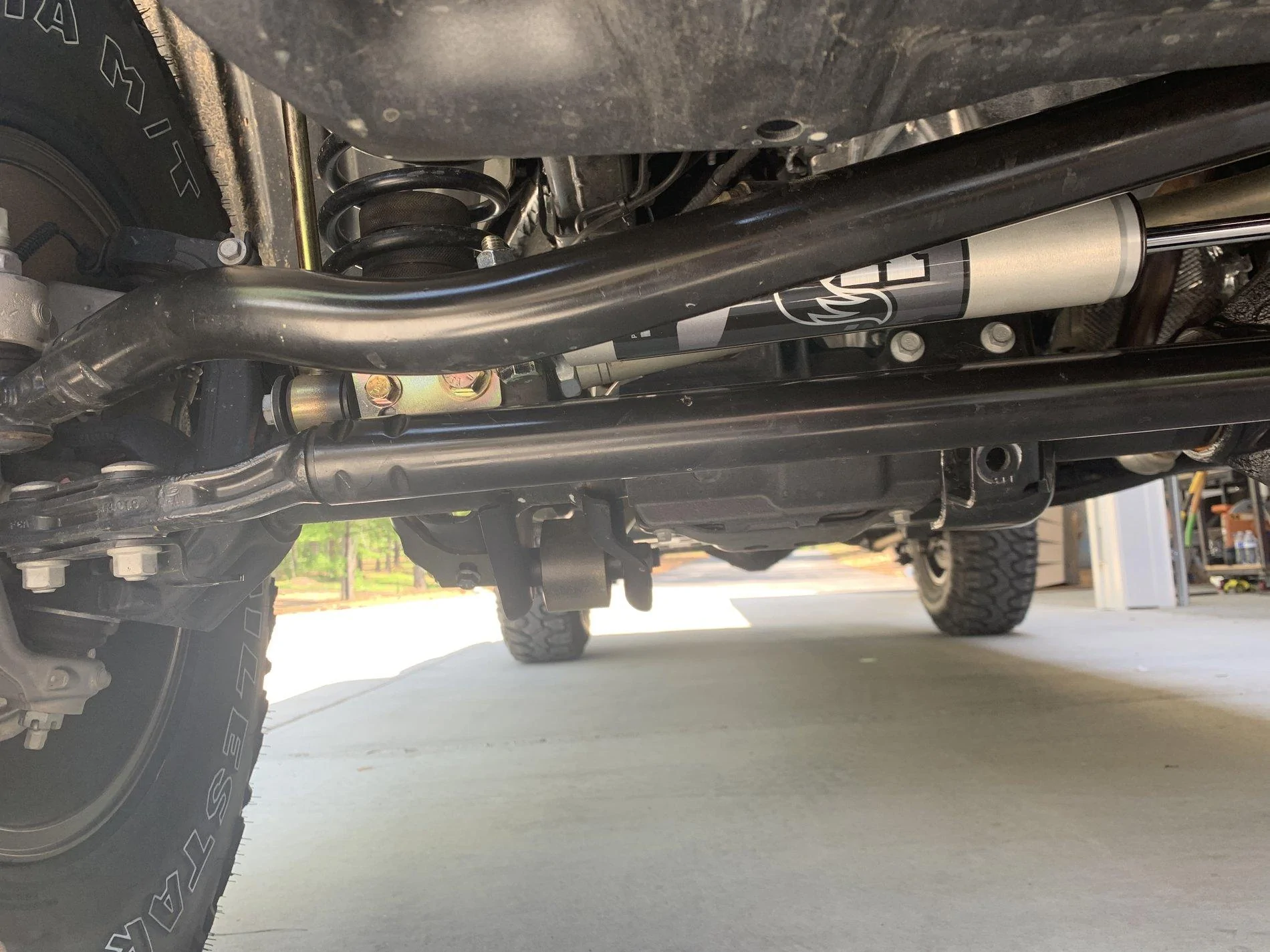

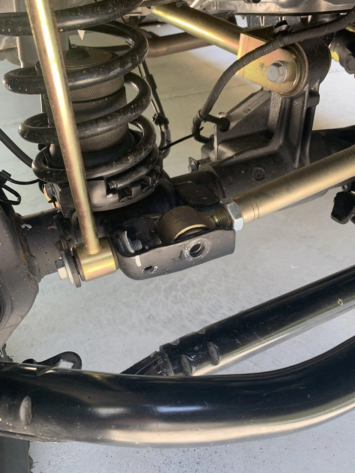

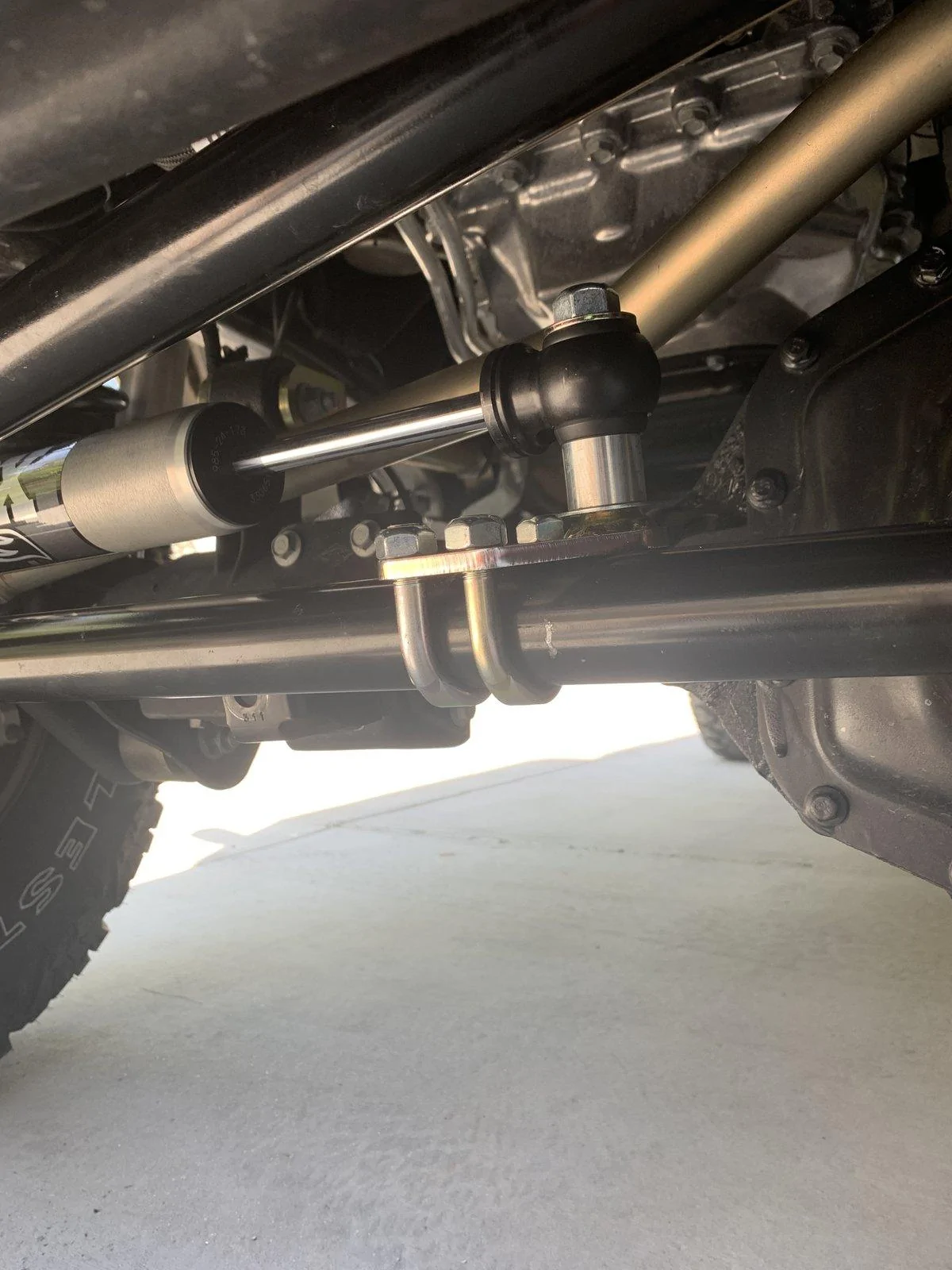

Install was almost simple. You need to drill a hole in the trackbar frame bracket. Limited space to get in there. Other than that it is pretty simple.

So just for clarification, the red circle was the hole you had to drill and the green circle was already there and you replaced the factory bolt with the Kit Bolt, correct?

green is existing track bar hole. Kit comes with new bolt and nut for this. Red is 3/8” hole I drilled.
1. Remove track bar bolt
2. Temporarily install new bracket and tighten using old bolt.
3. Center punch existing frame bracket through new bracket hole. Make sure bracket is angled so when you put in stabilizer and bolt it clears the tie rod.
4. Drill out to 3/8”. Tricky because tie rod and drag link in way.
5. Remove new bracket and paint drilled area to prevent rust. 6. Install new bracket using new bolts.
