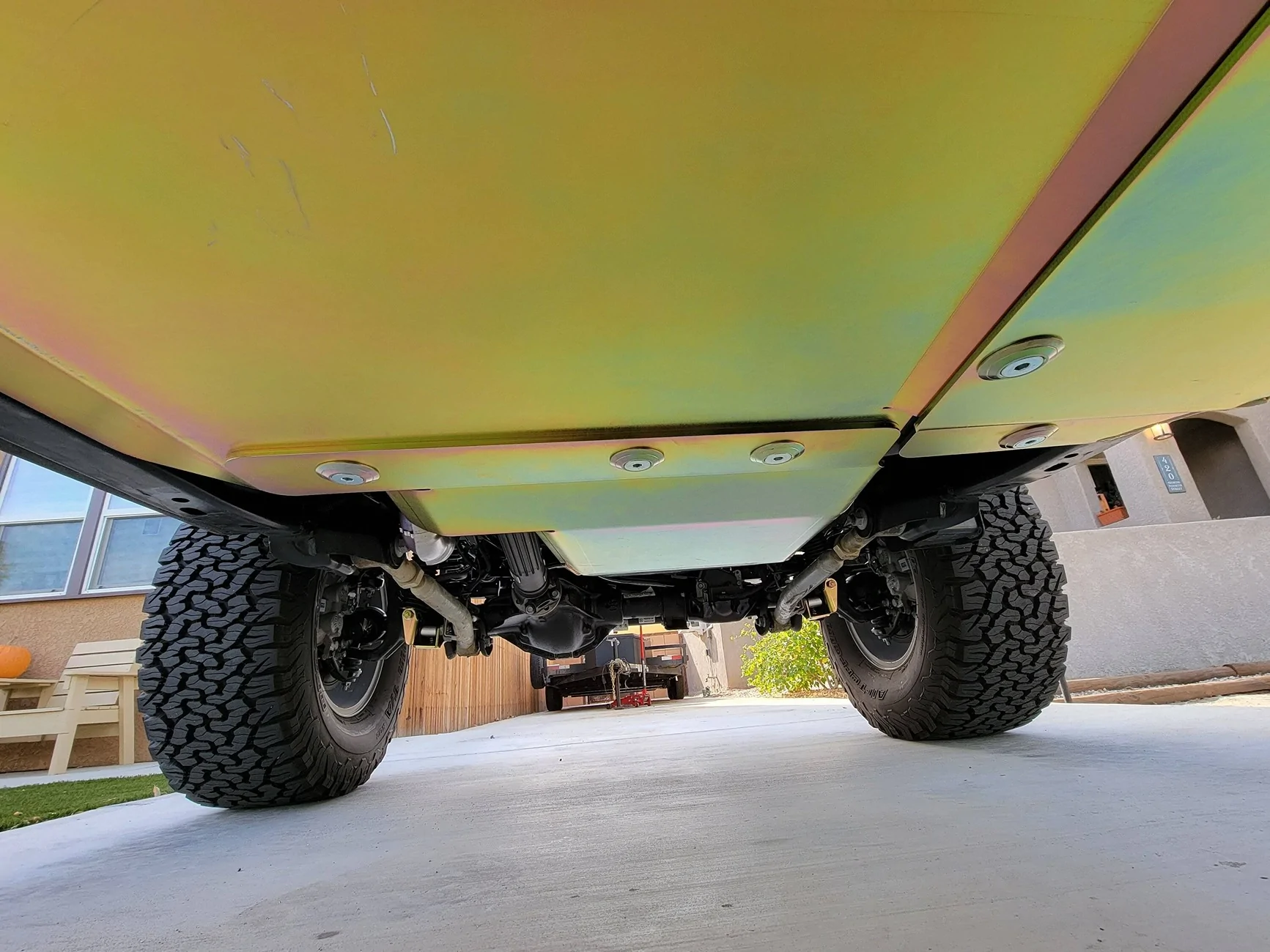

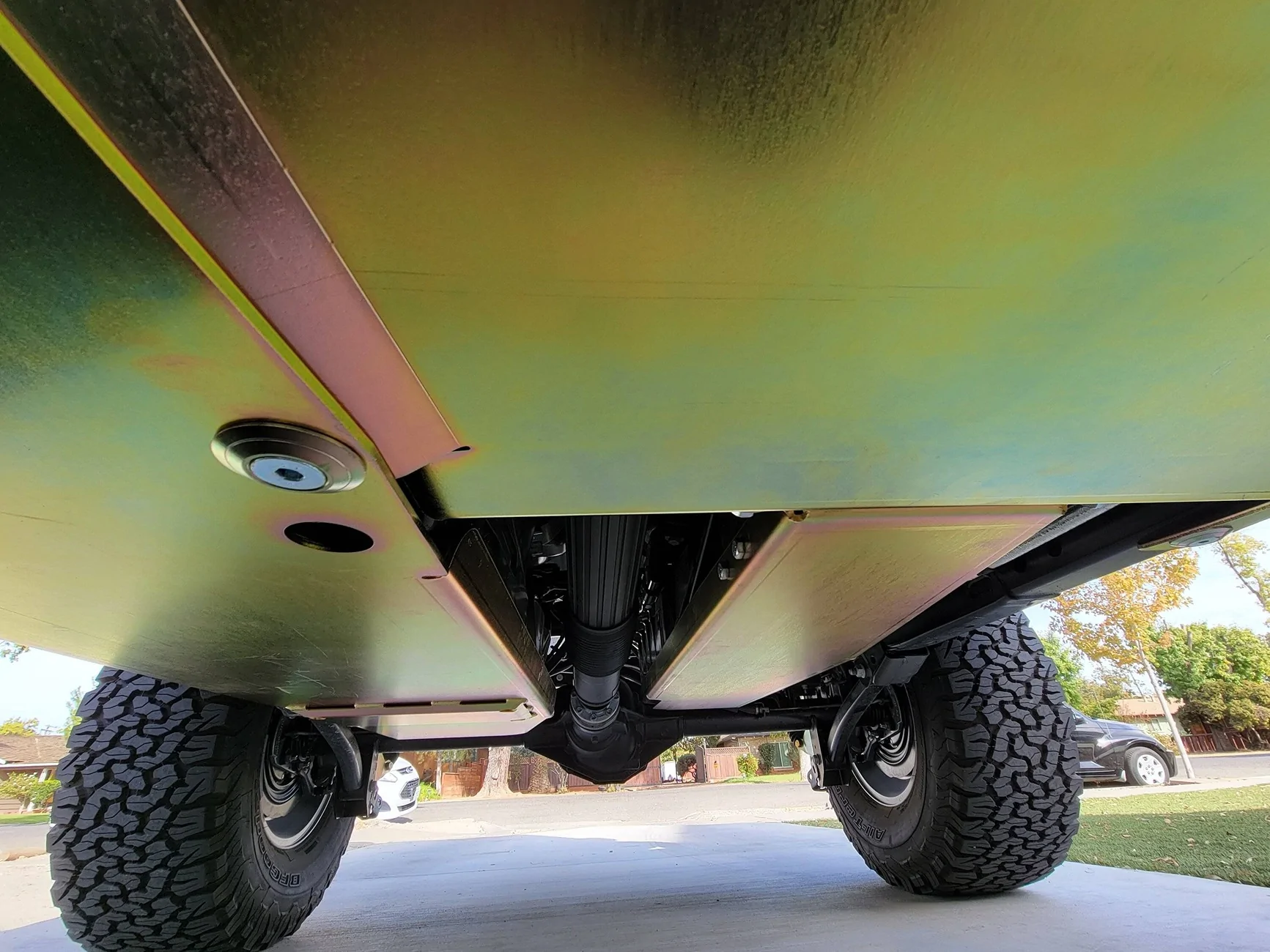

Metalcloak 3.5" springs too. I'm a fan for sure. Great products, amazing customer service, and they are local to me. Wife's Jeep runs their springs and full set of skids too.
I’ve ordered from them a couple times and they also give me a call after to say thanks for the order and give me an update on shipping time. Only company that’s ever done that for me.
