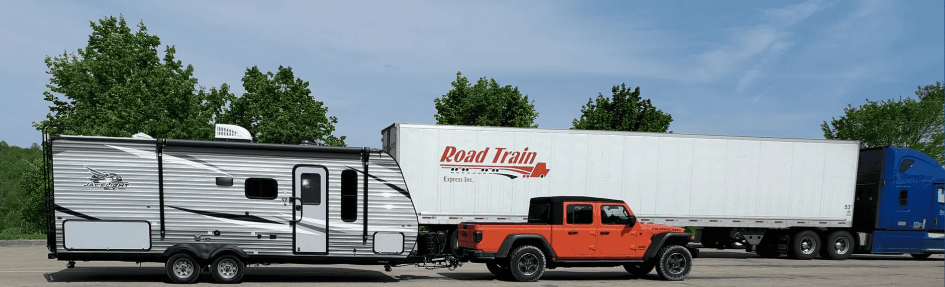

That squat doesn't look bad to me at all. The length of the JT exaggerates how it looks.
That’s why I said ā€œa bitā€. But I have a rubicon, and know how they look when squatting.
