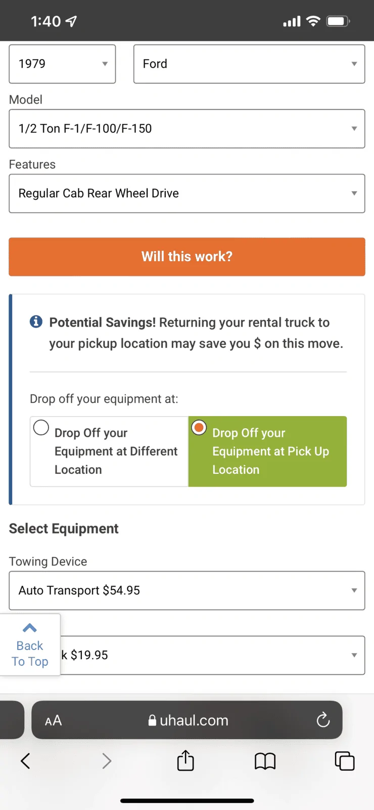

- The UHaul "auto transport" trailers are terrible. They're nearly too short for a pickup truck, they have excessive tongue weight, and they do not allow you to back the vehicle onto the trailer to even out the tongue weight by their rules. I would strongly suggest borrowing a real car trailer.
- UHaul won't rent to you unless you have a hard top on your truck.
- The Gladiator is a 1/2 ton truck. Not just by payload or tow rating, but also by the very stamp on the Certificate of Origin. If a Ram 1500 or Ford F-150 will tow it, the Jeep Gladiator will tow it.

Rent a pickup from Home Depot or some other Big Box home improvement store, and rent a trailer from Uhaul. Just be sure the truck has a hitch (they normally only rent trucks w/ hitches if you also rent something that needs towed).

The UHaul Auto Transport trailers have brakes on them. Brakes won't be an issue, and neither will pulling power or handling. I've used the UHaul trailer to tow a couple of heavy V8 cars on 160 mile round trip. Not an issue at all.
The only thing I don't like is that they set their trailers up with excessive tongue weight. They do this for safety, oddly enough. But it makes a 1/2 ton truck sag pretty bad if you don't have airbags or overloads like the Timbren SES kit or something. Still, it works fine.

Exactly. The U-Haul trailer has surge brakes. They don't need a brake controller in your truck.
You can read online the pros and cons of surge vs. electric brakes on a trailer.
