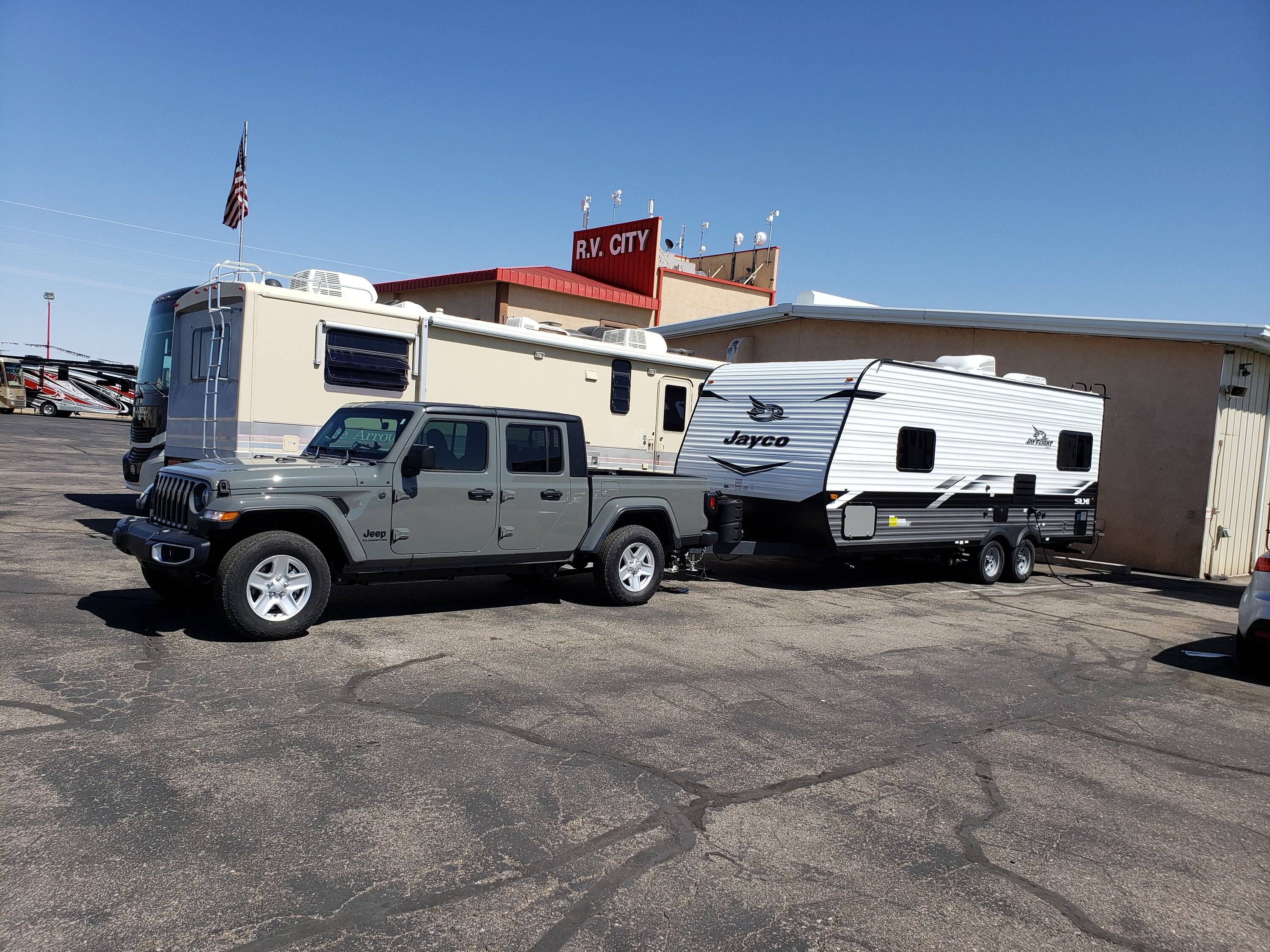

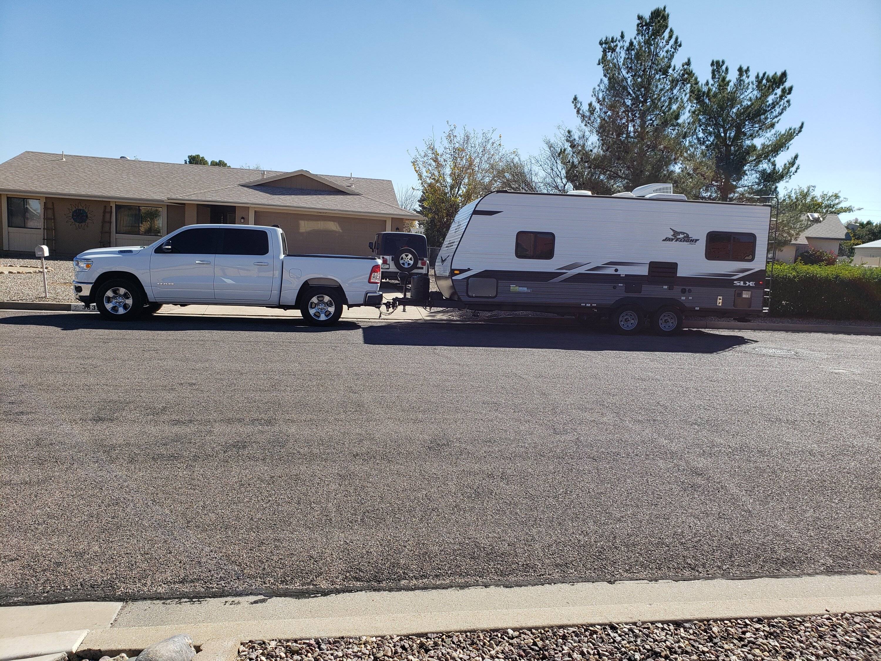

I would just like to add that I personally never go by dry weight on a trailer. Wether you travel with empty tanks or not, when you load up for camping, your trailer will be close to gvwr. Our travel trailer's dry weight is 4,000 and some change, while the gvwr is 5,500lbs. We do travel with 10 gallons or so of fresh water so we can use our own bathroom while traveling. Loaded up, it's at the 5,500lb gvwr, if not a little more. I towed with a 22 Gladiator max tow and just was not happy with it. We live in South East Arizona and have mountains every direction. I found a 21 Ram Big Horn Crew Cab 1500 5.7 with 3.92 gears and very happy with my decision. Also gained a little more than 300lbs of payload over the gladiator.
very nice truck! At some point Im sure Ill end up going in the larger truck direction as well. If nothing else it will give the kids more room on the back while we travel. The mountains are a significant consideration to be sure. The JT can do a steep grade, but not happily. Pulling through PA I went up a grade where all the big rigs slowed to 25mph, so I followed suite and was glad I did. Since then I pay more attention to the grades of where I go and stay cognizant of the potential to re route if I think its just too much.
As I've read some of your posts, the important thing for the gladiator's are a good WDH and a good trailer brake controller.
