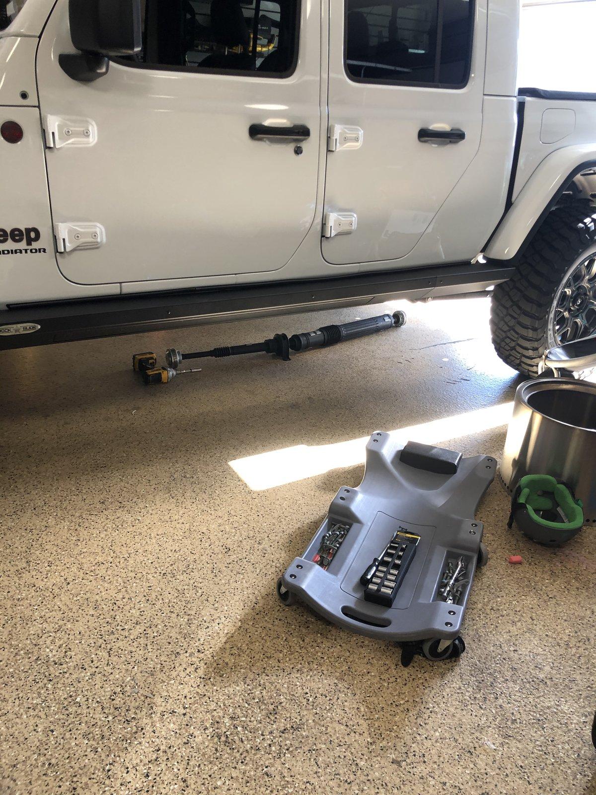

6800 miles. Chasing a driveline vibration. I dropped the rear driveshaft and test drove. Vibration gone. I too would prefer a solid shaft without the carrier bearing.
How did you test drive if you dropped the rear driveshaft? Front wheels only in 4H?
Did you end up getting a new driveshaft? OEM or single-piece?
