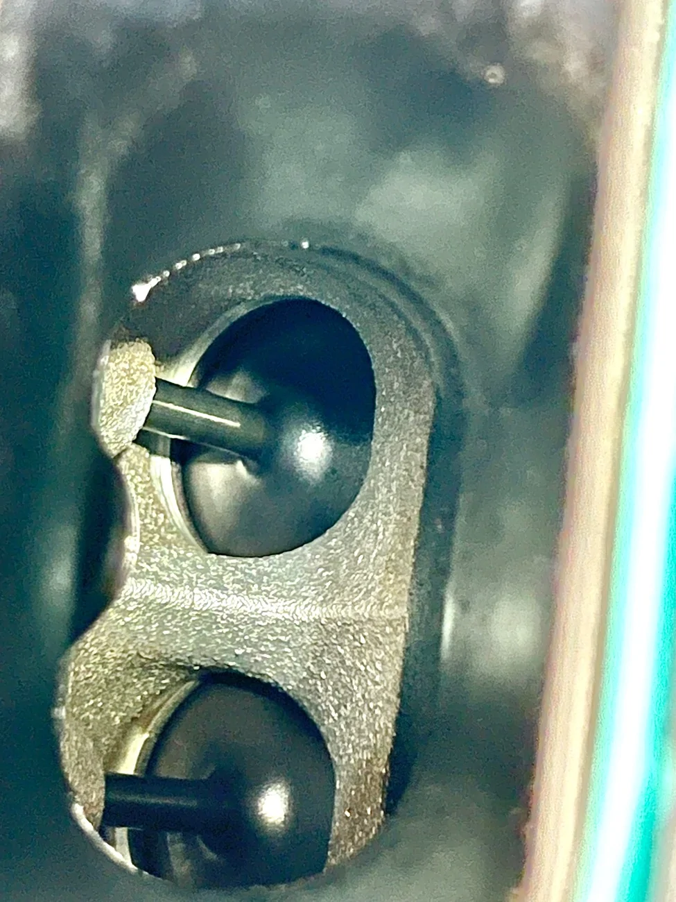

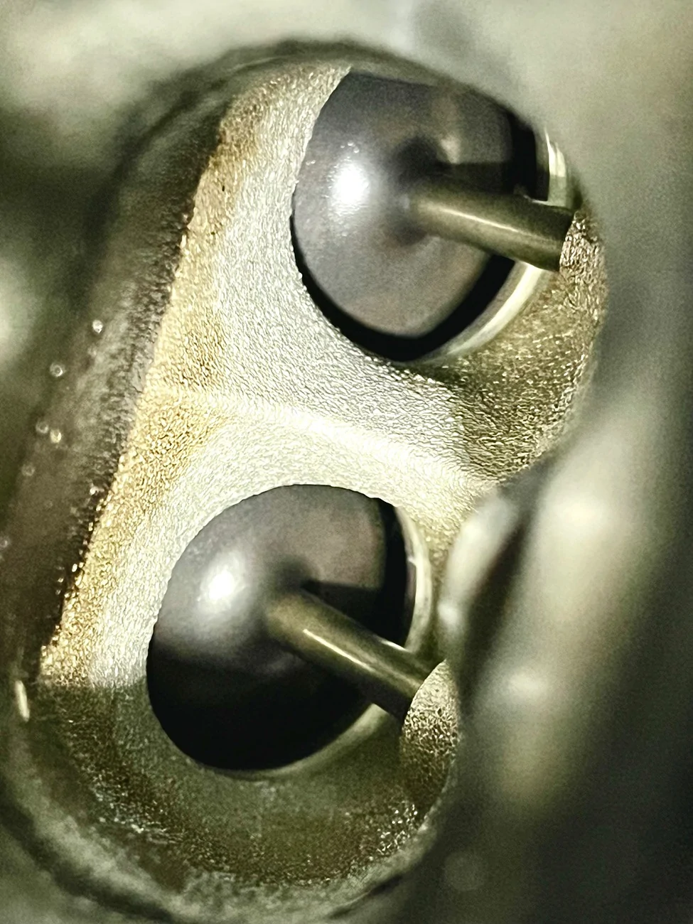

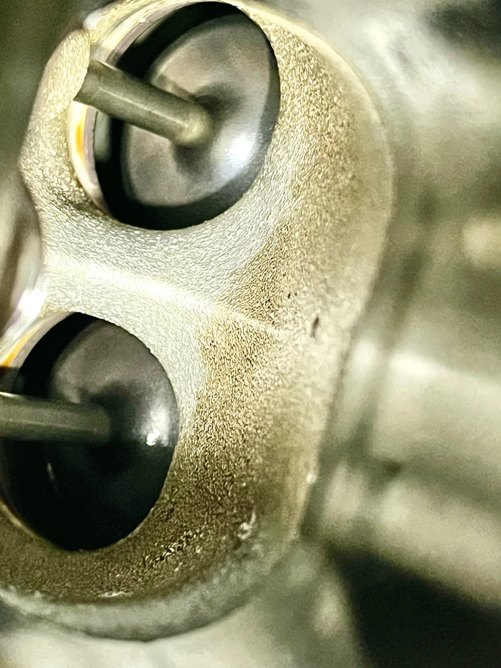

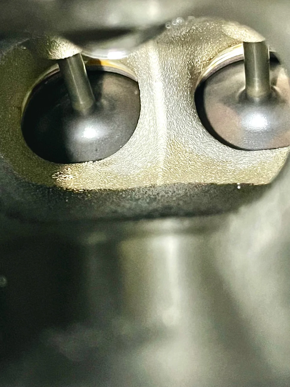

We can take comfort in knowing we have port injection and not direct injection. Here’s what our valves look like for having gas wash over them. I was changing out my spark plugs at 60k kms and took these pics.
Came here to say this is why direct injection requires MORE maintenance, the ethanol in the fuel doesn't touch the back of the valves allowing more carbon/contamination deposits (EGR, PVC, etc) and REQUIRES 40-60k mile top-end teardowns for "media blasting" of the heads and valves.
This service is NOT covered and is an out-of-pocket expense every 40-60k miles. Or don't do them and watch your valves start to stick, flow worse (worse mpg/power), intermittent CELs, and power delivery issues (not always but can and has been a thing).
DI is simply better for emissions as it CAN allow for more complete combustion in lower rpms (city driving), but actually is worse for top end power which is why performance vehicles use 2 sets of injectors: DI for low rpm/emissions around town, and MPI (Multi-Port) for everything else.
- The BRZ/FRS/GT86 use this design as the engine spins over 8k rpm, and DI just can't effectively do its job with those pulse rates.
DI/PI split is the way to go and would be the best setup for every manufacturer out there in my opinion, most of the Ecoboost models I work on are DI/PI split, and with a healthy low pressure side and a couple tuning tweaks, those fuel systems can sustain 500 plus HP.
The PUG 3.6 could EASILY be rated 310 HP/280 TQ if they integrated DI into the mix while keeping PI supplemental, while probably kicking MPG ratings up a smidge at the same time. The evaporative effect that the fine mist from the DI side produces allows for cranking up spark timing quite a bit and better temperature and knock management. I don't think Stellantis has any plans for that unfortunately.
