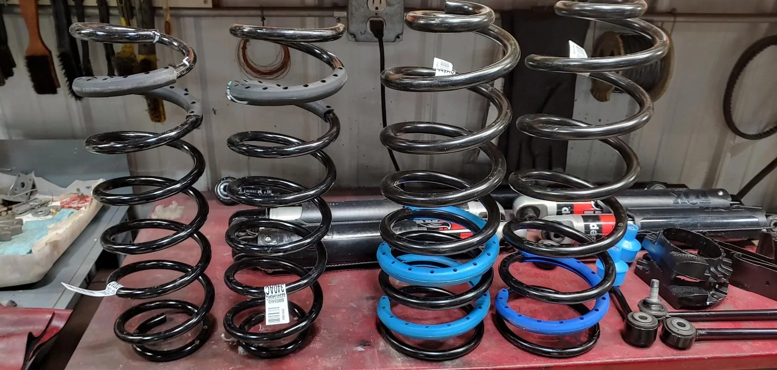

Have you actually compared the springs side to side? I have. PAIR of Rubicon springs - one side has 9 coils and is slightly shorter, the other has 7, spaced differently.
They have different rates, different numbers of coils, and I bet if I went through the work of pulling them off the high shelf and unpacking/unboxing them again and measuring the wire size, I'd see a difference. Not always, but some.

The two rear springs on the right -449 and 450. The 449 has more coils and is shorter, the 450 goes on the right and is a tad taller, fewer coils.
If you lower the amount of coils, you'll increase the spring stiffness which is the spring's rate.
The one on the right has fewer coils, so a higher rate - and goes on the right side of the truck.
They are from the same truck..........

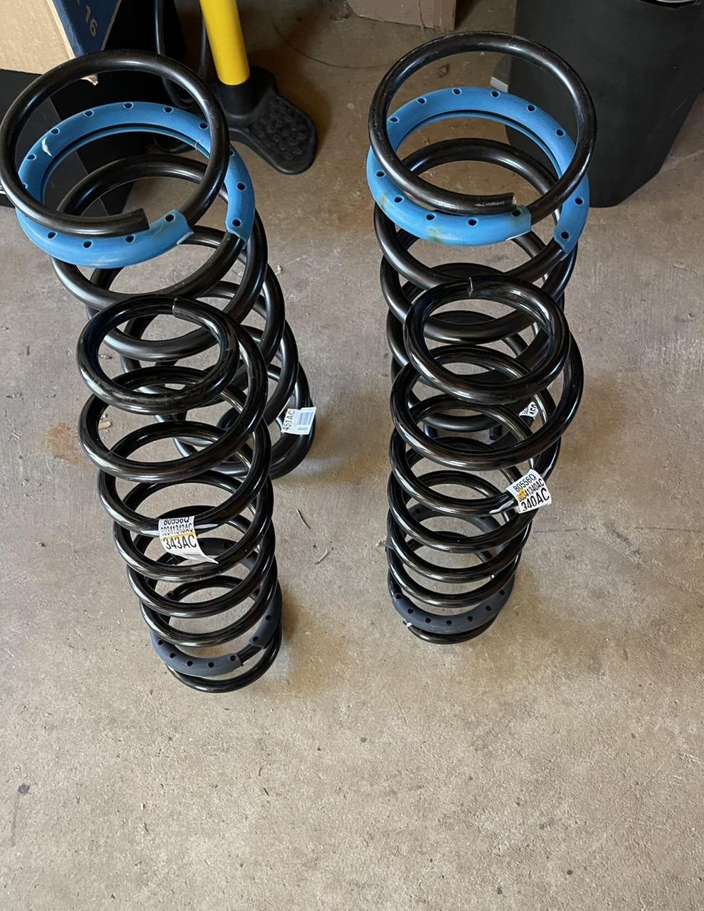

I have 339 and 340 front rubicon springs. I don't know if I should put them in or if I should buy a 343 and put that in with my 340 instead.
I would like to take a little of the rake out/tiny lift... But I don't want to make body roll worse. Any thoughts?

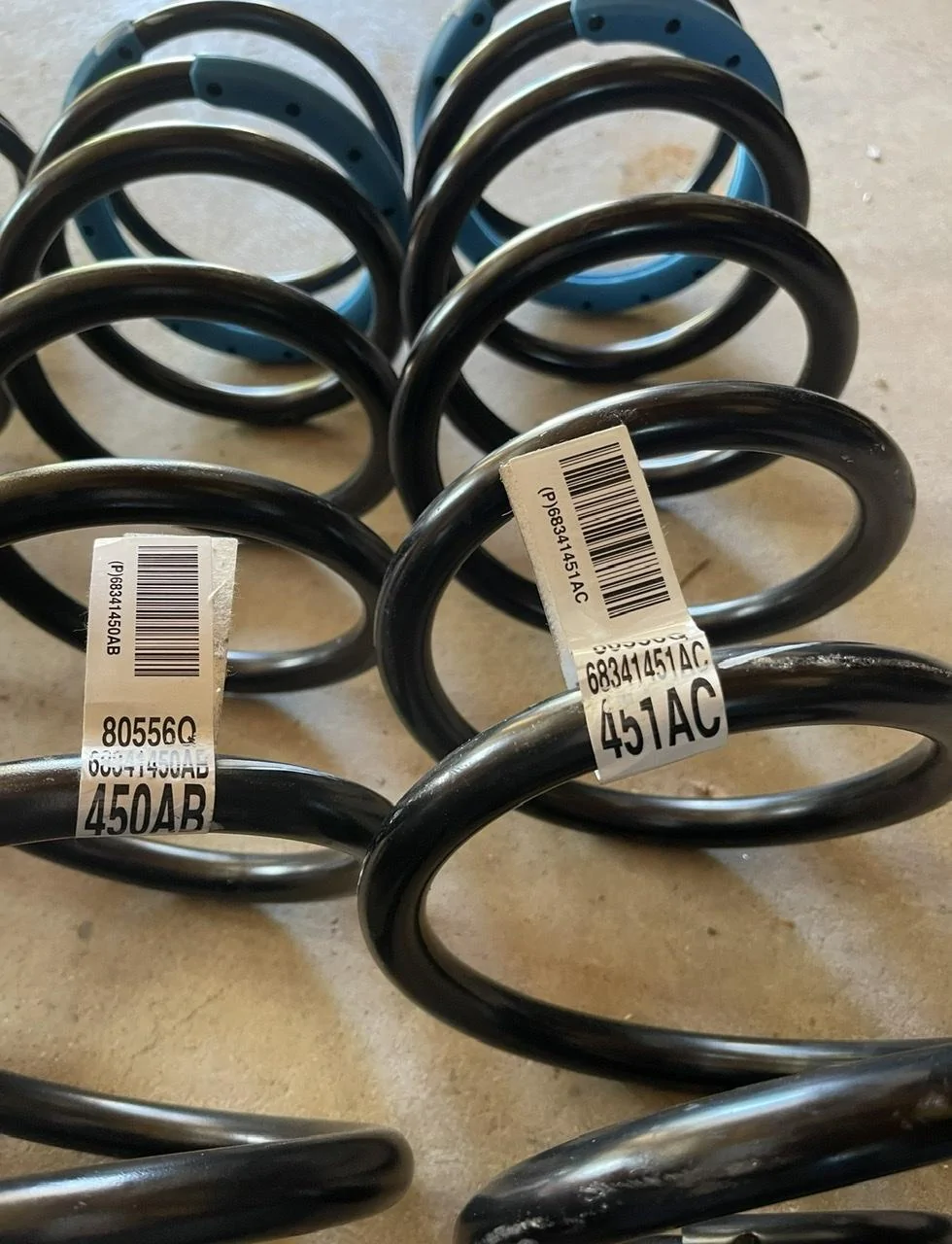

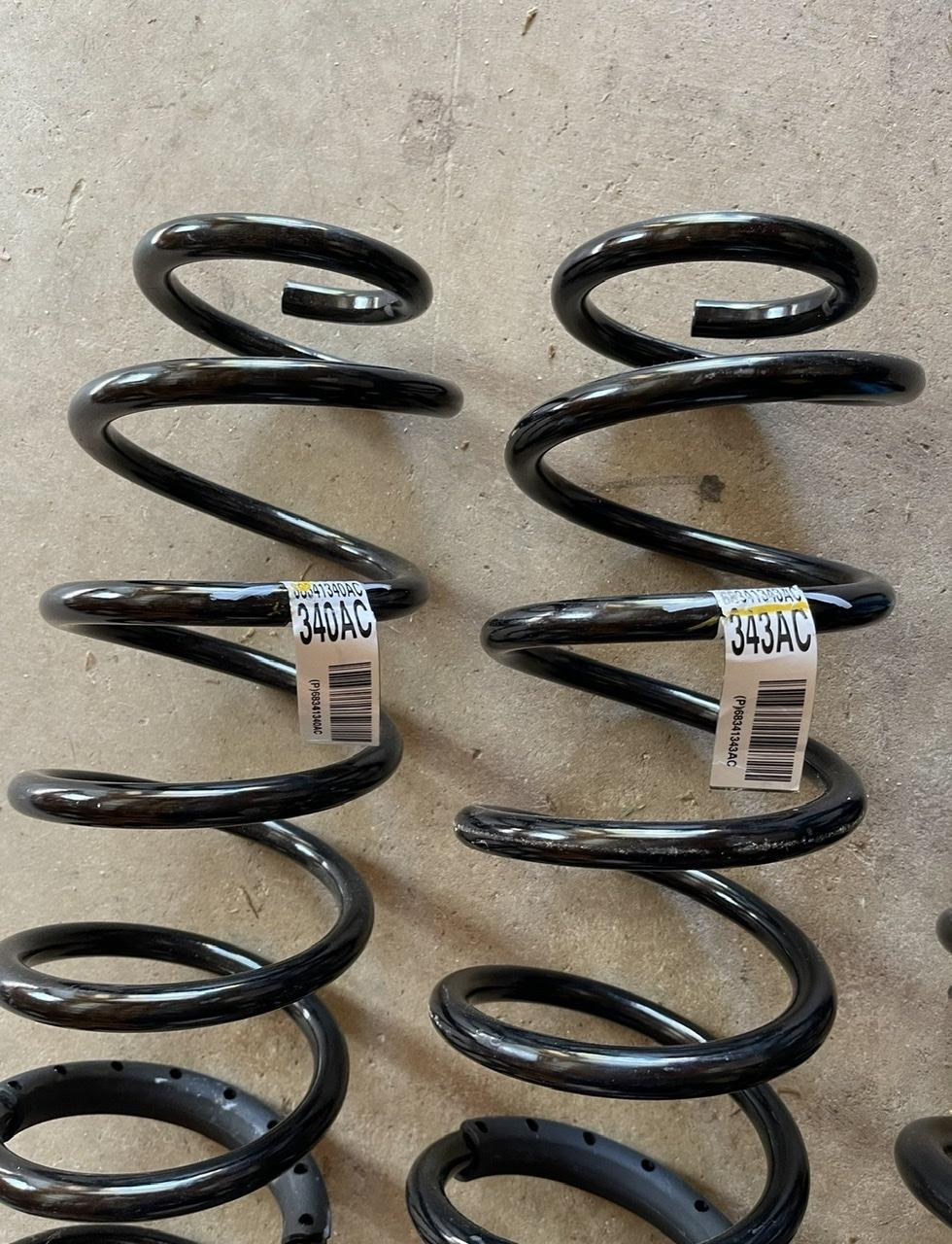

I’m looking at a set of Rubicon coils from a JTR LE.
Do I have this correct?
Front (L/R)= 340AC/343AC
Rear (L/R)= 450AB/451AC
TAI

Teraflex leveling kit. It'll take out the rake, with minimal impact on handling. There's no way to lift and have no impact on handling, but this is minimally invasive. Either that, or I actually have a set of .75" Daystar spacers which I'll give you for free. I have no need for them.

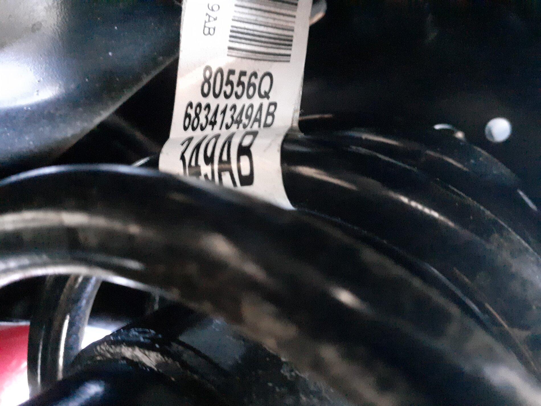

Here's my front driver side.
349AB
Couldn't get a clear shot of the passenger side.
349? That’s interesting. Diesel?
The highest I’ve seen up front is 340/343. That’s what mine are and because they’re off of a LE Rubicon.

Anyone know what AB vs AC means? I have
340AC/343AC
450AB/451AC
Just a minor revision - could be the amount or placement of the padding on the coils, who knows. I'd be it wouldn't be different rates with that minor revision.
