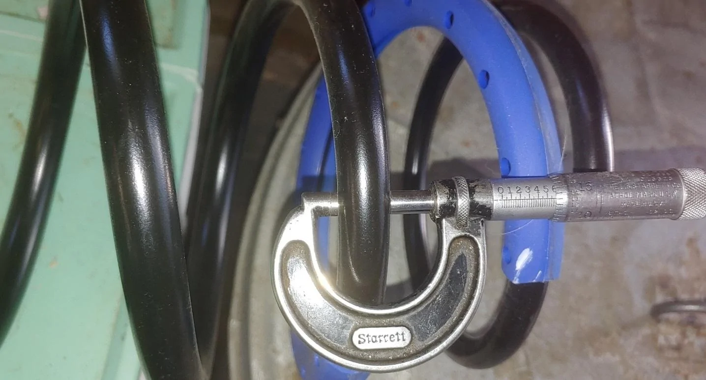

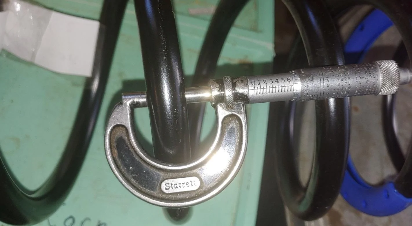

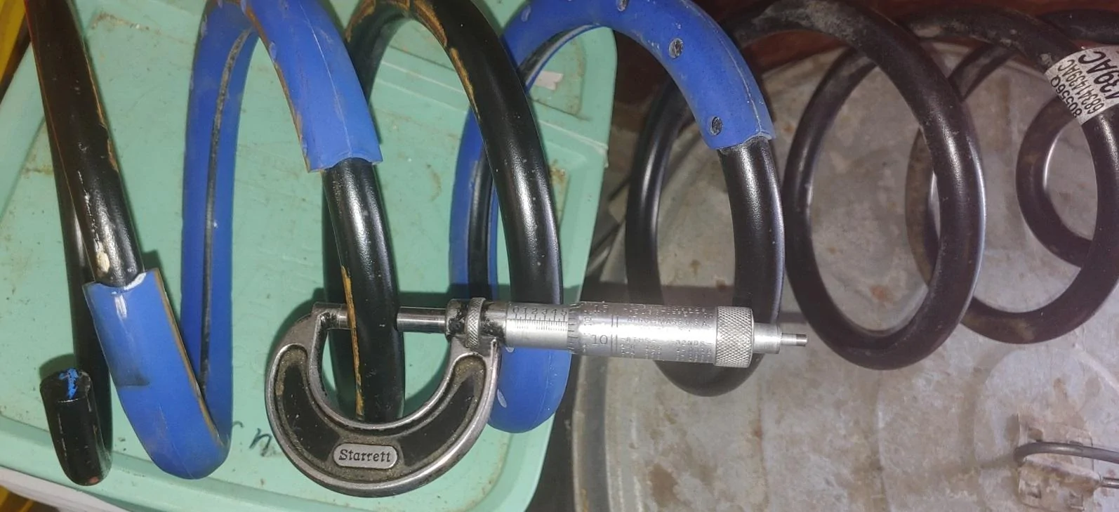

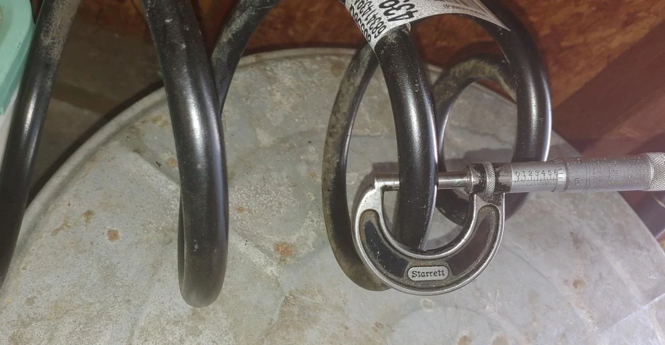

I knew the Rubicon were different from top to bottom just by looking in my pics, but to clarify just how much, and to show it's not just Rubicon, I got my ladder off the hooks, pulled a bunch of stuff down and unboxed my springs......... I measured both Overland original rears and Rubicon rears.
Here's what I got (and I ignored the first coil since that's the base or top and doesn't "move" or "spring") I concentrated at least 2 or 3 coils from each end.
Overland rears -
top 4 coils were .658"
Bottom 2 1/2 coils were ~ .536"
Rubicon rears -
4th coil and up .650"
3rd coil and down - . ~.587"
Those are appreciable differences and obviously for a purpose. We're talking over .1" in some cases, close to that in others.

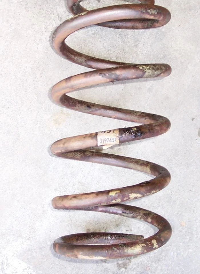

I should scan the AMC parts books I have - pages of springs....... depending on the options. Go-pack, AC or not, PS or not, V8 or I6, etc.
The last three digits of the part number are large/bold......... reminds me of Jeep springs.
