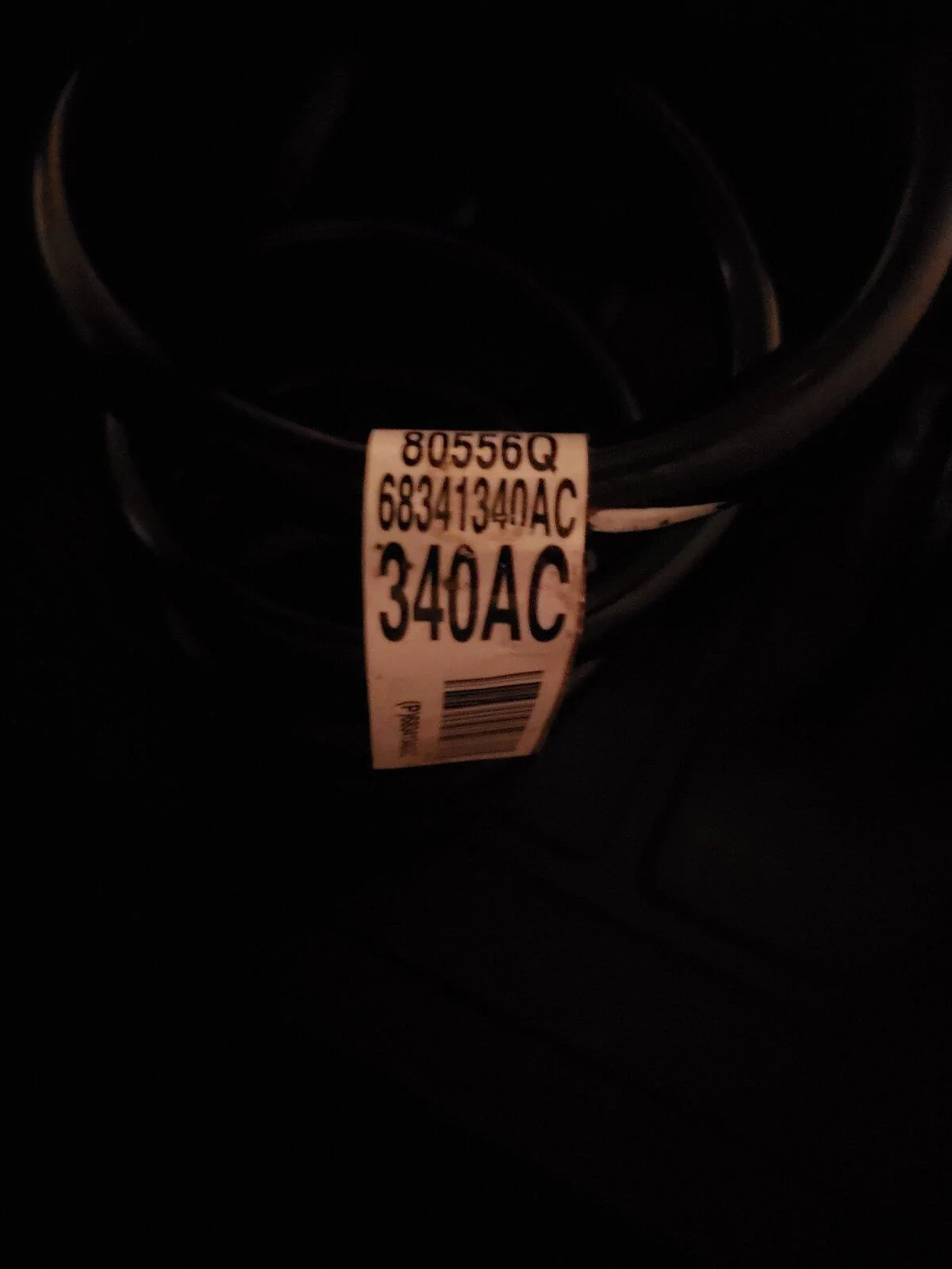

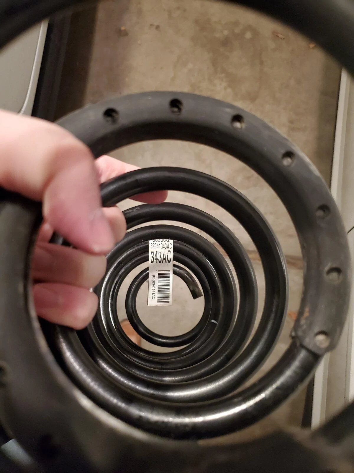

An update that is a combo of good and strange news (but no real conclusion)
My local parts guy checked the LE VIN (I found another one on Carmax) and confirmed the 340/343 combo for the front springs. (These are Rubi/gas/hardtop with the steel bumper).
This syncs with the data from @Isle_of_Man (provided just above) and by others elsewhere in the thread.
The strange part: matching this up with the 339/340 pair on my Rubi/gas/hardtop with OEM plastic bumper).
Convention seems to have it that the "lowest number" spring goes on driver side. And that there is a "handedness" (right-side vs left-side) to the springs.
So, the weird thing: This set of data has that 340 spring SWITCHING SIDES of the vehicle.
This baffled both me and my parts guy. (Jeep's spring pretzel logic remains obscure.)
I'm going to keep investigating. Any insights from the wise minds reading this is welcome.

The spring numbers are not location specific across the trucks. You have to compare right to left on the same vehicle, not with other vehicles, for placement location. So far, all Gladiators have the higher number spring on the passenger side, and the lower number spring on the driver side. The springs placed on the truck are affected by the options ordered and how they affect the overall weight of the truck, and by the model ordered and how they will affect the ride. It would be nice if Jeep would make available the chart and calculations they use to determine what springs are placed on the truck.

Not strange.
Take the 339/340 pair like I have under my Overland (from a Rubicon apparently without steel bumper)
340 is the higher numbered of the pair so it goes on the right
With a 340/343 now the 343 is the higher number so the 340 goes on the left.
There is no left and there is no right spring. The determination of sides is based on - which spring has the highest number. The highest number wins the right side, lowest number goes on the left.
So don't think location, think RELATIVE position based on numerical sequence.
40,514
54,044
Well now that I have a STEEL bumper and WINCH and SKID PLATE I need to find a 343 Rubicon spring. I'll move my 340 to the left and put the 343 on the right.
