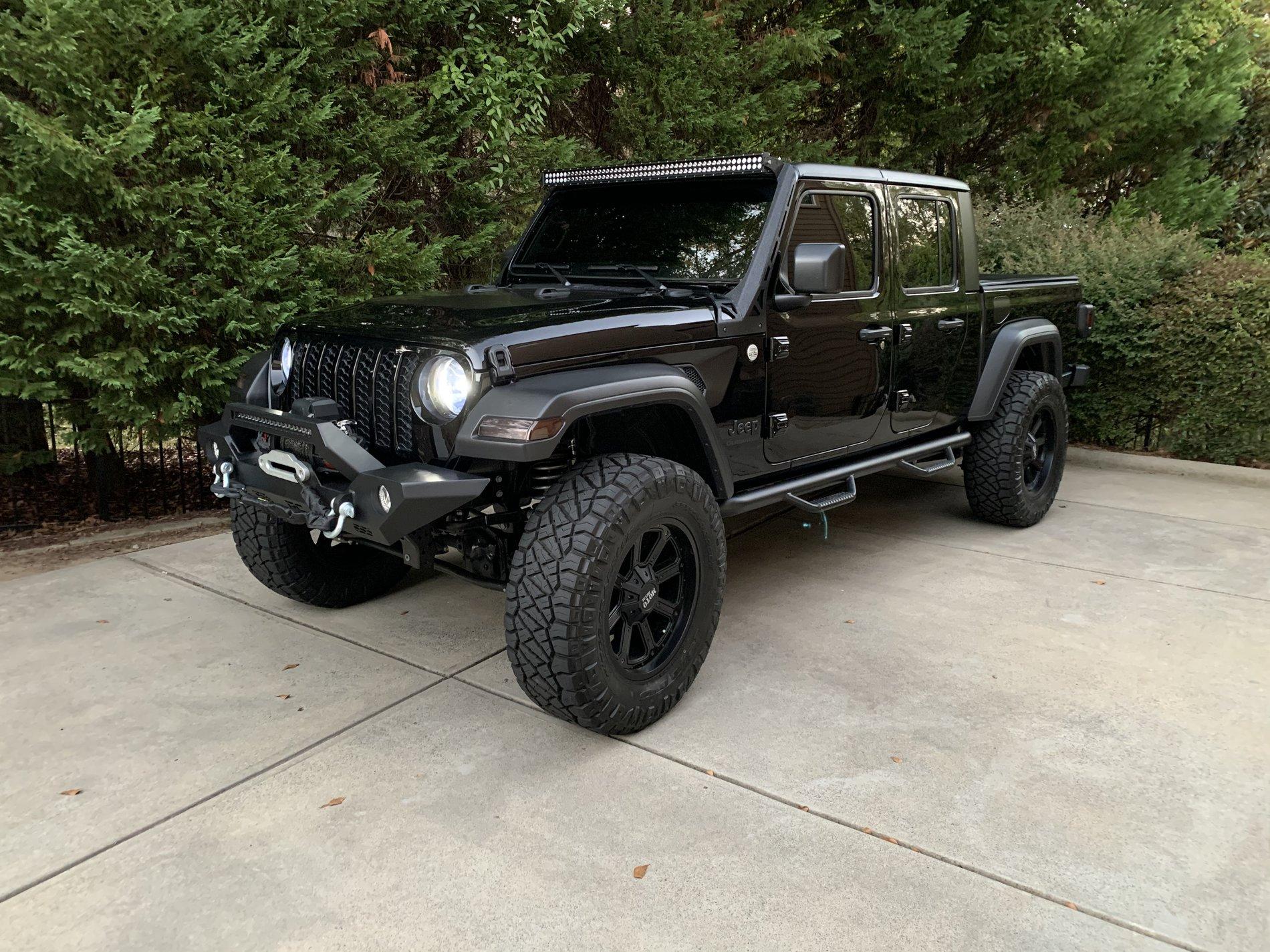

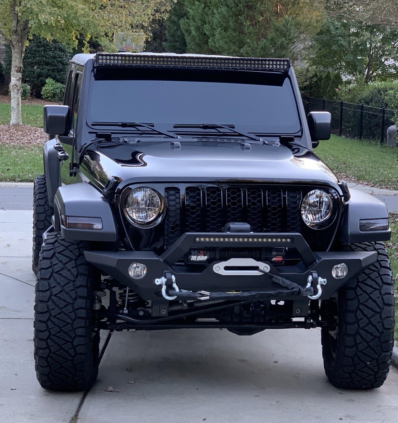

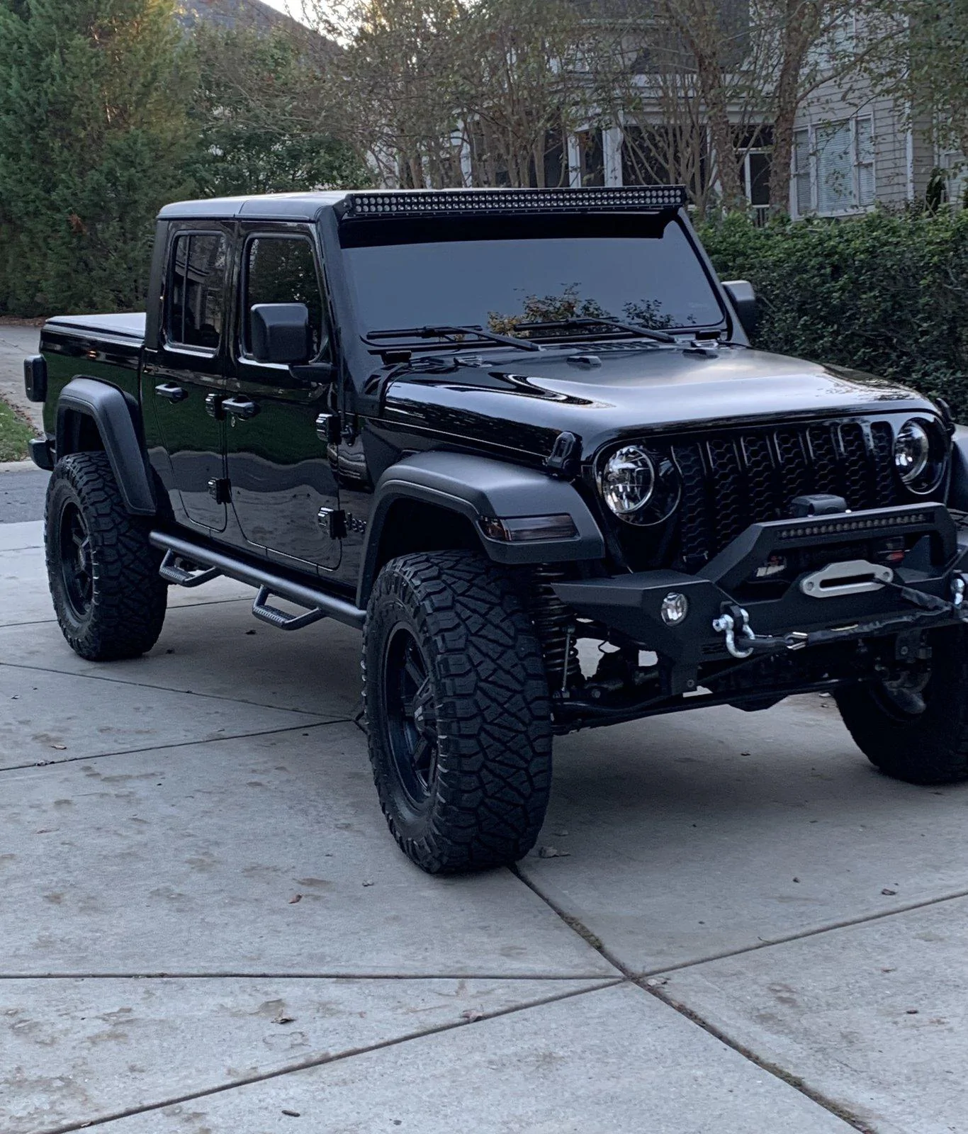

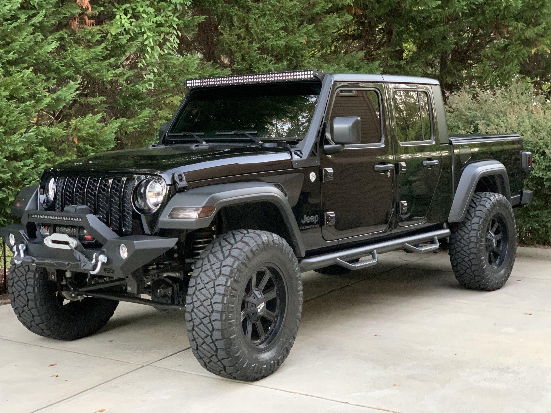

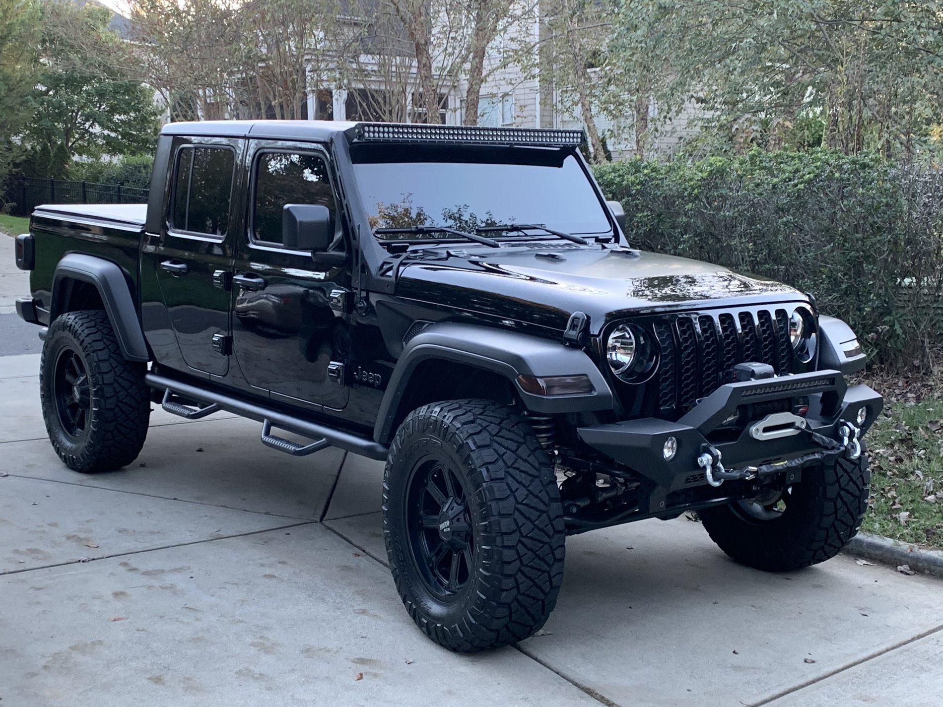

Update... for those running a sport with 37 and raised, definitely regearing makes a huge difference and brings the truck back to great running condition. Prior to doing it it was slow and gears not changing correctly .. 8th gear was like a slug. Now it is running great so if you are in such a position, I recommend it.
Oh and also we did. 4.88
