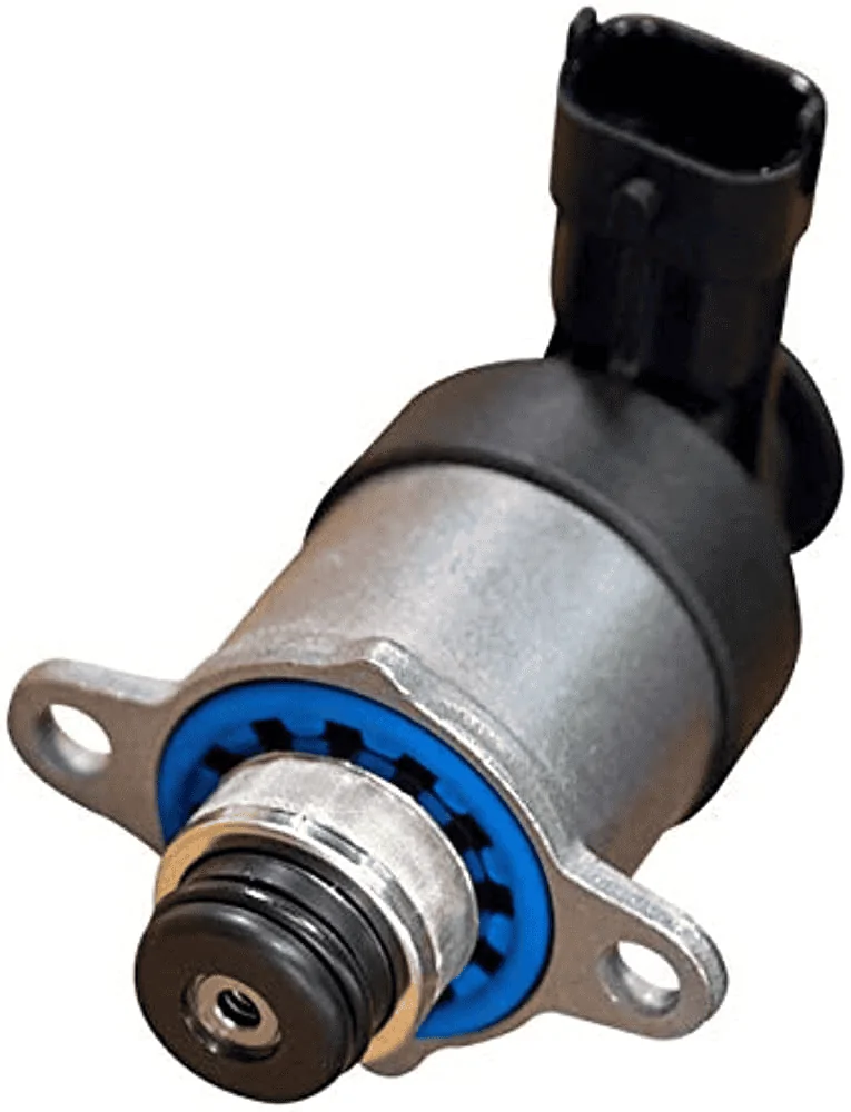

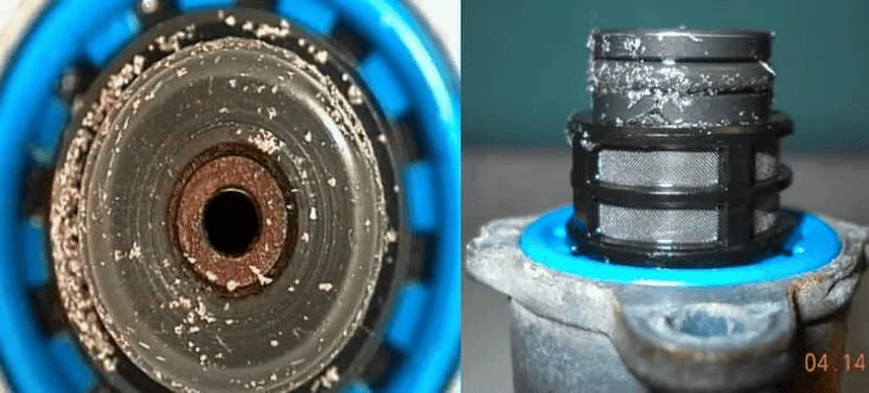

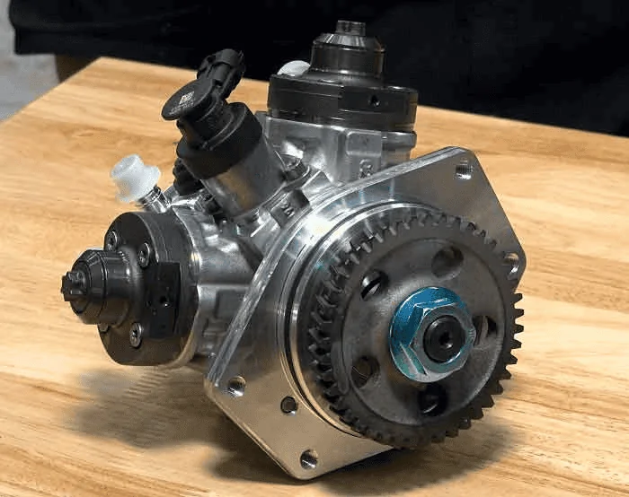

i cant seem to find a way to check if its gonna fail soon. anyone have thoughts or pretty much take pump off and look for particulates?
On the CP4 pump. The black connector piece between the V. You have to remove that to see the screen on the bottom of it.
Jeep Gladiator CP4 Fuel Pump EcoDiesel Recall 1682989099652
Jeep Gladiator CP4 Fuel Pump EcoDiesel Recall 1682989240779
Jeep Gladiator CP4 Fuel Pump EcoDiesel Recall 1682989297007
