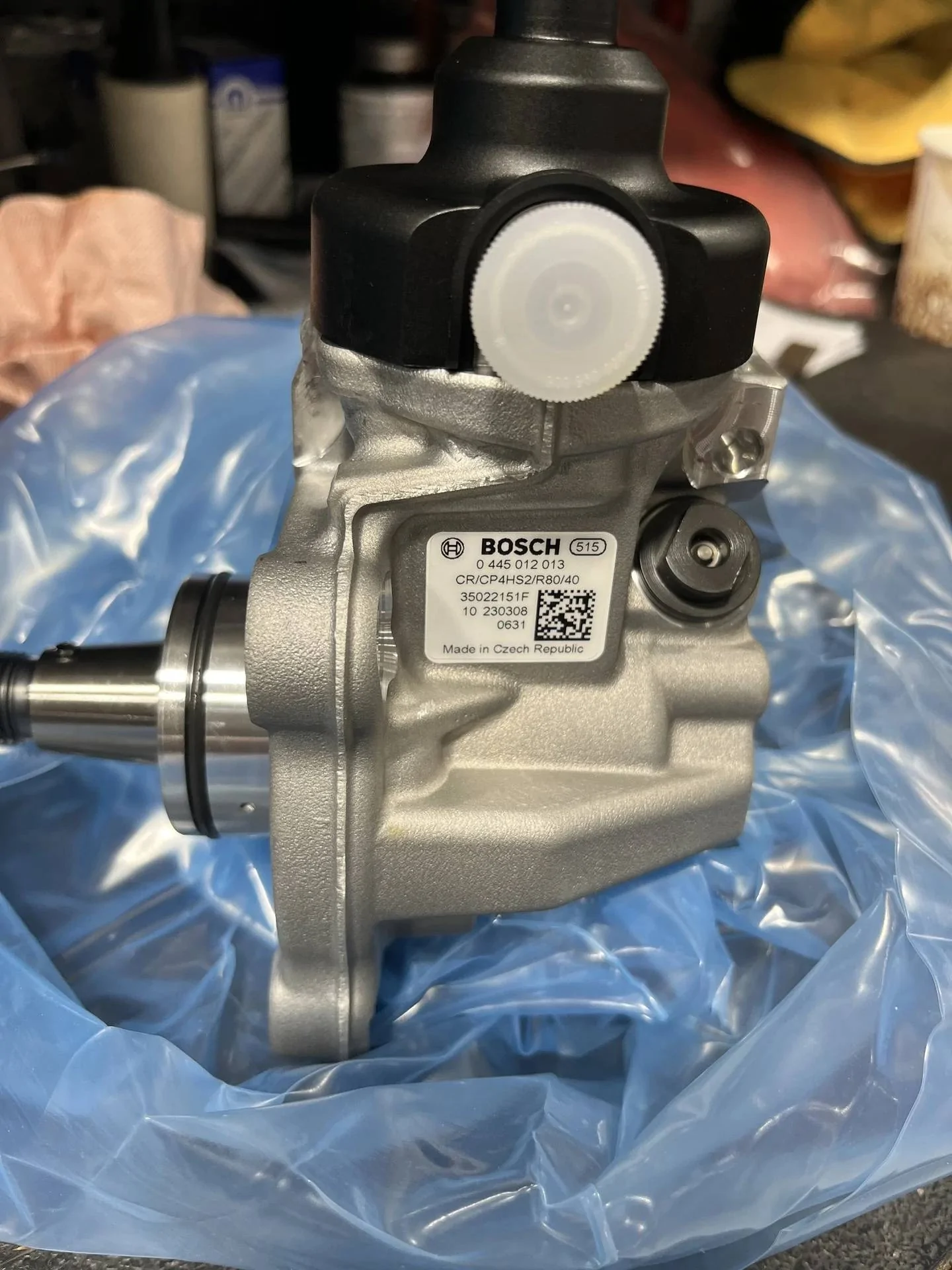

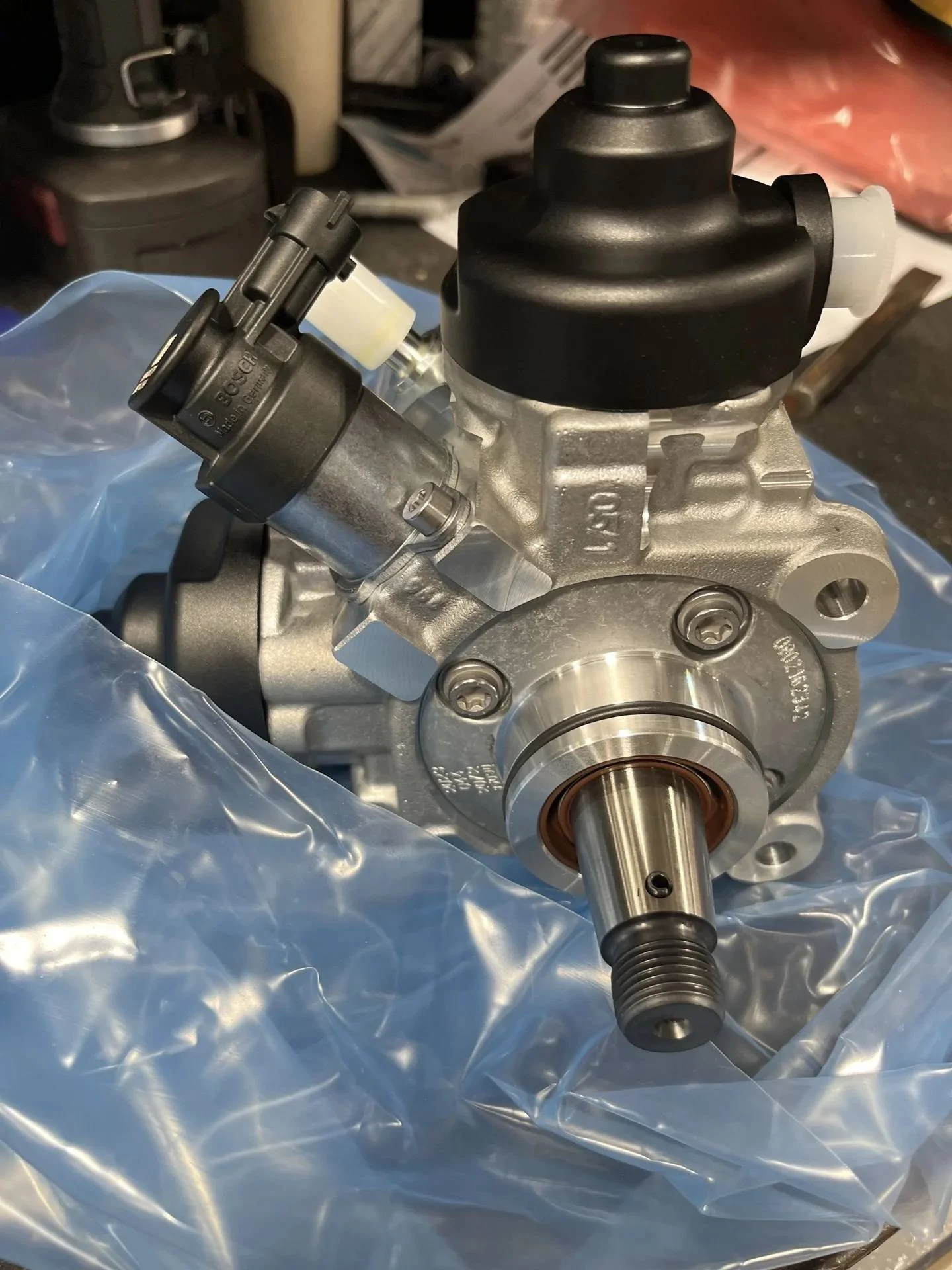

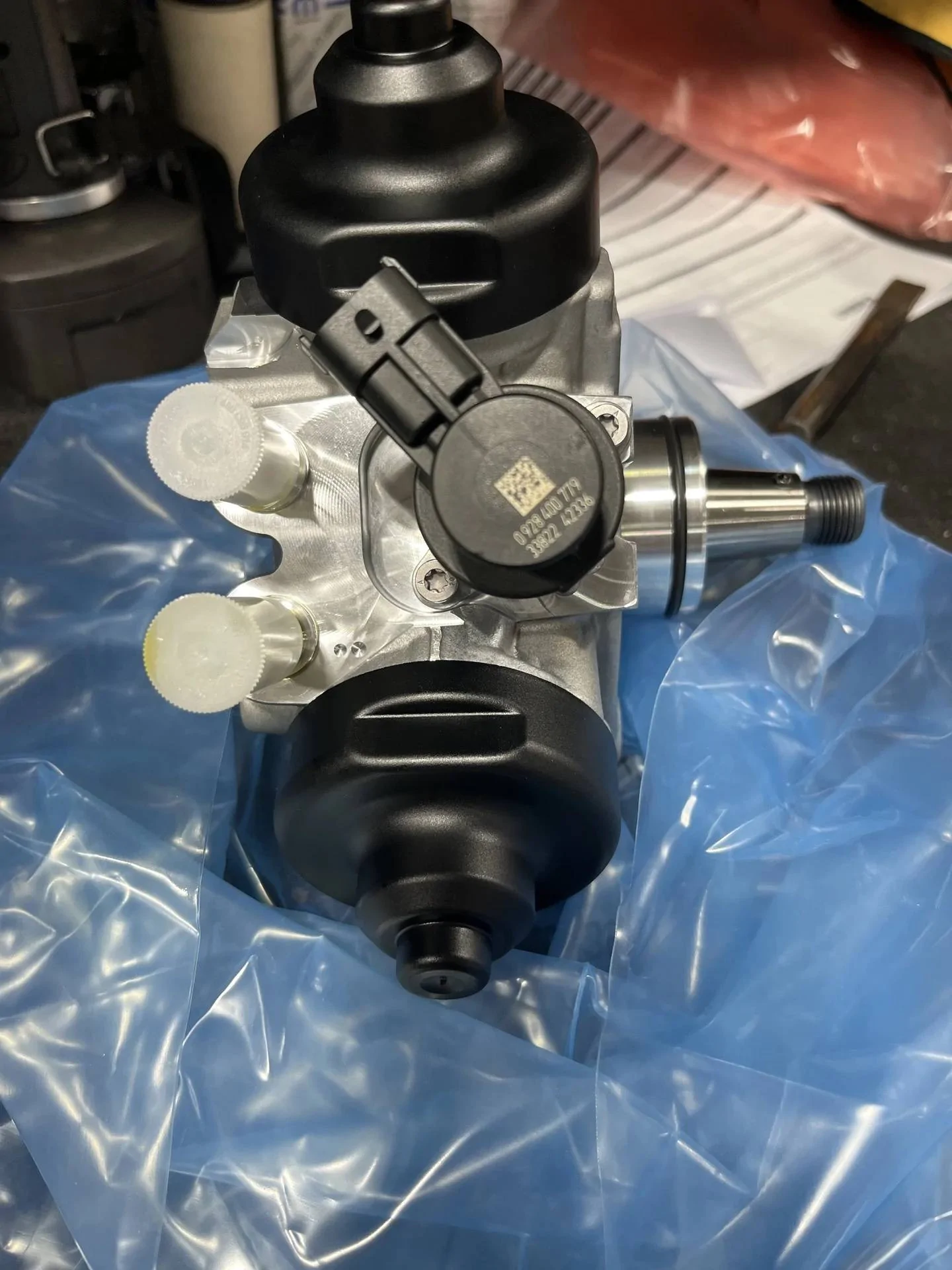

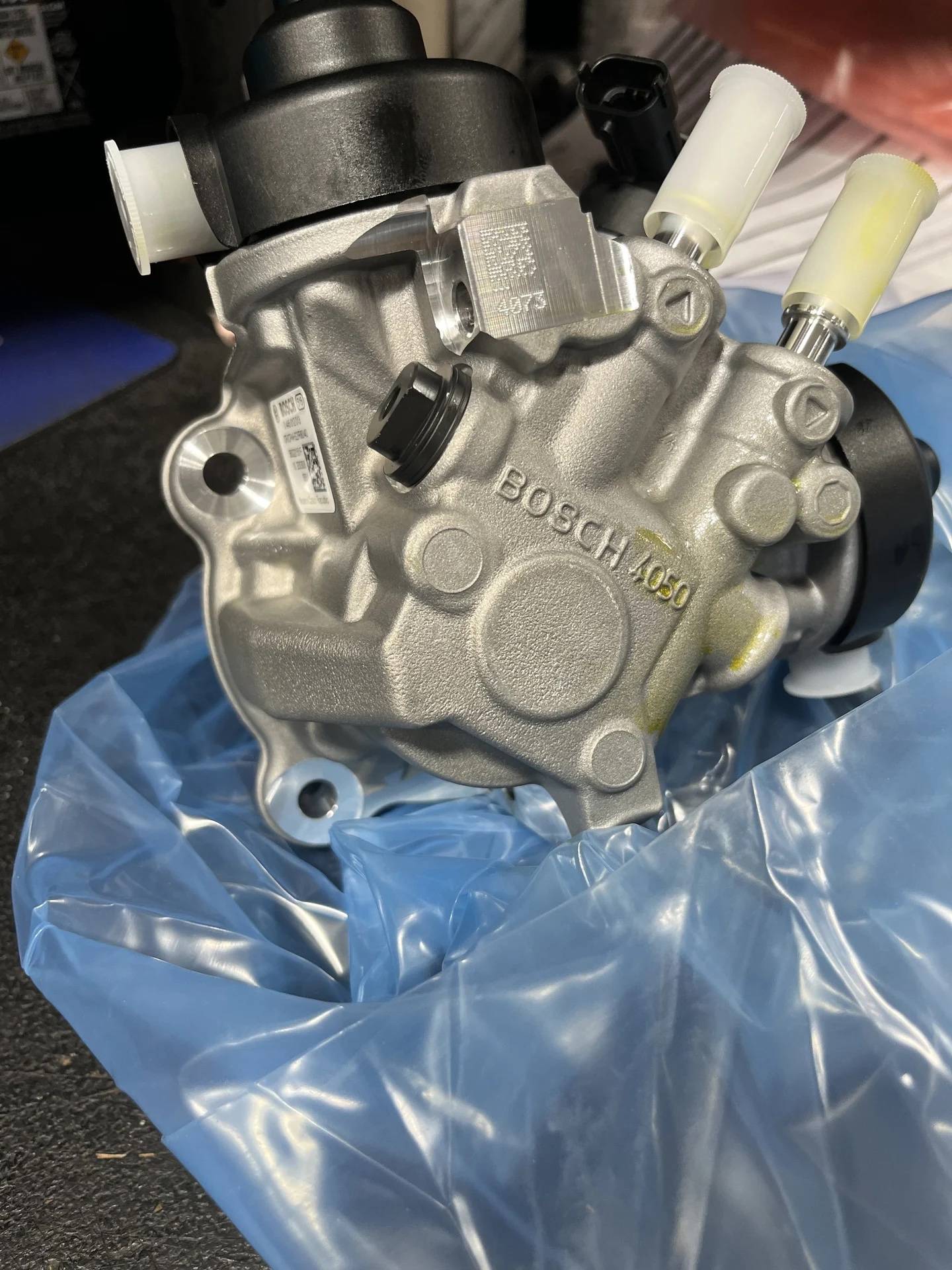

New Pump Photos (found on another site) can anybody see any differences?
Jeep Gladiator Z96 High Pressure Fuel Pump Recall!!!!!! Pump1 copy
Jeep Gladiator Z96 High Pressure Fuel Pump Recall!!!!!! Pump2 copy
Jeep Gladiator Z96 High Pressure Fuel Pump Recall!!!!!! Pump3 copy
Jeep Gladiator Z96 High Pressure Fuel Pump Recall!!!!!! Pump4 copy
Jeep Gladiator Z96 High Pressure Fuel Pump Recall!!!!!! Pump5 copy

I can see the dimple count is different based upon an image shared on this forum some time ago... But beyond that I don't see any external differences yet.
Jeep Gladiator Z96 High Pressure Fuel Pump Recall!!!!!! 1692409606438

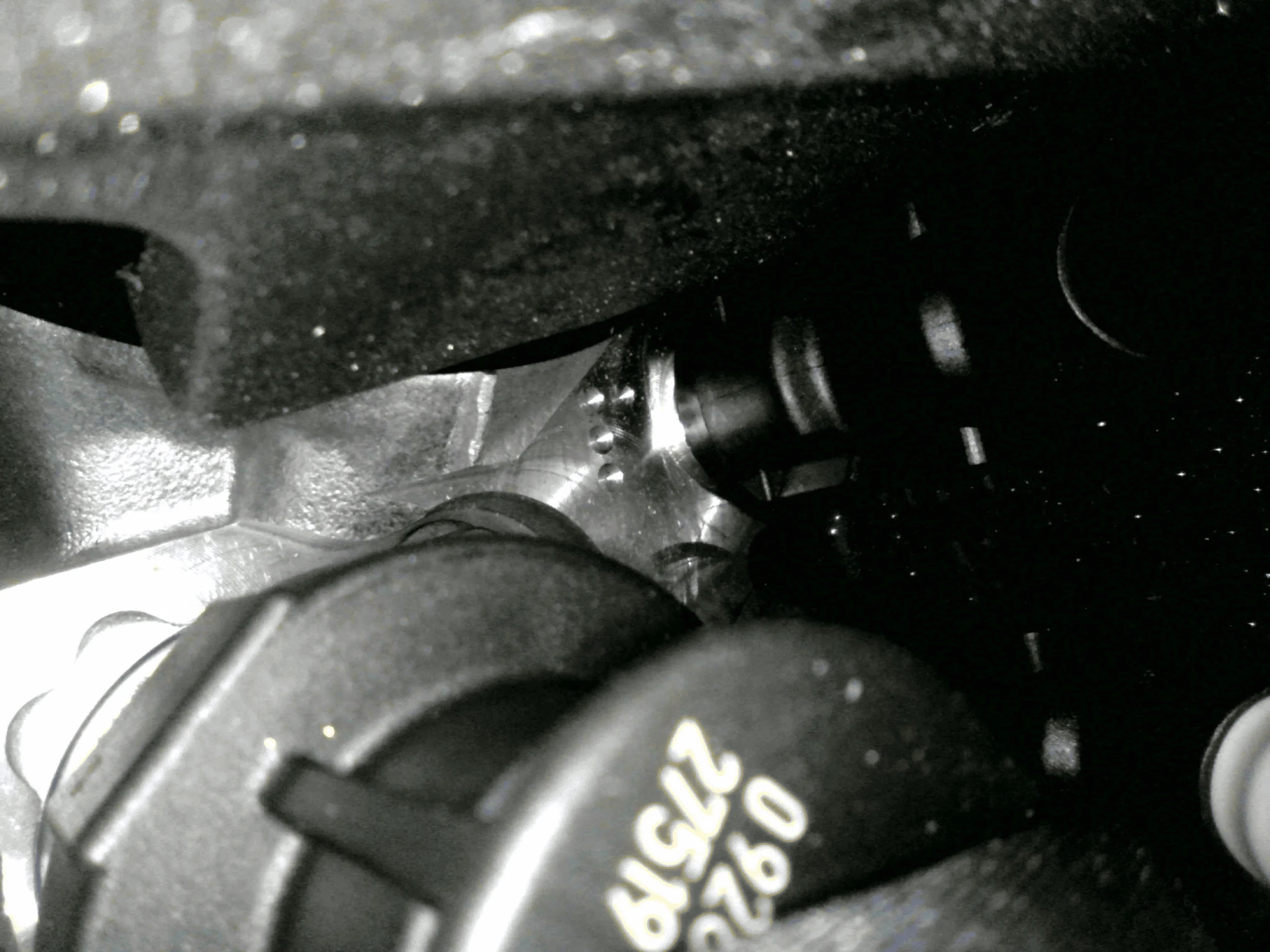

Mine is available as well. I called my dealer and am on the list. I had the jeep down there a week ago showing them metal in the fuel filter cap... They told me they are allowed to order 1 pump per week and they are going to call me back tonight with my number.
Fingers are crossed!!! because I have metal in my filter....

How have you made out? Changed my fuel filter yesterday on my ram and aluminum was there to greet me. Not a good feeling. My dealer is still claiming no parts for Ram's yet...
Jeep Gladiator Z96 High Pressure Fuel Pump Recall!!!!!! fuel filter housin
I have an appointment for ‘inspection’ on Wednesday…. We will see…..
